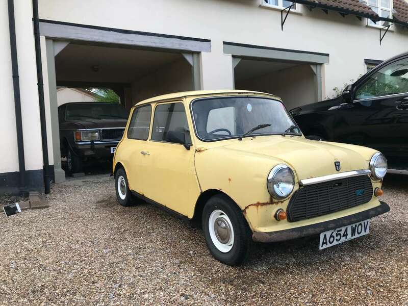

It's been a tough year on the Mini, but it is still with us. I should really consider some preservative measures sooner rather than later...

I wish there was a way to encase that mini in amber and protect it exactly at that state of bedraggledness for eternity, while still being able to use it.
It's a thing of beauty.

That way of protection is not its current life of road salt, bird poo and brake dust…
Although it did just manage 100 miles on Tuesday to collect more Granada parts. I just need to keep using it because once it comes off the road I have a feeling repairs will escalate!

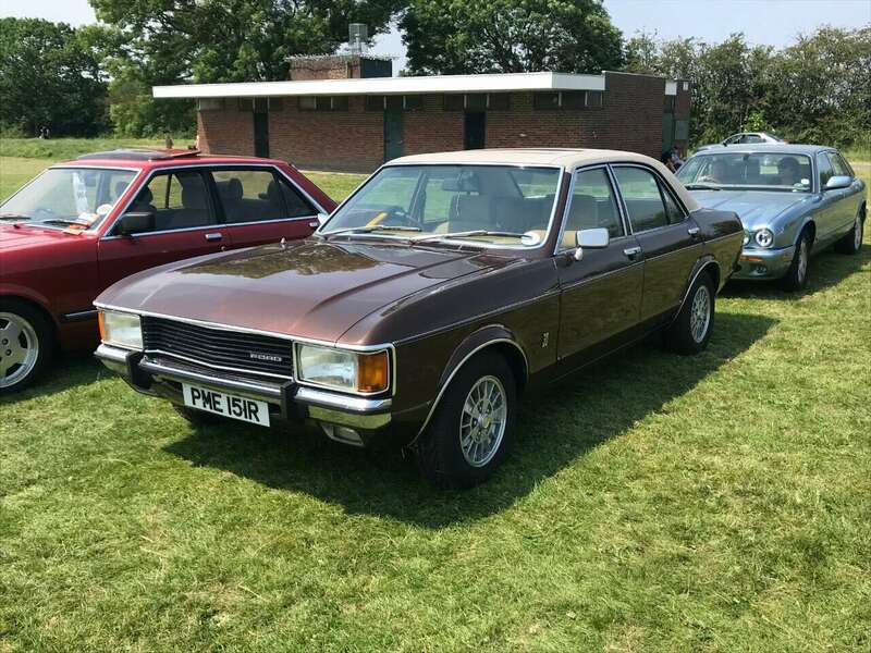

This Granada was “car of the show” for me. I don’t think I have deep enough pocket to get mine to this standard.

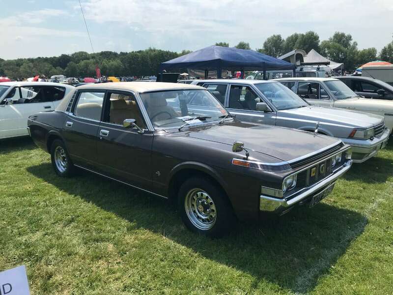

A close second fave was the Granada’s period competitor, the Crown, in a very comparable spec.

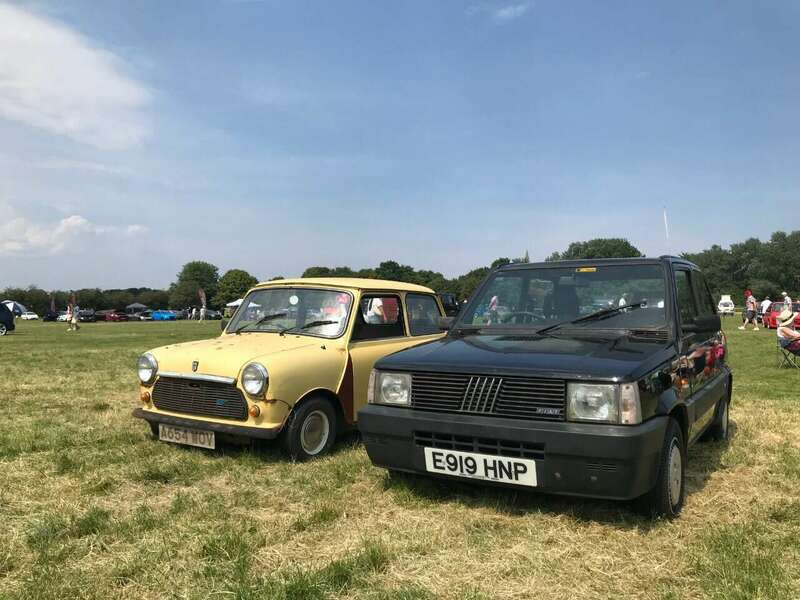

On the way out of the show the Mini was able to meet up with a few friends.
We made it home ok, despite the timing (I think) being a bit out after fitting electronic ignition. It’s getting a bit hot and pinky under high speed and load on dual carriageways.

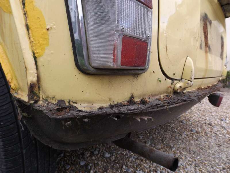

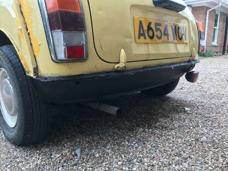

With its mechanical maladies addressed I thought I’d begin on a gentle program of aesthetic maintenance. I started at the end, specifically the rear end. The bumper has lost all of it’s paint and quite frankly looks a right mess and although replacements are pretty cheap, this one is twisted and dented in all the right places. The number plate is almost completely delaminated meow.
Removing it uncovers yet more bodywork horrors, naturally.  – Anyway, Krust + POR15 and hide it under the bumper again and job’s a good’un. Shan’t lose sleep.
The bumper was treated to Krust + the dregs of two Hammerite aerosols + Halfords mid-range satin black. I’ve not lacquered it as the City bumpers were sort of matt black from memory and as it is it’ll probably weather in more quickly.
A new plate was put on with a pre-2001 font as the old one was sure to come up on the MOT as “legally too tatty”.
A wash made a big improvement too. I really need to stop parking it up on bear earth under a big tree.

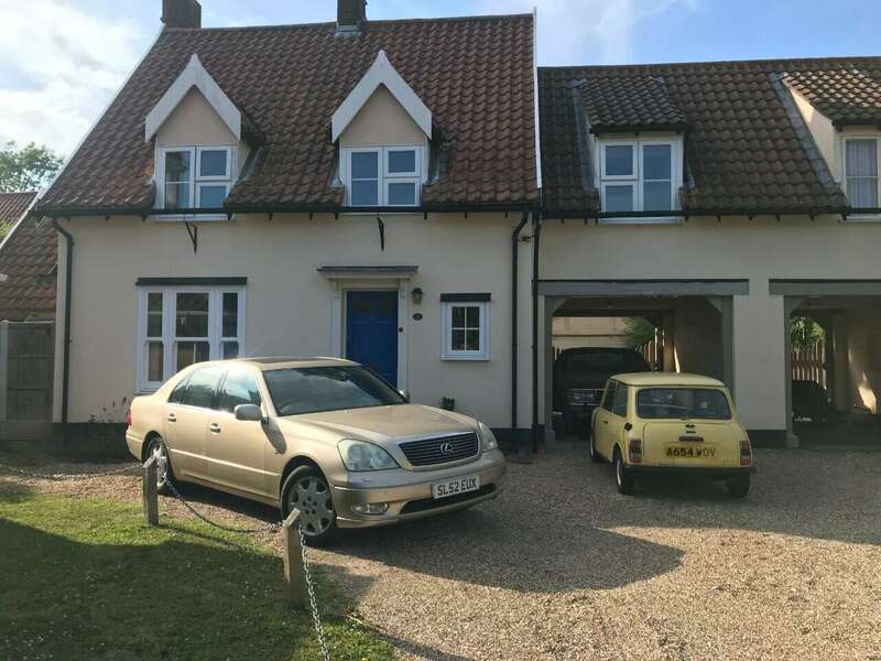

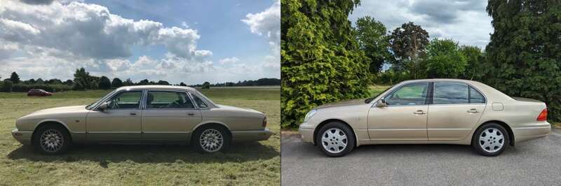

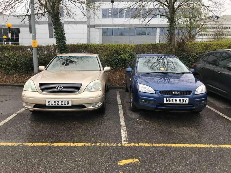

I’ve not really said much about my Lexus yet, but it’s gone now so let’s review 88 Days and 531 miles with a Lexus LS.
First impressions were great, it’s big, it’s beige, it’s V8; what’s not to like?! It took me a while to get my head around having it, what with it being about half a day between an out-of-the-blue text message proposition [for the car] and it being sat in a parking bay later that day at work with me scratching my head over getting rid of the diesel Focus and telling my wife I accidently bought another car, again.

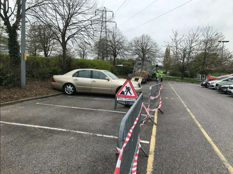

Indeed, it did spend a bit of time getting in the way… but finally, once it was coned off and probably earmarked as abandoned, I decided it was time to take it home.
For me, the main enjoyment with this car has been the refinement and the ridiculous amount of kit it has, particularly if you’re used to driving an early 80’s Mini City. Highlights include the many Auto-you-name-its, remote rear headrests, a blind that drops when you select Reverse and goes back up in Drive, an air purifier as well as multi-zone AC, a refrigerator, cooled seats, double glazing, hidden CD multichanger (I mostly used the tape deck with a 3.5mm jack, haha), soft close doors, dual radio controls, oscillating air vents, not only one glove box, but two and the headline act – massaging rear seats.
Features and capability wise, in period, this was probably the smart choice over the main competitors (S-Class, 7-Series, XJ?) particularly because I think they were quite a good price comparatively. But something about it seemed that it never sold that well and maybe for the same reasons, to be really honest, it never gelled well with me either. I had an XJ8 a few years back that (obviously) shared no two components with the Lexus, but to all intents and purposes it was the same car. Big, Beige, V8. For some reason I much preferred the Jag.
The Lexus, then, objectively is a good car, perhaps the best I've ever had, despite this particular example’s grotty bits that I won’t go into here (in the For Sale Sold advert if you’re particularly interested). Yet I never really let it get under my skin. But to be fair, 500 miles was not much opportunity for it to make its case. I am glad I had it, it was a lovely place to be, I just couldn’t get any more enthusiastic with it than with the glee of finding yet more features that I hadn’t realised existed. I seem to remember finding the Jag a bit boring at the time actually, so maybe I just needed more time with it and more time to pass before my spectacles get a heavier rose tint and it'll turn out that the Lexus was in fact as ace as it should have been.

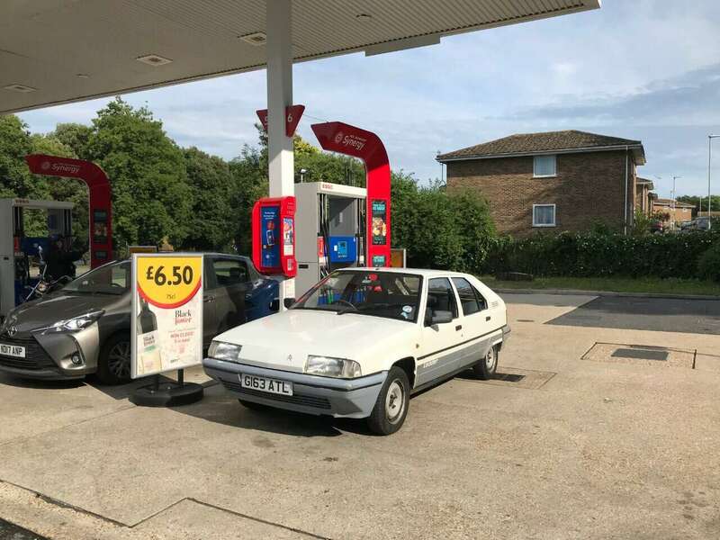

Harrison’s History #60 - Citroen BX LEADER
Replacing the Lexus directly is the BX “Leader”. I don’t think I’ve fallen for a car so quickly for a while!
I’ve decided to record this one a bit differently - a return to the older format of a thread following a car rather than a person with a car, so for the Leader I’m going to set up a dedicated thread (and post the link here).

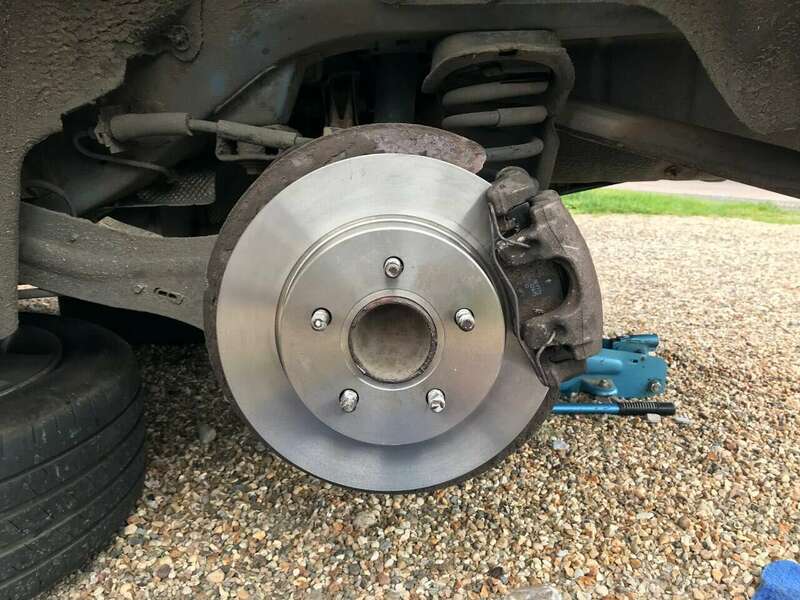

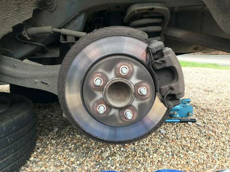

Grinding. The stalwart Focus came back from the last trip of my wife’s holidays with reports of grinding and a “really hot wheel covered in red dust”.
As Adam Savage would say, “There’s your problem”. The rear O/S calliper had stuck or been sticking and has Müller’d the pads when compared with the other side. The Volvo is still at the welders, the Mini’s MOT expires tomorrow, I need the BX for my work and my other cars are… haven’t been cars for some time.
One course of action. To Euro Car Parts! Rear discs and pads for both sides are I n stock and collected in just an hour. 1 minute to order, 59 minutes waiting for them to bring them out of the stockroom.
The sticking calliper was a bit of a pig, but the car was needed in the morning and I couldn’t get a new one on the spot, so a bit of exercising and greasing the sliders had it mostly ok in the travel now it had fat new pads in there. It would probably stick though when the pads where thin again so needs to go. All buttoned up and back together in under 4 hours ready for work the next day (…and a few hundred miles of weekend fun).
Day 2. Everything back apart again as the damn thing was needed as a car before a completely satisfactory “finish”.
The new calliper had time to be shipped to the store and only took an hour to pick up! 1 minute to acknowledge the delivery, 59 minutes waiting for them to bring them out of the stockroom.
While I was doing the rear N/S disc and pads during the previous session I noticed the spring has snapped near the top. A speculative spring was ordered and if I don’t do it now with the arse already up in the air I’ll probably put it off for too long.
I used an ingenuous* spring removal method by undoing the bottom of the damper and levering the whole suspension arm down by sitting on a great big piece of angle iron while reaching in to pull out the old spring. Tentatively.
It turned out the spring had suffered double ended borkage, and was probably responsible for “mystery clunk A” and “mystery clunk B” (of many).
I used the same method (it’s not as perilous you’d expect it could be) to refit the new spring, but on account of it being longer thanks to being in one piece I had to employ more travel to my suspension seesaw by adding a raised fulcrum (block of wood) to allow me to really open it up. All back together in time for tea.
I’m pretty pleased with what I manage to get done in two evening slots with the car still useable in between  - but it really is so much nicer to not have to.
