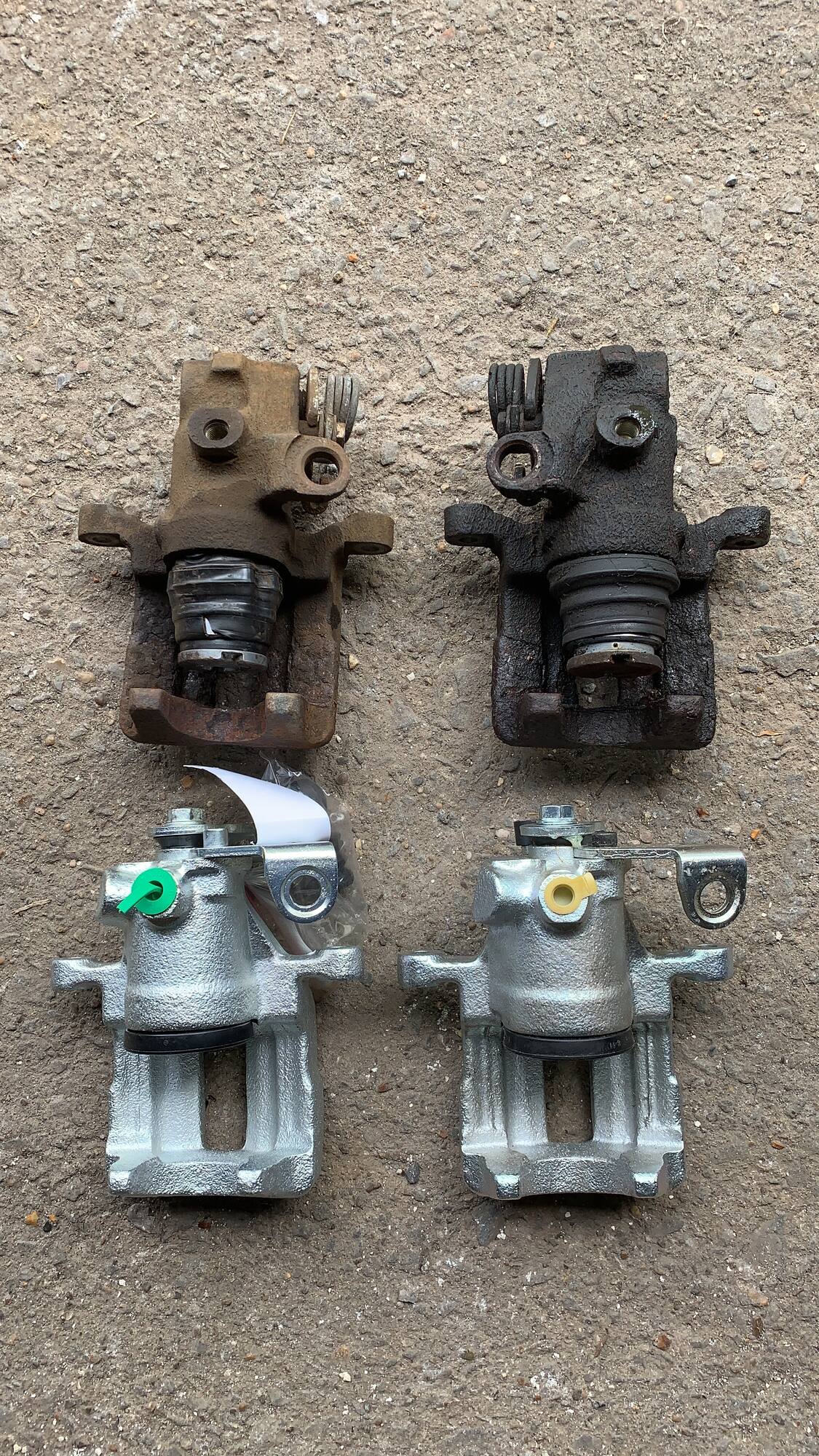

I used brake fluid as a lubricant, following internet advice - is brake grease better?
And yes, they sent me two offside (RH) ones. (My order was correct.)
20 minutes ago, SiC said:
New ones don't appear to have the handbrake cable mechanism either.
They have a handbrake cable mechanism, but it’s different and the hole is too small for the ferrules on the handbrake cables.
So they’re both wrong.  And ECP aren’t accepting returns, so I’ve been properly ripped off.
I’ve now ordered some cheaper, correct-looking refurbed calipers from eBay sellers, as I’ve run right out of being arsed with this job.

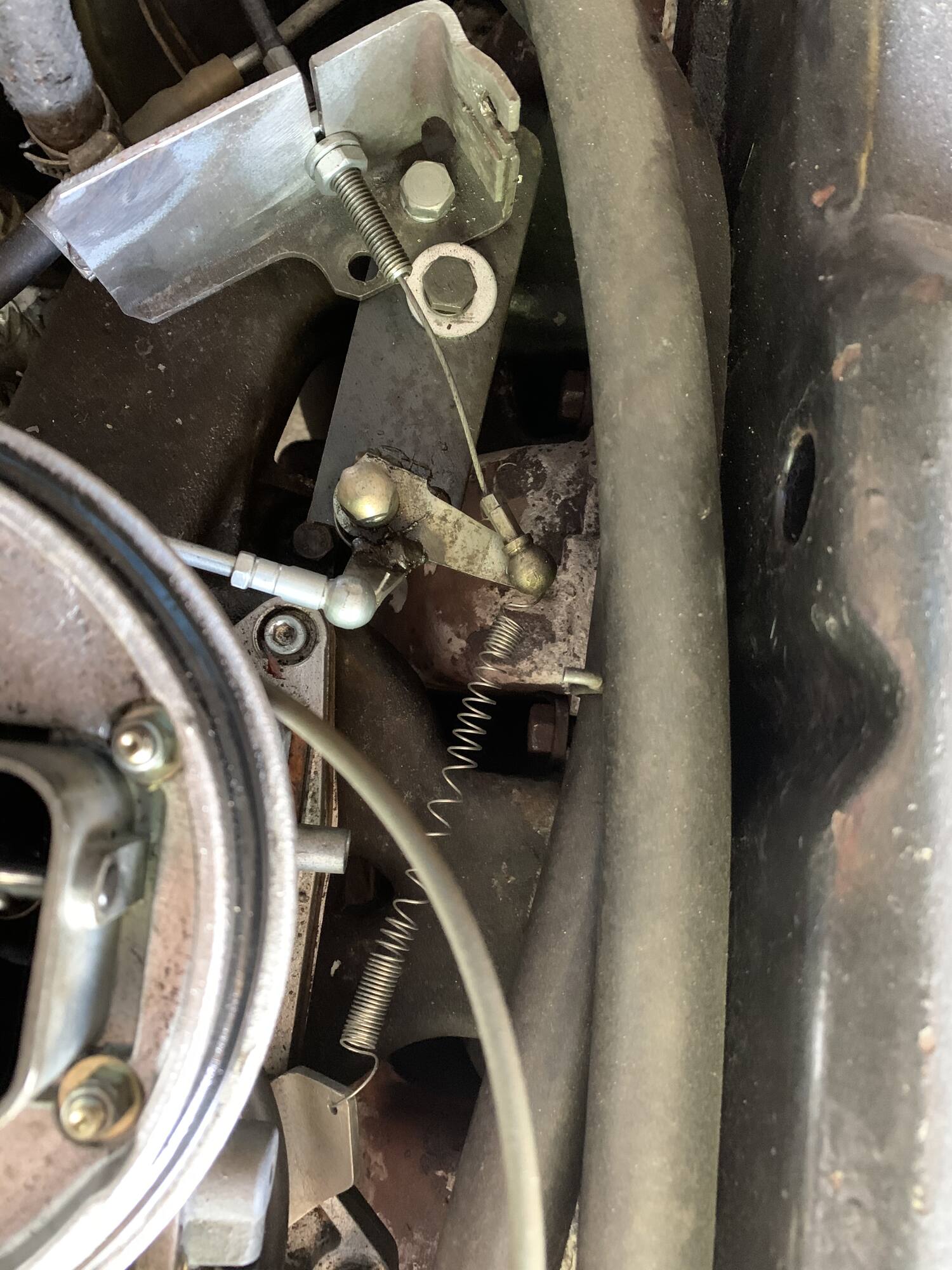

While bits of brakes and Dremel wire wheels are on order, it was time to look into the sticking throttle on the new Royale.
Looking at my own video of the mechanism working, it struck me that the accelerator cable was attacking the pivot at an unhelpfully sharp angle. This meant it took rather more force to start it moving than to move the pivot through the latter portion of its arc.
Before:
That return spring doesn’t look ideal, either. Someone’s been in here tinkering, methinks.
Off with that bracket, some re-orientation (I tried lots of positions, fnarr) and we ended up here.
After:
It doesn’t look hugely different but the throttle feels MUCH smoother now.
The proof of the pudding was in the drive home — it’s no longer the eighth task of Hercules to manoeuvre at low speed without stalling, and on the open road the car drives like it should — which is to say a big luxury coupe with an unstressed six cylinder engine that wafts and surges like a boss.

It looks as though it should turn through 90 degrees more and use both bolts to hold it, and the cable go though the other hole in the bracket.
That’s what I thought too. When I tried it though — either way round — it’s too close to the pivot and there isn’t enough range of movement.
I’m not convinced it’s the right bracket. I may fabricate a new one - I have some suitable steel that even has holes in the right place by bizarre coincidence, but they need boring out to 8mm and I’ll need a stepper drill for that. I thought I had one but it seems not.

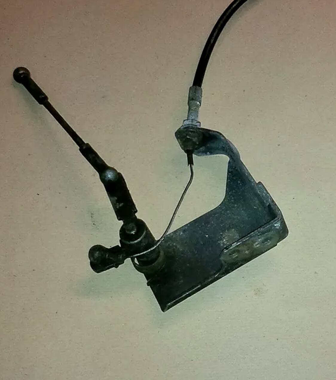

Further research brought up this, a Vauxhall/Opel 2.8 accelerator cable for sale on eBay.
It’s definitely a different bracket, and looks a more suitable shape.
I’m not paying £25 for it though.  When I can be bothered, I’ll make one.

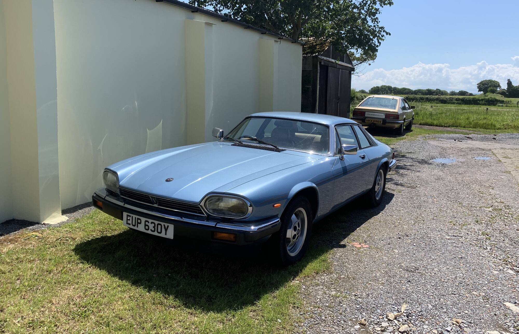

The XJ-S is home. It went off to the local specialist for MOT and a couple of other jobs before lockdown, and I sort of ignored it.
The garage did close briefly but has been open since Easter, which I hadn’t realised until they rang me up this week.
They’ve fixed the automatic choke - a faulty valve - and replaced a coolant hose that conveniently burst while they were working on it rather than when I was driving to London or something.
They’ve replaced the gearbox actuator too, again — it had gone back to kicking down under all but the lightest throttle. Might have been a faulty part or there might be something else amiss; we’ll see how it goes.
For now it’s driving much more smoothly and it’s lovely to have it roar then purr straight away when you start it from cold, instead of having to faff about with left foot braking so you can keep the revs up.
Very lazy photo:
They’d parked it with the handbrake on, not unreasonably; I had to quickly google how to release it again. I never normally use it because I have the fear with flyoff handbrakes.
For my own future reference: lift and let drop to engage, lift and press button to release.

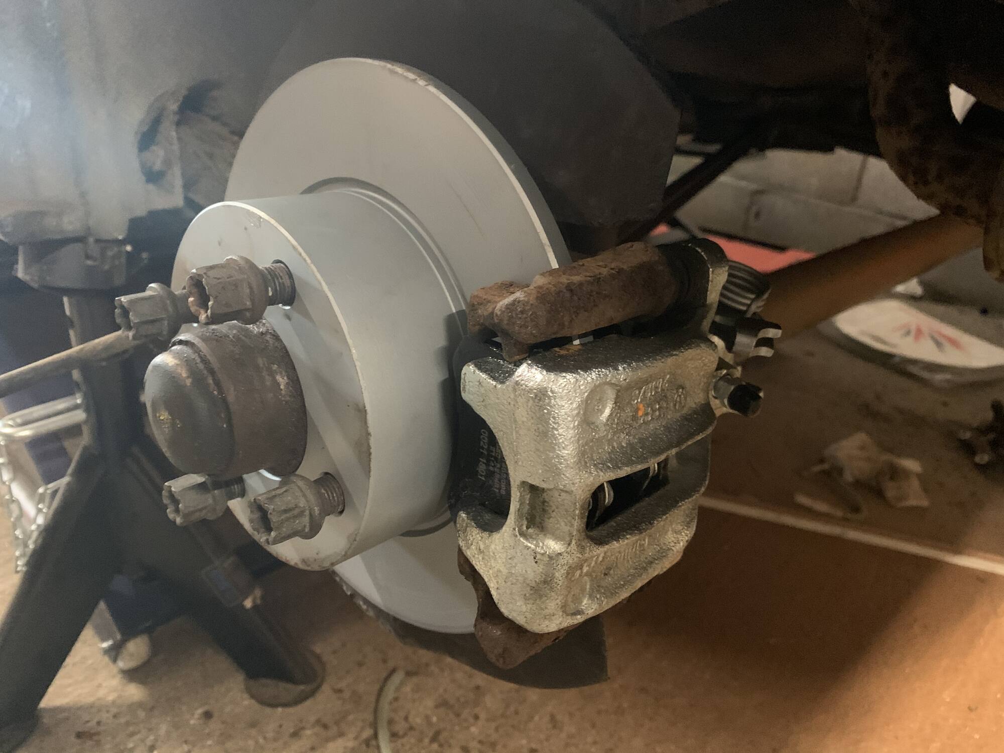

Minor update: finally got the correct eBay-sourced rear brake calipers fitted to the Audi 80 today, together with new discs and pads. Also cleaned and greased the sliders and applied new rubber boots.
It would have taken half the time if I hadn’t faffed around trying to get the springs on the pads to locate in the caliper. They don’t — you fit the pads first then they just butt up against the caliper. Durr.
The hydraulics are connected up but actual brake fluid and bleeding can wait until I’ve done the fronts — next time.

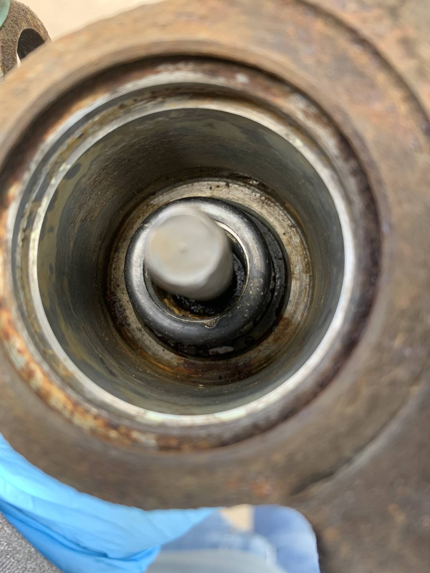

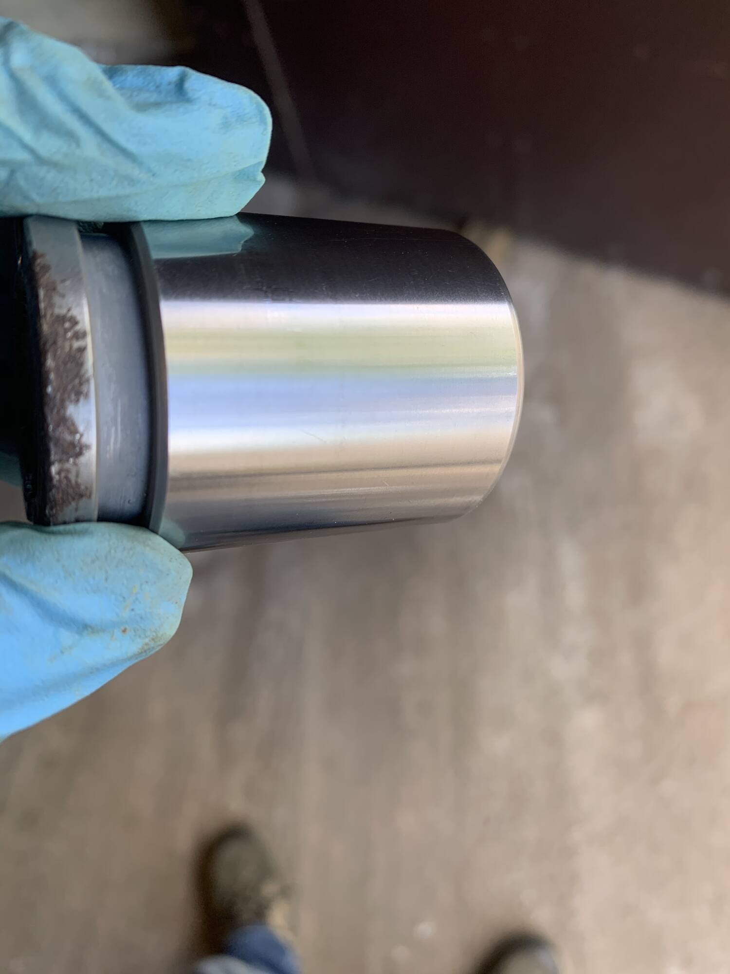

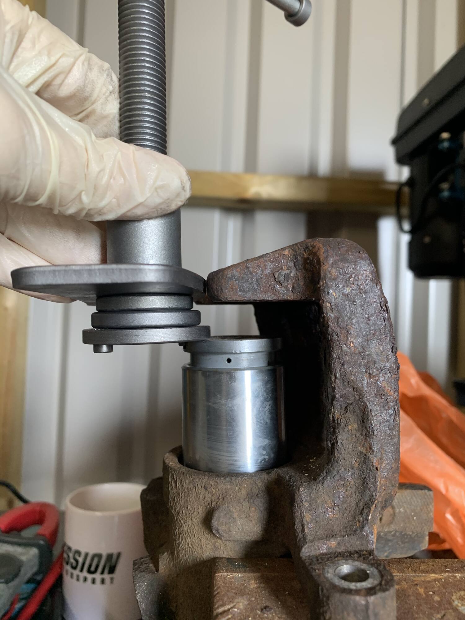

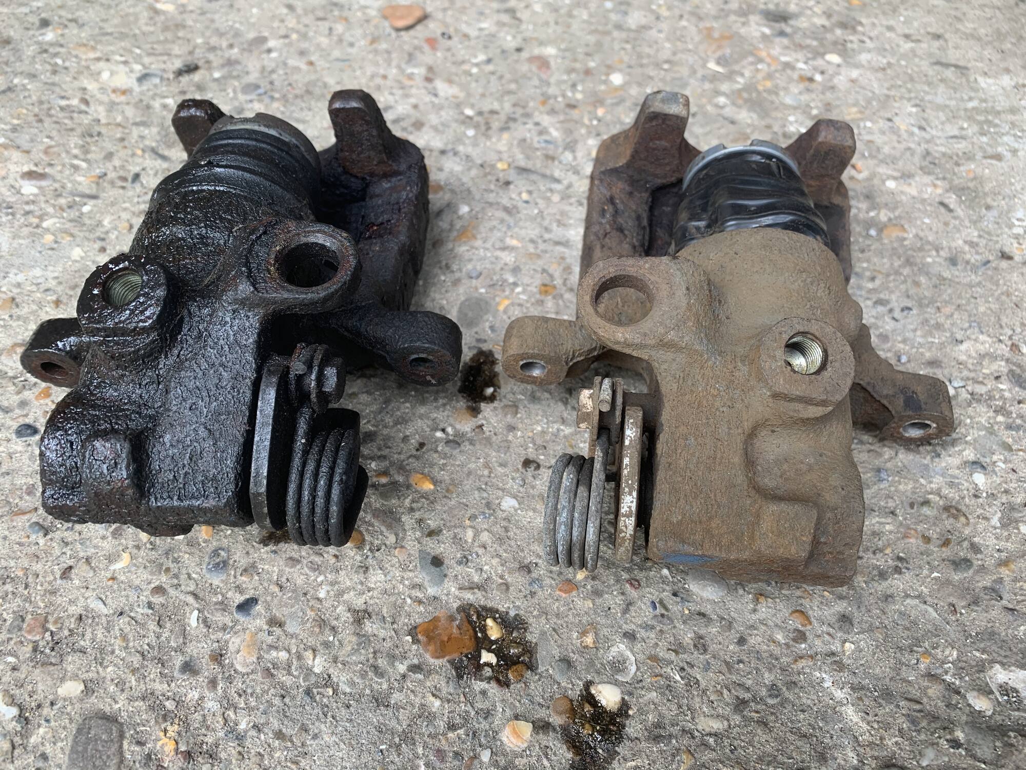

In between getting distracted by plush Vauxhalls, I have been chipping away at the problem of the Audi’s rear brakes.  They are fighting back hard at every step.
I stripped the calipers down and cleaned them up in a roughly 10% solution of POR15 degreaser in the ultrasound bath (before on the left, after on the right):
I bought a rebuild kit and replaced the various seals.
I gave the pistons and cylinders a polish with some 2000 grit:
FB4615AD-FB85-484D-9D3D-EB63643A5B35.thumb.jpeg.24ffe52a9a51c72f9a53bd2b51ccf4b9.jpegB1217D47-6DA5-401B-AA99-3E26EAD2A6A0.thumb.jpeg.208b7abaca935848b26fd409b73a2534.jpeg
The problem I’ve got is that the pistons won’t wind back in — they won’t push past the new square cut seal. I can’t fit a rewind tool between the caliper and the piston to apply enough mechanical pressure:
I’ve tried fitting the seal round the piston and trying to force it down the gap into its slot, but that’s going nowhere too.
So I caved in and ordered a pair of new calipers from ECP, both left and right sides...
...can you tell what’s wrong with this picture?
one's green the other is yellow? ?
