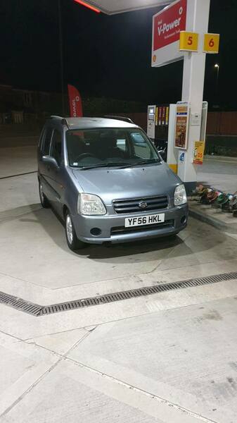

She is now officially in the club :)
Just now, barefoot said:
Hasn't she got a name yet?
Not yet
But without one, how can I possibly be expected to comprehend which motor vehicle you are speaking of?

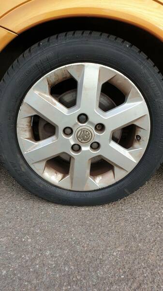

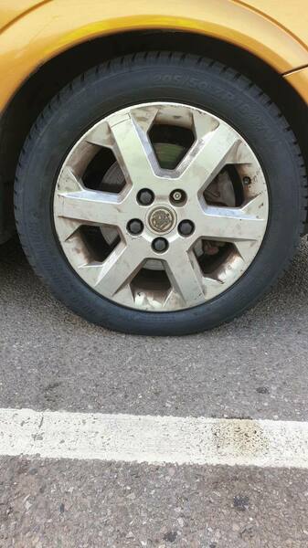

Shirley the disastra had a new set of front tyres today. Kormorans. Decent mid range tyre.
Fitter advised that the Chinese death rings on the back, were past their best, 8 yrs old and rock hard and one has a slow leak.
So next Tuesday, she goes back for two more tyres. This may resolve the squirrily handling on worn tarmac.

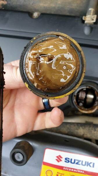

So when buying a car, there are a few basic checks to perform.
Lights, tyres, interior electrics, oil cap, coolant, dip stick.
Then see if it drives OK.
I did all of these bar one.
Went out today, to see how easy the thermostat would be. Thought I better check the one thing I had forgotten.
Now I like mayo. On my chips, not in the engine.
Coolant is clear, doesn't seem to have lost any and no mayo on end of dipstick.
So. Three scenarios.
1) Previous giffer owner, did short journeys with a non functioning thermostat and the oil in the top of the engine has emulsified.
2) It had a head gasket failure recently, got fixed but oil wasn't flushed.
3) OMGHGF
I'm obviously hoping 1) or 2) but expecting 3).
Think I need to buy a sniff test kit before spending anything else on the motor.
Note to self- NEVER forget the basic checks.
  • Cookiesouwest changed the title to Do you want Mayo with your chips - Cookie's adventures in shiteing
I'm voting for not getting hot because of the thermostat being the cause.
I do hope so.
I concur 🤞🤞 with the added short journeys at no more than 2000rpm from the giffer with flat cap and gloves. Possibly with floral cushions on the parcel shelf.
I think it's a suzuki unit, if it's a 1.3. The 1.0 and 1.2 were the GM engines I believe same as the corsa???
Looking at the cams and screws holding them on, it appears to be a GM unit. If so, that mayo is entirely normal for them. My Corsa was way worse than that when it was in daily use.
I'd recommend taking the rocker cover off and cleaning under it with a paper towel as well.
This one has the Z12XEP. GM 1.2 twinport engine.

On 3/20/2021 at 7:55 PM, Cookiesouwest said:
Close. This one has the GM 1.2
TADIS on those engines if driven short journeys. If it gets really bad it can bung up the oil pressure sensor and look like the oil pressure is low.
She does have evidence of brown coolant spray all over engine bay and the coolant bottle looks suspiciously new. Could be a co-incidence.
Possibly OMGHGF fixed but not cleaned up very well.
Plan is to do thermostat, get oil changed and monitor it.
