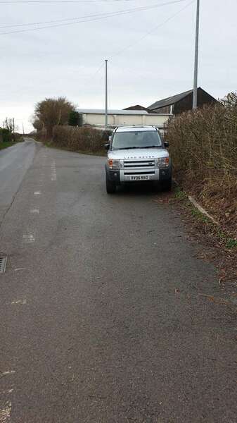

Disco is off to the garage tomorrow. As its a 2hr walk back after dropping it off, I decided to drop it off today.
Except the estate is locked :(
So I've had to leave it parked at side of road.
Anyone want to bet, whether its still there in the morning?
Will drive up in the Mondy when they open Monday AM, so I can discuss what needs doing.
If I get any change from 1500 notes, I will be thrilled.
If it gets nicked, I will probably be almost as thrilled lol

Just went to check on it - yes I'm that sad.
It's still there :)

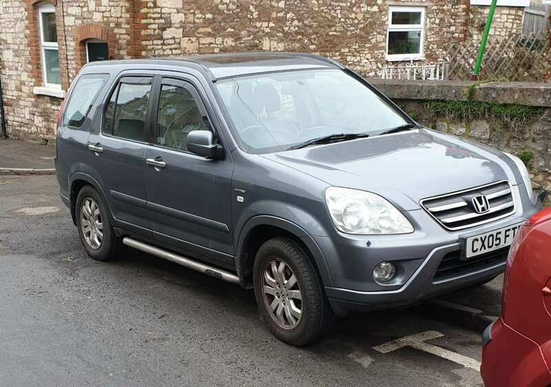

CRV went to garage yesterday, in an attempt to get it off the naughty step.
Needed the advisories done from MOT (just a couple of suspension bits) and a diff fluid change, in an attempt to double its current 2wd.
Went to collect this morning and took the dogs, for an hour walk.
Sadly no snow or torrential rain, to find out if I now have 4wd. Rear end certainly felt better.
Pic of CRV now off the naughty step (hopefully).
