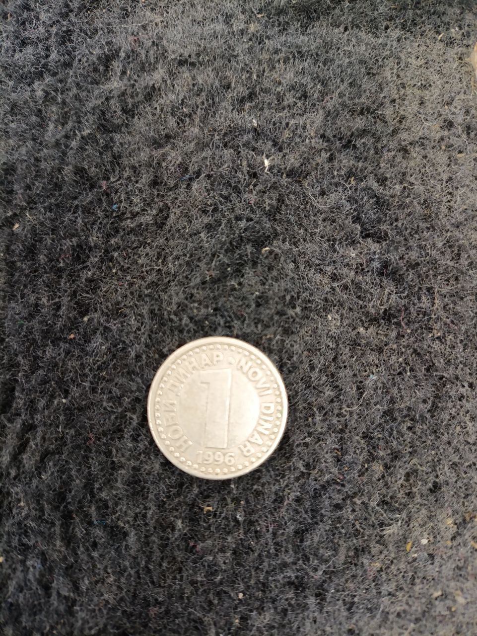

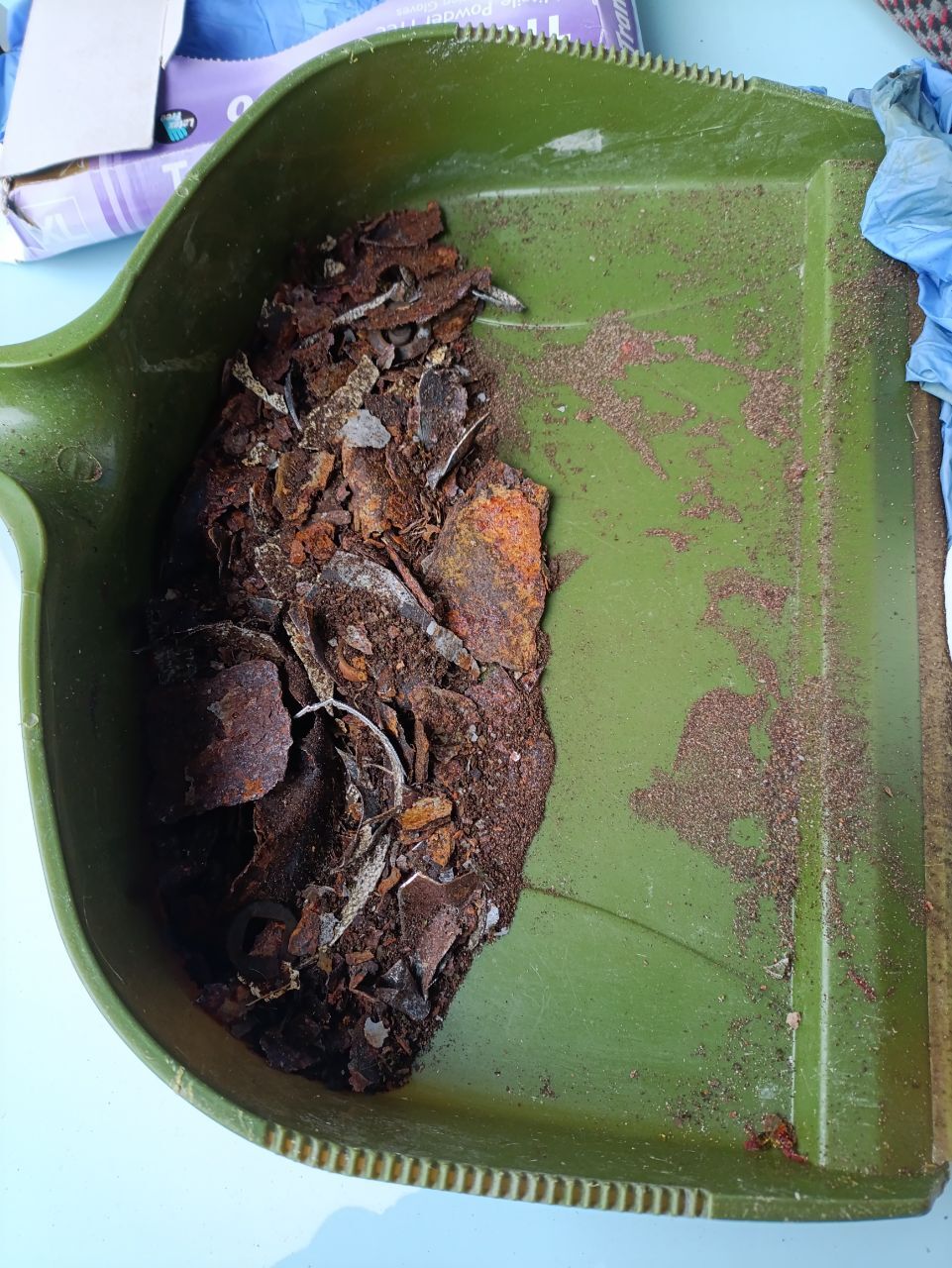

sdkrc Posted May 24, 2025 Author Posted May 24, 2025 First interesting find, a Yugoslavian coin, sort of. I thought Yugoslavia ceased to exist in 1992 but this is the Federal republic and not the socialist republic. So Serbia and Montenegro and not the rest Lacquer Peel, Dyslexic Viking, Tickman and 8 others 11

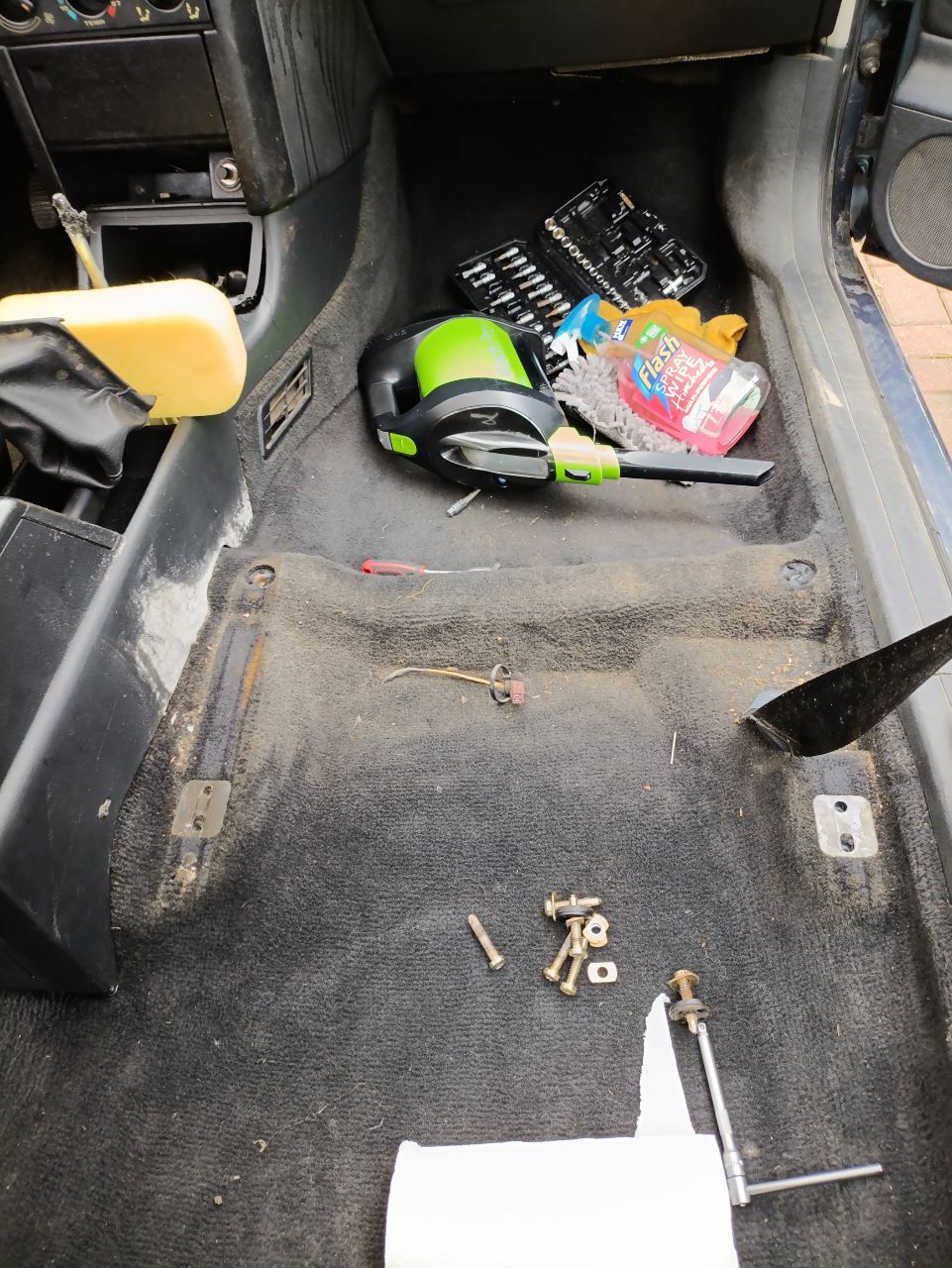

sdkrc Posted May 24, 2025 Author Posted May 24, 2025 2 hours ago, Supernaut said: I assume you have bought the others out. Hostile take over. It was @Jimbob McGregor who found it and sourced the funding with me and @loserone 2-3 yrs ago. I bought everyone out. It's had sportline wheels courtesy of @loserone and has been kept in a barn since then. It's Serbian and needs MOTing and importing, it's high mileage. It's got a bad head gasket runs a little rough. Will see to those eventually. Progress today: - Interior de-contaminated and mostly removed - driver's seat slide mechanism freed after a 2hr battle - Passenger window is up - Battery has been revived with a dumb charger and then a smart charger - French and Yugoslavian coins obtained AnnoyingPentium, Supernaut, Schaefft and 14 others 17

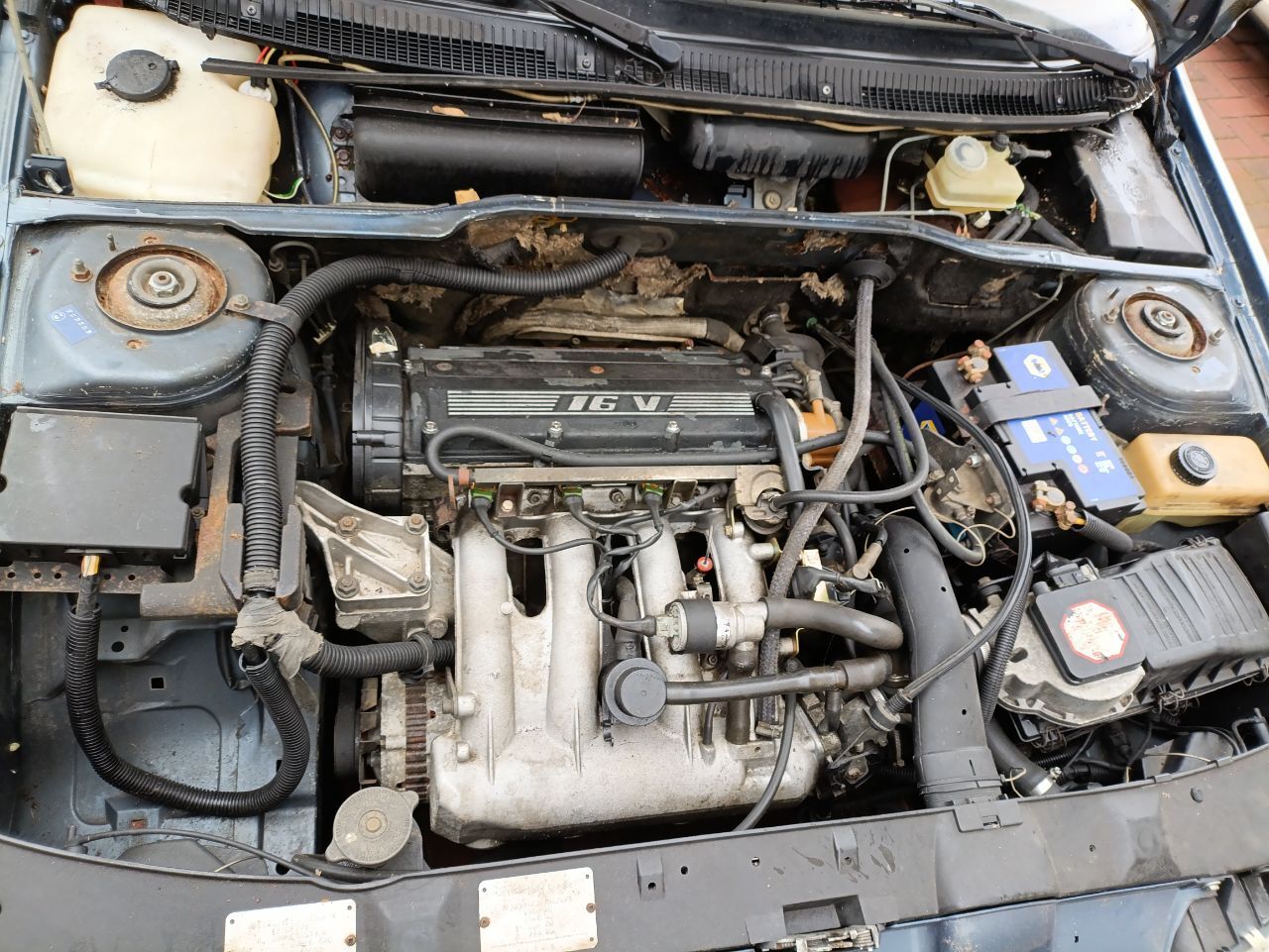

sdkrc Posted May 24, 2025 Author Posted May 24, 2025 16 minutes ago, Scruffy Bodger said: Is it the proper all alloy Mi16? I think so, not sure what versions of the engine there are Jim Bell 1

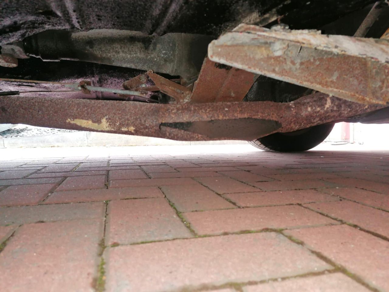

Scruffy Bodger Posted May 24, 2025 Posted May 24, 2025 13 minutes ago, sdkrc said: I think so, not sure what versions of the engine there are That's the badger, brilliant engine that loves to rev to the 7.2K limiter, that's why so many made their way into 205's, 30bhp more and no weight penalty, a fantastic combo! What's it like in front of the rear wheels? Lacquer Peel and sdkrc 2
sdkrc Posted May 24, 2025 Author Posted May 24, 2025 I've not checked, is that the place for rust? It looks like this was a German car up until 2019ish and then it went to Serbia. Better than a lifetime in Scotland but not sure how much better. I need to check if it's stolen actually. Is £16 via car vertical the going rate now!? They seem to think the vin is for a 106
Scruffy Bodger Posted May 24, 2025 Posted May 24, 2025 1 minute ago, sdkrc said: I've not checked, is that the place for rust? It looks like this was a German car up until 2019ish and then it went to Serbia. Better than a lifetime in Scotland but not sure how much better. I need to check if it's stolen actually. Is £16 via car vertical the going rate now!? They seem to think the vin is for a 106 That's the main area, yes. They hide it really well under the thick underseal, have a really good poke about underneath and check it over properly so you don't get any nasty surprises later on. The facebook group is very helpful if you need bits, especially guru Gritton. sdkrc 1

sdkrc Posted May 25, 2025 Author Posted May 25, 2025 I can't find the Serbian registration card so don't think we'll be able to fish out more detail on this for the time being. I suspect the previous owner/importer guy has it. Vin numbers match across the import doc, chassis, documentation etc. but may have been tampered with. Not sure if they stamp the engine too but will have a gander in the future. Driver's side in front of the rear wheel looks great. Passenger side is crusty but fixable. Brake lines need replacing. Costs are mounting but it's still firmly in cheap territory. Bonnet catch came clean off too Jim Bell, loserone and Coprolalia 3

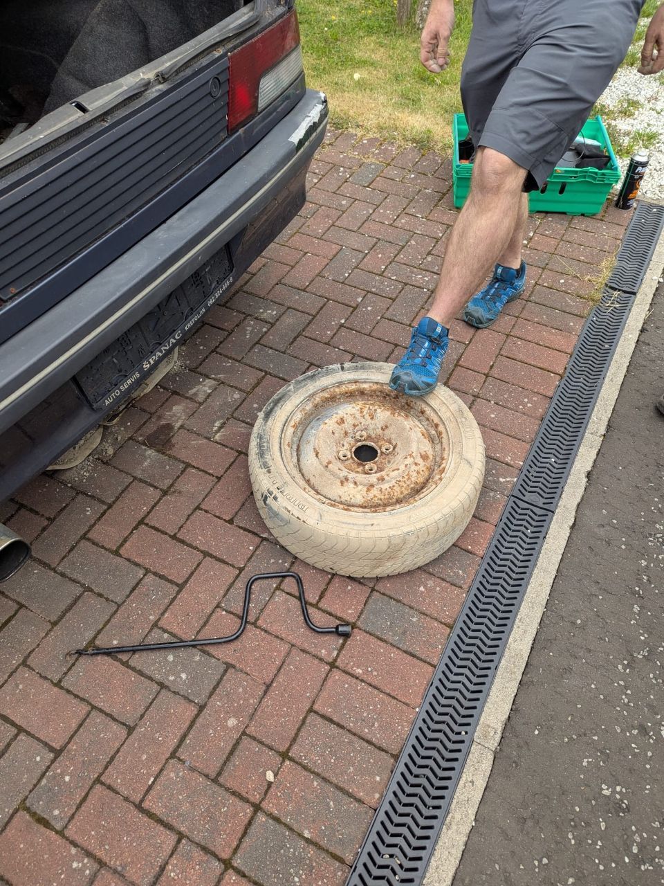

sdkrc Posted May 31, 2025 Author Posted May 31, 2025 5hrs of spark plugs in and out. Lots of lessons learned. A great day though It's achingly close to running. Hopefully just timing BONUS CONTENT: the 405 mi16 spare wheel appears to be an original Pirelli P600. Rock hard but only 3psi loserone, Supernaut, Matty and 11 others 14

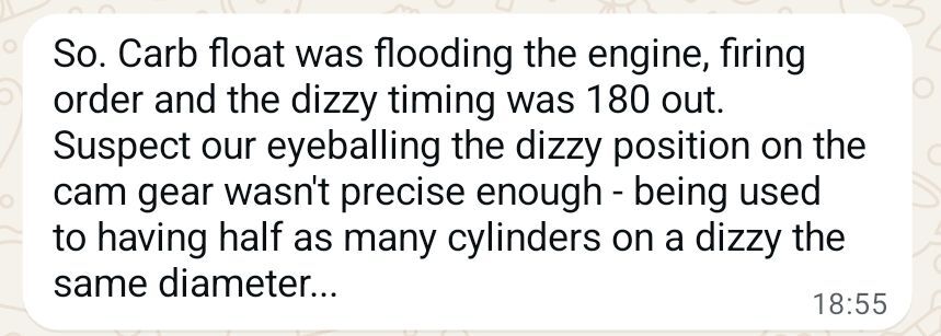

captain_70s Posted June 1, 2025 Posted June 1, 2025 So, in brief. Previously it'd run for 30 seconds or so on some cylinders and then piss fuel out of all the carb seals. A group tinkering sessions was arranged and we assembled to talk shit, eat sandwiches and fail to achieve much. Going in we had a few things that were seemingly known. Firing order correct, spark at all the HT leads, over 100psi of compression in all cylinders (wet), carb rebuilt. So a list was made, check valves weren't stuck, check all the plugs were firing, check ignition timing, make sure carb was doing carb stuff. Rocked cover removed, valves all moving, hydraulic lifters with no obvious adjustment but they had a tiny bit of clearance at full lift, so not hanging up a valve. Plugs all tested fine, carb was having issues in that it was dumping fuel into the cylinders. A bit of digging found a fiddly little spring clip on the float wasn't positioned correctly so the entire float assembly was lifting up allowing fuel to overfill the float bowl and force itself into the carb under pressure. Ignition timing initially seemed to be 180 degrees out, so the dizzy came out and was flipped. Now it just kept backfiring through the carb. Hm. Eventually we realised we had the firing order flipped, so we had the first plug on the right bank down as cylinder one, when it was actually the first plug on the left bank. FFS. Everything swapped around to the correct setup, dizzy back out. Cleaned the crank pulley, revealing the factory timing marks to ascertain whether the Tipex mark was indicating TDC or was a timing mark. Coughs splutters, still doesn't run... It was now time to pack up and head home armed with new information. It seems everything is largely working as it should but the ignition timing is incorrect. When we dropped the dizzy onto the cam sprocket we did it the way that works for old British 4-pots. Set engine to TDC on no.1, have the rotor arm pointing at the correct HT lead for cylinder 1, fine tune by spinning the dizzy body. In retrospect it seems obvious that the V8 has the same diameter dizzy cap but twice as many cylinders. So the spacing between cylinders will be much smaller and simply eyeballing the rotor arm probably isn't good enough and we were spinning the dizzy body far too far when moving the timing. It'd be very easy to end up firing the wrong cylinder on the intake stroke - Likely the cause of the backfiring through the carb. So, close but no cigar. But we all know a bit more about V8s and Motorcraft carbs and fingers crossed it'll be running at the next session. We did at least find where some of the fuel that was getting dumped had ignited... Dick Cheeseburger, Jim Bell, Rust Collector and 9 others 12
