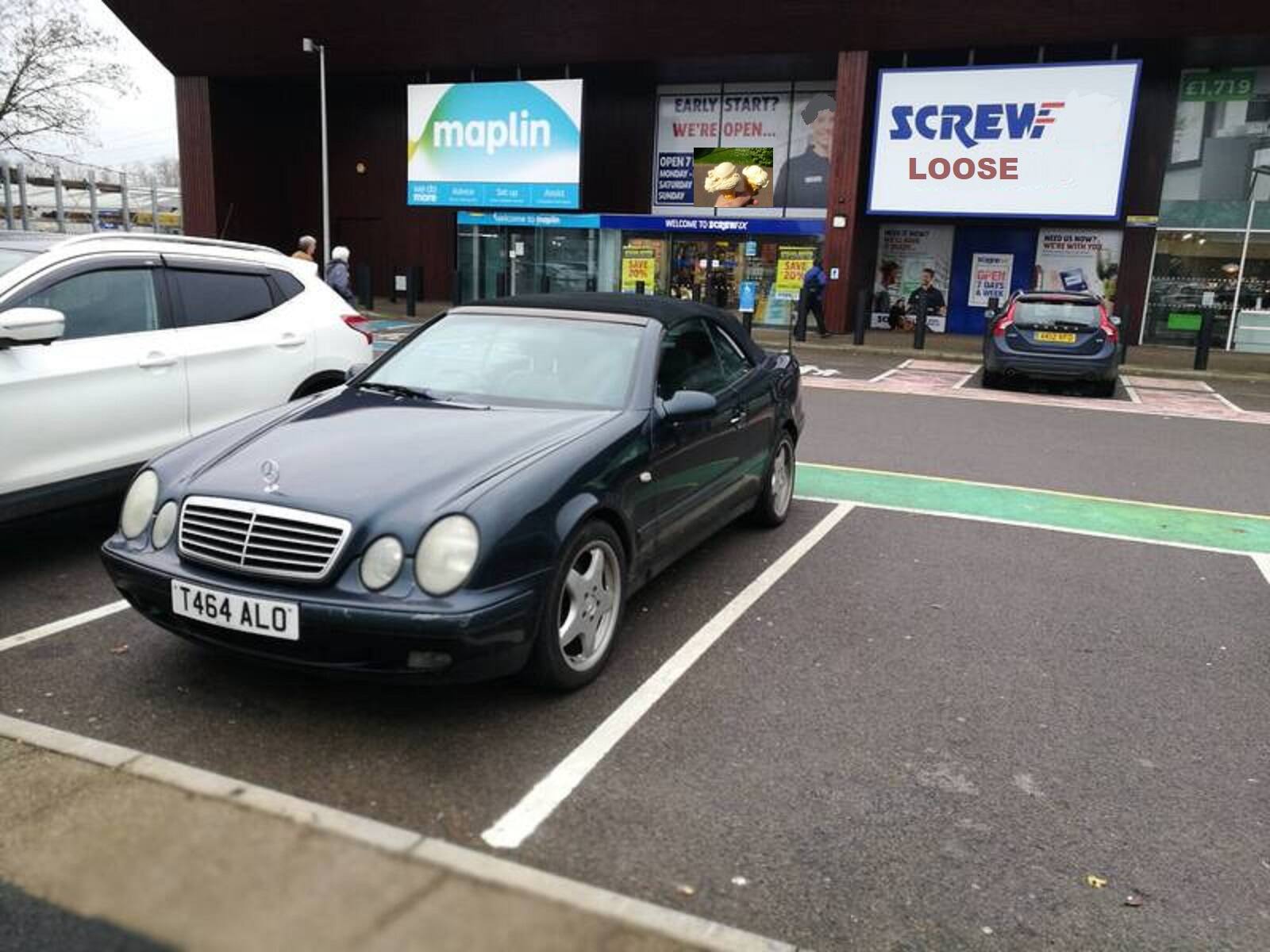

Hairnet has been dispatched to Manchester by train and I am home, the car looks great and drives very nicely.
I was just telling Mrs6C and she went outside and said why is there a strong smell of petrol and drips coming from the underside of the car. 10 miles before I had refuelled it, but this was the second time as we had already filled it in Tavistock and didn't have any smells then. I will leave it over night and check in the morning.
The purpose of the refill was to check fuel consumption, 8.55 gals for 237.7 miles = 27.8 mpg.
It appears to have cataracts, but looks tidy.

It does have some bubbles on the front arches but not bad by MB standards.
On my 2000 320 CLK the fuel lines rotted and leaked where the rear passenger footwell ended and the pipes did a 90 upward. I did a temporary bodge until I dropped the tank to do the brake pipes.

Congratulations on your purchase, as a long-term CLK owner I can confirm these are lovely (and extremely reliable) cruisers. These CLKs often leak petrol if overfilled beyond the first click. The hose to the petrol expansion tank often leaks due to wear, fairly simple job to replace, I suspect that's the issue here. Fuel economy can get up to the upper 30's on a run if everything is in order. Plugs take (for me anyway) a few hours to replace, but newer plugs = way better economy, emissions fails on MOT are often due to plugs too. Once in a while they deserve some premium petrol, and MPG goes down quite a bit if tyre pressures aren't perfect. If you're thinking of a long-term relationship I recommend removing the sill covers, can hide all kind of horrors that are best sorted asap, ditto inner wings. Gearbox fluid & filter change is simple DIY too and well worth it. Any issues or questions please feel free to drop me a line anytime. Pic of mine attached.

Nice facelift you have! My old one (6cyls new one ) is a prefacelift elegance and doesn’t have the dreaded sill bodycladding, had a recent gearbox oil and filter and also had the dreaded leaky gearbox pilot bush replaced (worth checking if yours is a 722.6 auto which it must be as the 320 was only available in auto guise)

I haven’t had it do it on this one- but it did do it on my old 320 cabrio- easy job remove the OSR wheelarch liner and the breather pipes (rubber rather than metal thankfully) are there, some generic hose of a similar dimension can be substituted, cost me a fiver if memory serves.

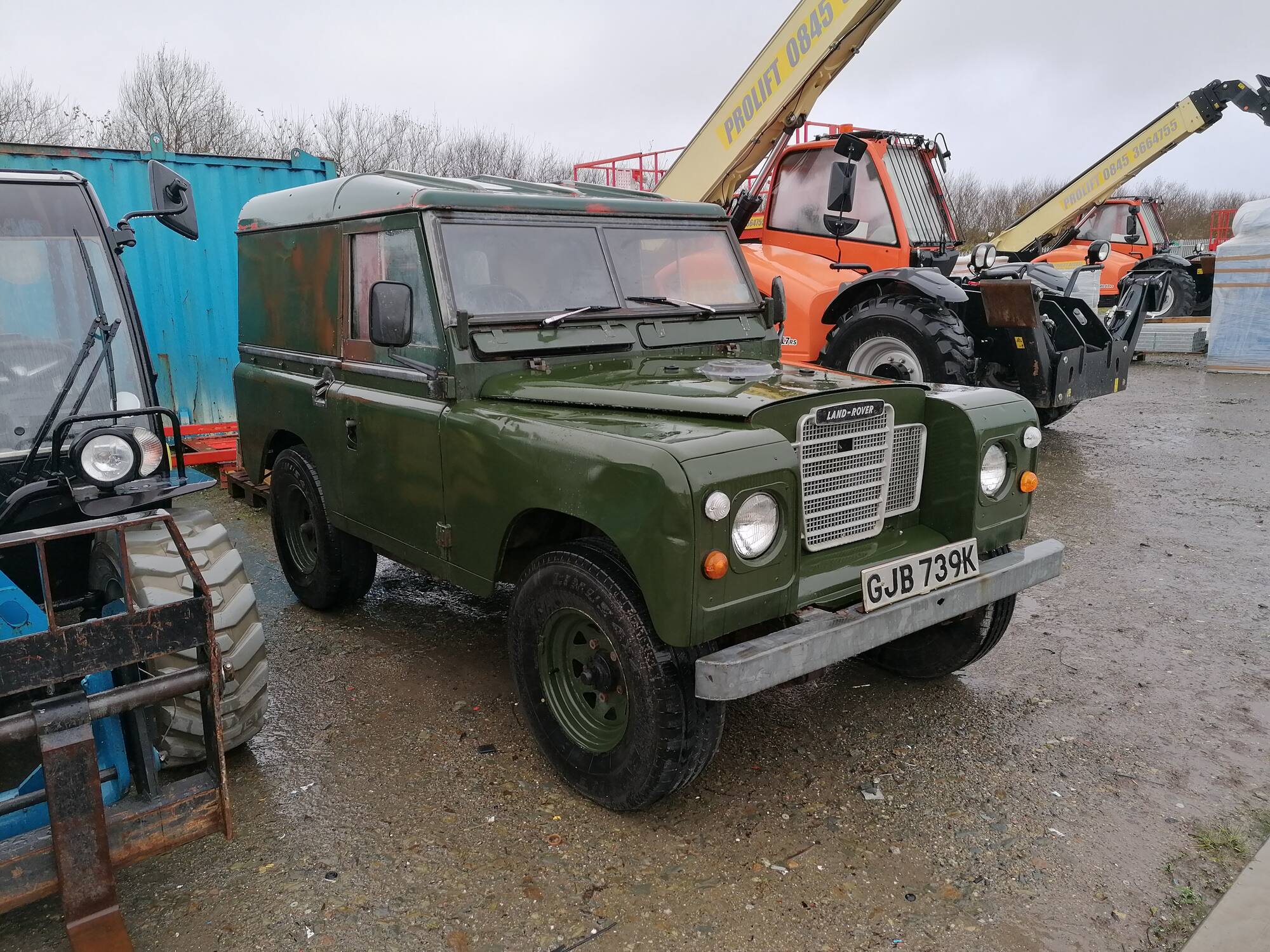

Just for you x, I would have taken it sooner if the Land Rover wasn't at work awaiting yet more repairs
