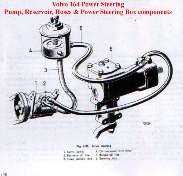

Never noticed that...! Ref box.....previous owner re-built it, and reckons that he put one of the seals in the wrong way......they are notorious for leaking, but re-building them is tricky. They usually leak because the main scroll shaft wears out. They are s stupidly complicated [what a surprise!] system
Transit mk1 steering box + Corsa leccie/load sensing PAS.
Job Jobbed :)
Job Jobbed :)

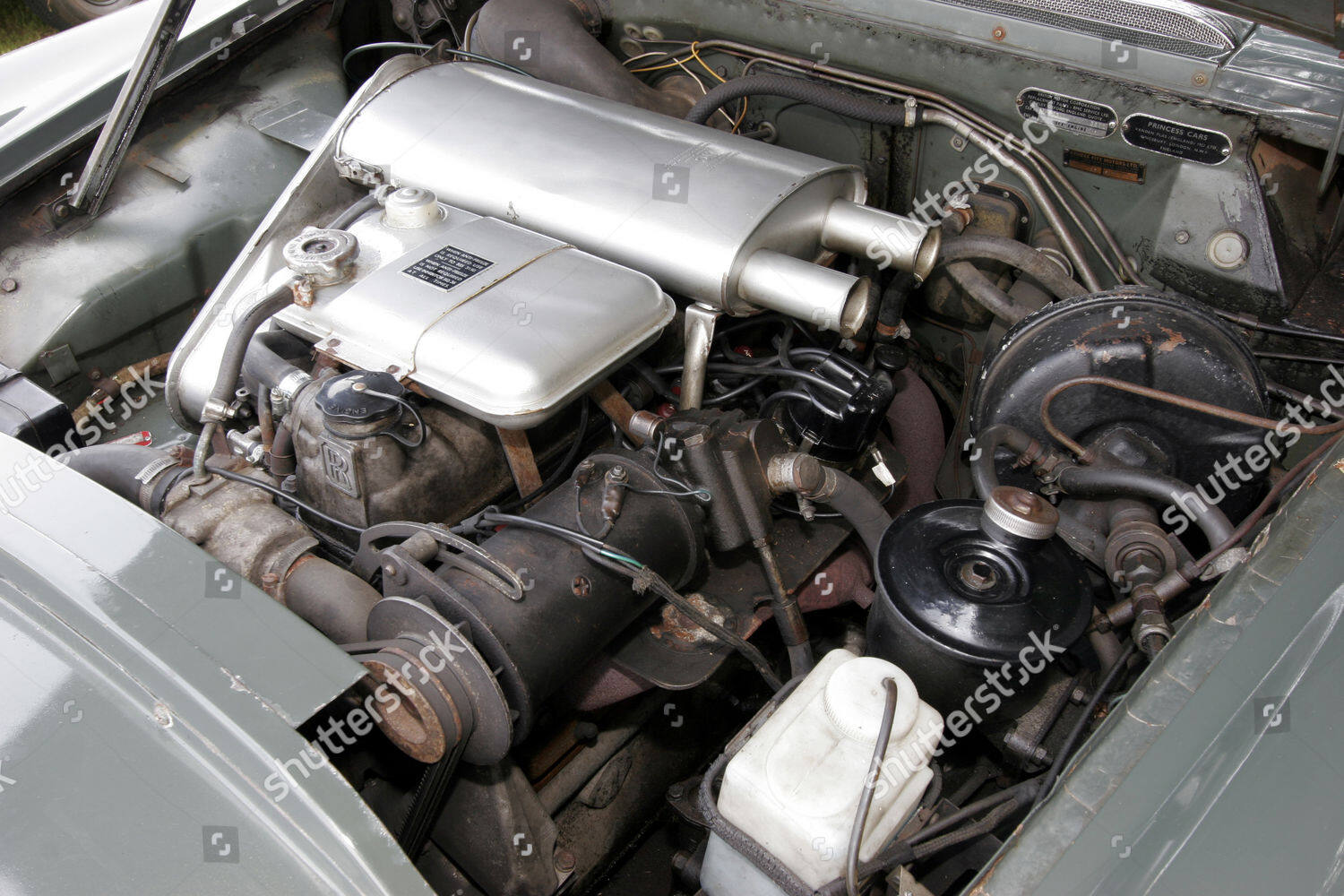

Keeping the box, but getting rid of all the existing power steering gubbins, then fitting what Mr Savvy suggests is looking increasingly tempting. .Slight complication is that the pump is not driven directly by a belt, [see diagram, Volvo 164 system is the same] So slightly more complicated than just removing the belt [as that drives the dynamo as well] Apparently a Volvo 164 pump can be made to fit with a bit of modification, but they're now extremely hard to find. Photo below shows that the PAS pump is driven off the back of the dynamo!
The VW boys with T3's use the Corsa power steering a fair bit, but I'm always a bit wary about the cutting and welding of steering column stuff that is required with that sort of setup usually.
A common upgrade on talbot express based campers too, the variable assistance kits work really well.
