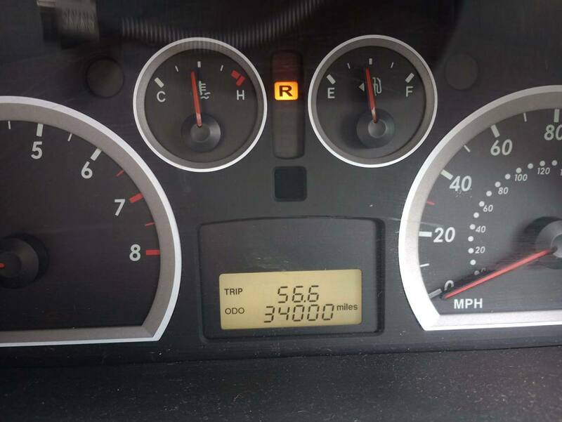

Minor achievement - the Santa Fe passed 34000 miles the other day, apparantly whilst going backwards!
Yes, thats 34,000 miles for a car which is 16 years old so just over 2000 miles a year. But 7 years of that it didn't move and then we had 2 covid years. I'm putting the miles on it now, easily 100+ miles a week. It is still running great and is a very relaxed crusier.
