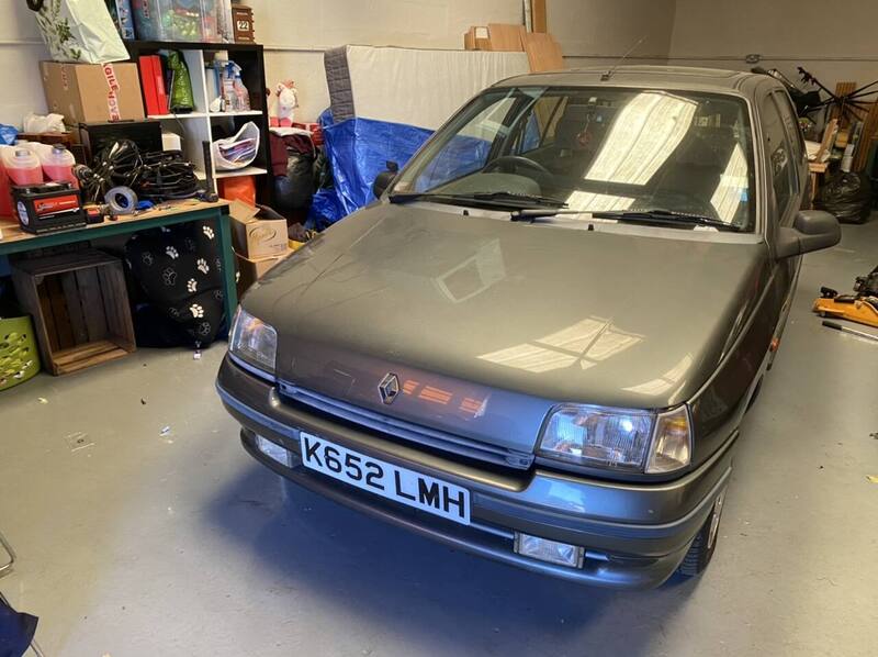

Kiltox Posted April 18, 2020 Author Posted April 18, 2020 Still got this. Still utterly stumped as to what’s wrong with it. Look at it, though, scrapping it would be like kicking a puppy! Split_Pin, Skizzer, loserone and 7 others 10
