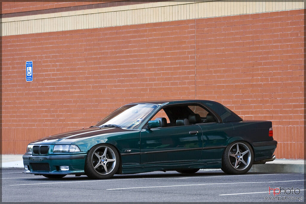

E36 is best open!
26 minutes ago, Six-cylinder said:
E36 is best open!

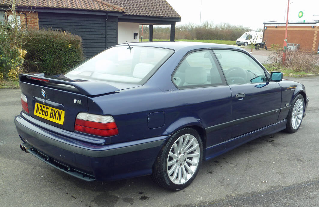

1 hour ago, yes oui si said:
No No NO
Best to get a coupe if you want a solid roof.

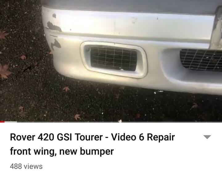

Bit of a random one but what happened to the omghgf rover? I was watching nitrosilvia on you tube (also on retrorides with the sd1 police car)  did it become bean tins?
He's got a replacement bumper for his rover and it looks the same colour and had the chicken wire in the grills on the bumper.
Currently in the custody of Craig Cheetham (Retro cars editor) waiting for it's turn to be given some attention.

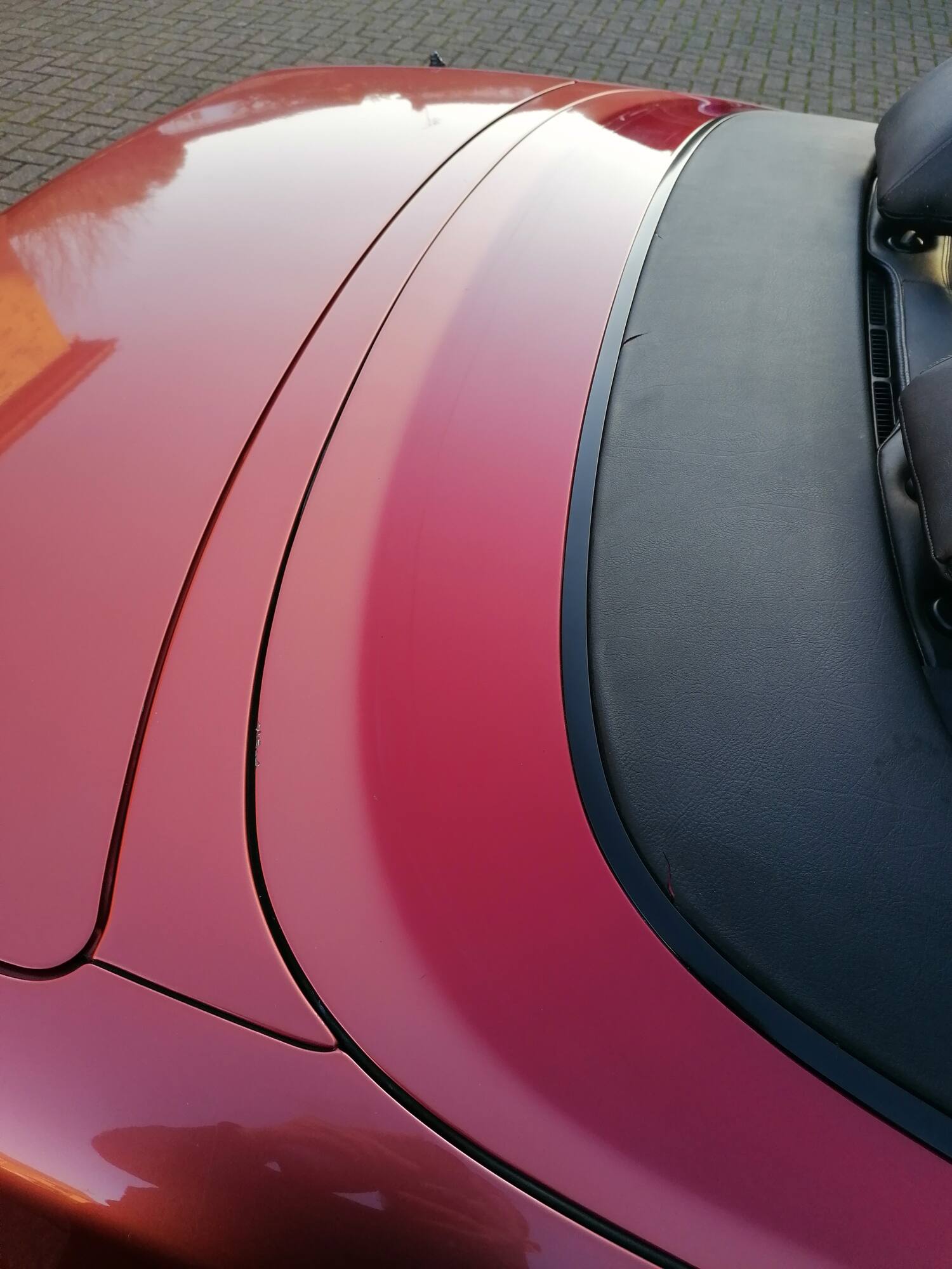

Did a bit of cleaning of the roof, it was covered in white fluff.
Also tried to clean the mucky line where the roof meets the body. Look at the colour fade!
11 minutes ago, Wingz123 said:
Lint roller and one of those autoglym hood cleaner packs is what u want
Lint roller was ineffective, had better results with a lint brush.
