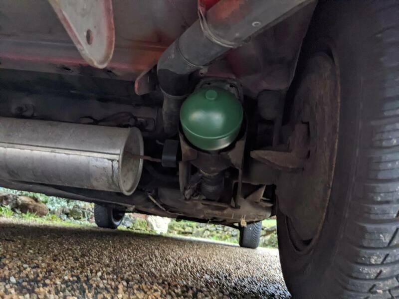

The rest of the work included replacing the rotten fuel return hardline with the big job being fixing the suspension goofyiness once and for all.
I now haz new grenadez-
The dark patch on the fuel filler hose suggests the old spheres were blown like I suspected. It now feels so good to drive, like, no longer stiff and weird-feeling, which is nice 😉

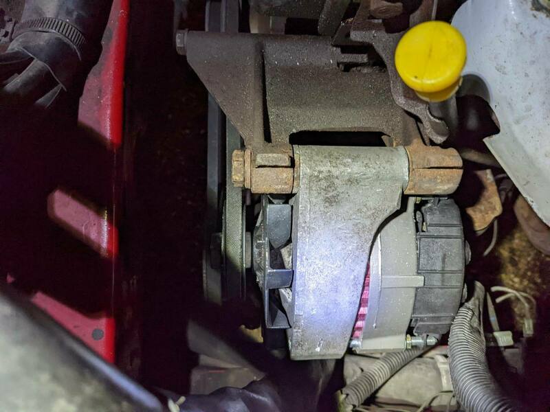

I arrived home at 15:15, weary but pleased I got back. So naturally I then embarked on changing the alternator. Easy job..... right?!
It all started so well... I firstly went about loosening the wrong tensioner bolt
...this one's the locking bolt for the hydraulic pump. I found out after I tried to push the altenator down and off for 5 minutes.

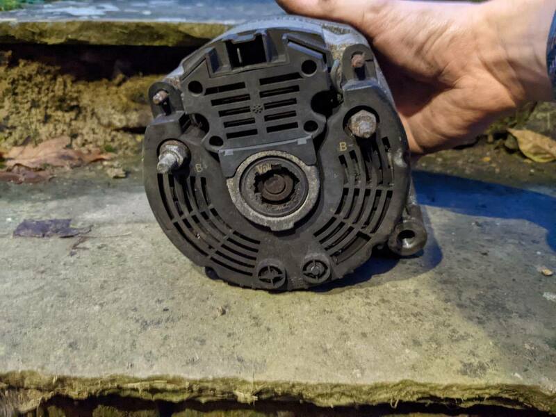

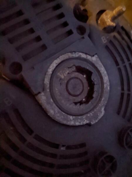

So that was a good start. Then, when I took the old alternator out of the vehicle, I discovered it was absolutely pooched.
PXL_20211220_162340984_MP.thumb.jpg.a492a7758873af0e4ddc4b739696bcab.jpgPXL_20211220_162356620_MP.thumb.jpg.d0c1b762379dfefb95d0c38e70f1e524.jpg
So that's not going back in again. The rear bearing was dry as a bone. The front bearings on these are sealed but the rears are just normal unsealed ball bearings with a plastic grease cap over them. As you can see, this one had the cap busted off.  I wonder if  the bearing started rumbling or something and someone attempted to repack it with perhaps the wrong grease. This was futile as A. the grease would have been flung out owing to a lack of grease cap and B. this side is right next to the hot exhaust manifold, so the grease would have evaporated if it were the wrong type.
By this time it was 15:50 thereabouts and light was fading fast. "Better get the fresh new alternator in!"
Oh. I can't. Alright then, Lucas, you win for a second time.
This is on the fecking compatability label on the damn box.
Does it fit? Does it fuck.
Here's the issue. The alternator I've got will fit on a Suitcase engine, but, for some strange reason, they also claim it'll fit on a TU... either that or Lucas engineers thought the 1.4 BX used the Suitcase engine throughout its production run. I didn't take a side-by-side picture of the two (and I wish I did but oh well) but not only is the hole for the hinge bolt lacking in width (so it flaps around when bolted in), the hinge bolt hole is on the opposite side to the old alternator, so it won't fit in the first place! What a fantastic waste of my time.
Unlike the starter motor, which was cheaper and had no hopes of ever fitting, I noticed the actual alternator portions of both were the same, with both being made in France. So, instead of throwing in the towel, buying another (but correct!) alternator and living in misery, I threw caution to the wind and made a modernist art installation.
I crown thee: "Trust* Lucas"
Violence was used to get the front cover off the old alternator
Which involved cutting the alternator shaft, using a puller and other violent instruments. This part alone took about 1 hour. In just getting to this stage, I was whacking the thing, I sheared one of the bolts tieing the the alternator parts together... Basically it was a fight.
I then tried to remove the NOS bearing, firstly by hijacking the cooker so I could heat up the cover and not the bearing. This ultimately failed.

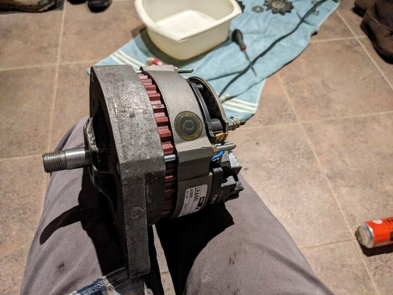

By contrast, I stripped down the new alternator in a fraction of the time. I then retreated into the warmth* of the porch which had a little more light than the Anglepoise lamp I was using:
PXL_20211220_193914520.thumb.jpg.b3b9b4e7ad042dfa99592a0e018fd275.jpgPXL_20211220_193919538.thumb.jpg.678fe32dbae34e9f6e12ef62672920c4.jpg
The good news was that the innards were well and truly identical, so that's a win. I cleaned up the alternator front plate and rotated the bearing a bit to see if it was as ruined at the rear one was. The good news is that it isn't, although there's radial play and it feels slightly gritty. I can try to replace it but I doubt there's much chance of it failing anytime soon. I iused an improvised parts heater to expand things a little, and the thing slid onto the new alternator like butter*. Well, more like a block of lard you've just taken out of the fridge.
Fast forward a few more minutes and there's this:

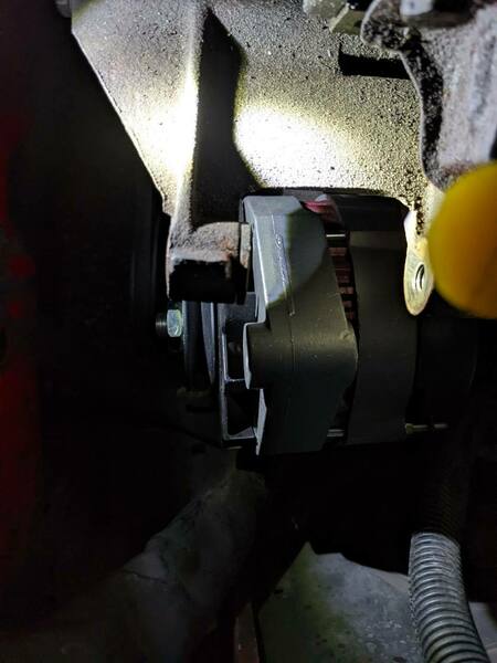

Good, good. Now, onto the slight* problem of fans and pulleys. Because I managed to cuntfuckulate the old one and couldn't reuse it. Yep, I bent one of the pulley sheeves and fucked the fan up completely. This is wonderful, because the new fan and pulley don't exactly work with the engine, either. Of course not, because fitting perfectly would be silly.
The old alternator fan and pulley arrangement consisted of washers, a spacer between the fan and pulley sheeves, and the sheeves themselves. Once you undo the bolt that secures everything in place, they all fall off the shaft in a confusing arrangement to ensure you'll never be able to reassemble them again. The pulley was seriously, seriously worn anyway, so even if I did use it, It'd still be having problems in the future. I discovered that the fan on the new alternator was plastic and the pulley was metal, so I inserted a screwdriver and *pop* they separated and flew across the room. Once I retrieved them, I then used a combination of old and new parts to get it roughly similar to the old one:
And a test fit on the car proved this would work. By this time it was well and truly dark and around 20:45. Oops. Now all would be well and good, but the shaft on the new alternator is shorter than the old one, and as it happens I've destroyed the old one and canae use it. Because of the new spacer, the pulley was resting on the threads instead of the shaft, so it was able to wiggle side to side. Bad. Very bad. So I did the right thing and made a shim out of a coke can I cound in the bin:
And after 3* attempts (well, maybe 5 but I've forgotten) it was just about ready to put on the car. I tightened down the pulley bolt and washer, made sure everything still spins correctly, and bunged it in the car.
...with the usual tensioning nightmares because the belt is the wrong size. Even though it looks old it isn't cracking and isn't too glazed, so I left it be. I do have a replacement in my parts stash. The glazing may disappear now that a new pulley is being used.

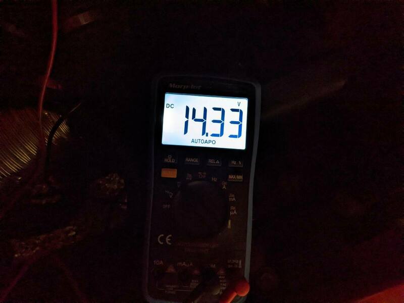

With fingers and toes crossed, I started the car, put the headlamps on and held the revs at 3000-
We has an victoree.

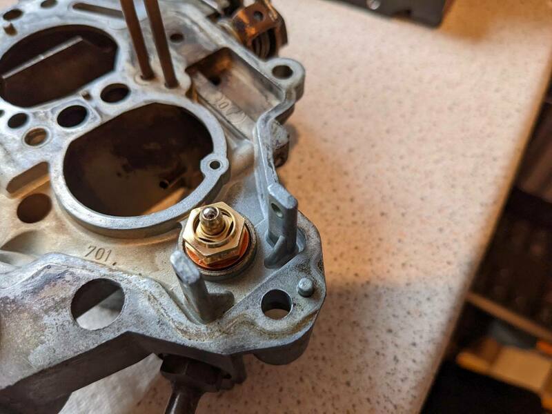

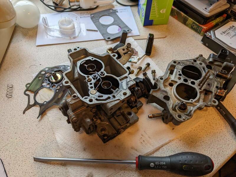

Yesterday's surgery.
PXL_20211221_131330263.thumb.jpg.5c696f9d7551f53d0ba2017b0d151323.jpgPXL_20211221_140411364.thumb.jpg.58f9ff5a3b48900f8bc3926975119430.jpg
PXL_20211221_133002683.thumb.jpg.57ed08a2c102f3be50be703bf9531332.jpgPXL_20211221_131708992.thumb.jpg.30836f6e6266a4a01b288b0a34745c53.jpg
Work included:
  • Replace split and broken lid gasket
  • Replace idle jet O ring
  • Replace power valve diaphragm and spring
  • Replace accelerator pump diaphragm
  • Replace needle valve and washer
  • Replace the carb-manifold gasket
I've still yet to find where the choke pulldown diaphragm connects to. The vacuum port to the rear does the vacuum advance on the distributor. The port on the front is blanked off at the mo because its opening is directly below the second barrel's butterfly. I've found few images of this carburettor with the same arrangement, and Weber state it's an emmissions thing on their versions, so it has me stumped. When I had the vac advance connected there, it did nothing and the car ran really lean. I may leave it blanked and tee into the vacuum advance line instead.
Functionally the car works fine with the pulldown disconnected, but it means I can't use anything more than half choke so I have to leave the car to warm up a bit before I drive. Any ideas on how I should get it reconnected? I can't find a diagram for it anywhere either, which is annoying.

  1. Fitted the new new new boot strut so I have a matching pair working in perfect* harmony
  2. Dialled the fast idle back

  4. Measured up the correct alternator
