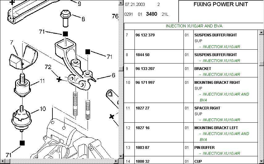

In other news, the engine mount is swapped, but ..... f47422735ba8c1b871df4d5f338967e5.thumb.jpeg.7c25c794fa885fc59fad37bec0b72b43.jpeg
Part number 7 (96 132 379) suspension buffer has took a fair beating with the collapsed mount and needs to be replaced.
Citroen want £28 and a 4 day wait .. currently sourcing elsewhere if possible.

Today a bad thing happened ....
That used to be the top part of the right hand side engine mount!
Problem now is that Citroen have discontinued this part and while I have found one for sale it will be above a week.
So my mate has made a temporary item...
And it's all because of this ..
Many hhhhhhhhhh but she battles on.

Stroke of luck this evening.
I managed to find the remains of a 405 1.9td being broken in Leeds . Although the engine had sold long ago, he kept back the top mount and suspension buffer!
£28 and a trip to Leeds later and she was all fixerated at the roadside. The guy I bought the parts from even helped.
