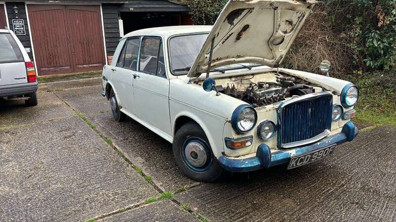

I managed to pick up a VP too:
The blued chrome is certainly interesting!
  • Agree 1
20 minutes ago, sharley17194 said:
Autos really hate dirty oil, so flush it a few times before you ruin the box.
Will change again in the not too distant future, I know @Sigmund Fraud changed it when he had it, and I've changed it twice now so its not running on really old stuff. will change it again in roughly 250 ish miles.
Well, when Auto$hiters go magnet fishing...
Has it GOT bumpers .. Yo✔️
..... great catch 😉
the blue chrome is grease, apparently its old school to stop pitting, its just a twat to get off.
Brighton reg, a Wadham Stringer car? Hope the inner sills are ok.

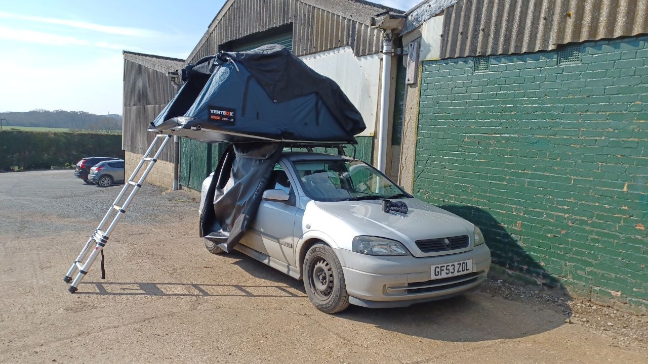

Once they were done I rang a campsite, chucked the rooftent on and pissed of to glastonbury for the night. Because why not.
Campsites not the usual old scruffy field type that I like but most are closed till April so this will have to do. Its nice but 35quid for the nights a bit pricey!
