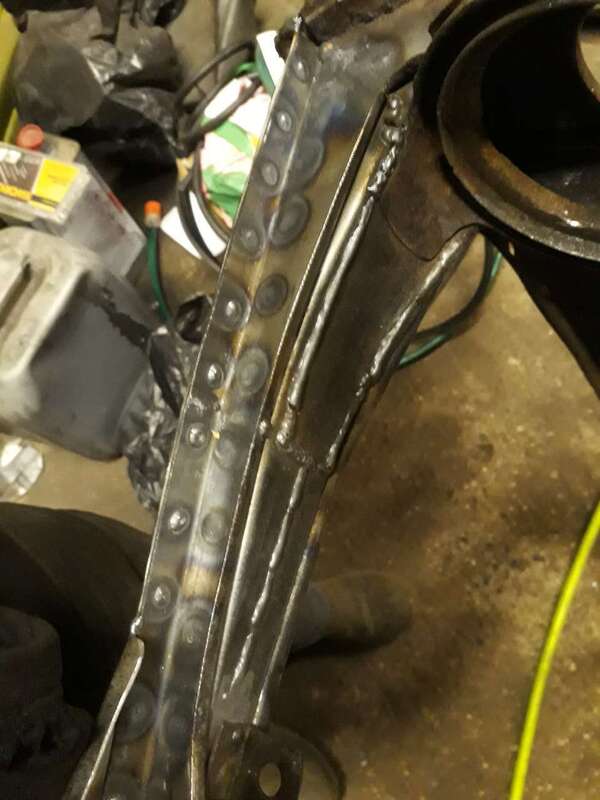

Final step is to repair the bit in between, below the displacer. The sides have gone and i kept it in for reference for the bits mounting to it. Going to be a fiddle but that will be the final panel to make then its done.
Weld-done, just needs dressing back and some holes drilling in, then its time for some rust converter and paint.  Im fairly happy with the results.

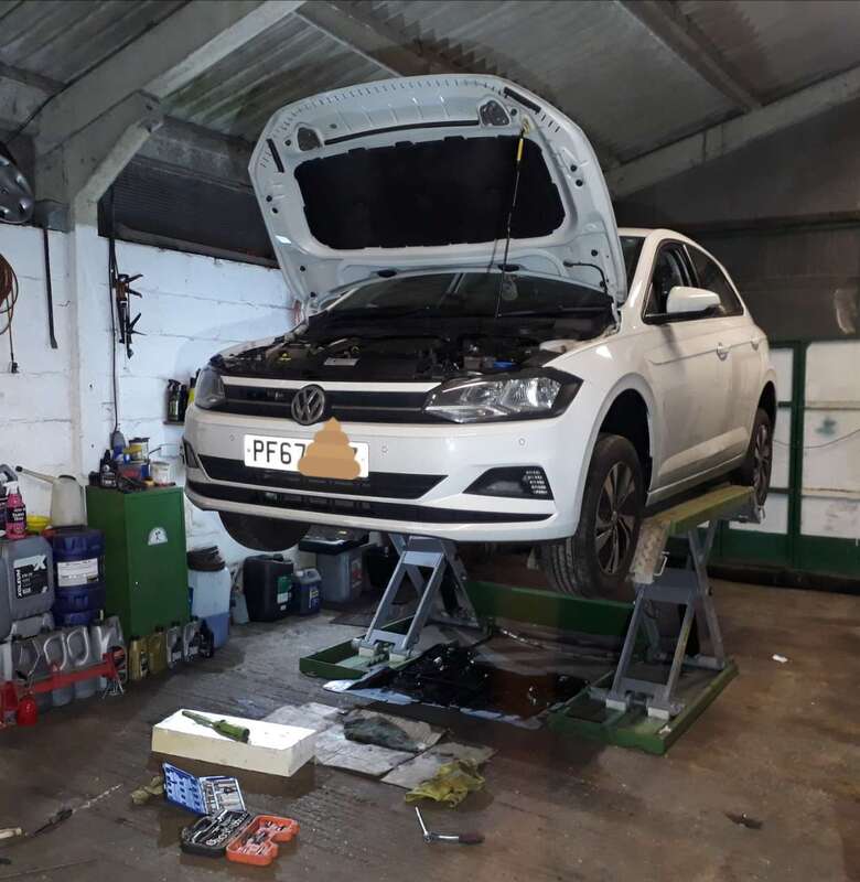

Handily the car was not far from the workshop and my mate swang by and grabbed an old bottle of oil that was close enough spec and off to go find the car.  Half hour later the car arrives at the workshop leaving a  trail of oil.  Didnt sound fucked now it has oil so hopefully its survived.
After a quick chat about servicing and Guessing the car hadnt been serviced in a long time my prediction of a rotten oil filter being the problem was spot on.
The whole underside of the car was dripping, even the back axle was coated. The car was purchased used at 8k miles and wouldnt have been due its first service then and hasnt been touched since. So that oil and filter had done 67k miles since 2017 when the car was new.
With no parts to hand the car was left on the lift for the night ready for parts the next day. New filter and fresh oil chucked in with the plan to change again in 1k miles ish. Sounded fine but i advised that fucking it off sooner rather than later wouldnt be a bad idea as id say thats shortened its life span by a few years.

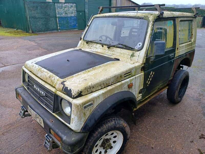

Anyways, when the VP1500 left my old tin top samurai returned and lets just say its not looking great having sat in a field for years. It didn't look great after it left here to go to the field. It was previously rotten and mildly vandalised when it left and any modifications were just chucked on so they weren't on shelves or the floor. No time to address the rot at the moment but let's just get it running and driving so it's not another immobile pain in the arse.

A friend joined me at the workshop and we decided to see if the old shed would fire up. Plugs out and a we bit of wd40 down just to be nice, turned freely by hand. Plugs back in, booster pack and some easy start and fired straight up. Starter made some awful noises but it was running nicely. These g13s are impressively quiet running.
Jerry can rigged up and some other make do fixes and with the idle getting stuck at 2500 rpm, and no foot or handbrake we limped it into the workshop.
Thankfully this has a modified crawler or 'rocklobster'  transfer box made for a sj413 and sj410 case combined. so low range is properly low rather than the normal ratio so it can creep in and up things slowly.
