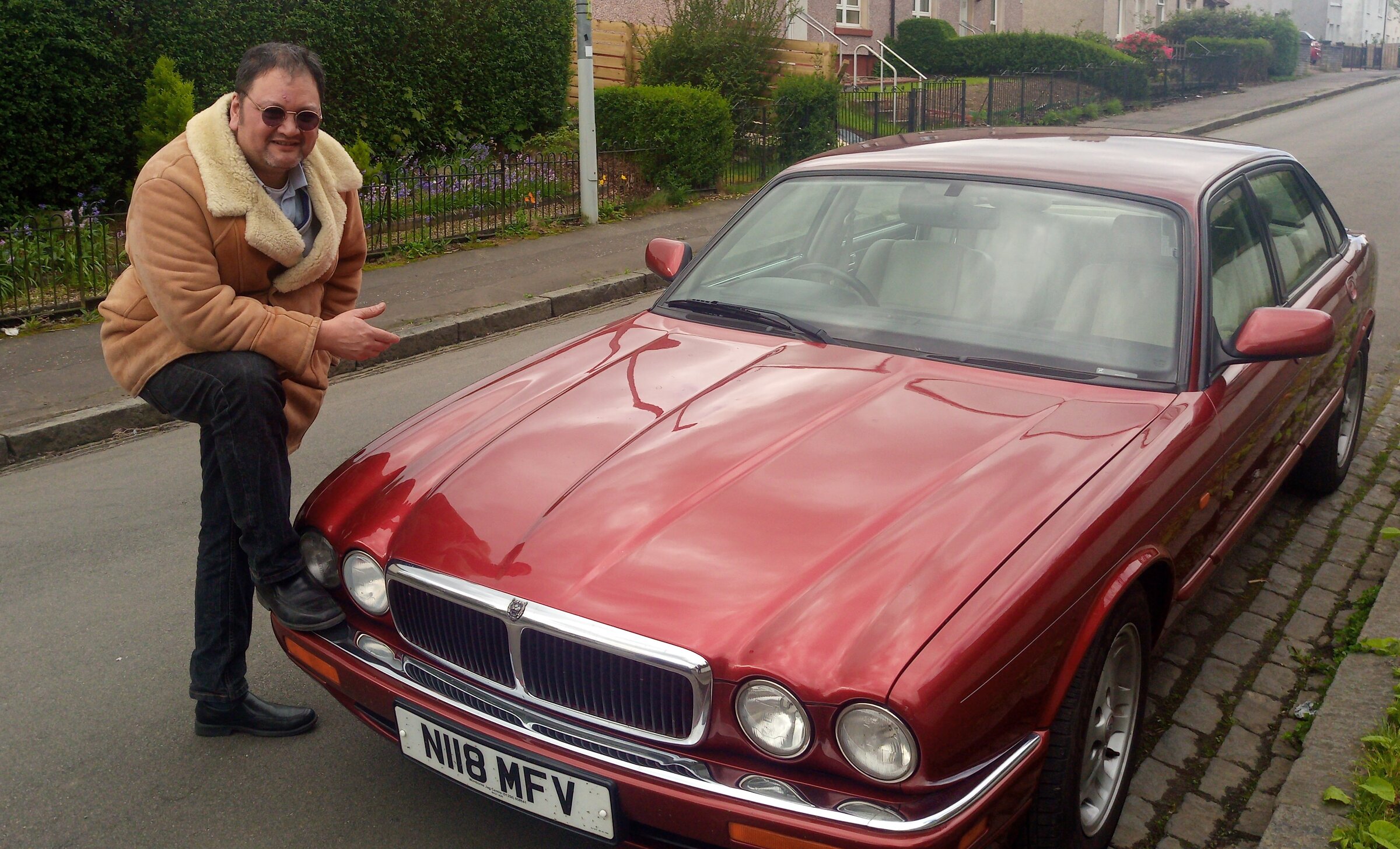

Yes. Back in Scotland. I'll be a spit of where it was last MoT'd tomorrow as I'll be in Arbroath for the footie.
Loving the Jag and the coat. I'd love to own a jag somewhen. Good luck with it love the colour
