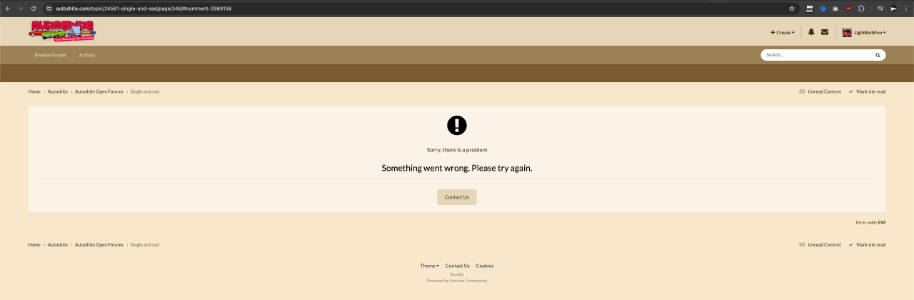

LightBulbFun Posted March 18, 2024 Posted March 18, 2024 around 5:42 and 30 seconds, I clicked on the single and sad thread and it broke then rather ironically, as I clicked on this thread around 5:43 and 40 seconds or so, it also broke LOL I find it very Autoshite how it broke trying to load the bug reporting thread AnnoyingPentium 1
Supernaut Posted March 18, 2024 Posted March 18, 2024 Yup. I'm getting lots of "sorry something went wrong" errors too. It's taking a couple of tries to get into any thread, including this one.
Saabnut Posted March 18, 2024 Posted March 18, 2024 Almost every thread comes up with the error message for me, but a single hit on the refresh button and all is fine. Edge on a laptop if you need that info
SiC Posted March 18, 2024 Posted March 18, 2024 For some inexplicable reason, the forum software decided to revert to the old search server password. Despite that no one changing that setting. I've reverted it back to the correct new setting. Hopefully its set as I'm on the train and on mobile. Seems to have got rid of the errors for me though. Smells like a bug in the forum software. If it does it again, I'll have to file a bug report. Saabnut, Sunny Jim and egg 3

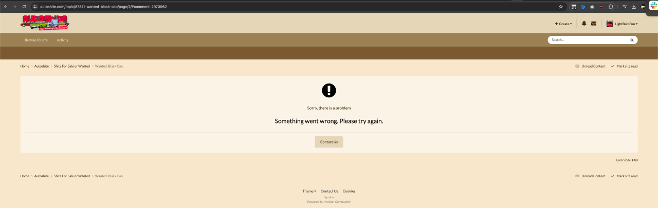

LightBulbFun Posted March 20, 2024 Posted March 20, 2024 On 20/03/2024 at 17:48, SiC said: Index rebuilt. I'm seeing some new errors appearing occasionally in the logs but not sure if they're appearing to users (i.e. it retries and succeeds). Last one I saw was at 17:29 and was when @MiniMinorMk3 was accessing a page. Did you see any errors when that occurred @MiniMinorMk3 (or anyone else today)? Expand it broke for me just now accessing a notification on the wanted black cab thread 8:24:10 and also just now trying to get to this thread at 8:24:35 or there abouts Remspoor 1
