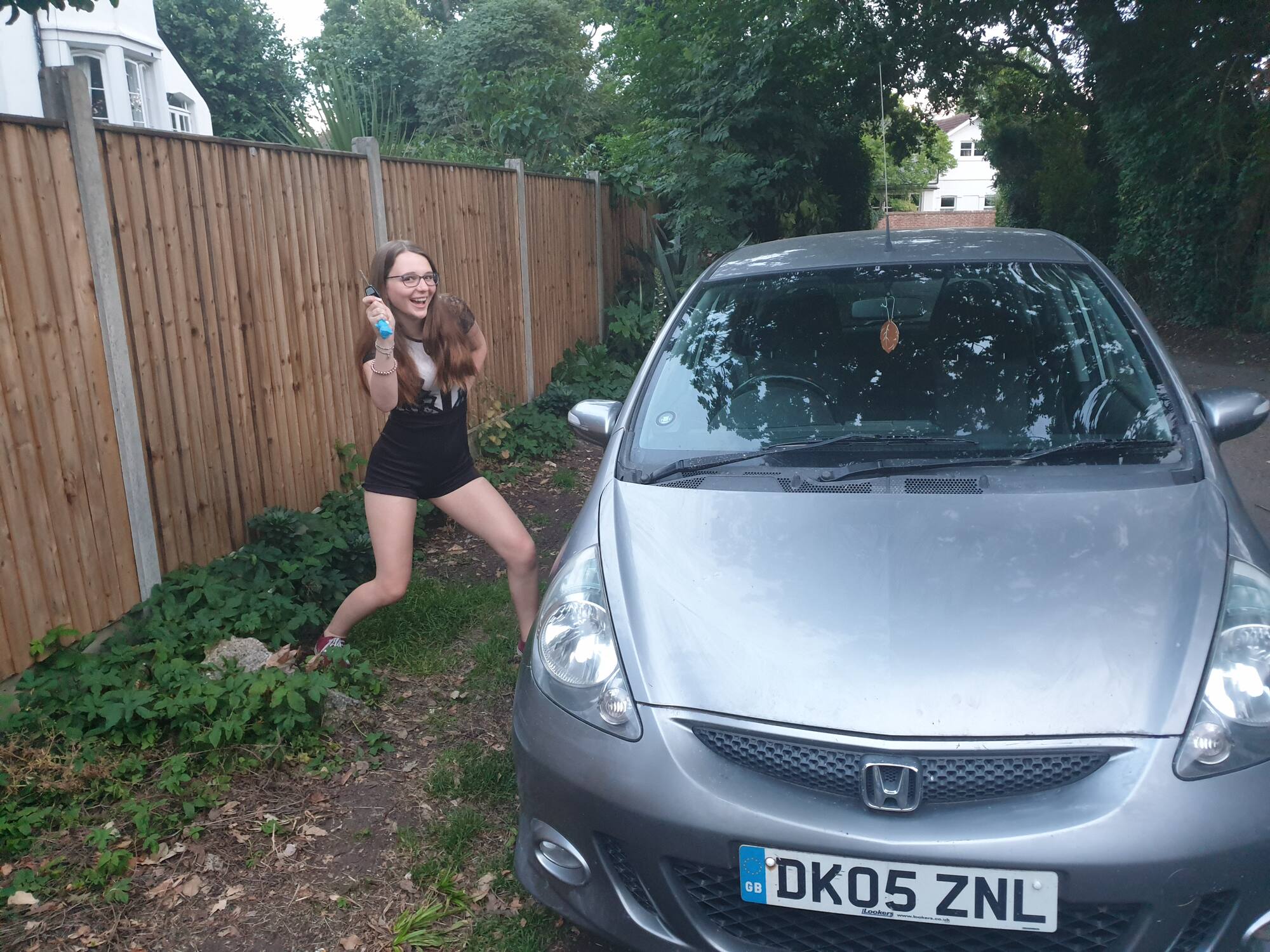

Slartibartfast Posted July 19, 2020 Author Posted July 19, 2020 Update, since it's been a while. I ran out of time to do the work to get her through the MOT myself, mainly due to an unexpected house move. So I ended up paying a mechanic to do it. It was Not Cheap. He ran new brake lines front to back and replaced the exhaust and cat. Then later on the infamous EGR valve issue presented itself (and may have been responsible for the poor performance Dave experienced). Since then Nina (as my daughter named her) has motored along no bother. I occasionally get to drive her and she is an absolute hoot. Unfortunately daughter has a black box so I have to behave. Today I replaced the rear drivers side light cluster due to an unfortunate reversing incident. Dave_Q, theshadow and Asimo 3
