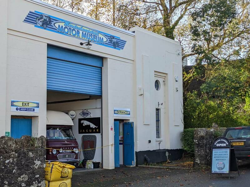

The trimmer was down in Devon, so gave me a chance to visit Moretonhampstead Motor Museum that I've been wanting to go for a while. Last week it's open this year.
  • SiC changed the title to 2000 Porsche Boxster - Hood Split and Moretonhampstead Motor Museum Visit
So Moretonhampstead Motor Museum. I believe a previous Shitfest visit before my time on here. Anyway I had a good time wandering around, even if it wasn't particularly large.
Massive bunch of photos in whatever order gets decides to upload them.
