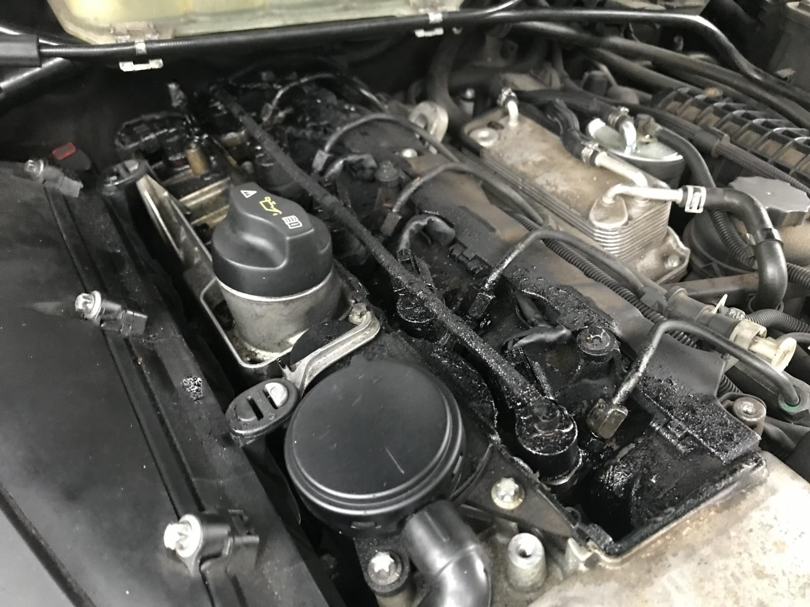

vaughant Posted January 30, 2019 Posted January 30, 2019 Someone's got a barg and I hope you're mate gets to spend the cash as he wants it due to his current situation. Looking at that so called repair, I'd say there's no way those injectors have been taken out and re-seated and if so, why the hell didn't the mechanic clean the carbon from that area first? Anyway, that will NOT affect the starting, mine had proper black death on it for years after getting the seats done for a 3rd time and in the end I just couldn't be arsed but despite that, it never affected the starting. It will most likely be the small "o" ring seals that are all around the clear diesel pipes in the engine bay(about £10 for 10 from Merc themselves) None are really hard to replace and a quick test is to get it started then turn it so the nose is pointing downhill overnight. Go out in the morning and there'll be a good chance it well start instantly and run fine. Mine certainly did!!! Another common failure are those electrical connectors that go to the injectors, if anyone of those is loose or comes off, it cuts the engine or straight away and no offence to the mechanic that did the work, but if he's happy to hand a car back with the injectors in that state, then I doubt if he's going to give a shit if he's cracked an injector connection or chaffed the loom. If these ever go down on power/bad economy, disconnect the exhaust after the turbo (really easy to do, one big clamp and then the cat can be moved back) and take it for a spin, it feels like a totally different car. Good chance that both cats have failed, the front fails and the bits get shoved into the rear cat blocking everything up. Best thing I did too mine was gut them both. Never caused any MOT issues as you can't see them when they're done. This one sounds a good one though because you can get top gear on it, I couldn't until I binned the cats on mine!!!! Just a few tips for the new owner. Despite what the internet tells you these are damn fine motors and that looks in brilliant condition. skattrd, The Old Bloke Next Door, oldcars and 7 others 10
