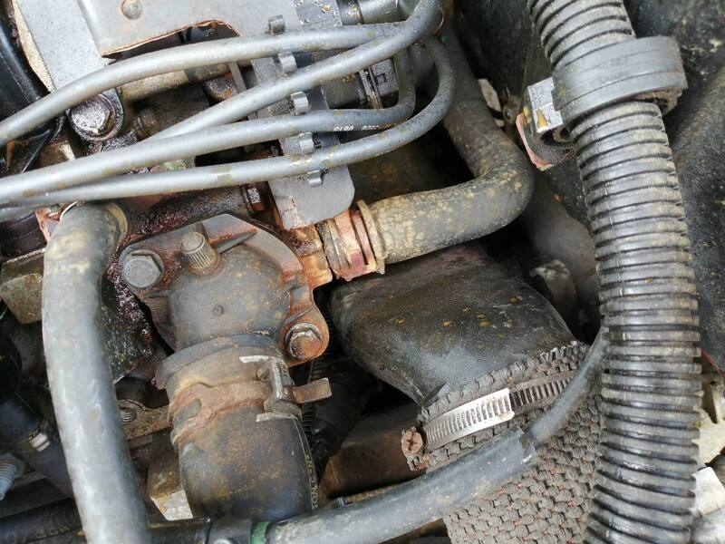

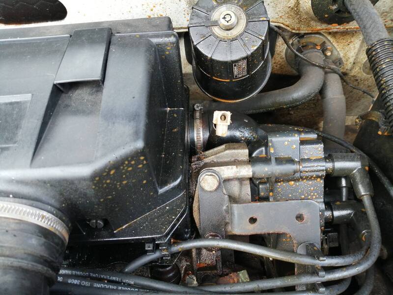

Took the 405 out to do a few jobs today.
Sexy rake.
It's still not dropped any coolant so I gave it a bit thrash on the short run home.
Hmmmmmmmmm.
Ah.
Red light indicates danger.
It's shooting out steamspunk (TM) from here.
And splashing it all around here.
Which is a shame.
It's still a lovely place to sit while you're waiting for it to cool down.
And it still hasn't dropped anything on the ground.
Old cars eh?
Think it's time for another Yaris.
That's a good idea.
Ah fuck chap, thon is an pizzor.
Wonder what's causing it?
Looks like it's coming from the thermostat/housing? Maybe it's stuck shut (Although that would be unusual TBF)
EDIT to say hopefully just a blocked rad or stuck thermostat, either of those would be an easy fix I'd imagine...
There won't be water on the ground, it's all steam in the air.
My moneys on the themostat, chuck it away (thermostat not car).
edit, put a new jubilee clip on the heater hose as well.
If it is the stat, don't be tempted to replace it with a Circoli one from ECP . Ask me how I know.

I'd remove the thermostat and not put one back until winter, and then only use a genuine one.
You hate to see it. That sucks. Maybe you would like a very scruffy 205 diesel that doesn't have a coolant temperature gauge so no worries at all.
Is it a three door no sunroof?
4 hours ago, Jim Bell said:
From the vid it looks like it's coming out the hose running left to right in this picture near the clamp. Can you take the hose off and see if there's a hole?
I'd maybe remove the thermostat too and test it/run the car without it in case that's part of the problem?
Another vote for running the car without a 'stat!
It looks very easy to get at and and would cost £0.

Let's have a look then.
Crosses fingers.
Oh well. Was worth a go.
Seems like the housing or hose is split bad as liquid is running out of there now.
