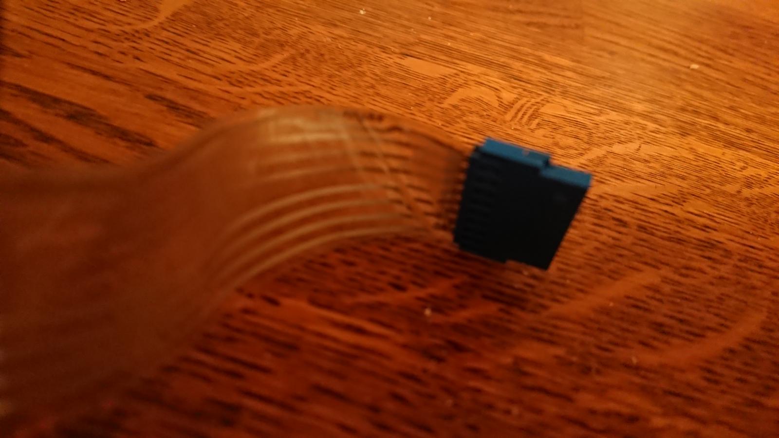

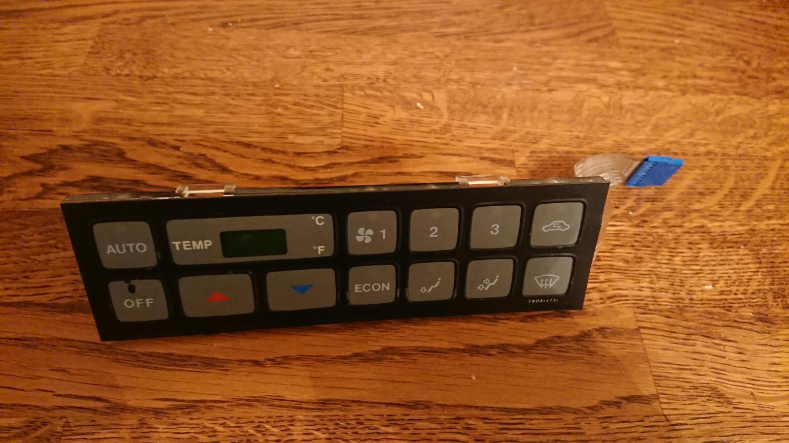

I've been in garage last night trying to sort out why the blowers arnt working, it looks like it's the face plate that has solder issues, I'm going to try repair it today
You've got to love them don't you. We can't even get a fuseboard right so let's press on and make a touch sensitive control panel for the heater.
