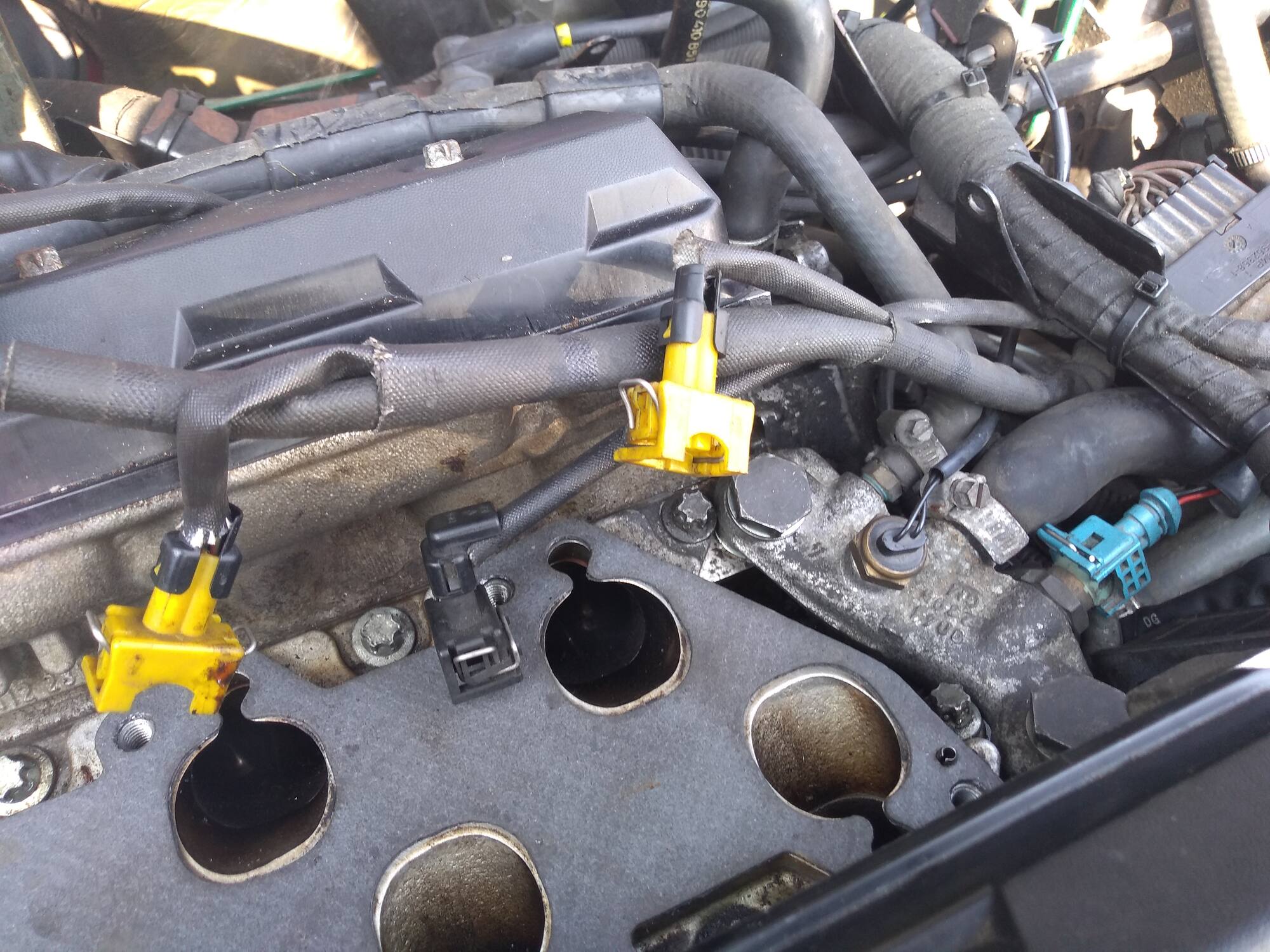

Our lovely neighbour has lent me the sockets so more dismantling...

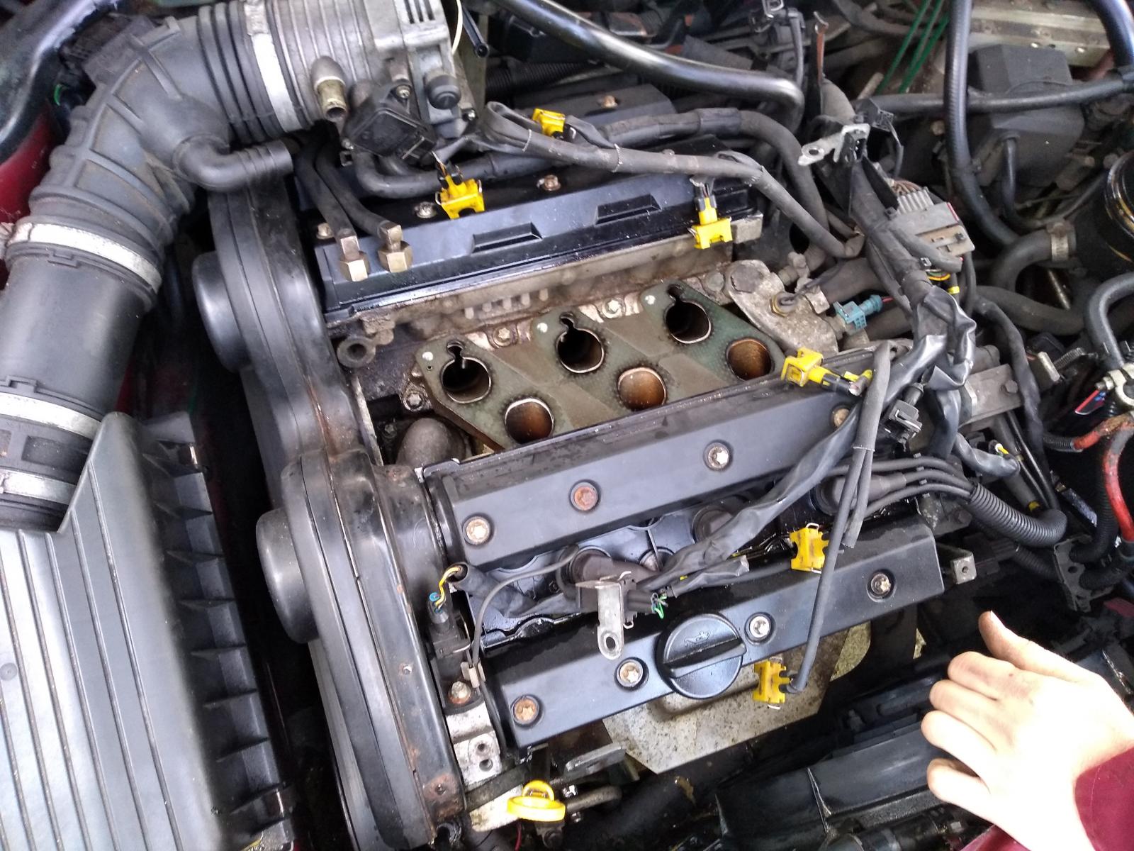

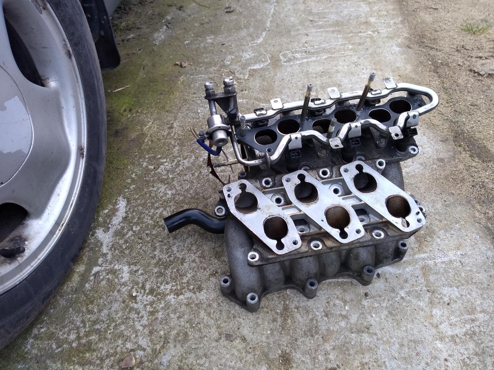

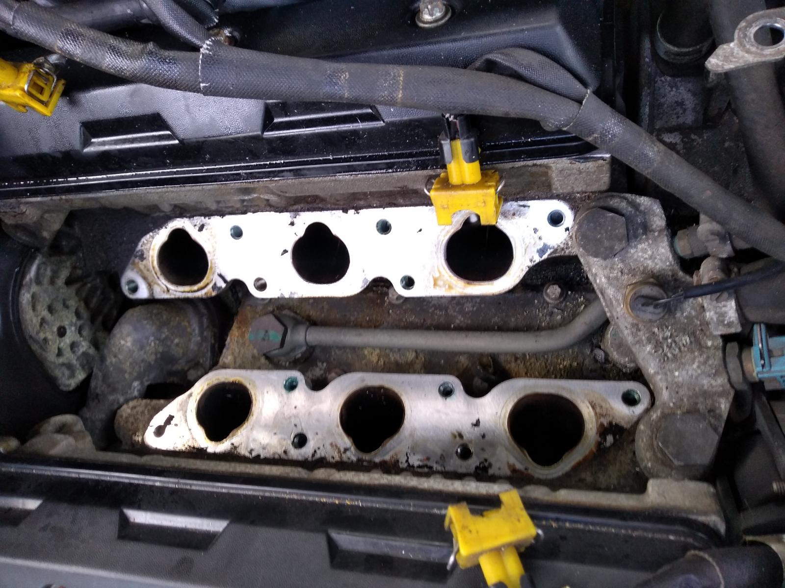

Start by removing the fuel rail. Then the manifold below.
There is a lot of old bits of plastic and injectior number stickers down here.
I've removed all the bolts, why won't it come off. Try levering it with a broken breaker bar, no, hitting it with a hammer, no but the gasket moved let's take that off... Oh
I'll undo those then
I think that is the oil cooler. BeEP has gone to get his unbroken breaker bar to undo the big bolts to the right.
Now to remember where this stuff goes.

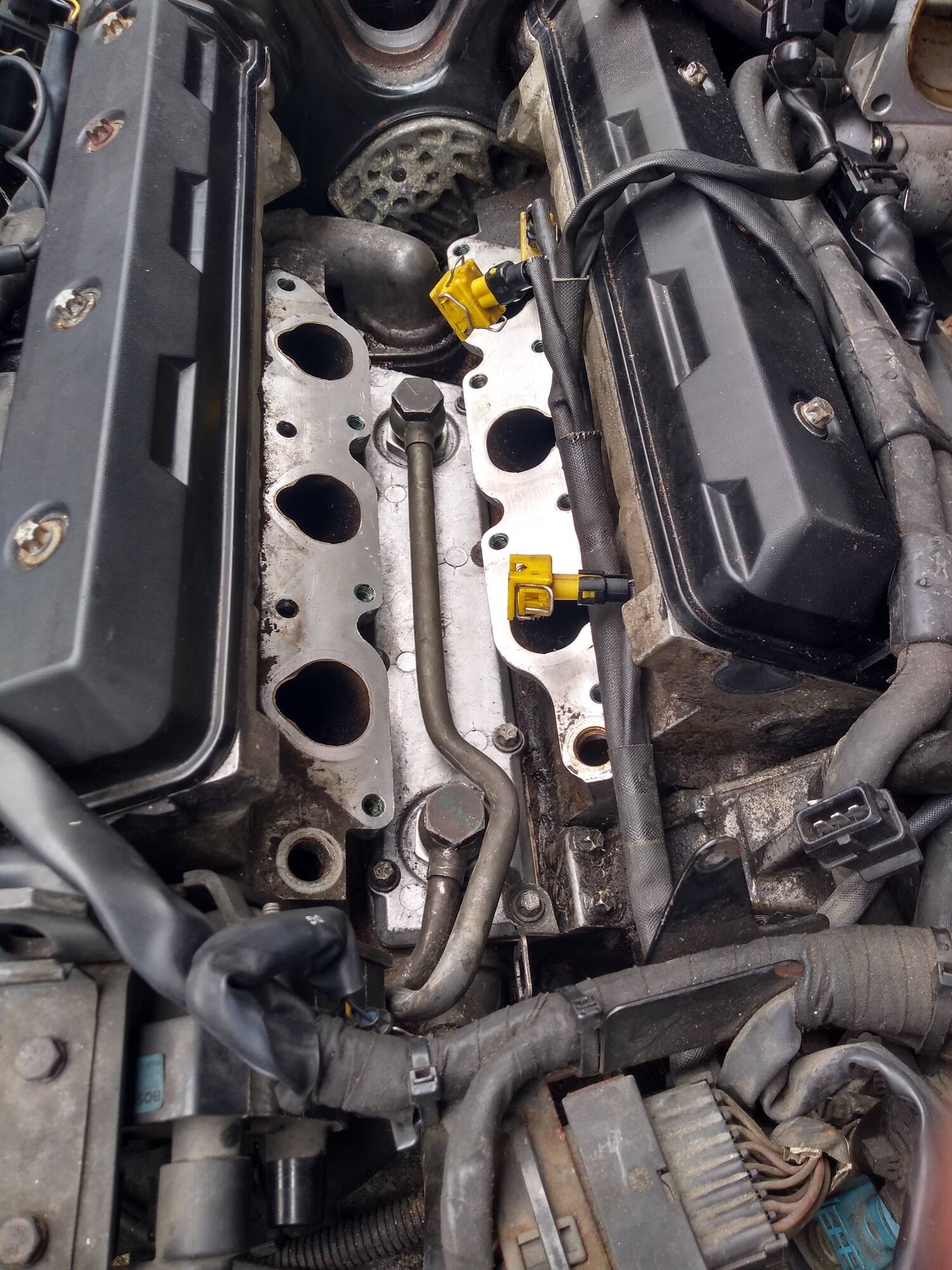

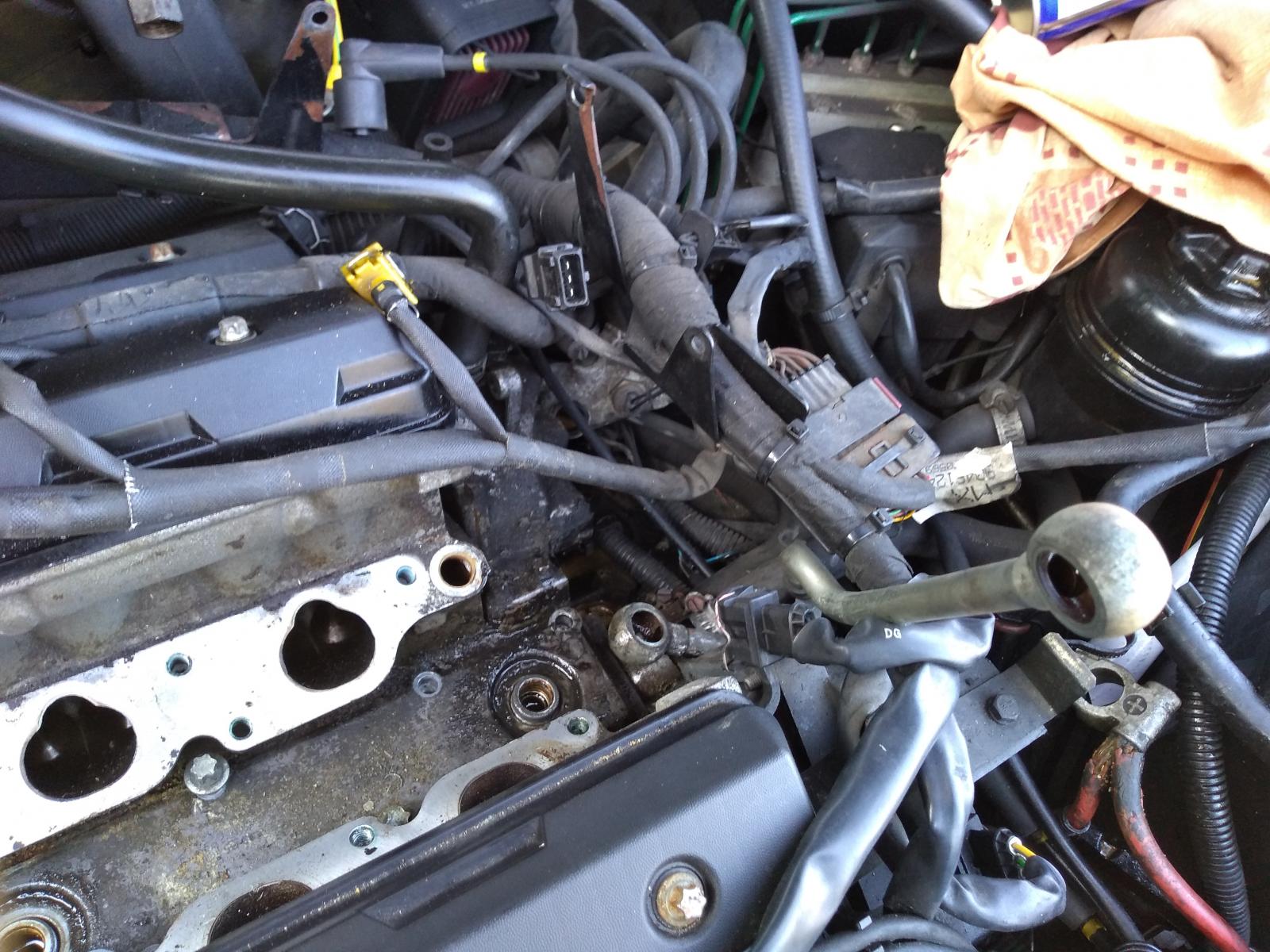

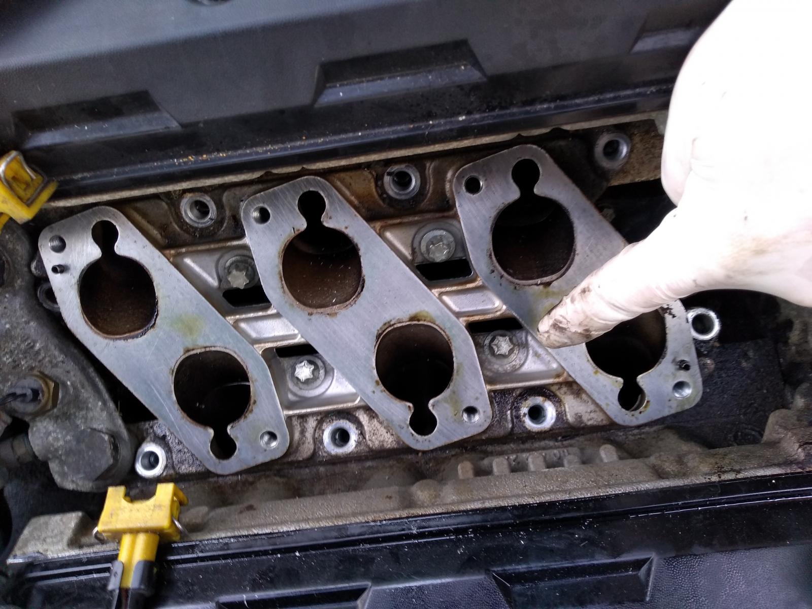

So it has been left pretty much at the last picture, but the two rigid oil pipes have been disconnected and the housing for the coolant sensor removed.
The has us down to the cover for the oil cooler which has been unbolted by the oil pipes have to come off to remove it and were starting to round the 19mm unions at the other end of the pipes. T.b.c probably next week. My multipla shat it's MOT while we were collecting the two for BeEP so that needs some attention.
Cheeky hidden bolts are always a nightmare. Glad you found them before applying too much force.

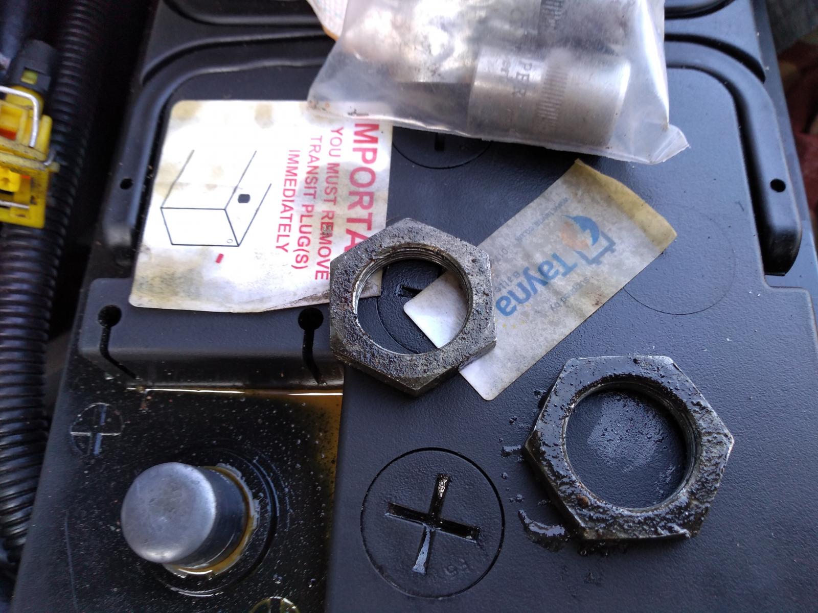

Had another hour or so on this earlier. Managed to round the very tight engine union on end of one of the metal oil pipes. So rather than cut it off to get a six sided (or smaller) socket on it I just bent the other end to get clearance to remove the oil cooler.
After doing this I could then see I didn't have a big enough socket for the two nuts on top of the oil cooler. Luckily for me BeEP had a 30mm socket in his tool box so I popped round to borrow that. Had to pop to of the removed hex bolts back in to get them off as they were quite tight

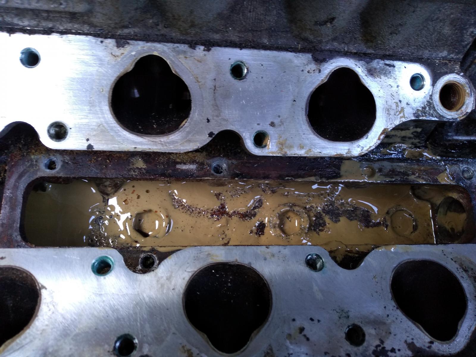

Cleaned out the mayo in the water jacket with paper towel, then poured four litres of water through which then started coming out as water with drops of mayo in it rather than just thick mayo. Then nursery called to say junior the Princess had to come home with an upset tummy so put it back in to fill the hole and gave up.
I didn't even know engines had a heat exchanger in such a place! I guess it isn't leaking inside?
Crazy place to put it really, under a load of stuff right on top of a hot engine.
It is quite rusty round one of the inlets and I filled it up with water and it did seem to drop (but that could just be me spilling it).

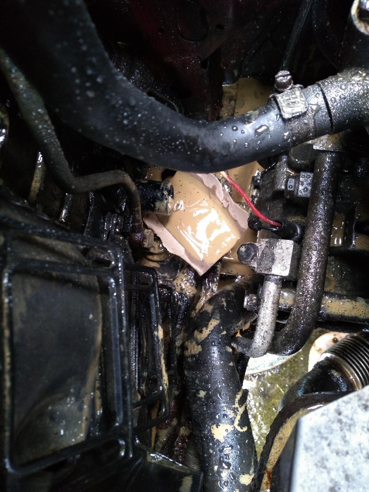

  • 2 weeks later...

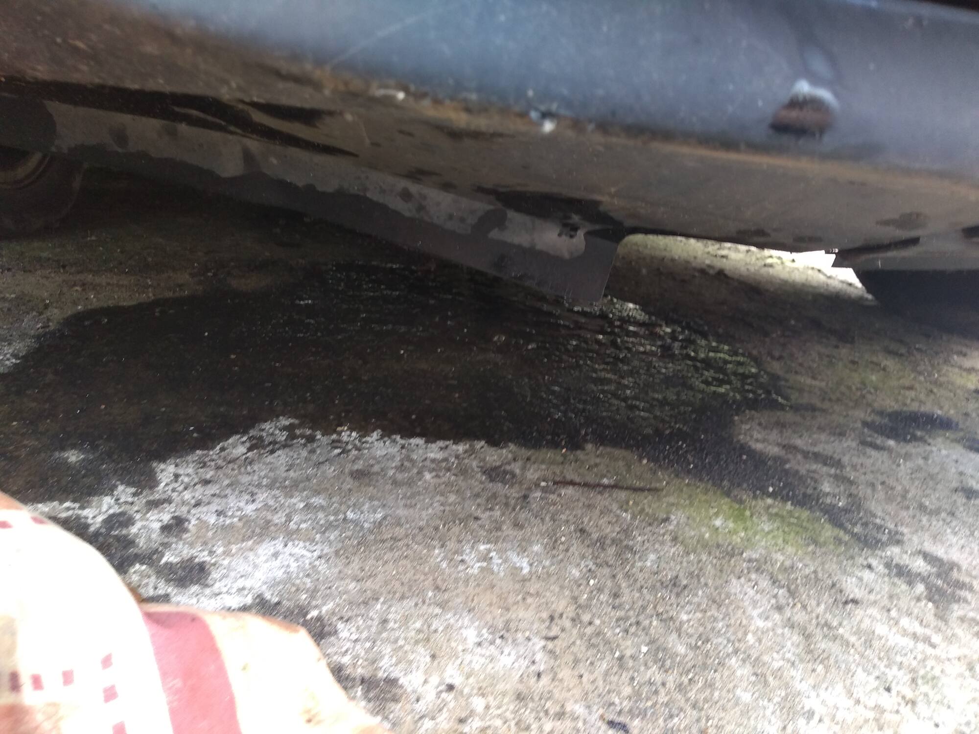

So it seems the two washing up bowls I had to drain the oil and oily coolant weren't under the car enough not to fill with water in the rain yesterday.
Then overspill all over the drive.
Then spill lots more when emptied into 3 old oil containers.
Still two rolls of kitchen roll and a very oily hand has resulted in a very oily driveway but no actual puddles of oil.

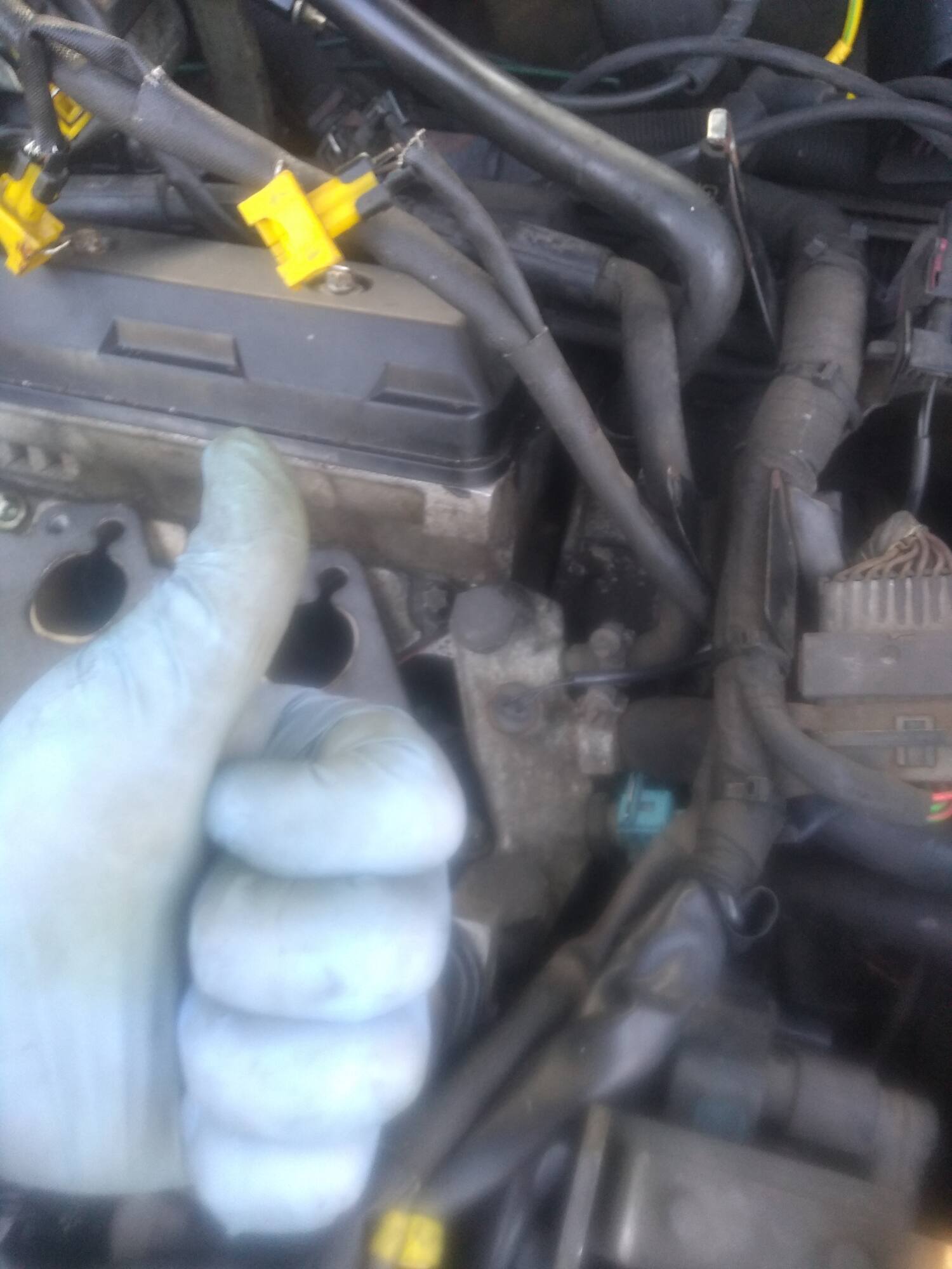

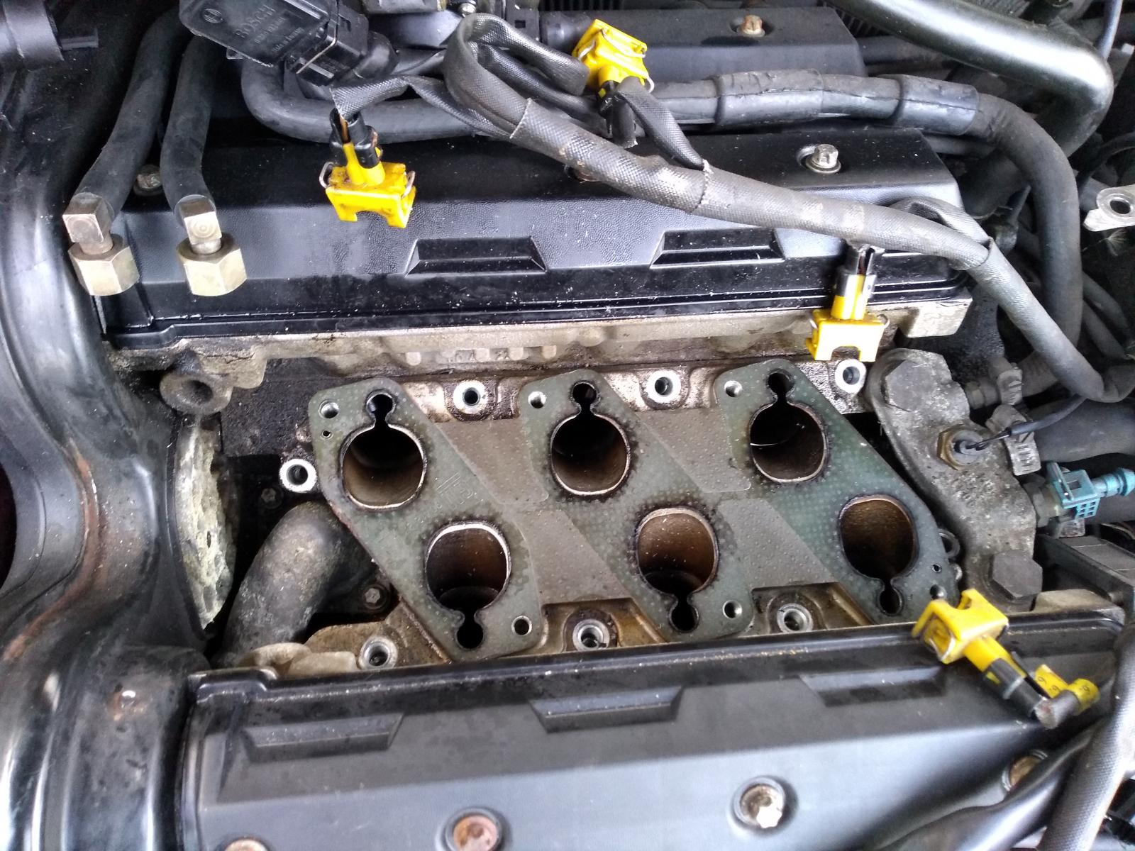

Inlet manifold cleaned up with new gaskets and bolted back on, fuel injector plugs reconnect and fuel line reattached.

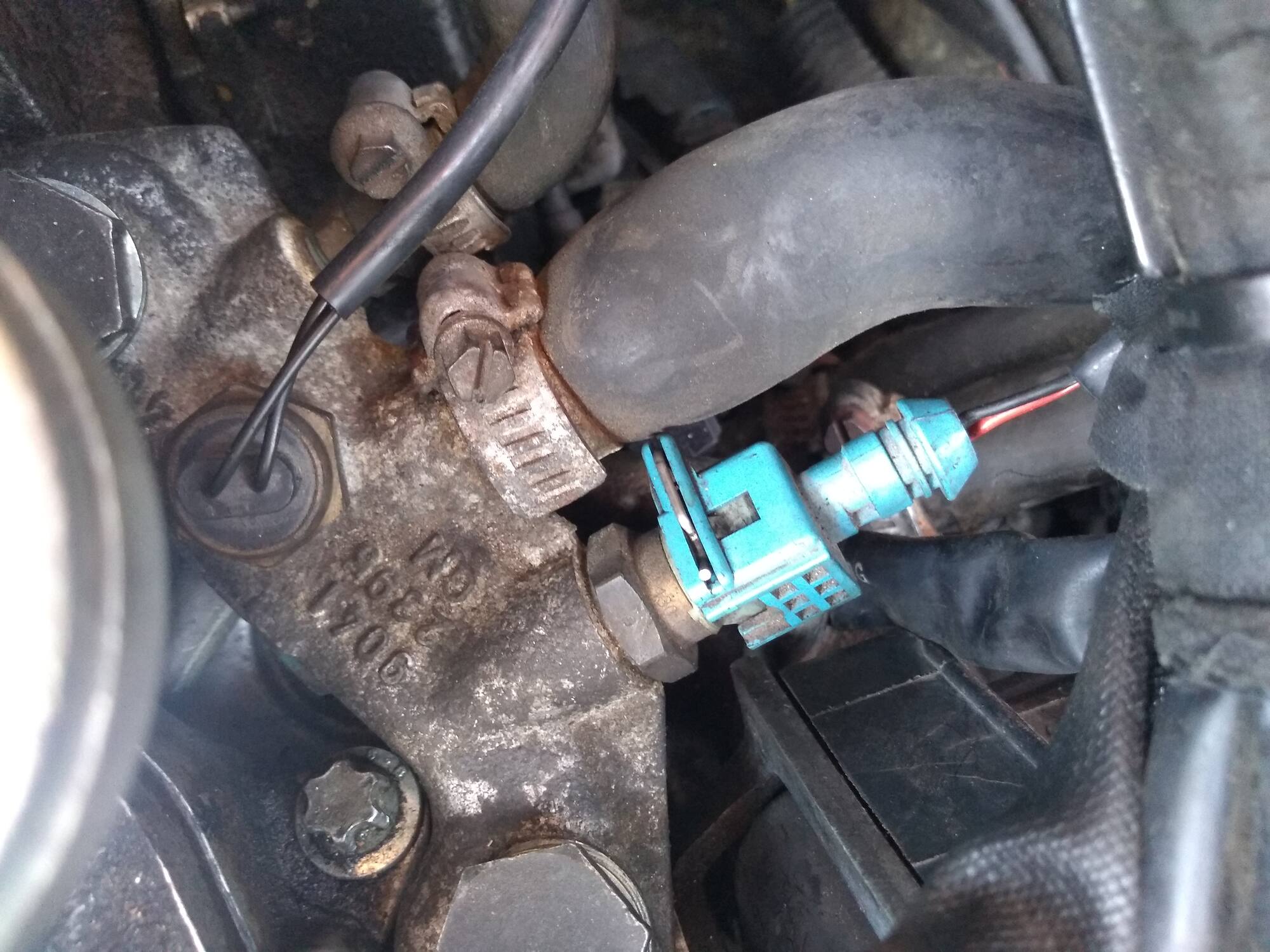

Now just to refit the two banjos connecting the coolant pipes to the oil cooler water jacket.
No, the top part of the manifold needs to come off to line up the bolts. Bugger.
Perfect. Loads of access now.
But the bastard banjo at the front won't go in the hole without cross-threading. So I shut the bonnet until Tuesday.

It can be difficult to get the banjo bolts in without cross threading, especially if they haven't been undone at the bottom end. I found the best thing was to very gently bend the pipe to get the bolt to go in at the correct angle. Patience is required.

So BeEP came over this morning and of course the banjo bolts went straight in easy as anything first go.

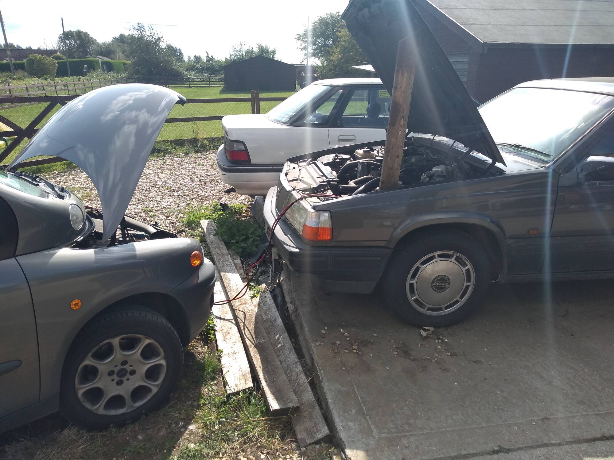

Jump start the 940 out of the way to jump start the Saab. Let the Multipla charge the Saab for 10 minutes and...
That's a tappety engine. But after a bit more oil to get the level back up after filling oil cooler and oil filter and revving it a bit it got quieter. There was a bit of a coolant leak and quite a bit of steam bit they seemed to get better.
Until the heater hose popped under massive amounts of pressure. So it looks like it could be the head gasket after all. Bollocks.
