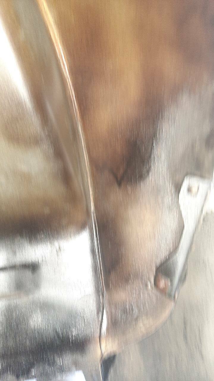

Finally worked up the enthusiasm to get the ramps out and have a look at the Fiesta exhaust...20210117_155103.thumb.jpg.c8c4ddb1c5dcbf595787412eb24e902b.jpg
mmm, don't think a bit of bandage is going to help! Got the clamp off but it's seized on, tried whacking it with a hammer and widening the sleeve but not worked, left it with some plusgas on but may need some heat.. - Got some work to do on Fiesta but think its probably time to move it on, SmollestFL not shown much interested in learning and really wanted a 306..

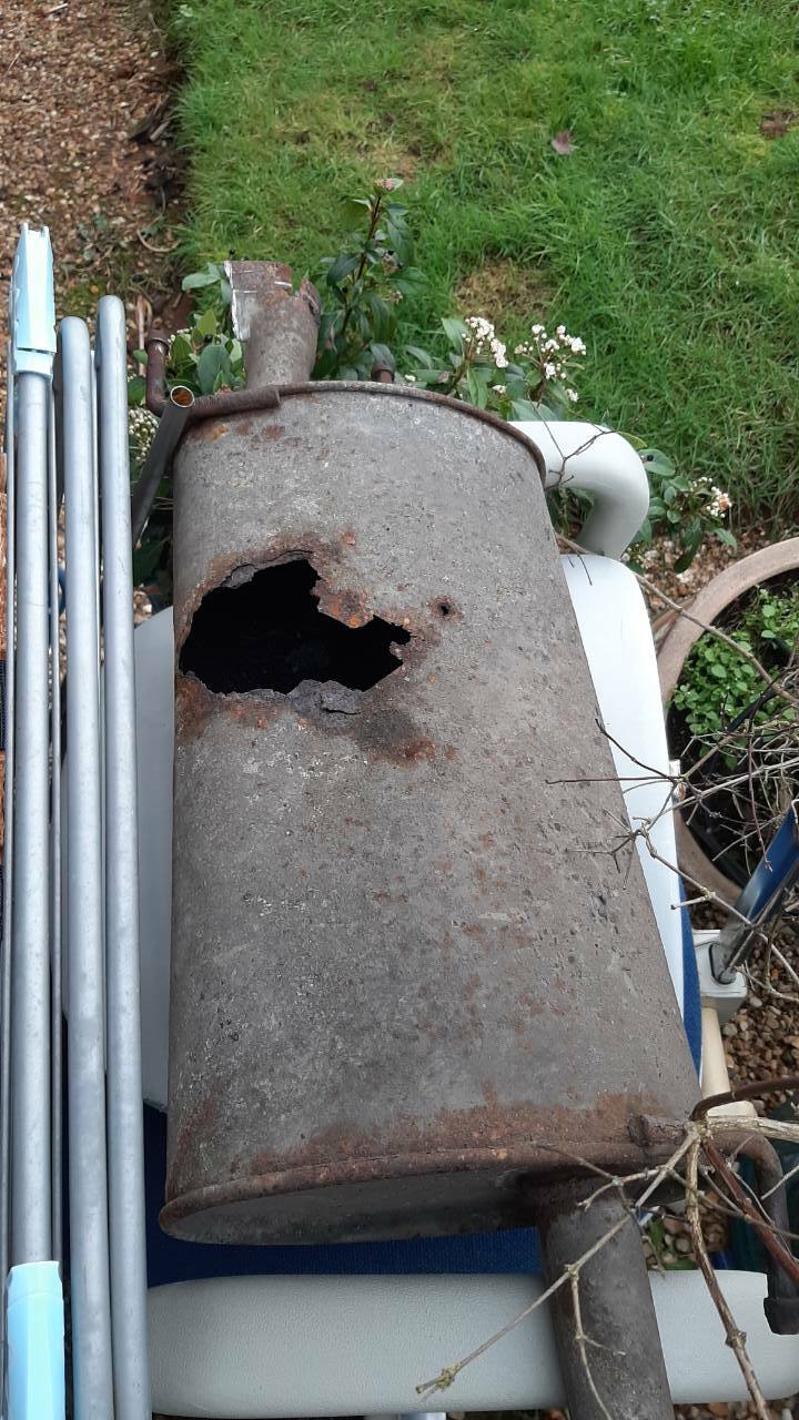

Finally got back under the Fiesta after two weekends of snow rain and wind, backbox had completely disintegrated internally, finally got it off after cutting a slice in the joining pipe with the grinder amd prising it apart.
Next with this one is oil and filter, sort the rust, clean and polish and I think it'll be moving on.

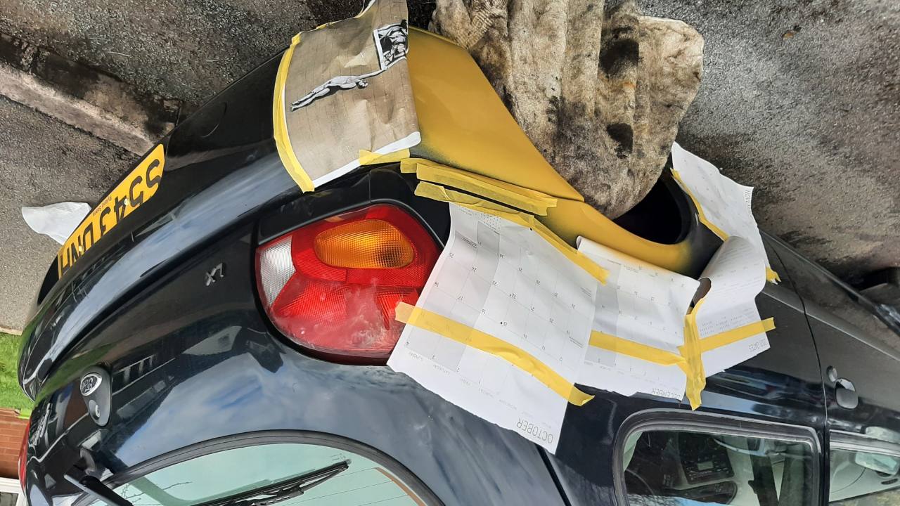

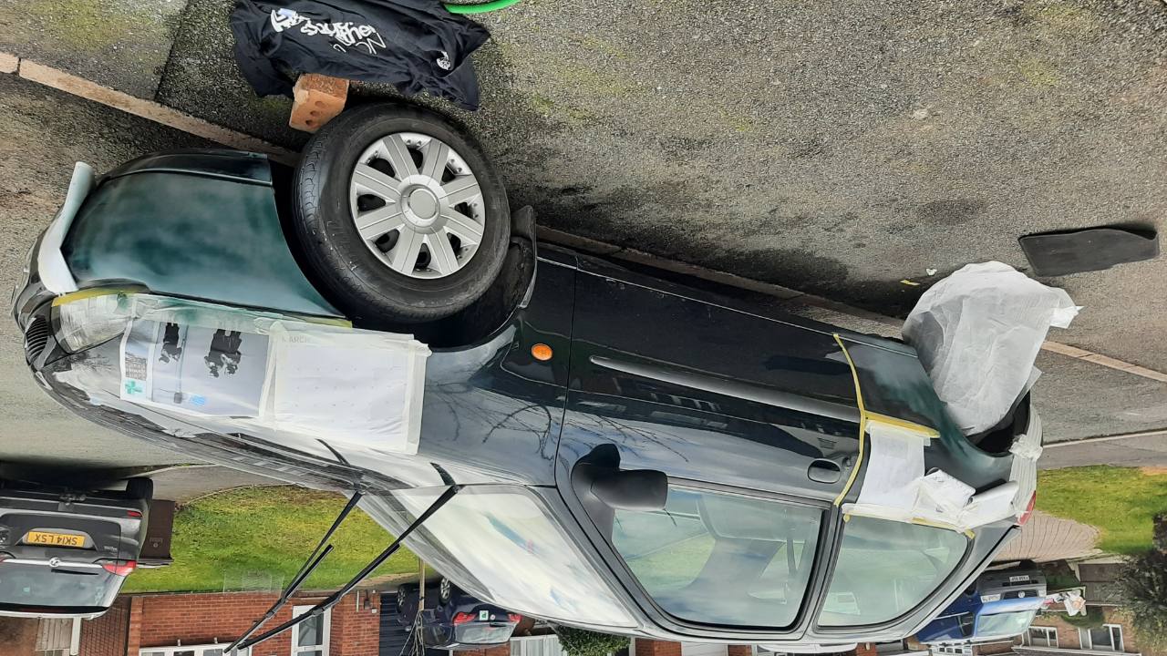

It's all gone a bit "two bucket wrongun" on the Festa,  coming up well with the DA polisher also sorting out some grot of the rear arch with isn't too bad for a 23yr old Ford.. not sure why pics are now upside down...
Today did a bit more bodywork on the Festa and set about sorting out the grotty interior, first up passenger seat..
  • Floatylight changed the title to Floatylights Fleet - Fleet update - Its all gone a bit "Two bucket wrongun "
I iz bodyshop pro* , rattle cans & filler at the ready!
P.s sorry photos upside down, I turned the pics 180° and they are still upside down!
  • Floatylight changed the title to Floatylights Fleet - Fleet update - I iz bodyshop pro! **

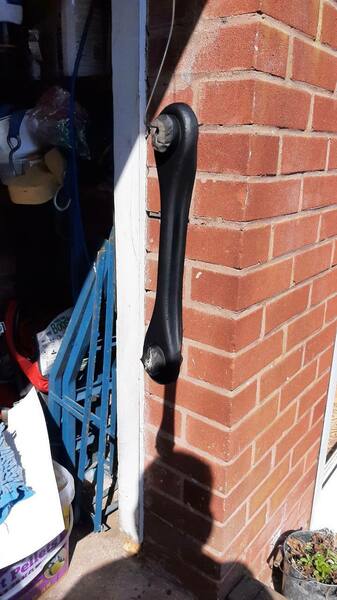

Out for a drive in MrsFL's Mazda 3 and the rear suspension started making all sorts of terrible noises an investigation revealed broken spring, knackered bump stops and worn bushes so a complete set was ordered from Autodoc which has still not arrived in the meantime I decided to cure its cataracts,

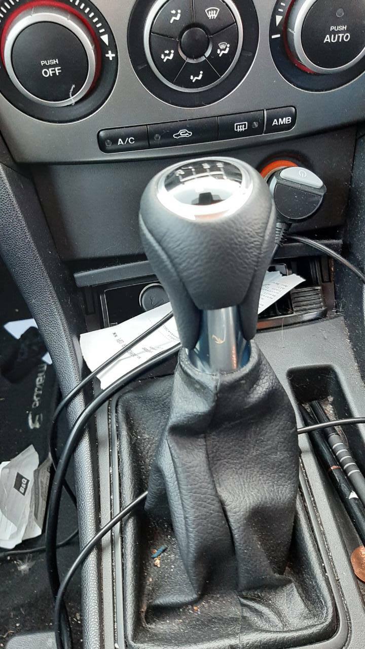

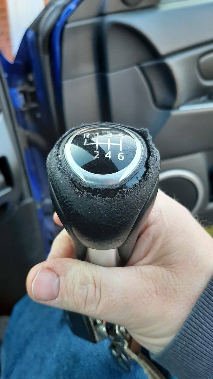

I also replaced the disintegrating gearknob duff Bose speaker and broken mirror cover.
20210413_080650.thumb.jpg.b8ec4d03e13c729a2408feb890a68747.jpg20210413_080705.thumb.jpg.5257f2225d822c584d2c5075e0c1a848.jpg
Now the rest of it needs a good clean and polish and when the bits arrive I'll sort the rear suspension, to reward being shown some love the front droplinks started clunking..

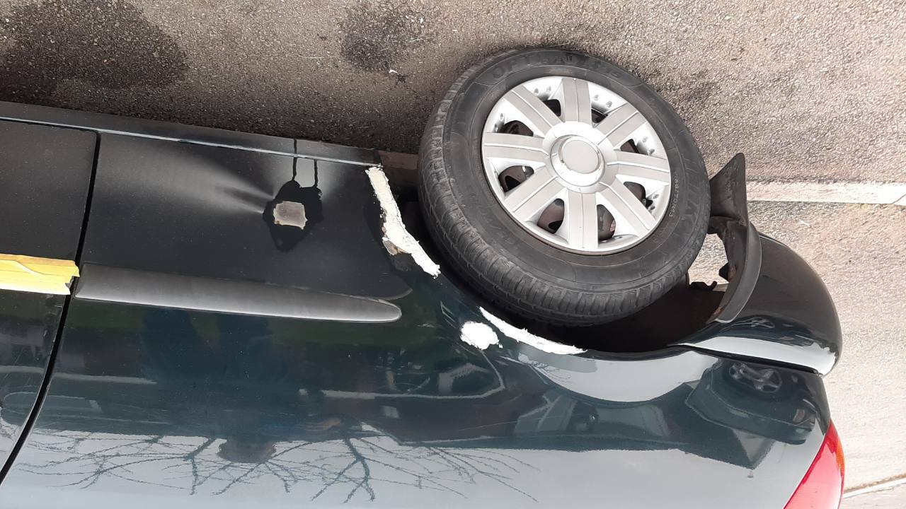

So to the trusty C4GP, due to covid not really being doing the miles and being parked up has not done it much good, a little bit of bubbling turned into a hole in the sill. BiL happy to weld a plate in but plastic front wings makes it a lot more difficult.

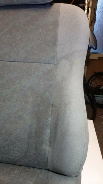

It also smelt like a swamp and the seats were all stained so I've had them out amd cleaned the carpets and seats with the vax, now smells lovely.. also plan to give it a good going over with the DA polisher..20210411_130918.thumb.jpg.f144075be90c4f7f3d90d2eff23027a7.jpg

A box from Autodoc finally turned up on Thursday. So Friday night I started stripping down the rear suspension on Mrs Fl's Mazda 3, the shock came out easy enough, but much grumbling ensued and the spring refused to come out.
Fast forward to this morning and the spring was liberated after cutting a droplink off.
While I was in there liberal amounts of Bilt Hamber Dynax UB was applied  (cos Mazda) but much more grumbling ensued trying to get the new spring in, of course in the Autodoc tutorial vid it was dead easy, no need to compress the spring just get a pry bar and pop it in, some ingenuity later it was in having used spring compressors which gave me the fear.

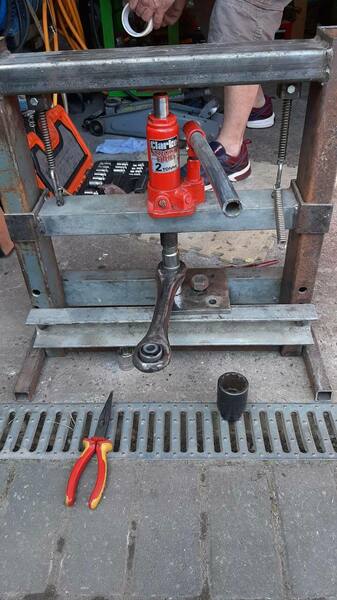

Some bushes looked suspect and having ordered a full rear set the bar was whipped off, cleaned up and over to BIL's to use his homebuilt press which did the job perfectly, he even rust protected and sprayed it up for me, reassembly from here on was fine. The other shock and Dynaxing the other side will have to wait for another day.
