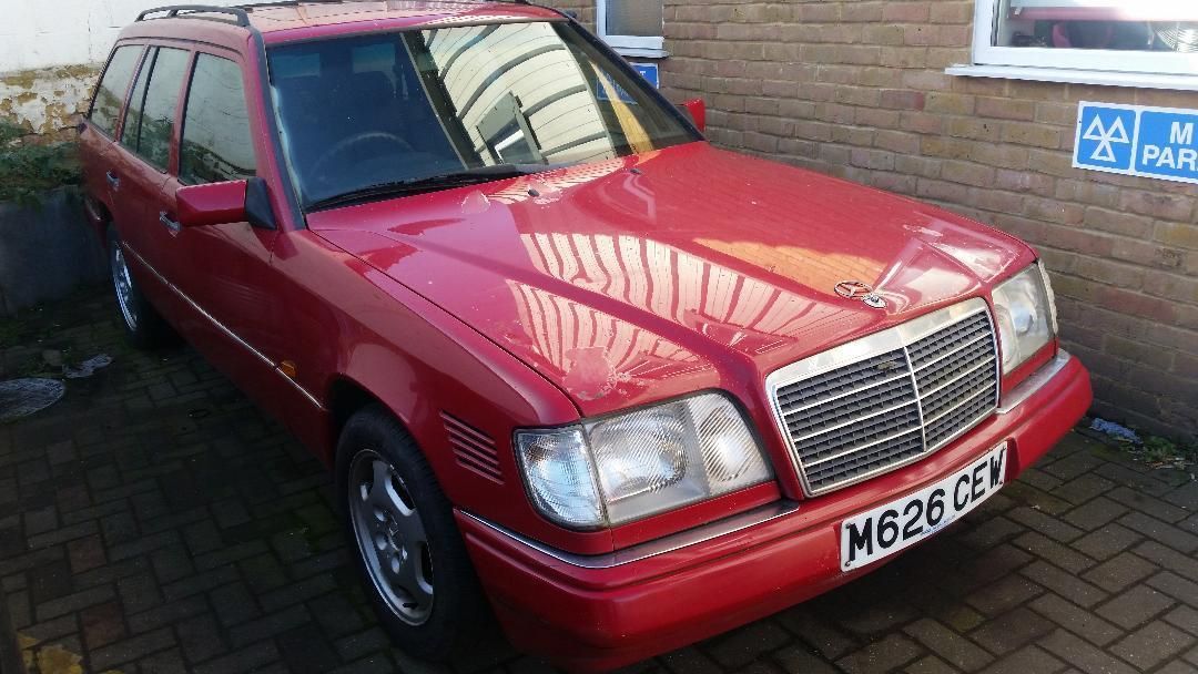

Having been on fleet for 48hrs, I've already dun gone bort parts for it..
New stop valve and a new ignition barrel winging their way as we speak.
Those are the two things that stop it from being useable at the moment.

The two parts bought so far will mean:
It is possible to turn the ignition every time.
The car will switch off on the key.
Those two done, I'll run it and assess, if you've seen my Oxford thread you'll know I ain't scared of rust investigation..

Your indicators are odd! Also, all the diesels I’ve seen have an offside front wing that is vented - presumably to help breathing.
I'd quite like to rip the engine and associated stuff out of one of these to put into my saloon, which isn't rotten!
Y U no fit a 606 from a W210 if you want a dizzler?
Only the multivalve 124 diesels have those vents.

That's good to know thanks:) I had a look underneath as best I could and I have seen worse. I see it as being cheap motoring reagardless how long it lasts.
I think the SLS has no fluid in it (certainly the tank in the bay has nothing in it)

The gearbox shifts fine and kicks down ok (i.e an appreciable rise in noise and negligible increase in speed!)
I may consider a change once I know it's worth working on, so the info re the TC is appreciated!
