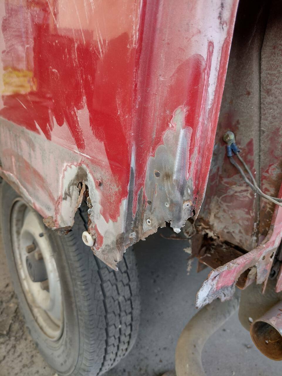

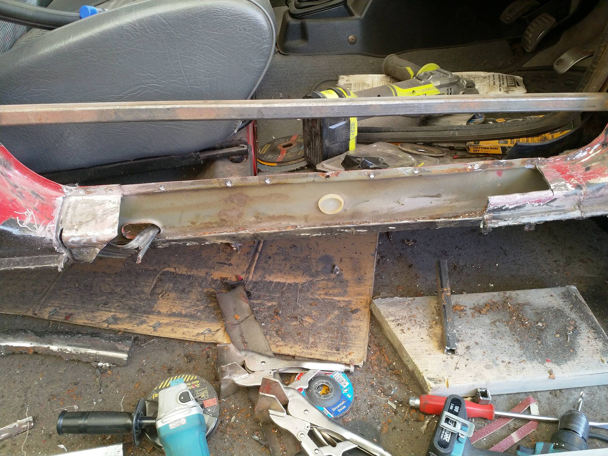

The original c15 has had a number plate change to something older as it annoyed me by being far to new! It's now gracing a P plate which looks far better. It's my daily motor, scruffy but solid....or so I thought ?. So this weekend I wanted to temporary fit another driver side door so I could rebuild the rusty original.  Whipped the door off and the had a little scrape of a rust spot on the door step. This quickly went into a hole so I  got the grinder out and cut it out to repair. It's here it all went wrong as I decided to look inside the sill and discovered someone had been creative with aluminium mesh and filler.  So out with the grinder and started cutting back to solid metal, it took a while to find some!
So after some metal work and lots of welding it ended up like this.

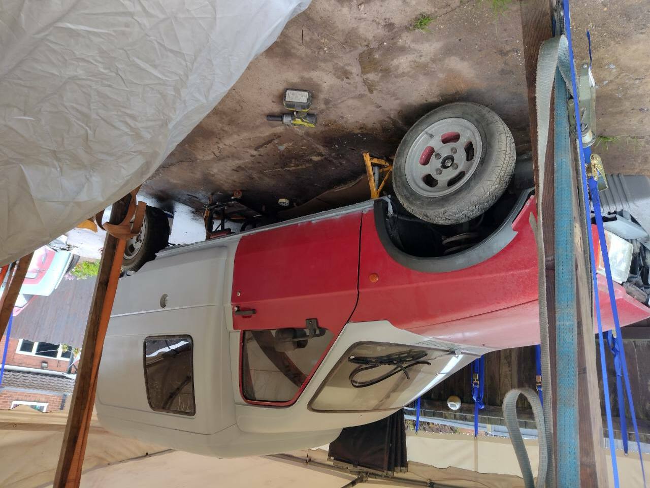

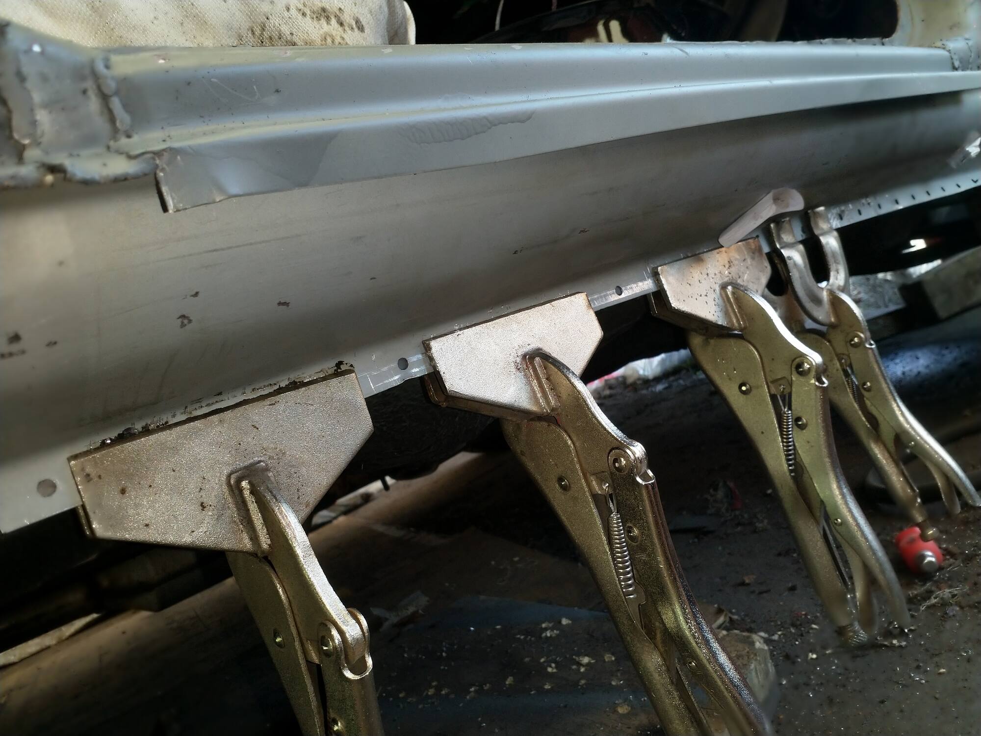

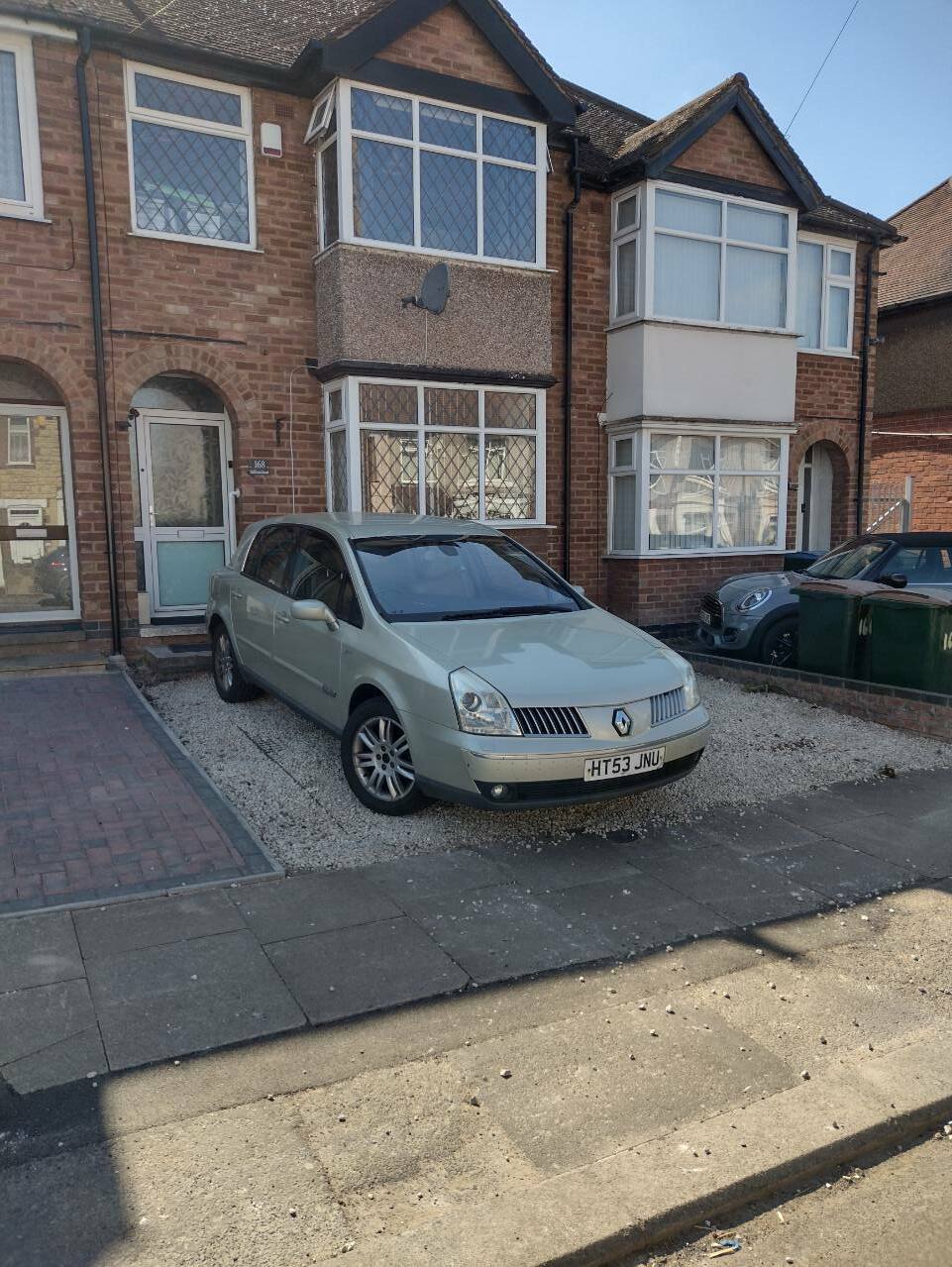

Time for an update on this. Current fleet is shonky the bx, currently on restricted duties due to a poorly head gasket. Zx auto estate, plodding along slowly and in rude health. C15 van, just had a new sill on the nearside and various other bits of welding and being prepped for a budget respray. Finally the Vel satis of many shitters. Only had this a couple of weeks and done 800 miles in it so far. Managed to cure the low screen wash warnings by unplugging the sensor and working my way through destickying the interior plastics. Last weekend I went to Plymouth to collect a visa valence, and today I went to chesterfield to collect slot mags for the van. Then home via Wellingborough to drop some bits of at friends. Have some random photos off my phone, no doubt they will be every which way but correctly up IMG_20210408_112227835_HDR.thumb.jpg.59af450441ef572a3f29c93d319bd322.jpg

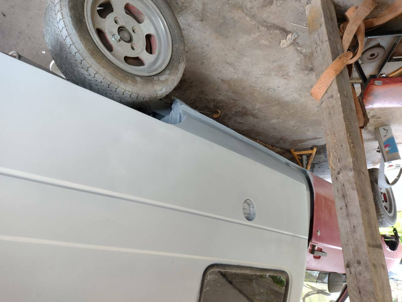

Van has one side now all in primer and the sill all stone chipped. Needs blocking down but will get whole van in primer first
Scored a cheap replacement grill for the Vel satis and a trim clips so the front end is now properly held together. Trying to find the source of the oil leak on top of the rocker cover. Replaced a few knackered breather hoses and put a new seal on the oil filler cap. Need to get brave and pressure wash the engine. I'm suspecting it's because the engine is breathing quite heavily. Still drives lovely though. IMG_20210512_130449802_HDR.thumb.jpg.d02f5a817411d042f36f99e0f382541a.jpg

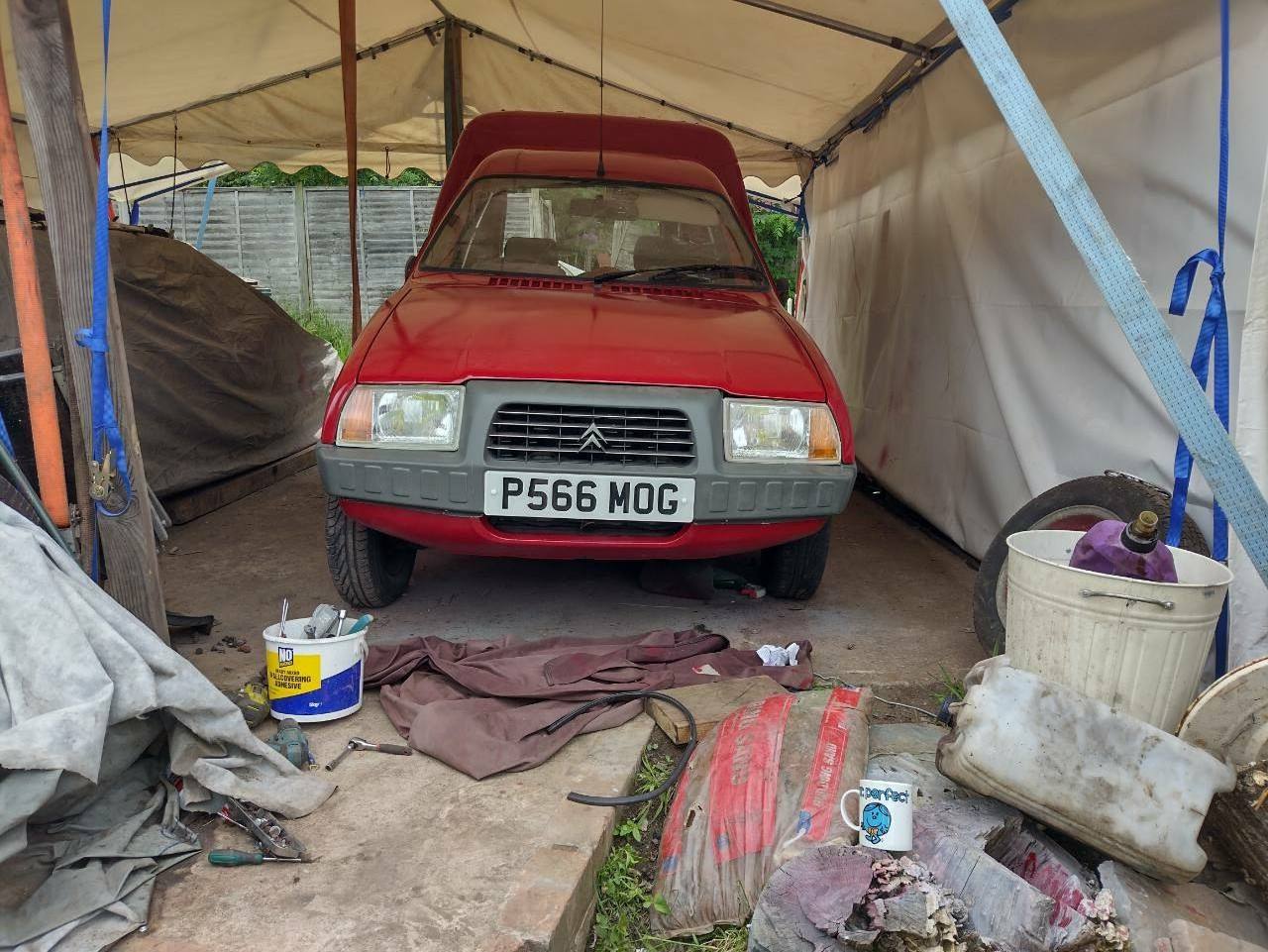

Been assembling the van today. Putting the lower valance on was a nightmare. Had to cut a few bits off to clear the diesel subframe. But it's in place, just need to make a couple of brackets to secure it underneath now. Small list of things to do tomorrow then it will be back on the road.IMG_20210607_102035209_HDR.thumb.jpg.30cf284603f23ba0a29c958a62723733.jpg
God knows why one picture is upside down. IMG_20210607_152751513_HDR.thumb.jpg.9a6658019542a6ef88da6519faae69d1.jpg

I do like the pig nose front
I think they look so much better. I've removed all the side rubbing strips too to try and make it look like an early one. Would love to get a visa pod style dashboard and try and make it fit.
That is one very happy looking van! :-)
The pug nose suits the higher roofline of the van better than it does the Visa hatchback, I think.
