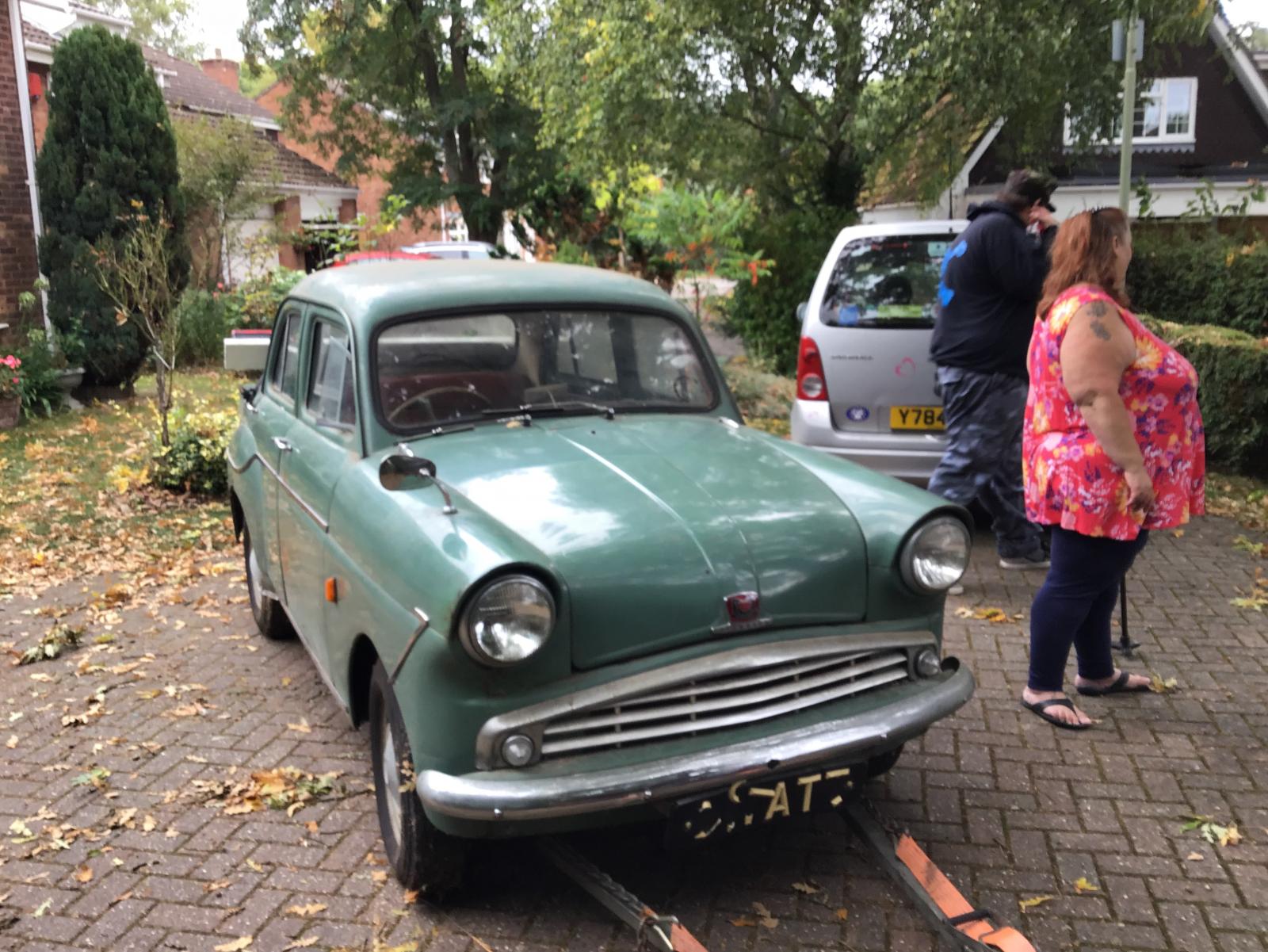

Popular Post nigel bickle Posted September 20, 2018 Popular Post Posted September 20, 2018 K. So I’ve just collected this. Used to have several of these but boredom, impecunity, a bloody big fire robbed me of most. This came up, very little detail, at sensible money - so I jumped. Seems ok. I pulled it out of this garage, languishing since 1981 , today Couple of seized brakes stripped to allow it to roll, engine free & willing ( no key) permitted me to A frame it back home. It seems pretty solid, has a nasty rats nest under the bonnet, so bound to have a few surprises. Current intention is to sort it to running condition, use this Autumn then play over winter. Thinking 1300, o/ drive box & banded steels, maybe bigger brakes. But, essentially, as is. tooSavvy, privatewire, Tickman and 49 others 52

nigel bickle Posted September 20, 2018 Author Posted September 20, 2018 Posh Standard 10. Usually two tone. Same running gear & most panels ( front/ rear wings excepted. Nowt special, but quite quirky.
barefoot Posted September 20, 2018 Posted September 20, 2018 Get some big fuck off wheels under them flared rear arches while you're at it too John F and bolognasal spray 2
Skut Posted September 20, 2018 Posted September 20, 2018 Pennants look cool with their little add on Fins. Like a miniature gangster car.

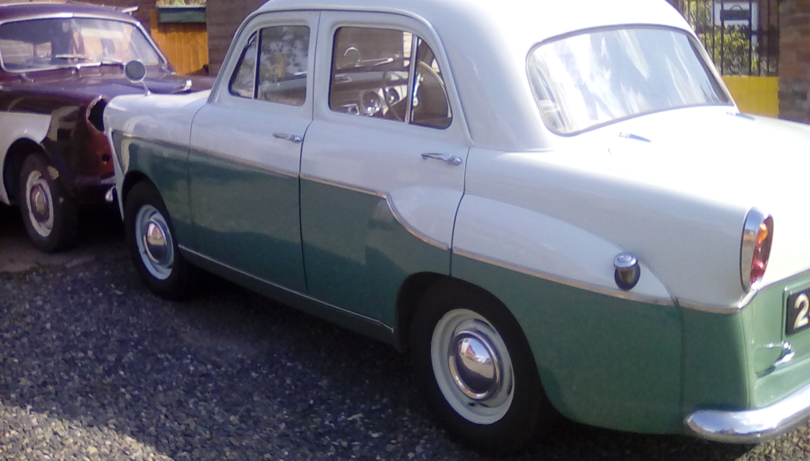

D Spares & Tyres Posted September 20, 2018 Posted September 20, 2018 This is the only photo of it on this device. 35,000 miles. Never welded. I painted it 17 years ago. Mostly original otherwise Rocket88, Twiggy, alcyonecorporation and 28 others 31
nigel bickle Posted September 20, 2018 Author Posted September 20, 2018 Nice. Same colour scheme as my first. Pretty car. On the road? No idea what my mileage is yet.- haven’t looked!

D Spares & Tyres Posted September 20, 2018 Posted September 20, 2018 Nice. Same colour scheme as my first. Pretty car. On the road?No idea what my mileage is yet.- haven’t looked!Thanks Yes it's all fine and perfect working order. I've only seen four since I acquired mine: One in a similar colour at a show A grey and black example owned by a couple who live only 20 miles away. They have sold that one now and replaced it with the pale blue one that used to be in Gaydon. The only other one I have seen was quite rough and had graffiti all over it. I knocked on the owners door and took his number. I then lost his number and couldn't remember where he lived. It was opposite an airfield in Wiltshire I think. There are a few others out there but not many nigel bickle 1
