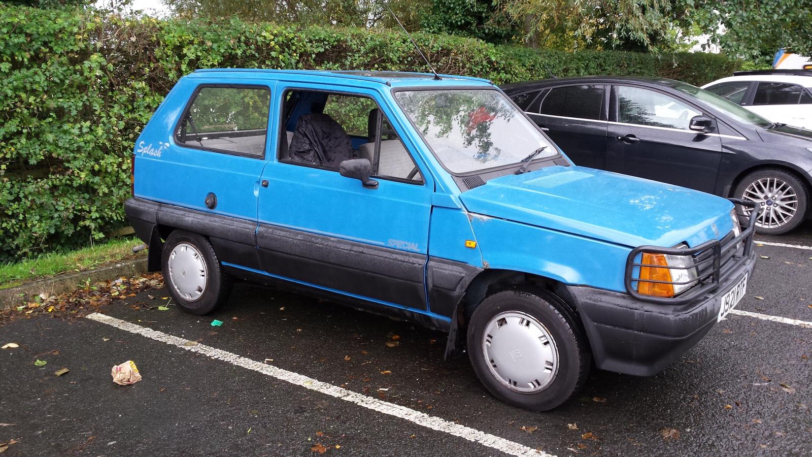

phil_lihp Posted September 29, 2018 Author Posted September 29, 2018 160 miles and 3 hours after leaving Stanky's office car park...She's home!It was great to finally meet Stanky, he and Slartibartfast are Autoshite heroes. Aside from quite a lot of oil escaping from the rocker cover gasket and the exhaust developing what sounds like a very large hole at some point early on, it was an uneventful, if quite loud, journey.Proper update and assessment tomorrow but I'm pleasantly surprised by it so far. It does make me smile, it's a cheerful little car. Coprolalia, Jim Bell, vulgalour and 17 others 20

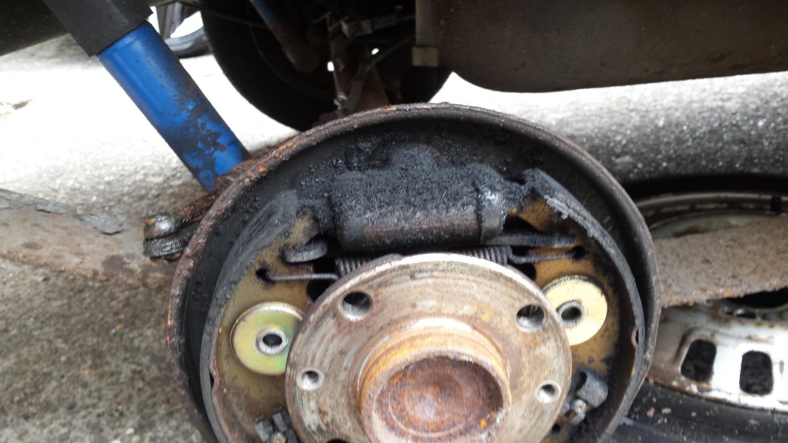

Parky Posted September 29, 2018 Posted September 29, 2018 My old Renault 5 had abysmal brakes. So bad that when I tried to sell it, interested parties walked away after the test drive. Usually ashen faced with their hair standing on end, such was the terror of trying to stop the thing. The rear brakes were the culprit. The self adjusters had seized up so even with the handbrake on, there was very little resistance. Once I manually adjusted them to take the slack out, the handbrake locked the wheels on the 4th click and the pedal felt so much better. It actually slowed down on demand which was a novelty. Your comment about the lack of retardation from the handbrake immediately made me remember having the same problem with pedal feel and effectiveness. Air in the system could be worth checking and some new brake fluid wouldn’t do any harm anyway. At least then you know it’s done and let’s be honest it isn’t expensive. Get plenty of Plusgas on the nips first! phil_lihp, Slartibartfast and Braddon81 3
Stanky Posted September 29, 2018 Posted September 29, 2018 Glad you got home safe and sound phil_lihp, was great to meet you and I'm glad you like the Marbella - it was certainly a happy little thing on the drive back to the office the other week. How did you find the cruising speed on the way back? I wonder if Parky may be right and the rear brake adjusters or cylinders may have seized. As we discussed I'm pretty sure the handbrake cable hasn't snapped because there is progressive resistance, and it does stop at about 45 degrees, rather than just pointing skyward as I'd have expected if the cable had gone completely. Keep us updated on your adventures, and thanks very much for letting Slartibartfast and I have a go, its a great little car! You've done well with it. RobT, phil_lihp and Slartibartfast 3

Slartibartfast Posted September 30, 2018 Posted September 30, 2018 The only photo I took the other day. It's such a happy little thing and the interior is functional but surprisingly comfortable. Vince70, michael t, Angrydicky and 6 others 9

Parky Posted September 30, 2018 Posted September 30, 2018 It’s just so full of win. The world would be a better place if we all had one of these. Let’s be honest, unless you drive 60000 miles a year for business, what else could you possibly need? And as for the rear brakes - yeah, all that fluid probably isn’t helping matters! I assume the parts are standard Fiat? Slartibartfast, Vince70 and phil_lihp 3
Parky Posted September 30, 2018 Posted September 30, 2018 The cylinders and shoes are pretty cheap - provided they are the right type of course.... https://www.ebay.co.uk/itm/PAGID-Rear-Wheel-Brake-Cylinder-Seat-Terra-Marbella-Fiat-Uno-Ritmo-Panda-More/332530611220?fits=Car+Make%3ASeat%7CModel%3AMarbella&epid=1937510780&hash=item4d6c5e7414:g:W58AAOSwxZNbWeBl And Quinton Hazel shoes are almost half the Euros price https://www.ebay.co.uk/itm/Rear-Brake-Shoes-set-of-4-for-SEAT-MARBELLA-1986-to-1999-Quinton-Hazell/222659460549?fits=Car+Make%3ASeat%7CModel%3AMarbella&hash=item33d789bdc5:g:C64AAOSwACZZzLjM phil_lihp 1

Zelandeth Posted September 30, 2018 Posted September 30, 2018 Assuming the rear brakes are shared with the Panda, once you've sorted the leak you want it set up so it will just about hold the car on a moderate slope. If you adjust it aiming to be able to do handbrake turns, you'll be looking for a new handbrake cable after you've applied it a few times. My old local garage used to test Pandas by seeing if the handbrake could hold on the hill outside, they knew taking them near the rollers was futile. phil_lihp 1
phil_lihp Posted October 1, 2018 Author Posted October 1, 2018 Thanks, the rear brakes might have to wait a while until I have time and spare cash but at least they're functional for now. On the plus side, it's so light that it doesn't need much bite on the brakes to achieve reasonable stoppage, It's certainly acceptable at the moment but will be a priority once the exhaust blow's been mended. RobT 1
