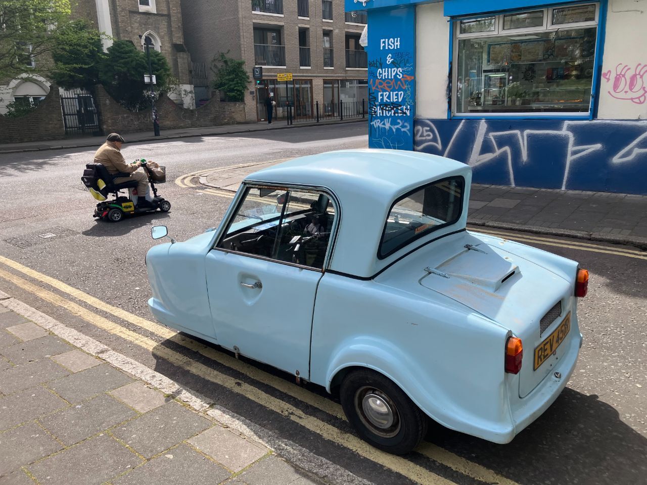

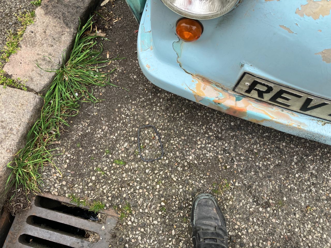

popped down to REV this(?) morning

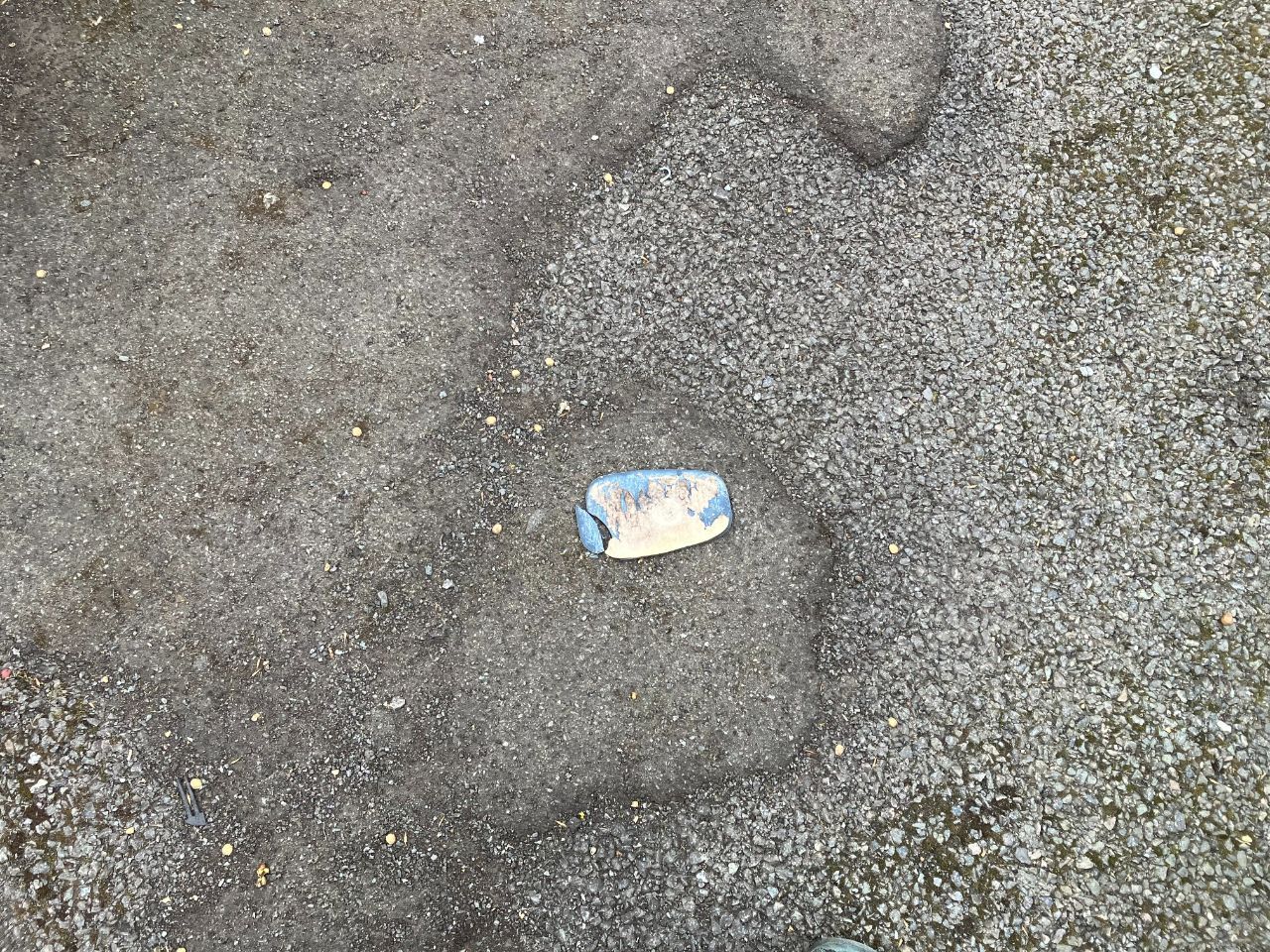

discovered her nearside wing mirror glass had gone AWOL
follow the clues...
on the pavement
a bit of tape later, like it never* happened...
(I had noticed the the black trim thingies, do like to work their way out of the mirror body and I usually pop them back in place ever other trip or so, I wonder if the nearside one finally worked its way all the way loose, if someone bumped into it or somehow the wind took it!)

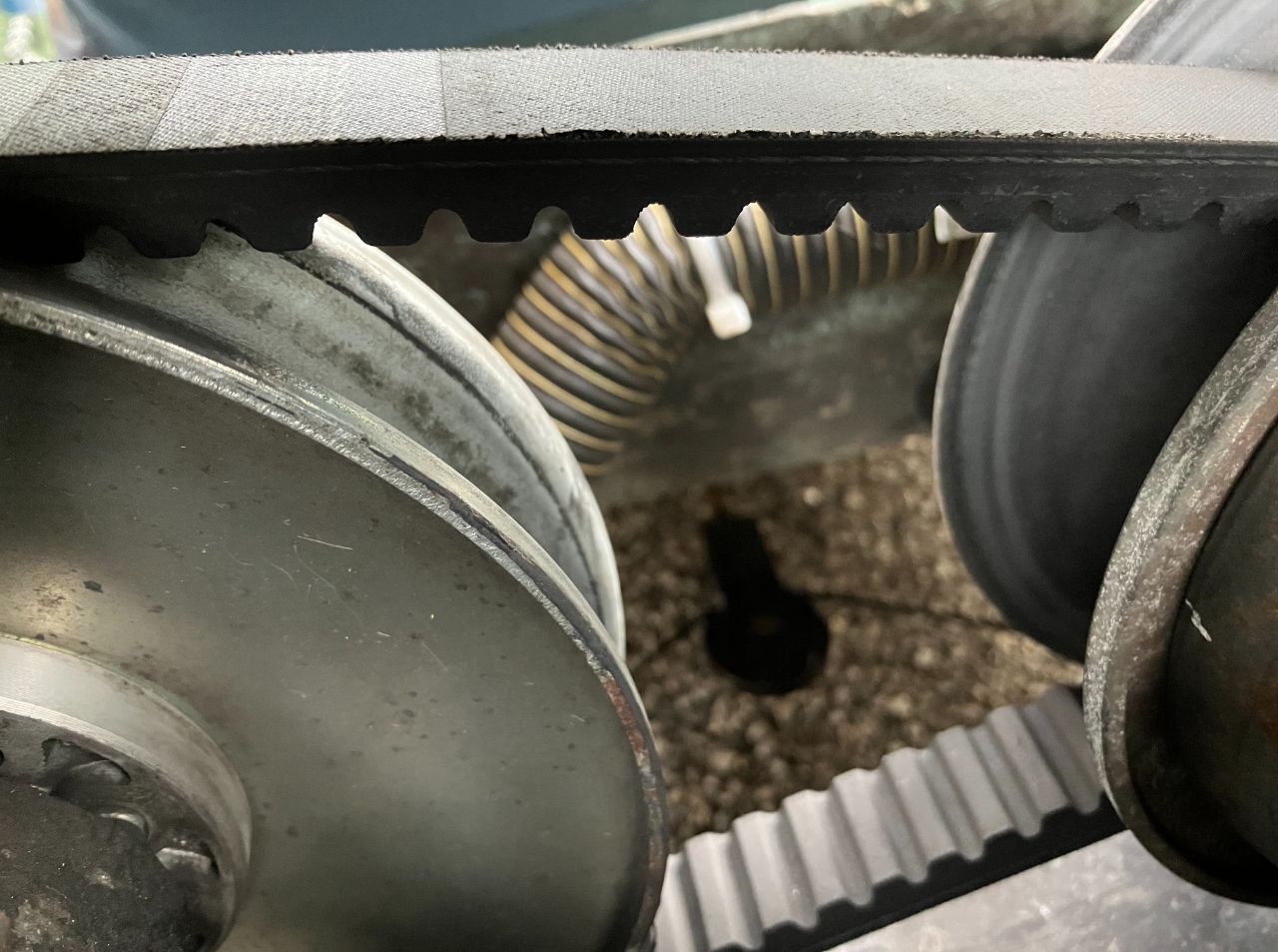

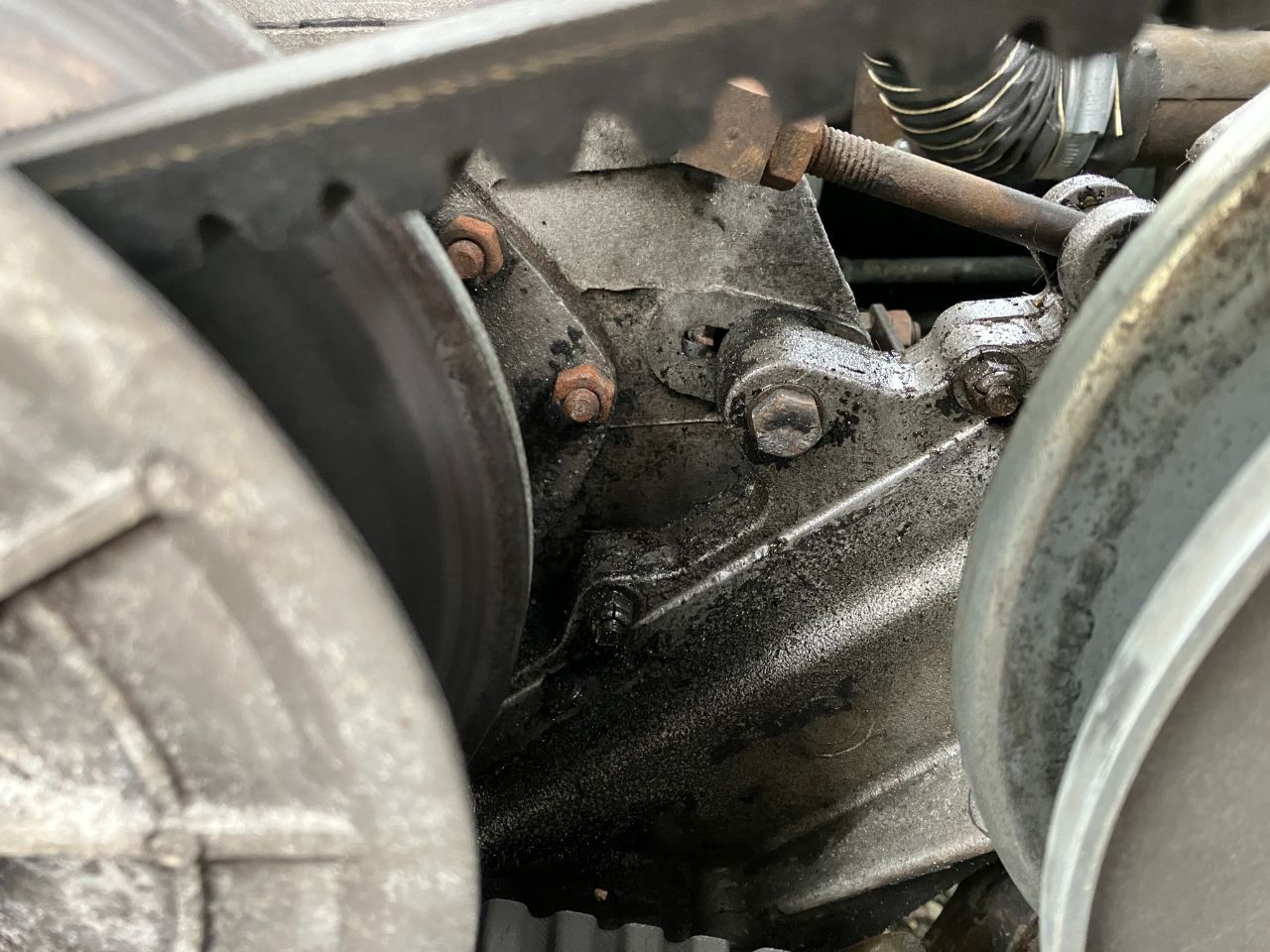

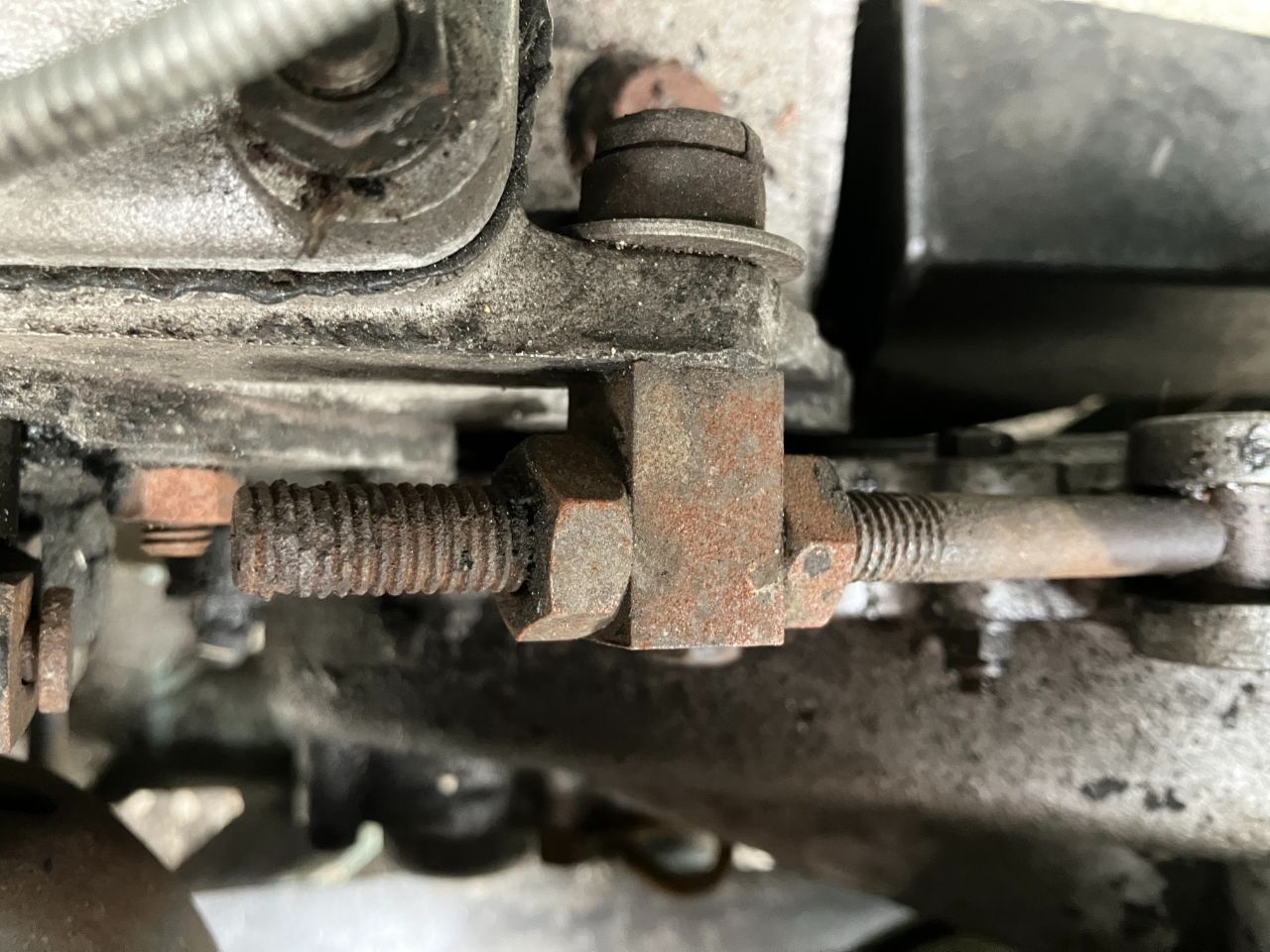

the thing I popped down for, was to look at REV's CVT belt and ideally change it for one of the new HP2020 belts I have, but alas
I took one look at the adjuster rod and realised, yeah thats not going to cooperate! (and for giggles I did try and get a spanner on it and it did not feel like budging) I was hoping to do it the @Zelandeth method, which is wind the adjuster all the way to minimum tension then you can walk the belt onto the pulleys without having to remove them and faff about with then compressing the secondary pulley to trap the belt in it (which is something I need a second person for as mentioned I am weary about how many more cycles the locking washer-tab thingies can take)
the other problem is to wind the adjuster off, theres 3 bolts in slotted holes you need to slacken off, but I could only find one, I could not find or see the other 2 at all,  I know they are there and I suspect if I got underneath I could probably find them, but fuck if I was going to faff about with that at this point in time LOL, you can see all 3 of the slotted bolt holes in the chain case drawing below
so I instead just made sure to inspect the belt, which looked in perfect condition for the most part, no missing bars or cracks (or even any cracks in between the bars)
the only thing I could find of any note was a section of the belt had a little bit of feathering to its edge as pictured above, but it seems to only be on the top very top surface layer,
so fingers crossed its nothing to worry about and can at least get me to the flower farm meet and back! ill still be looking to preemptively change the belt of course, but ill have to figure out another plan of attack for that

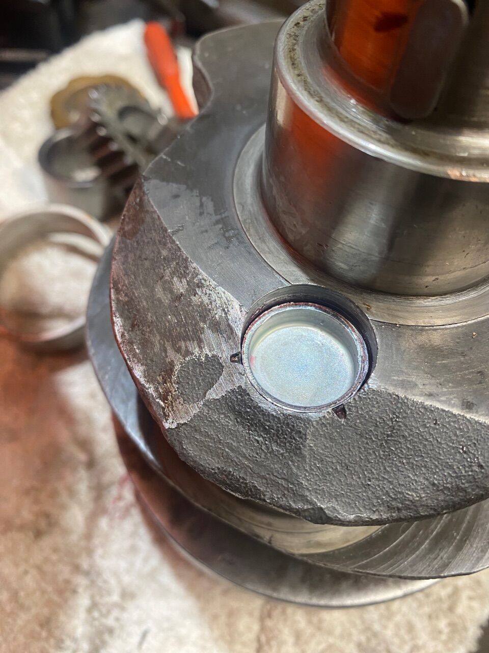

Oilway caps have been refitted using a Loctite sealer, the type Dez’s earlier post mentioned is now obsolete but I had some sealer on the shelf which ticked all the boxes.

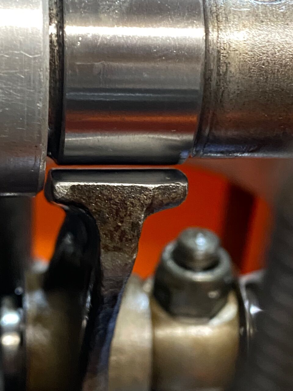

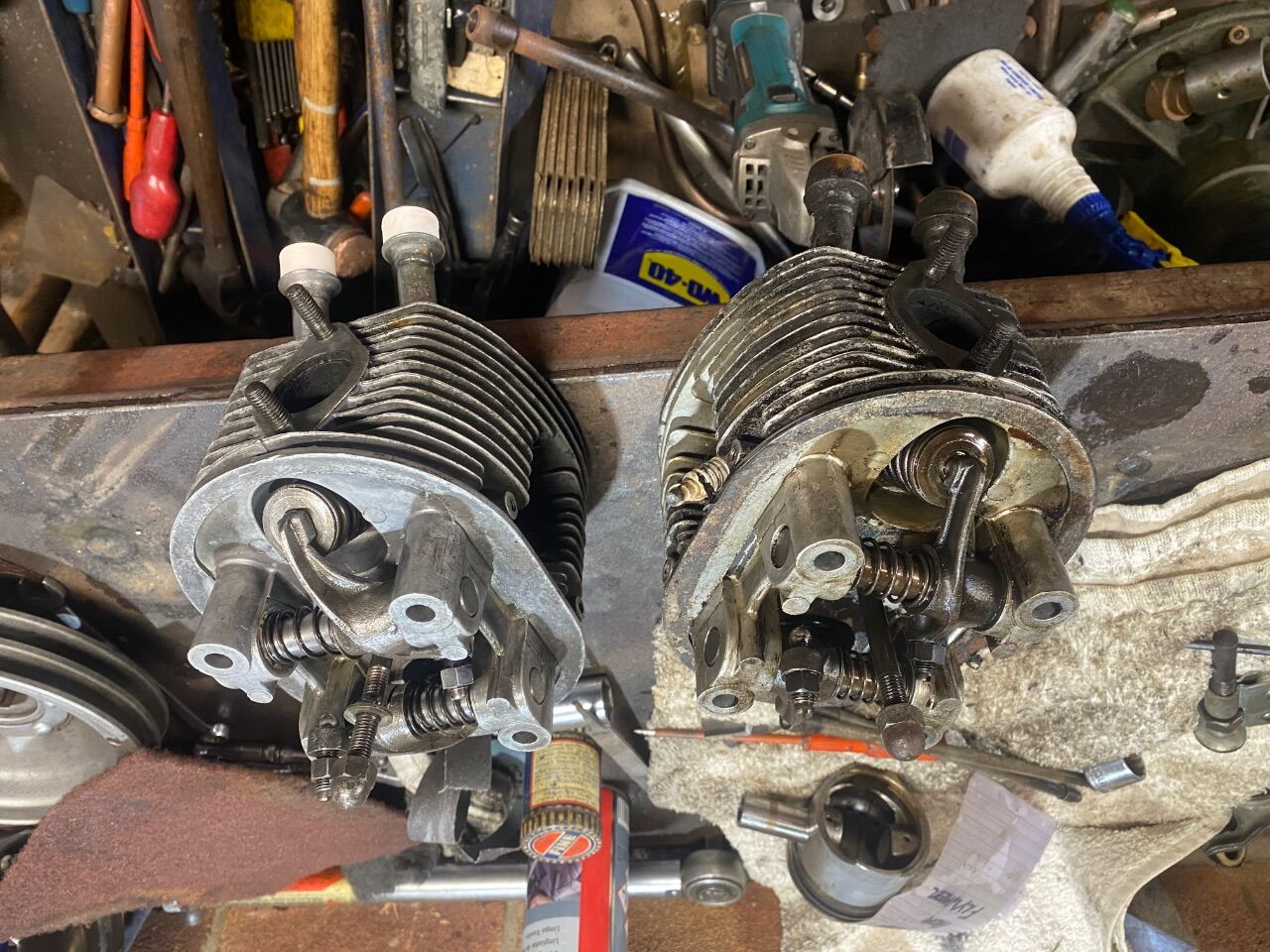

Attention then turned to the cam followers which a couple of were not making perfect even contact with the cams which would cause premature and uneven wear. They were “tweaked” by simply using brute force and a suitable lever to bend the metal until the faces mated perfectly.

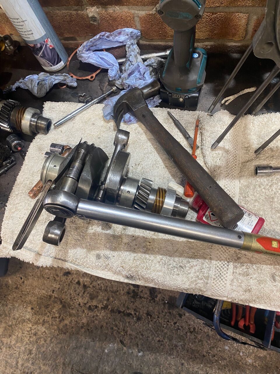

Conrods back together using feeler blades wedged between halves and web to ensure alignment. Then torqued up and peened for security.
601 retainer? Most excellent stuff.
Precision work!

The bottom end is back together, sealed with my old favourite stag Wellseal. Quite a fiddly little job trying to get the bearings to all line up with their respective locators while suspending the crankshaft while try to avoid redistributing the sealer. I could have used a third hand but got there in the end.

I tried a test on m8 bolts & nut left to set in the bench vice compared with 242. Tried undoing ttge 601 nut and sheared the  bolt, 242 came ubdone as expected.

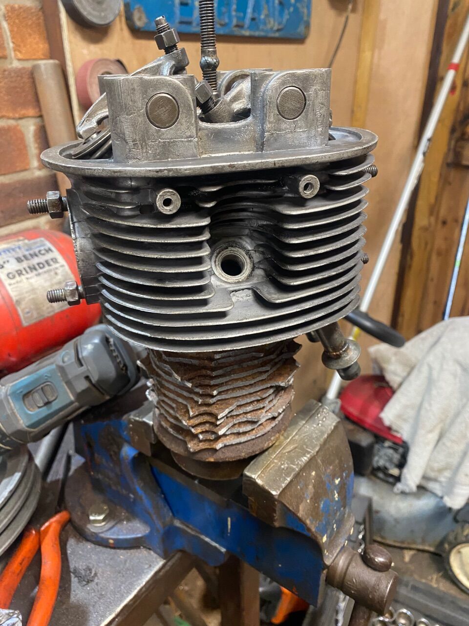

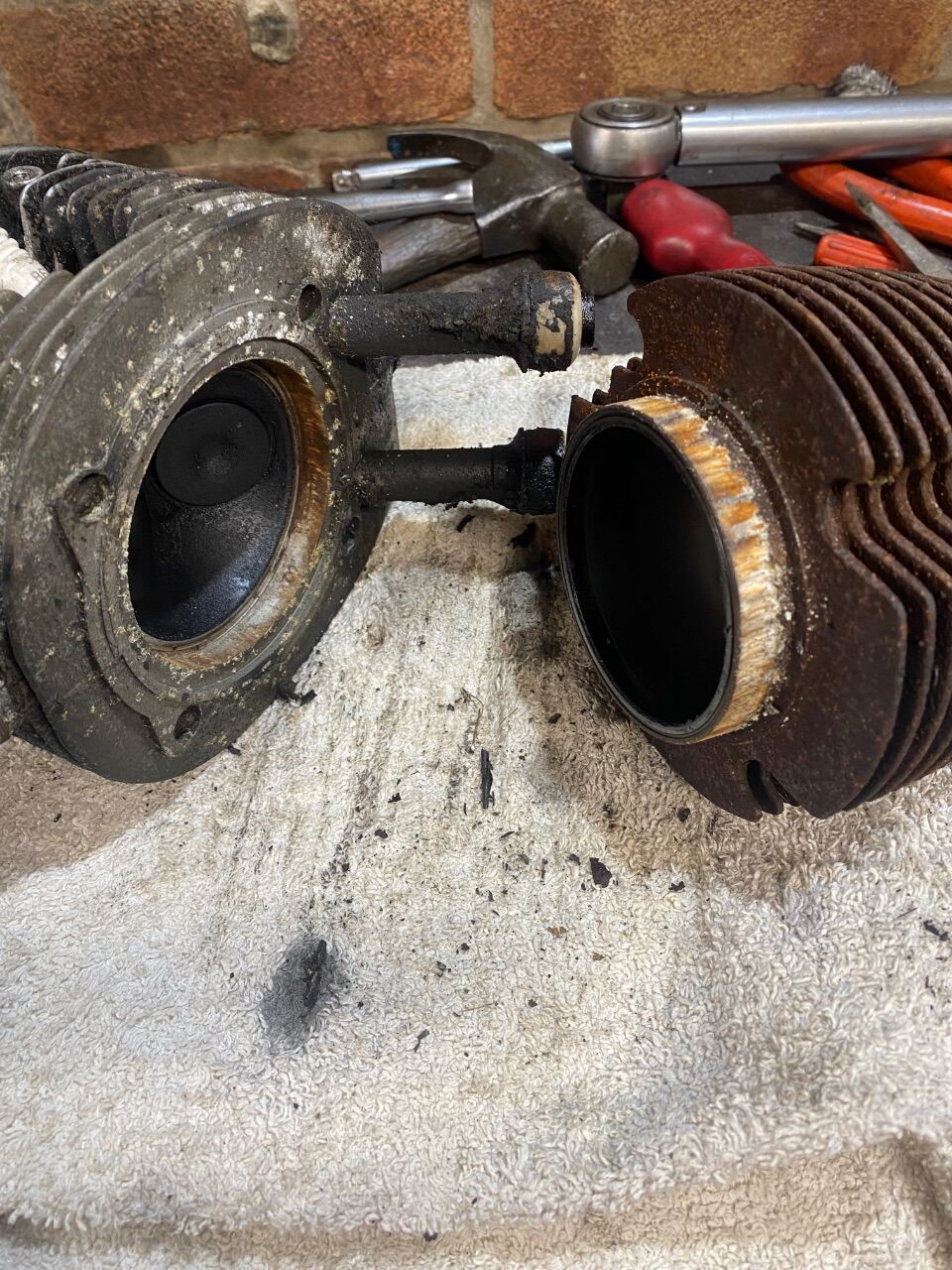

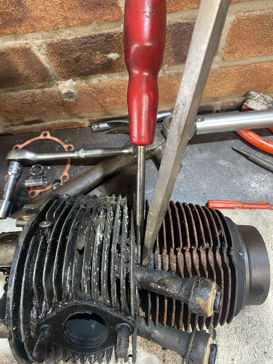

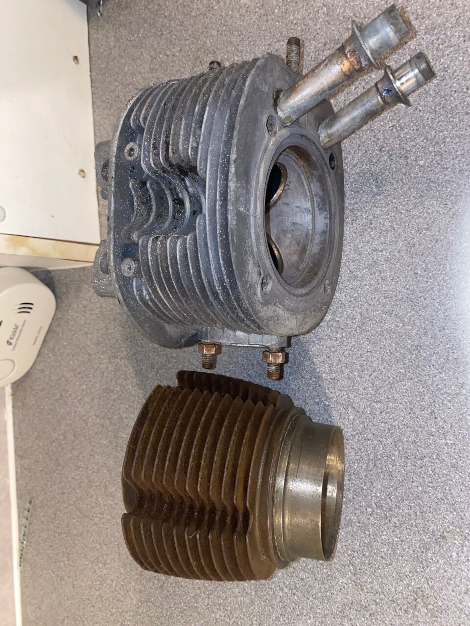

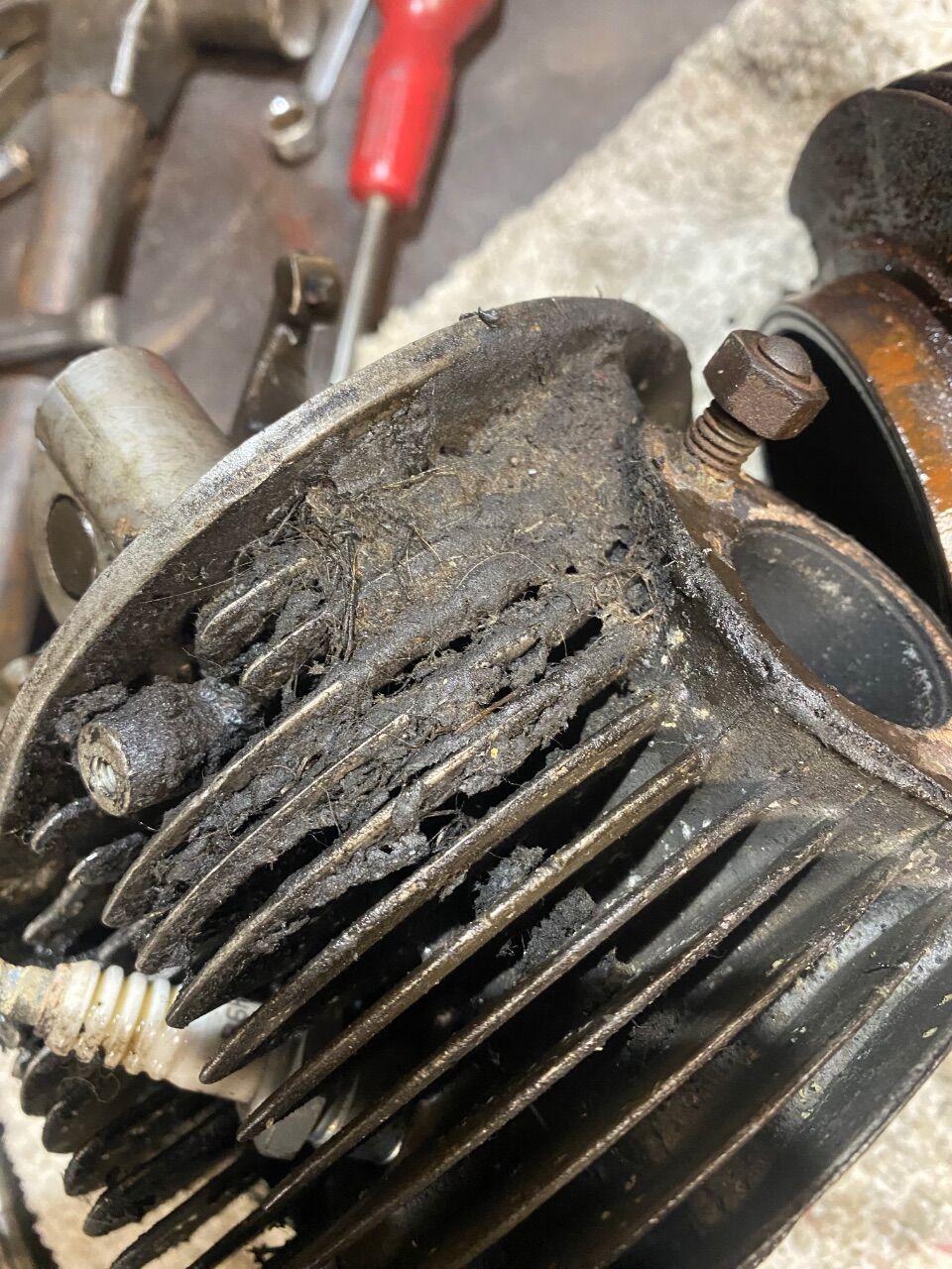

Moving on to the top ends, I started by giving them a clean off. Cooling must have been somewhat impaired by all the crap in there including tarry oil deposits, Bird Cherry seeds ( left by Mr. Mousey and also a spark plug tit that somebody somewhere, somewhen was baffled as to where it had gone!
 I was a bit apprehensive about what splitting the head from the barrel would hold in store but with some prying at the strongest points of the castings and avoiding damage to the fragile fins, they parted without too much effort.

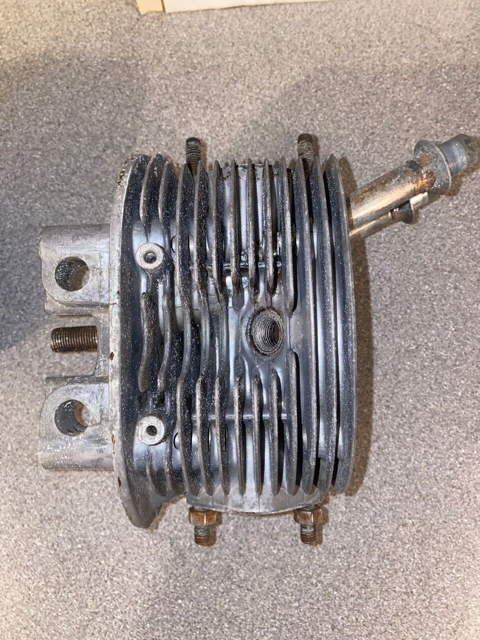

A protracted blasting with the pressure washer, a cycle through the dishwasher and some scotchbright later and the barrel and head were looking good enough to start work.  I have to say, the castings are lovely, in particular the head is a work of art! However , I was not happy with a previous repair to the rocker cover stud, it has been sheared, threaded and sleeved to accept an Allen cap head bolt which just doesn’t look right.

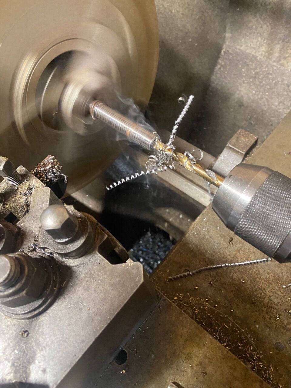

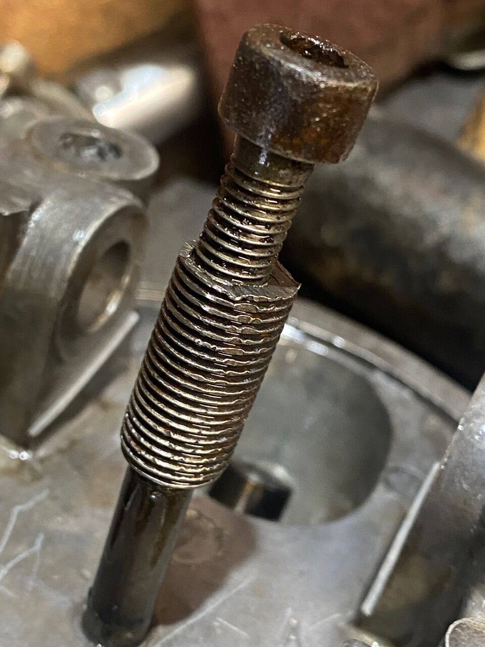

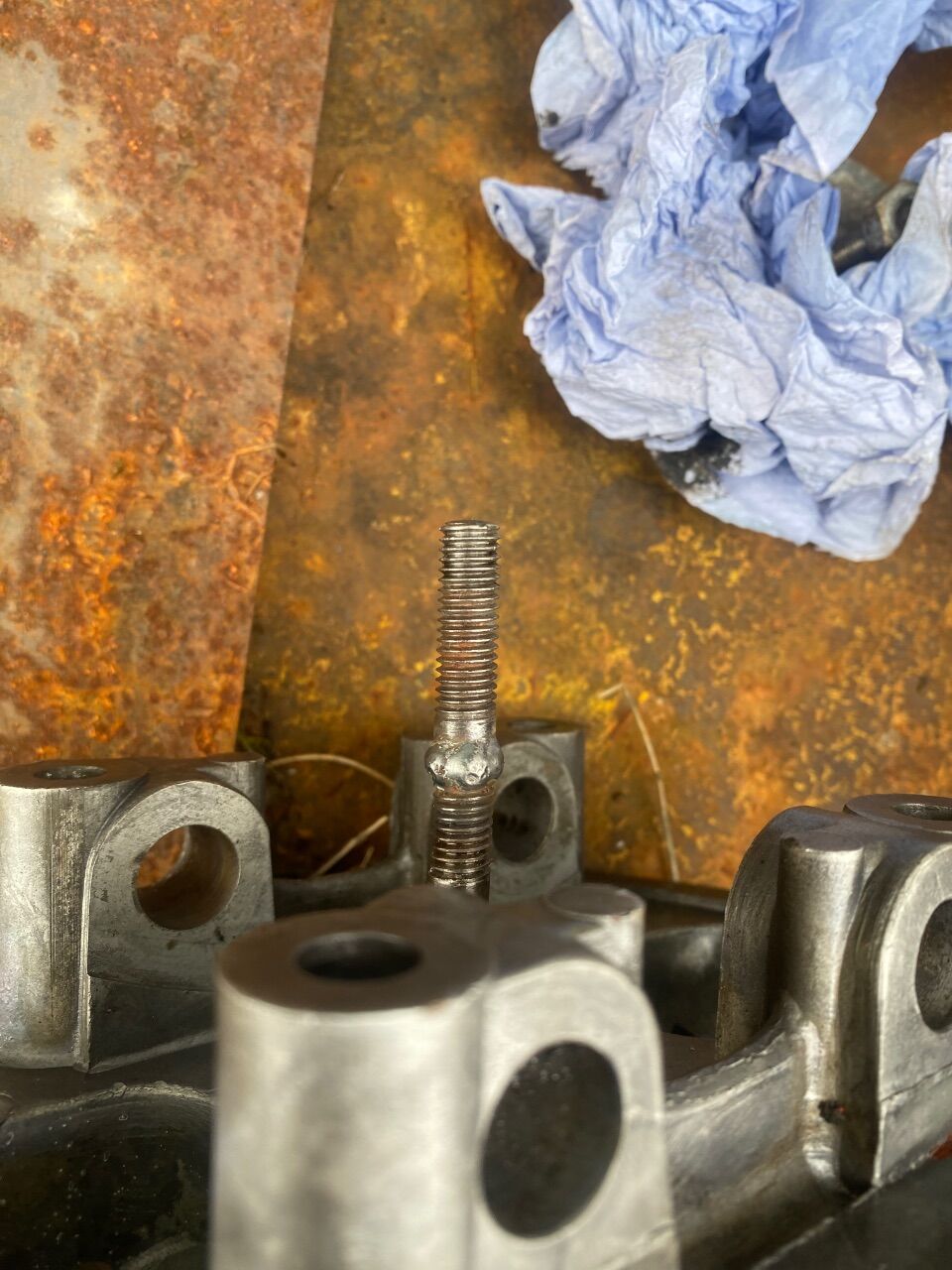

I did try to remove the stud on a couple of the knackered heads from the scrap engines to no avail, even after a lot of heat was invested. I came to the conclusion that these studs may even be cast into the head?
It was decided to weld a new end onto the existing stud, so a suitable brace was made to ensure alignment when setting up the weld. I also ensured it would end up at exactly the length of the original, which I didn’t realise at the time but this actually works to stand the head at the correct angle to work on valve seats when inverted.

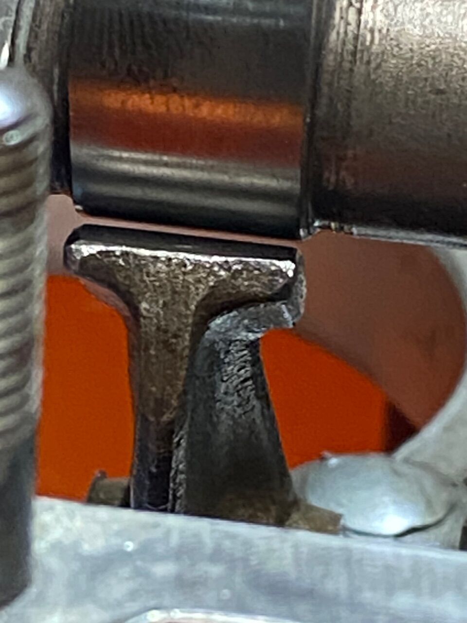

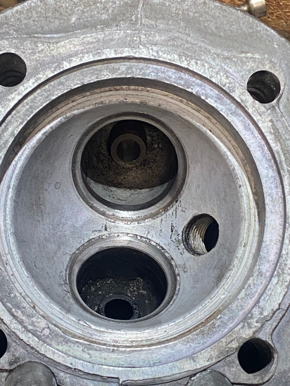

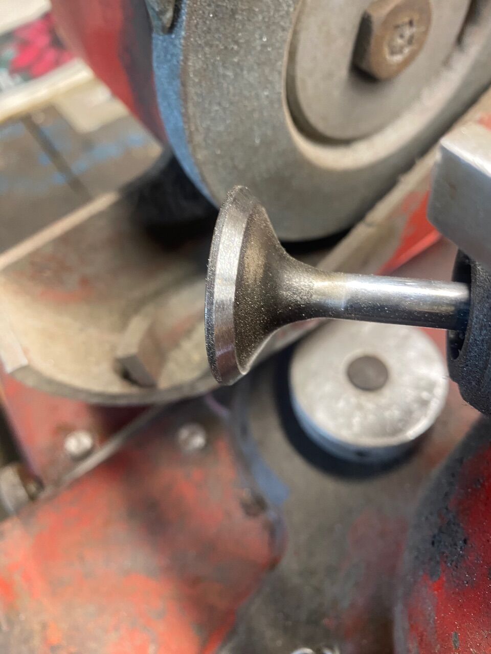

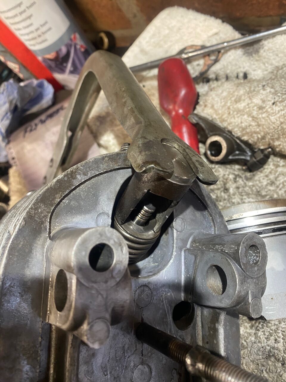

So then onto valve grinding, the faces did have quite a step in them so I pulled out the lovely old Wolf valve grinder that I saved from a skip some years back. A lovely piece of kit it is too.
the seats were actually pretty good and I decided not to cut them. I stopped in at friends to see if I could borrow a suction cup as mine is AWOL and being Sunday I couldn’t buy one. Anyhow, he did one better and produced an “Easy Lap”. I’ve never seen one before but now want one, it fits in a drill chuck and has a suction cup the other end which rotates small increments back and forth exactly as you would when manual lapping. It was then when the head was placed upon the table that I realised that the rocker cover stud length brings the valve seats parallel to the chuck!
I forgot to mention that using a conventional valve spring compressor doesn’t work due to the angles and recesses, a little open sided bucket was made to work with the compressor. It did the job and just allowed enough access to remove/refit the collets

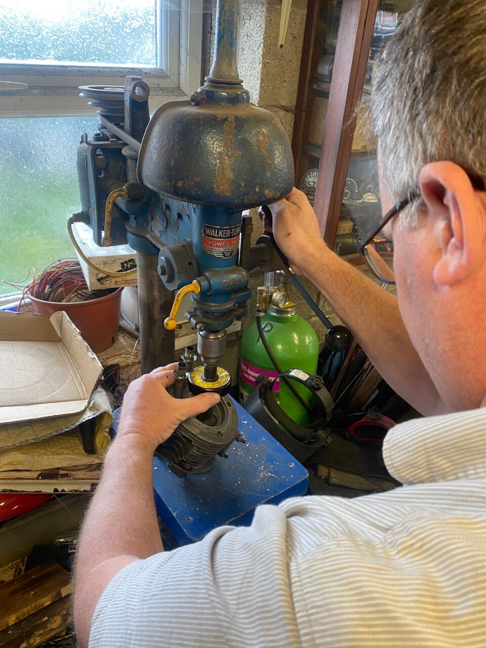

Using a barrel from a scrap engine that already had broken fins, I knocked the rest of the fins off and used it to lap the head (metal on metal seal, no gasket). One top end nearly ready, next to its partner that awaits the same attention.
follow the clues...
on the pavement

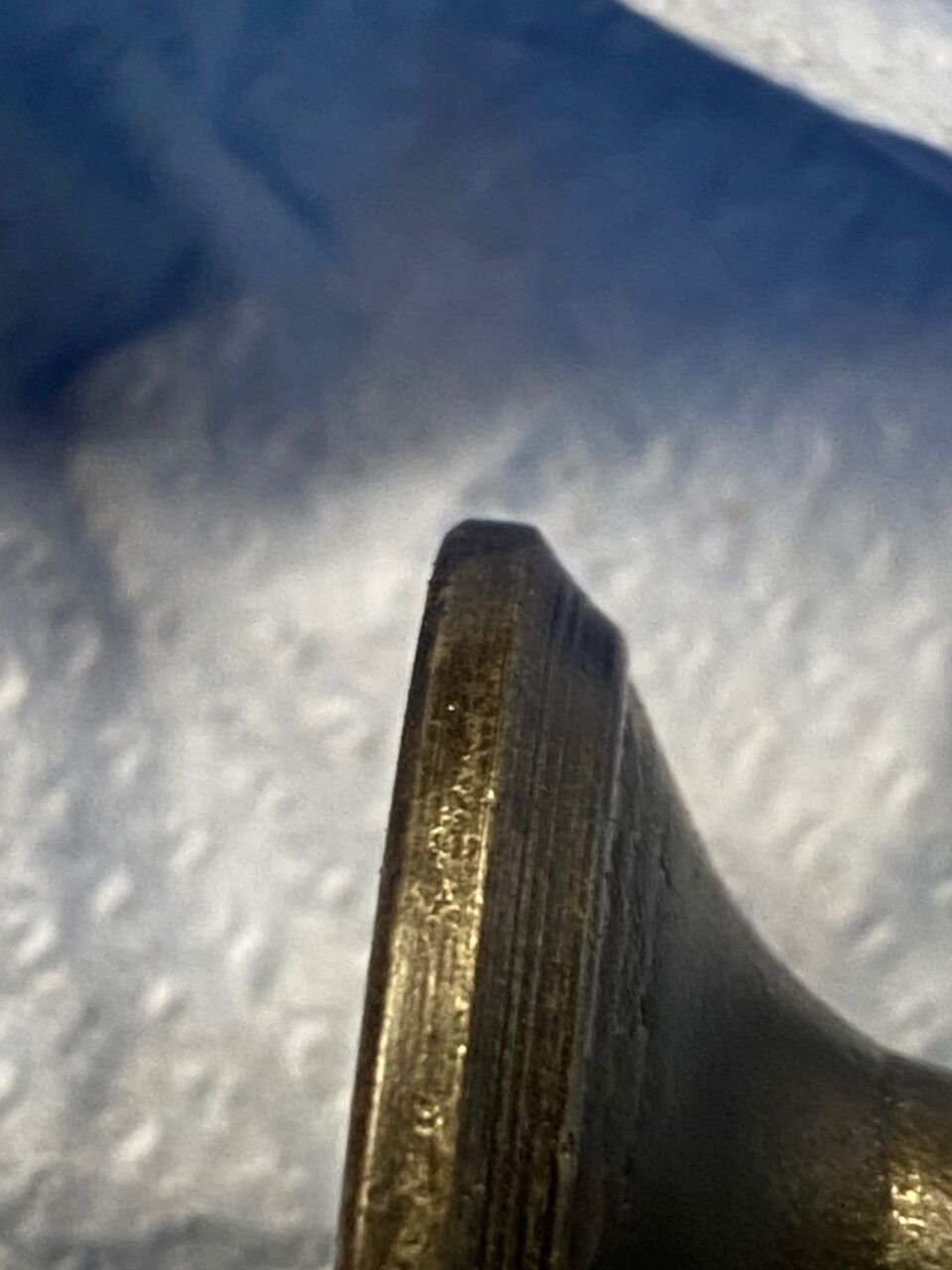

That adjuster looks fine, you shouldn’t have much worry with it, stick some decent penetrating fluid on it a day or two prior( not crap like WD40). It’s actually very good looking. The three bolts though, one is a little elusive (up underneath) but will be fine with your brothers help and diagram to hand. Personally, I’d be happy with the belt you have.
Back to your points, they don’t look pristine but also have a spark erosion pock mark centrally. Either a proper points file, nail file or even wet or dry will address this with a little time. The pock mark was probably formed by a weak condenser causing sparks at the points, whether it be a condenser past or present.
Y, tho? 😀

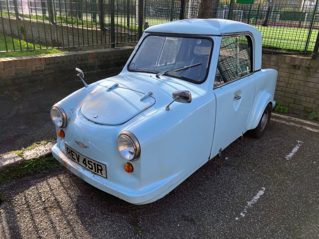

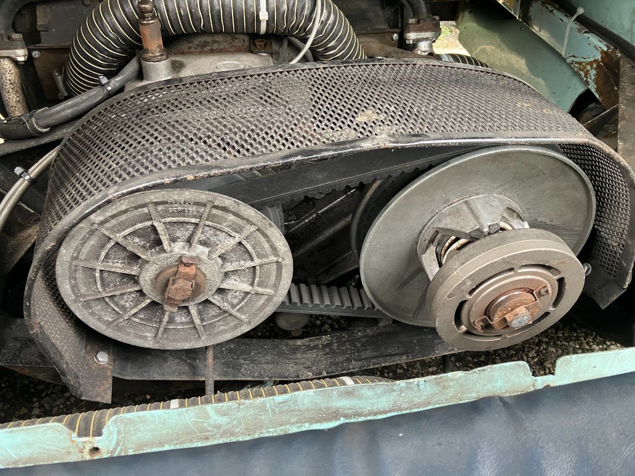

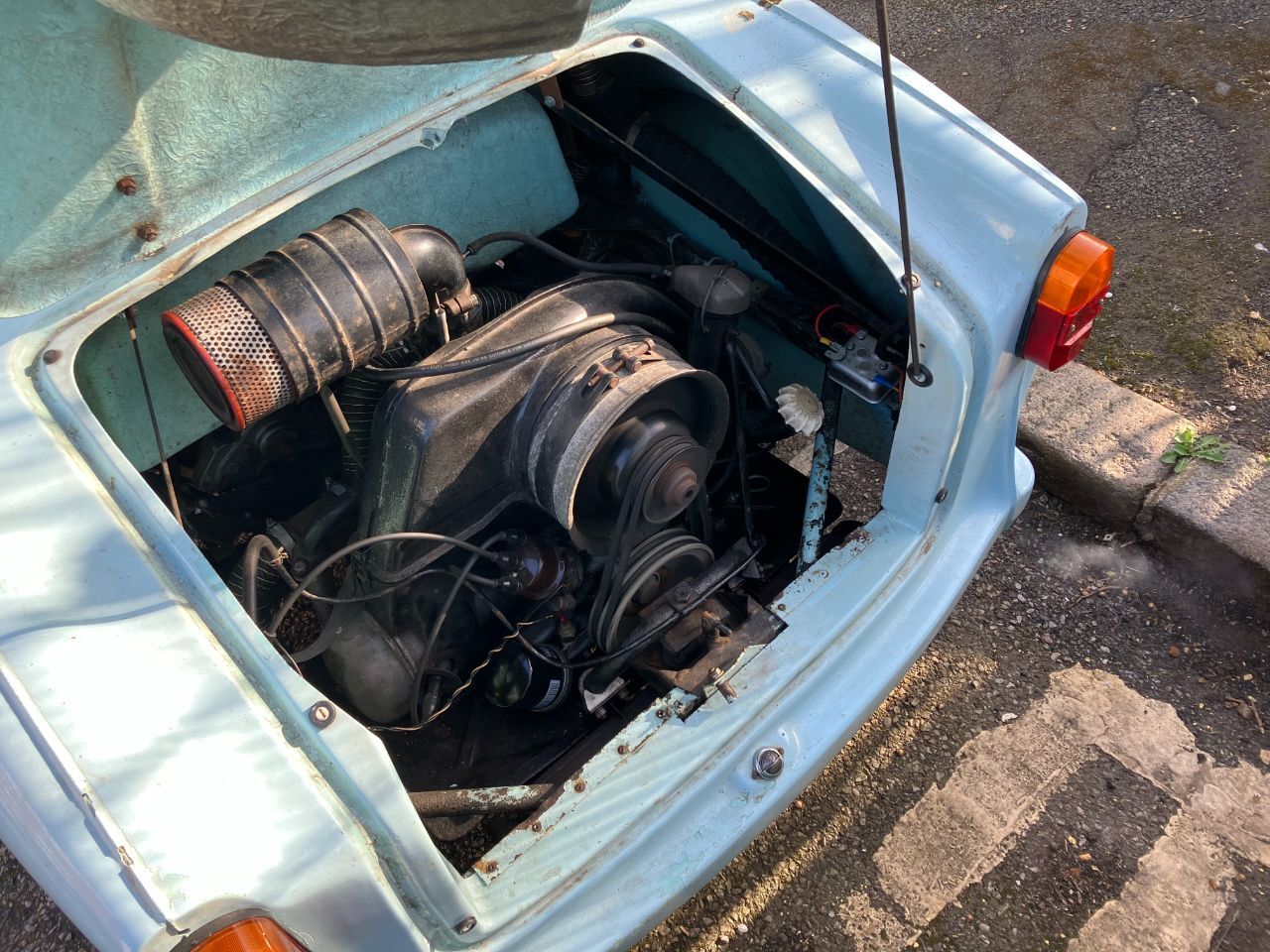

as likely seen elsewhere on the forum, I had good ol jaunt in REV today, up the Flower Farm shop just off Junction 6 of the M25 to attend the gathering of fellow shitters arranged by @inconsistant :)
warming up!
soon up to temp and then on my way, first stop, some petrol, was feeling flush, brimmed the tank, all £18 of it! only 38Mpg this time, but I think there was a bit more City driving and less cruising then on the last couple fill-up's
then hit the road, A12-black-wall tunnel-A2-M25, and got to flower farm right on time without any issues :)
Datman off Retro-Rides (the Chap I got the 1951 Throlux trough reflector fixture from) popped over with his Electric Berlingo and kindly dropped this off for the VDP
then eventually I headed home, the M25, got buggered *just* before my exit,not without reason tho, a 3 car smash, I could not help but notice, that as I drove past the scene of the accident, everyone sitting on the crash barrier, looked up at and towards REV as I pottered on past, I hope I gave them something to smile about in an otherwise distressful moment in time! (or hopefully I did not cause someone to think they had a concussion and where now seeing things!)
but 85 miles where covered without a problem! cruised at about 50-55 on the way there and at about 55-60 on the way back, thankfully touch wood it seems the stumbling issues that where present in the last 2 lightbulb collection capers have resolved themselves :) (perhaps the old hand on the carburettor trick managed to do something this time!)
very pleased REV is back to performing as she should, and I actually managed to get to the Flower Farm gathering unlike last time
there a few rattlings and squeaks that have developed over the last few months, that I probably should try and figure out whats what! theres a squeak in particular that happens when I go over bumps, coming from the front, I cant tell if its the front suspension itself squeaking or something in the bodywork squeaking LOL, ill have to try and record it and see what the Autoshite hive-mind makes of it, I tried a few times to just bounce the nose of REV when stationary and it does not do it then, its only when on the move and you go over a bump, and of course I need to do something to fix that wing mirror properly! I might take the opportunity to get a Convex Mirror for it, REV has a Convex Mirror on the offside and a flat mirror on the nearside, interestingly the VDP has the same arrangement, a Convex Mirror on the offside and a flat mirror on the nearside
I wonder why that is? why not just have convex on both sides for the wider field of view? figured I should ask incase theres a good reason I am missing before I do fit a convex mirror in place of REV's nearside flat mirror (I Much prefer the convex mirror as you get a wider FOV)
Flat glass gives a more accurate and less-distorted judgement of distance.
