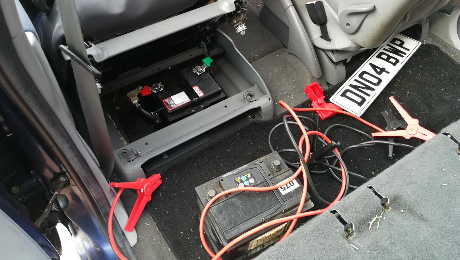

Dont know how long you mean to keep it, but would one of those quick release battery clips be any good.
https://www.amazon.co.uk/Qiorange-Release-Terminals-Motorhome-Terminal/dp/B075JCNMDC/ref=sr_1_7?ie=UTF8&qid=1533385820&sr=8-7&keywords=battery+release
Used one on a car with a battery drain. Peace of piss to fit, and really easy to use.
The original clips are quick release, and it seems to do the 'fail' regardless of whether the battery has been disconnected or not..

If the battery loses charge when disconnected, the battery is deceased. No?
Shurely shome mistake?

If the battery loses charge overnight when it's disconnected - when even in darkest Lanarkshire, the lowest overnight temperature is still in double figures - how can it be in good order?

Halfords or any decent factor will be able to test it for you. Halfords trade card at the ready for you if need be
Sounds daft but how dirty is the top of the battery? I have heard tales where over time dirt/grease/etc builds up and eventually causes a resistive electrical path between the two terminals. Thus causing a slow drain.

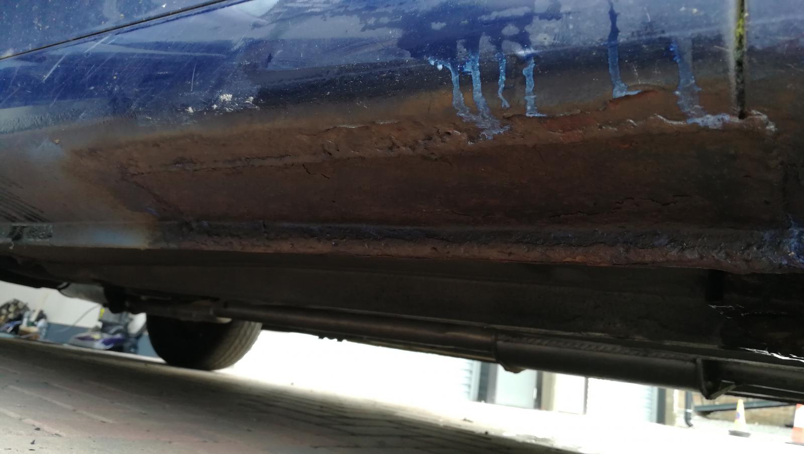

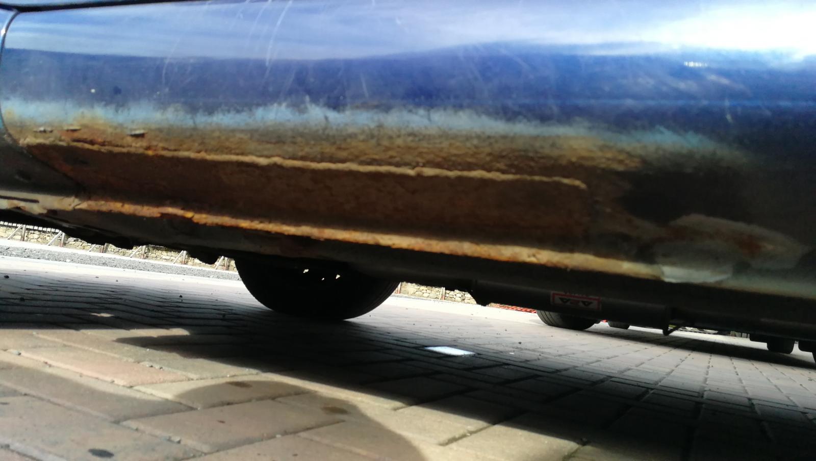

First things first, the place they all fail
The fronts of both sills have been welded. All seemed solid, if not concourse.
I did my bit and slapped on some rust converter!
We also saw fit to try and do something about the non start issue - as Bavarian Retro says, the battery was a suspect.
The passenger seat is tipped forward by pressing 2 small tabs under the seat.
We undid 1x 10mm nut at the front of the clamp, and 1x 10mm bolt at the back of the clamp ( kinda hidden by the plastic, but easy to find by feel).
Then remove the two shitty "quick release" clamps, and the battery just lifts out.
Another battery was fired in and connected up.
The car fired first time.
We switched it off and gave the interior a clean and hoover - also paying some attention to check the fluid levels under the bonnet. It came up ok, and the fluids were fine bar the screenwash.
It started off the key so we drove home. I have parked it up and locked it via remote (after checking I could get in with the key if needed).
I'll leave it overnight and see what happens. The battery is connected.

RML2345 has informed me that the battery removed was a BRAND NEW one from ECP...

In other news, it unlocked off the remote this morning and started ok.
Has successfully restarted twice since then.
Will need to leave it longer to see how it performs.
It must have been the dud battery then, I for one have NEVER heard of a single electrical gremlin affecting a French car.
