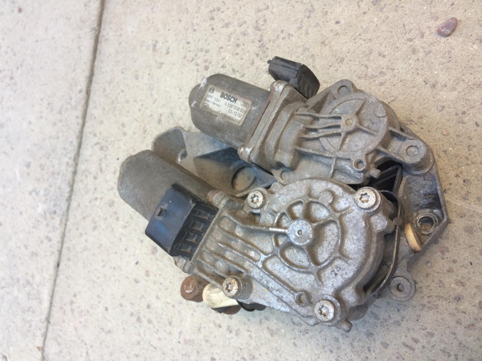

Lankytim Posted July 4, 2018 Posted July 4, 2018 Hi all. I’ve been given a 2004 Fusion 1.4 pez auto with a gear fault. It was stuck in reverse so I googled the likely fault and removed the gear actuator, expecting it to be seized up. It wasn’t and as I’ve disturbed the precise positioning of the selector motor the engine won’t even fire up anymore. Has anyone got any experienceOf fixing these? Is a manual conversion using a donor an easierRoute? Help!

dave21478 Posted July 4, 2018 Posted July 4, 2018 I dunno about the ford system but when I had the C2 vtr with a robotronic box, the Citroen diagnostic system had all sorts of modes for positioning and calibration. Perhaps forscan would be worth a try?
Captain Furious Posted July 4, 2018 Posted July 4, 2018 Yeah another vote for Forscan, I don't know specifically if it can do it, but its probably your best shot without spending money If that fails, squash it. Fusions are bleak.
Lankytim Posted July 4, 2018 Author Posted July 4, 2018 I know the manual conversion has been done before, it’s relatively easy as you keep the original box and just add a clutch pedal and assoacialted bits along with gear cables and gear stick. I think the ECU needs changing though

dave21478 Posted July 4, 2018 Posted July 4, 2018 I know the manual conversion has been done before, it’s relatively easy as you keep the original box and just add a clutch pedal and assoacialted bits along with gear cables and gear stick. I think the ECU needs changing though Again, this is C2 specific, but you get the idea... The manual conversion is physically easy...everything just bolts up from a donor car, but the electronics need a little thought. The gearbox has its own ECU which you can bin off, but the engine ECU needs told that there is no longer a gearbox ECU, as it needs some inputs under certain conditions...ie it wont let the engine start unless it gets a signal saying the box is in neutral. You can either make the changes with Lexia or swap the ECU for a manual one, but that opens the can of worms, needing immobiliser, transponder chips etc all swapped too.I would guess the Ford is vaguely similar. egg, Lankytim and clayts450 3

Lankytim Posted July 4, 2018 Author Posted July 4, 2018 These things don't have dual clutches or anything, they're literally just a standard manual box with a mechanical monkey bolted to the side to do the cog swapping for you. AFAIK most HGVs have the same set up. After doing a little research I think someone got one running by putting a switch direct to the starter solenoid and getting it running that way. I'd like to get this fixed, it belonged to the inlaws, and before them my own Mum owned it and is in pretty good shape all round. Apart from this and a coil pack hasn't put a foot wrong in 10 years or so. Plus it's got a fresh MOT, 4 new tyres and a full tank of petrol. There's actually a crashed fiesta just round the corner. I may have to make enquireys.... GrumpiusMaximus and egg 2

castros_bro Posted July 5, 2018 Posted July 5, 2018 Hi, I have experience of repairing these, where in our glorious country are you? Initially you need to know you have probably not buggered any precise positioning. The two motors/actuating bits each have three positions as in a manual gearbox, one motor produces the left/right movement the others does the for/aft movement. Usually there is a display with the gear on the dashboard, you can only start the engine if "N" is displayed 1 3 5 N2 4 R When you turn the ignition on there should be a whirling and clunking noise and the motors both select their mid positions which put the gearbox into N (natural) , the motors each have built in position sensors to tell Mr. computer which position they are in. On your photo at about 4 o'clock there is an off white plastic cap, this is the end of a blind plastic bush which is part of a rack and pinion set up, if you can remove the rack part so you can inspect this plastic bush internals you'll probably find it damaged and preventing the rack moving fully. Lord Sterling 1

Lankytim Posted July 7, 2018 Author Posted July 7, 2018 I’m in Stoke on Trent, I have indeed buggered up the motor positions when I took the motor off to inspect the rack. I expected it to be seized but it wasn’t so spun the motor around to see if it was seized, it was a bit stiff at first but obviously doing that caused it to lose all sense of what gear it’s supposed to be in. When I put it back together I made sure it was in neutral but after a second or so the gear indicator on the dash when blank, it won’t turn over now either.
