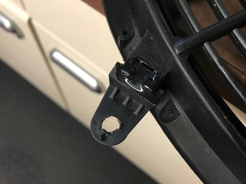

Peter C Posted March 9, 2019 Author Posted March 9, 2019 I purchased a 16" fan and thermostat kit via Ebay, all in £45 inc p&p. Weather conditions weren't great and as my W123 doesn't know what rain is, it stayed in the garage. Consequently working conditions were a little compromised. The instructions for the conversion kit suggest that the fan should be fixed directly to the radiator. From what I gathered that would involve extending cable ties through the radiator core, resulting in irreversible damage to the radiator fins. Instead, I removed the fan shroud and decided to fit the fan to the shroud instead. A 16" fan is a perfect fit inside the shroud. I used cable ties to secure the fan to the shroud. Everything lined up perfectly and there is plenty of clearance between the water pump shaft and fan. The fitting instructions recommend that the electrical supply is switched via the ignition. The only ignition switch live that I know of feeds the radio and not wishing to interfere with any other wiring circuits, I decided to take a feed from there. Unfortunately this meant having to remove interior trim to extend the wire into the engine bay. I have connected the electrical feed to the fan via a 30A relay. It's been a while since I last wired in a relay and I had to get instructions from the net. With everything fitted and connected, I turned the thermostat down to approx 10 degrees C and the fan came to life. I need to test it properly by getting the engine warmed up to full running temperature but initial signs are positive. I will tidy up the wiring once I know everything is working properly. The Moog 1

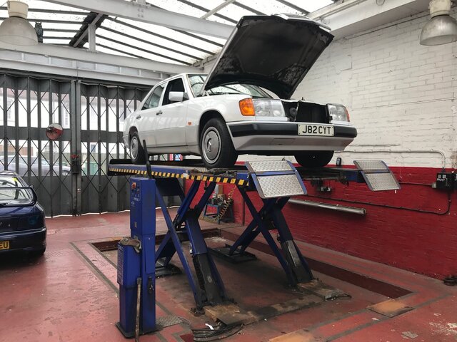

Peter C Posted May 4, 2019 Author Posted May 4, 2019 I took the 200E for an MoT yesterday. I also booked my mechanic, located down the road from the MoT station to carry out some improvements and repairs. The list of proposed works included: 1. Replace gearbox oil. 2. Replace brake fluid. 3. Replace rear subframe bushes. 4. Repair / weld / replace blowing exhaust manifold / gasket / downpipe. 5. Whatever else the MoT man flagged up. The MoT test went well. The tester was happy to let the blowing manifold pass as I told him about the proposed imminent repair. An inspection of the rear subframe bushes also revealed no movement in the rubber elements. My bodge has worked well. The MoT tester advised against replacing these as they can be a pain to remove and from an MoT point of view they are not defective. Later on my mechanic confirmed the same, so they are not getting done. An inspection of the exhaust manifold from underneath the car revealed not a lot. The M102 engine manifolds are known for cracking so it might be necessary to weld up the original - a new one is £££. Fortunately, on the 200E access to remove the manifold is nice and easy. All being well I'll get the 200E back some time next week, with the manifold fixed, ready for another 12 months of happy motoring. cort16, mrbenn, chaseracer and 8 others 11

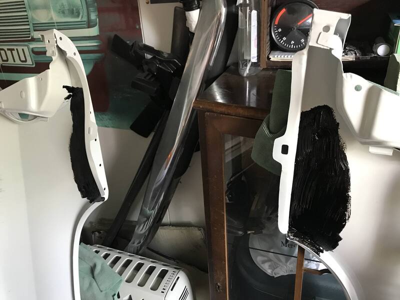

Peter C Posted June 6, 2019 Author Posted June 6, 2019 I collected the new wings from my bodywork guy yesterday, sprayed in Arctic White. I’ve given the vulnerable section of the inner side of the wing a coat of waxoil. I’ll apply two more coats before fitting the wings on Saturday. Can’t wait to get these on. Watch this space. timolloyd, rainagain and mrbenn 3

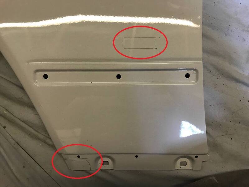

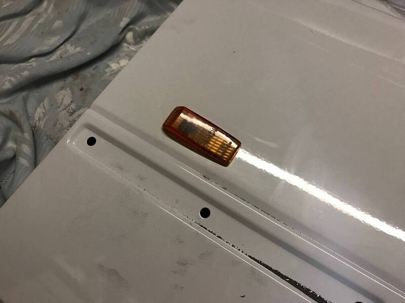

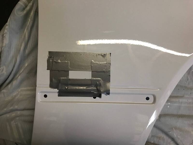

Peter C Posted June 9, 2019 Author Posted June 9, 2019 I am such a tit! The same day that I took delivery of the offside wing, I packed both wings into the back of my Tucson and the next day took them to the bodywork man for spraying. In the process I completely missed the fact that neither wing had a mounting hole for the side repeater. This meant that I had to some tricky cutting to do on a pair of freshly painted wings. I did exactly what Ed China always says, measure twice and cut once. The nearside wing was a genuine MB part whilst the offside was a cheap EBay repro. The MB wing was heavier and the gauge of the metal was clearly thicker, the inner lip around the arch was wider and it did not have a cut out at the bottom front corner behind the arch. A little research revealed that very early W124s, pre 1986, came without side repeaters, hence the lack of opening. The thickness of the arch lip is different on phase 2 and 3 cars. The lower cladding, not fitted to phase 1 cars, wraps around and into the arch and I later found that to re-fit the cladding to my early spec wing I had to cut a piece of plastic to make it fit. The phase 1 cars also came without sill covers. On phase 2 and 3 cars, the sill cover is bolted on to the front section of sill, which is why there is a cut out section in the front section along the bottom of the wing. It is fair to say that the generic approach of selling W124 wings on EBay, based on all being the same from 1985-1996, is complete crap. Gaffer tape was used to protect the fresh paint. I then drilled as many holes as possible to reduce the quantity of metal that required removal. Then came the hard bit, I removed the required amount of metal by filing down the wing with a file, all done by hand. Fortunately, my file was exactly the same width as the height of the opening. Working on the repro wing was relatively easy but getting the job done on the thicker MB wing was hard work. In the end I succeeded, both side repeaters fitted perfectly. I applied a little Hammerite to the cut edges and the wings were ready for fitting. I checked everything over whilst the wings were off. There was no sign of any corrosion within the concealed areas of the chassis. I fitted the offside repro wing first. It fits ok, the shutline against the door is fine, likewise the bumper and around the indicator but whilst the line is correct along the front of the bonnet, it becomes 3-4mm wider towards the windscreen end. There is no way of pulling the wing in as doing so would upset the abutment of the wing with the door, which would look awful. The varied width of the gap is not immediately noticeable and I'll happily live with it. The nearside MB wing fits very nicely. Ignore the uneven fitment of the two panels beneath the headlights, these are coming off today to be tidied up. Colour match is perfect and I got the job done in 6 hours. I'm a happy tit. Royale80, timolloyd, garethj and 9 others 11 1
chaseracer Posted June 9, 2019 Posted June 9, 2019 Nice job. Much better fit than the oh-so-obviously-repro panels on my old 300E!
NorfolkNWeigh Posted June 9, 2019 Posted June 9, 2019 Youve just reminded me of when I damaged a wing on a facelift Mk2 Carlton in the snow , when the Carlton was only about 3 years old. I bought a pattern wing, got it painted and set to changing it one Sunday morning, only to discover, like you, there was no repeater hole. However unlike you, I'm a bodging bastard, so I taped the repeater to the inner wing and bolted the new wing on, inte di g to sort it later... Well, it went through a Council Taxi test and an MOT without anyone noticing the repeater on the offside only and the guy that bought it 6 months later didn't notice either. I often wondered if when that bulb taped into the wheelarch failed and the others flashed more quickly, how long it would take to trace that fault. Incidentally that Carlton was a J reg 2.0 GLi and almost a competitor to your 200e when new, except the Merc would have been priced closer to a fully loaded CDX, ( probabl even a 2.6) the spartaness of the Merc makes it so much more appealing now. I've since learned my lesson and have a bASe e-class for work. Peter C and Shep Shepherd 2

HMC Posted June 9, 2019 Posted June 9, 2019 Easy to be caught out with merc wings. Early w210s have a repeater hole, late ones don’t (it got incorporated into the wing mirror assembly) they also slighly facelifted the whole front metalwork so although looking similar, don’t fit at all.
Conan Posted June 9, 2019 Posted June 9, 2019 The only reason repeater holes aren't drilled is because in the rest of the world, even on Phase 2 and 3 cars don't have them. They're exclusive to the very few market requiring them. Even in Germany or the US the Phase 3 car wouldn't have them.
