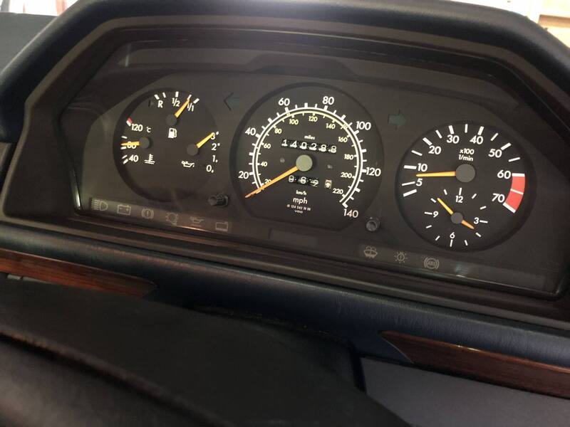

Peter C Posted April 1, 2020 Author Posted April 1, 2020 On 3/30/2020 at 9:08 PM, GBJ said: This has probably been covered already, but how do you know it is running cool? Maybe the sender or gauge are wrong? Because, when driven at low speeds in an urban environment, the engine temperature gauge indicates that the engine has reached its correct operating temperature and as the gauge reaches approx 90 deg C, the electric fan, which I've set to kick in at 90 deg C, kicks in. Yesterday morning I made an essential 35 mile journey along the M40, M25 and back home the same way. On the motorway, the engine temperature reached: However, once I came off the motorway and drove through town at speeds of less than 30MPH and reached my destination, the engine was operating near enough at its correct temperature. On route home I pushed the 200E up to 90MPH on a completely clear stretch of the M40. Once I got home and the engine cooled down a bit, I removed the expansion tank cap to find no evidence of any significant mayo build up. Deeper in the tank, the coolant was clean. If I have a cylinder head or head gasket problem, it's not massively serious just yet.

Pete-M Posted April 1, 2020 Posted April 1, 2020 That is definitely running too cool. Most Merc engines run at between 90°-100° or they're not happy. Having the electric fan set at 90° won't help as you're cooling the engine just as it reaches operating temperature. I'd set it at 100° ish so it kicks in when things begin to get hot. If you're on the motorway with the fan set at 90° the engine will never get to operating temp. The Mighty Quinn 1

Peter C Posted April 1, 2020 Author Posted April 1, 2020 2 hours ago, Pete-M said: That is definitely running too cool. Most Merc engines run at between 90°-100° or they're not happy. Having the electric fan set at 90° won't help as you're cooling the engine just as it reaches operating temperature. I'd set it at 100° ish so it kicks in when things begin to get hot. If you're on the motorway with the fan set at 90° the engine will never get to operating temp. The correct running temperature of the M102 engine is 87 deg C. That’s the temperature at which my W123 230E has run for the past ten years, rain or shine, ditto all the other W124s that I’ve had over the years. Bearing in mind that the engine temp doesn’t get near 70 deg C on a run, changing the electric fan setting to 100 deg C will make no difference to the overcooling issue. bangernomics and paulplom 2

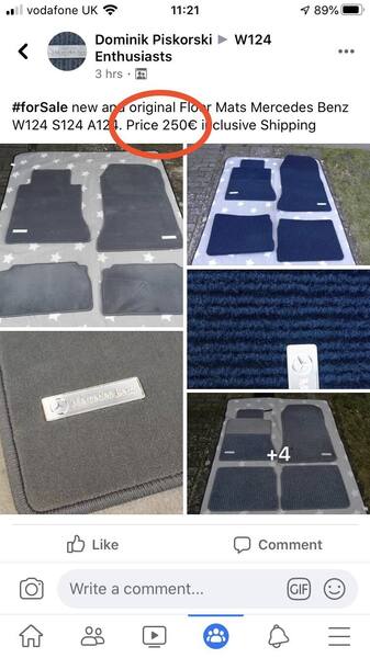

Peter C Posted April 7, 2020 Author Posted April 7, 2020 On 3/30/2020 at 12:20 PM, lesapandre said: Gosh the mats are that valuable! Taken from Facebook.

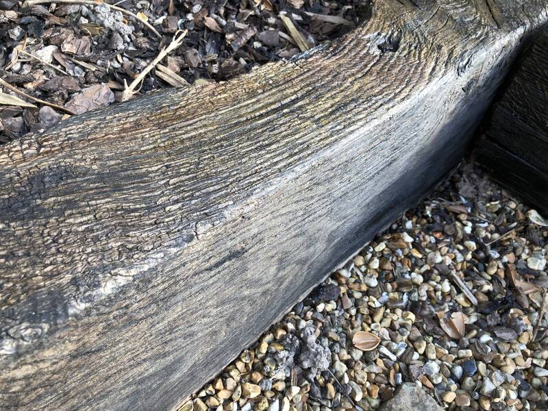

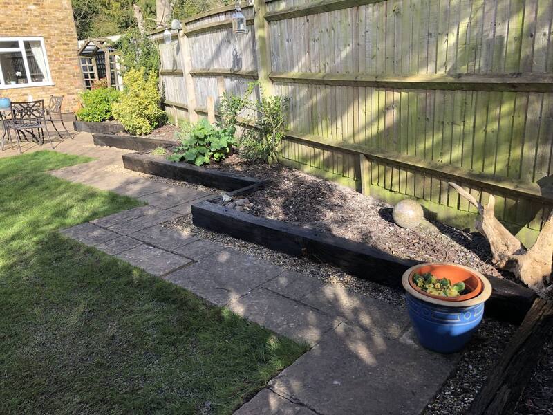

Peter C Posted April 7, 2020 Author Posted April 7, 2020 I’ve been keeping busy during the lockdown. Both Tucsons needed a wash, which killed a couple of hours. Having done a few engine oil changes on both Mercs in recent years, I’ve accumulated a few gallons of used 10W40 oil. A quick Google search revealed that old engine oil makes for a good wood preservative. I have an arrangement of old timber beams making up flower beds in the rear garden. The beams have weathered silver grey and started to look a little unsightly. A quick coat of brushed on old oil sorted them right out. The wood was touch dry within the hour. The oil doesn’t smell and has really brought out the grains. The Mighty Quinn, timolloyd, paulplom and 2 others 5
