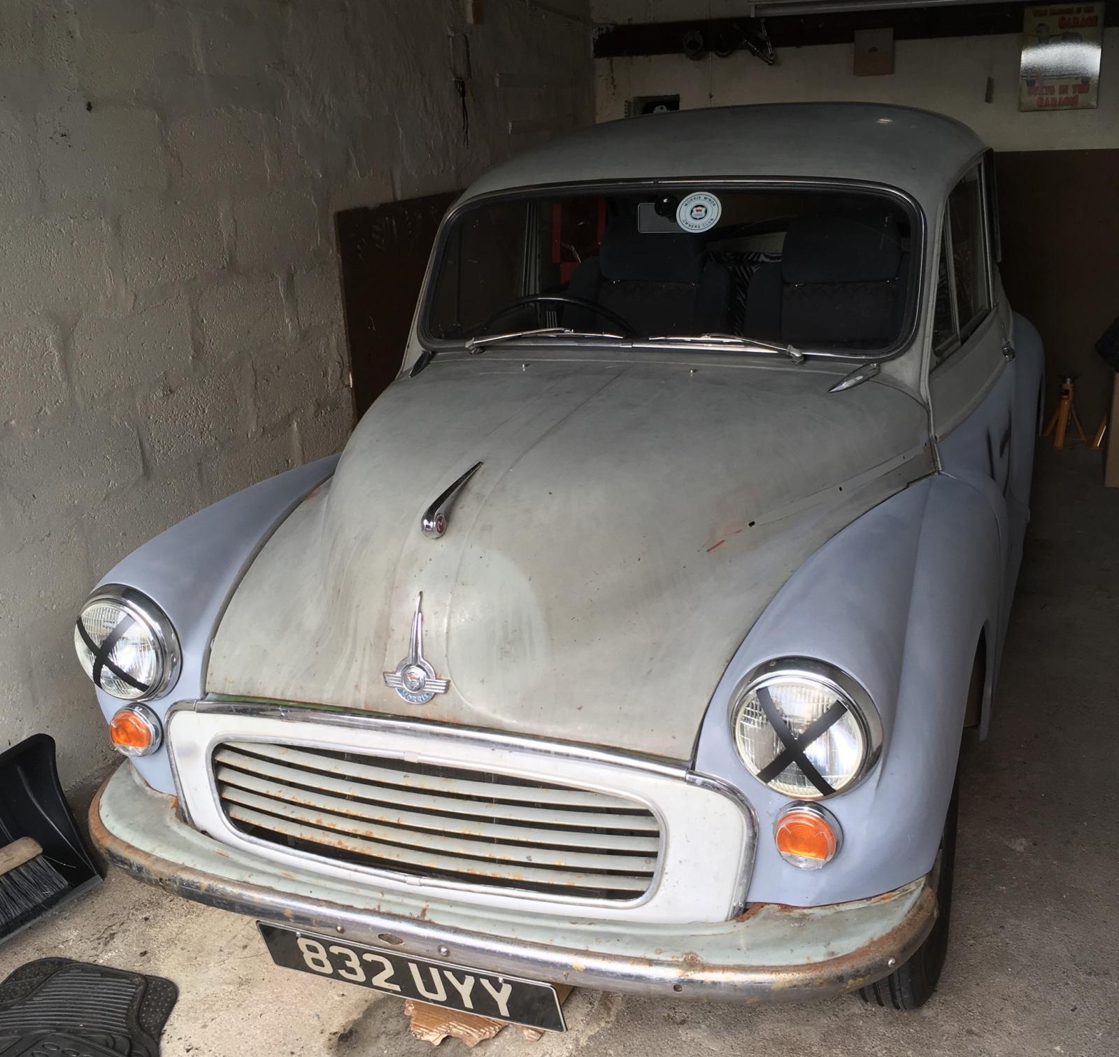

After much thought, I’ve decided it’s getting painted all one colour. Primer grey.
As much as I liked the two tone shabbyness of it, I think it’ll look much neater all one colour. And it also covers up all the writing that got added to the wings at shitefest...

Got the wings all painted, as well as the sides all in primer grey. Personally think it looks a much better now. :)

After a good few months, I’ve decided to put her away for the year into the comfort of the garage (Kicking out the 316).
So over the next few months I’ll get about to tinkering with it. And maybe even fully paint it. Finally got my checklist written out so fingers crossed I get most of it done before the start the show season next year! :)

As much as I want to say it’s came on leaps and bounds, sadly the reason it’s been all quiet here is because I’ve not done anything really...
Its been in my garage since September, getting started up and moved in the drive every so often. On the paint side of things I’ve got one side in primer and tested with a few shades of paint. And that’s it. Ive sadly not had it on the road this year. Priority has been given to other cars, and on top of that the house gets top priority. ?
I always did plan this as a long term thing though, and once the fleets thinned down a bit it’ll be back to work on it.
