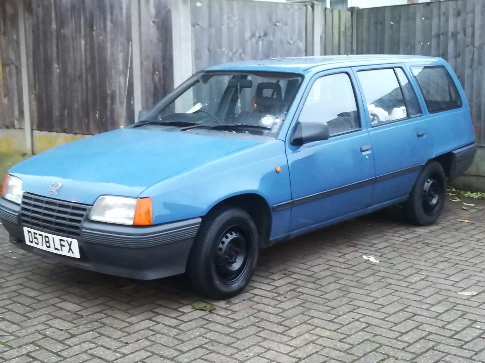

Well, the carb is rebuilt now, ready to go back on.
Unfortunately I've damaged the plastic spacer thingy that goes under, so I was wondering if I could get away with not putting it on and just using the new gasket? Any thoughts?
I think it'll get too hot and you will get fuel vapourising.  You could try it though.  How is it damaged?  Can it be repaired or does someone on here have another one?
I scraped some of the surface off when removing the gasket.
Glass and fine Emery paper so it's perfectly flat and rub the scuffs out gently?
I'm with bub on that.  It is there to stop heat transfer and the surface might need to be smooth, but the actual depth isn't critical.
Ok, good call. I'll set to it tomorrow and get it smooth-ish
In other news, tidied up the steels, as i like the utilitarian look. I've also put some rust killer on the rusty bits and cleaned up the grey plastic.

Well, put it all back together . ... And it started!
Ran well, until it came off auto-choke. Then it cut out. Would restart fine, but not idle. If i manually reactivated the choke, it would run again, until you blip the throttle and then it drops the choke off and cuts out.
Back to the drawing board.
Has the mixture been weakened off to compensate for a non functioning auto choke/emissions?
