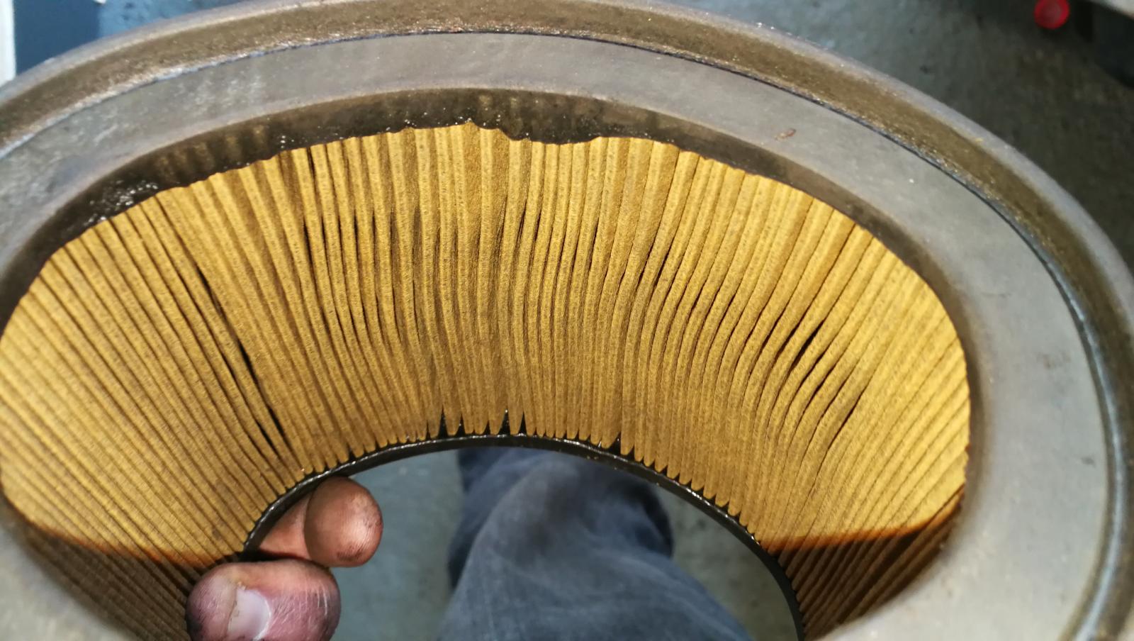

320touring Posted January 19, 2019 Author Posted January 19, 2019 Nice write up with great pictures. Those filters were minging!Thanks! The dearth of info online meant I resolved to try and capture the process so other poor buggers have an easier time of it chaseracer, LightBulbFun and Skizzer 3

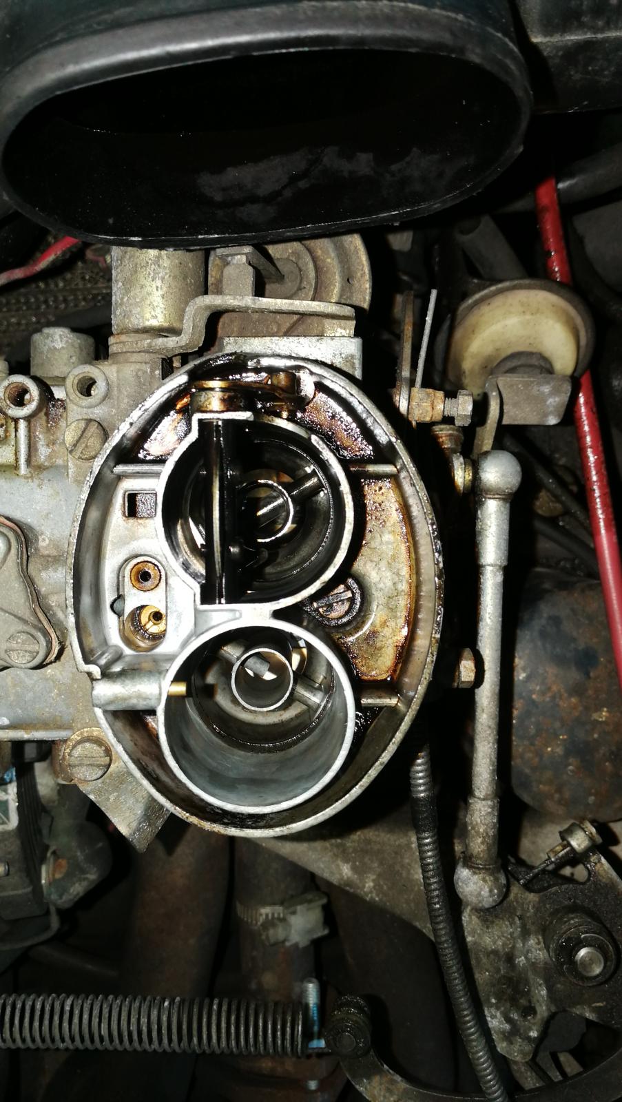

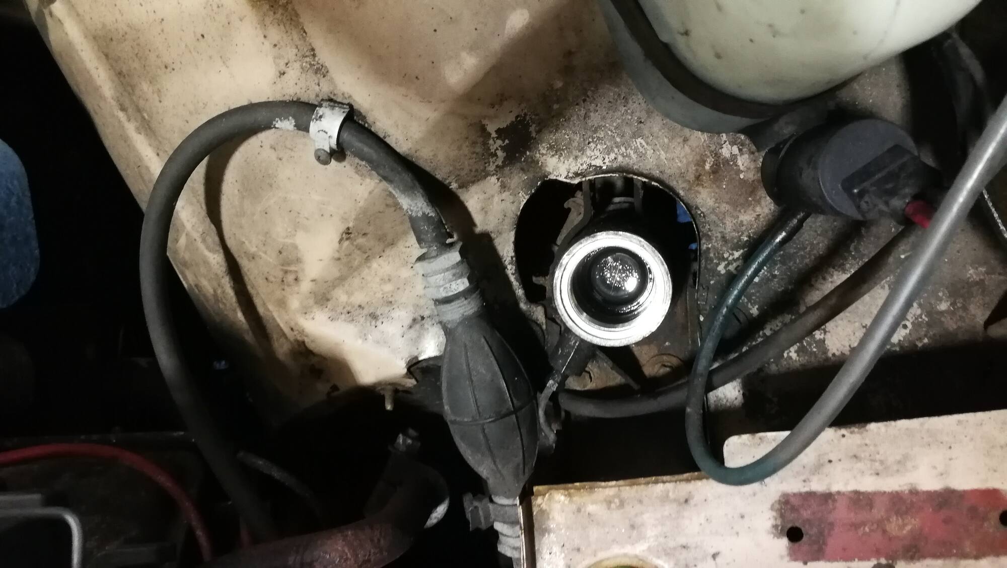

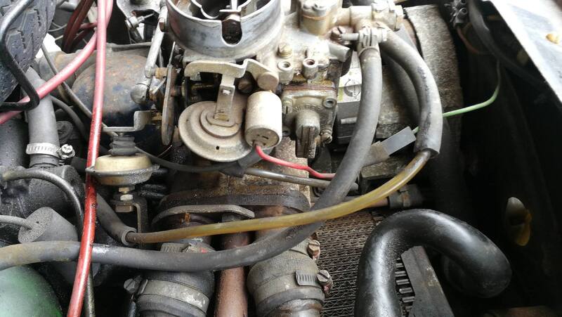

320touring Posted February 15, 2019 Author Posted February 15, 2019 Over the last week while, the Burd and my bro mentioned that the GSA was getting grumpy to start.. I know its been running a bit rich, and the fuel runs back if left for a while. Today, after sitting since Mon afternoon, I went to it and it wouldn't start. No amount of choke/throttle or coaxing got it to fire - despite it coughing. I used the primer bulb on the fuel line (dunno who fitted that?) And it still wouldn't start. Left it for a couple of hrs incase it was flooded and no dice. Any Ideas? I know it's getting spark and fuel (at least intermittently) as it will cough. Battery is strong enough to o have spun it over enough to get the esuspension up so I could push it out the way and get the Merc out instead. Any thoughts/ideas are welcome!
Eddie Honda Posted February 15, 2019 Posted February 15, 2019 It's French, TADTS. Sorry not helpful. The number one pain the bollocks for me was distributors, but a GSA shouldn't be as bad in that department. 320touring 1
RayMK Posted February 15, 2019 Posted February 15, 2019 In different cars which had the same symptoms as yours i.e. gradually increasing difficulty in starting, then wont start but will cough, the cause has been the points gap closing up (heal wear). Resetting the gap restored normal running. Does yours even have points? Before dismantling suspect systems, try Easystart in the intake. If it fires convincingly, investigate the fuel side. If the ignition system is electronic, I'm not aware of gradual failures - it's all or nothing.
320touring Posted February 15, 2019 Author Posted February 15, 2019 Thanks chaps. The plugs can get looked at tomorrow. It does indeed have points, but they are the funny cassette points, and a right faff to get off,adjusted and refitted. If it were points, I'd expect it to be grumpy even when running? - but no issues were reported when in use. My gut says the rich running is at the heart of it - we shall see! Split_Pin 1
Crooner Posted February 15, 2019 Posted February 15, 2019 I don't think it's in anyway a solution to your problem, but whilst tidying the garage I found a GS starting handle/ brace. Free, if you want it. 320touring and Split_Pin 2
320touring Posted February 15, 2019 Author Posted February 15, 2019 I don't think it's in anyway a solution to your problem, but whilst tidying the garage I found a GS starting handle/ brace. Free, if you want it.Thanks for the generous offer I already have a crank handle with my car, but it may worth offering it on here to other owners?
Eddie Honda Posted February 15, 2019 Posted February 15, 2019 It does indeed have points, but they are the funny cassette points, and a right faff to get off,adjusted and refitted. Aye, S.E.V. Marchal. (I don't know if says anything about them that I currently have a Ducellier on the car). https://www.flickr.com/photos/19864651@N00/sets/72157624328682798 https://www.gs-gsa-ig.de/gsa/gsa.zuendung.htm 7) SEV Marchal 41301502 A401 GA8 GD4 24° @2500rpm 1299cc G13/625 Ducellier 525073C GA8 GD4 24° @2500
320touring Posted February 15, 2019 Author Posted February 15, 2019 I have a spare set. Just not taking them Orr unless it's the last thing left:)
dollywobbler Posted February 15, 2019 Posted February 15, 2019 After my debacle, definitely start with plugs! 320touring 1

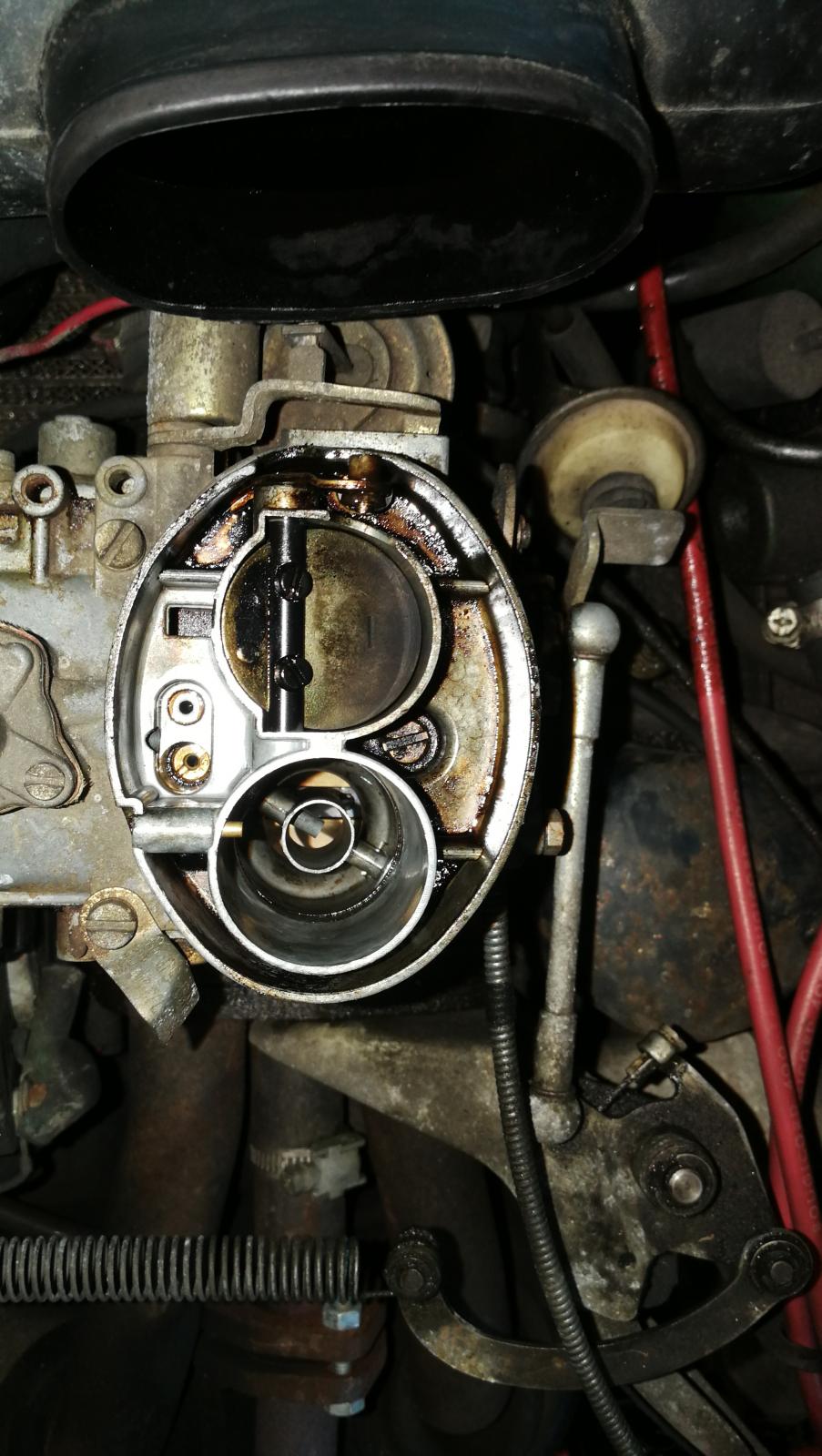

320touring Posted February 17, 2019 Author Posted February 17, 2019 Right, got a look at this today.. Sparkplugs are choked.Have been cleaned and put back in. Apparently, according to several folk (Inc dollywobbler) the carb fuelling is contributing jetting - so I didn't touch the carb settings. Folk on the G section Facebook group suggested the fuel lines In to the carb should be checked. One clip was a bit loose so I retightened it. I think the air filter has seen better days. I also checked that the choke was functioning properly Shut Open The Moog, Skizzer, Eddie Honda and 4 others 7

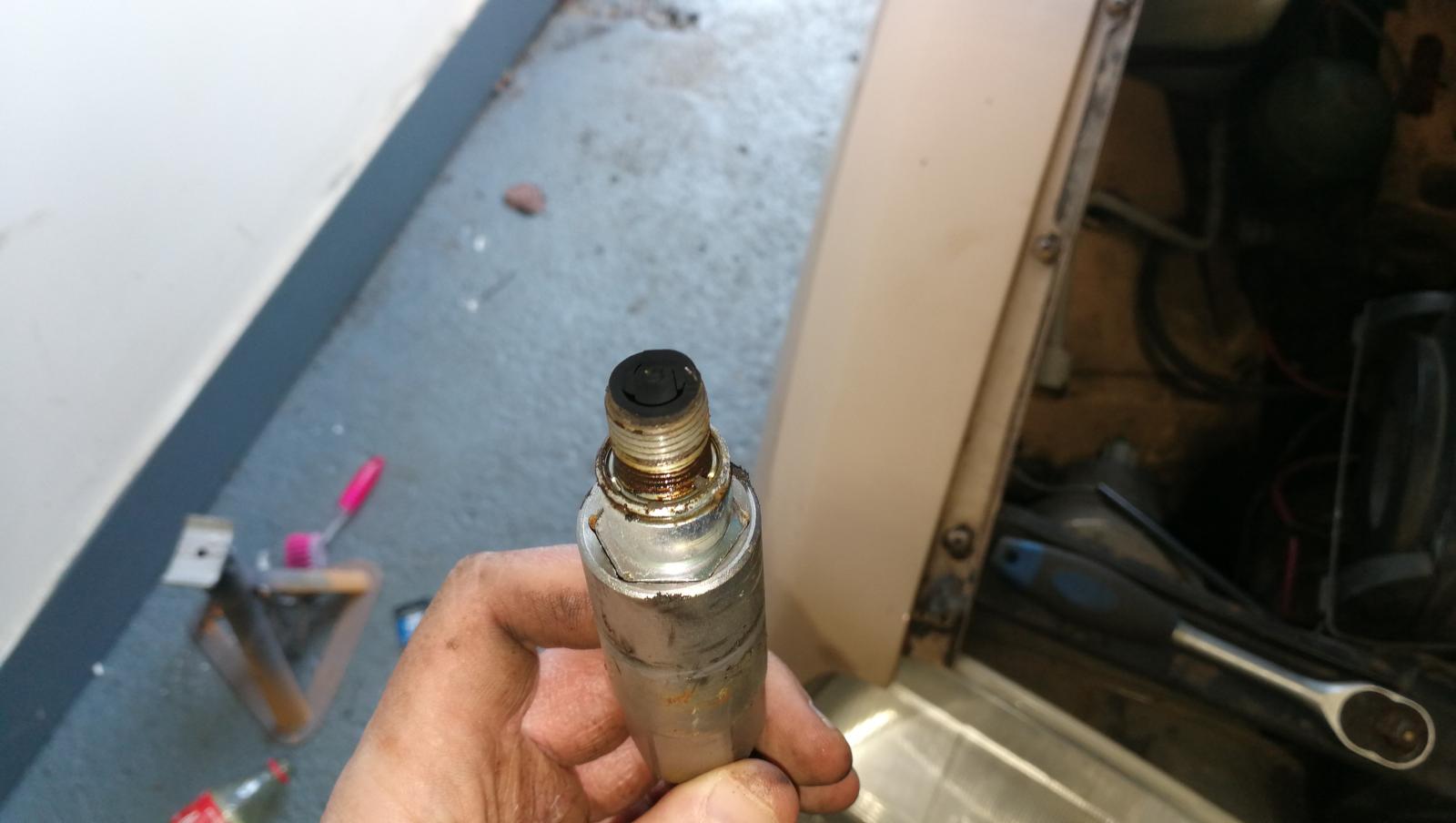

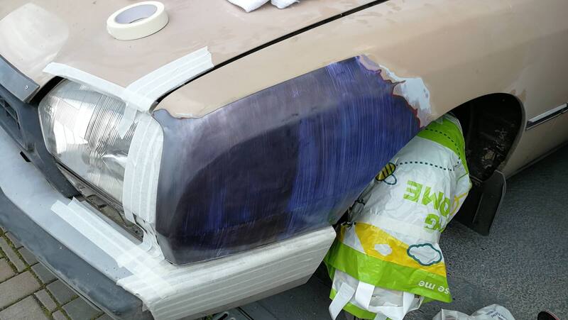

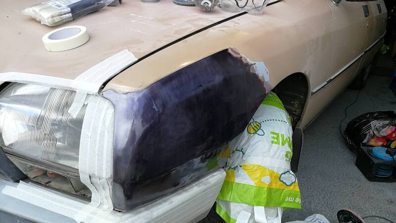

320touring Posted June 15, 2019 Author Posted June 15, 2019 Super progress on this today. With it earning it's MOT last week, I have had it as my daily for the last week (and 400km). Daily driving it pointed out a fair few issues and frustrations that needed resolving to allow continuous use. First thing to do was to assemble 3 Citroens (the Merc using Citroen derived tech for its rear suspension) A hearty breakfast was procured and consumed before a schlep to the unit. I had a can of fuel in the boot of the GSA as one of the things to tackle today was replacement of the accelerator pump on the Carb, so I was running the car low on fuel. I made it to the unit without need for the can, thankfully. The 4 screws to the left of the fuel pipe were removed, and the old unit was removed. FPB7 had diagnosed this failing as the likely source of the continual overfilling. At the same time, given it was in the kit, I replaced the tiny fuel filter where the line goes into the Carb, the old one was past its best. Testing thereafter showed no petrol smell, and better starting. The drive home showed better responsiveness, and a generally happier drive:) Back to the other things that needed doing: An Oil change was completed The cross over pipe connecting bolts were adjusted and retightened to stop small leaks Then it was onto the big thing of the day.. Bodywork. Since I have had this car, there have always been a few grot points needing attended to. With the fact the car was either the only working one on fleet, or parked in a hedge whilst others were used, they had never been attended to. Time to do something.. The drivers wing was the worst I didn't know what I'd find .. I chipped of the loose filler ( the whole wing seemed to be coated in it) This wasn't cutting it, time to go full on! This approach was significantly more satisfying - rapid progress was made. They don't kid about when they print "For rapid stock removal" on the flap wheel.. As can be seen, it was pleasingly rot free under the filler. What appeared to have happened was the filler was so thick it cracked, allowing water to infiltrate and start to rust. Swapping to a grinder driven sanding pad, the wing was finished back a bit more for some investigation. Eventually, it was cleaned back enough to see that the wing was in solid shape, despite a few bumps and wobbles. This was dusted down in preparation for a temporary repair before finishing is conducted. The next stage was a liberal application of Vactan. This dried to a most pleasing colour, so I drew inspiration from Dollywobbler, and just fucked 2 coats of lacquer on it until I get the Beige Colorado mixed up:) Heartened by the solidity of this old tub, I let evening dry off before treating it to a good wash and interior clean. I'm well pleased with progress - now to order up a sphere removal tool and get the new spheres and LHM in place. Shep Shepherd, Lacquer Peel, Skizzer and 25 others 27 1

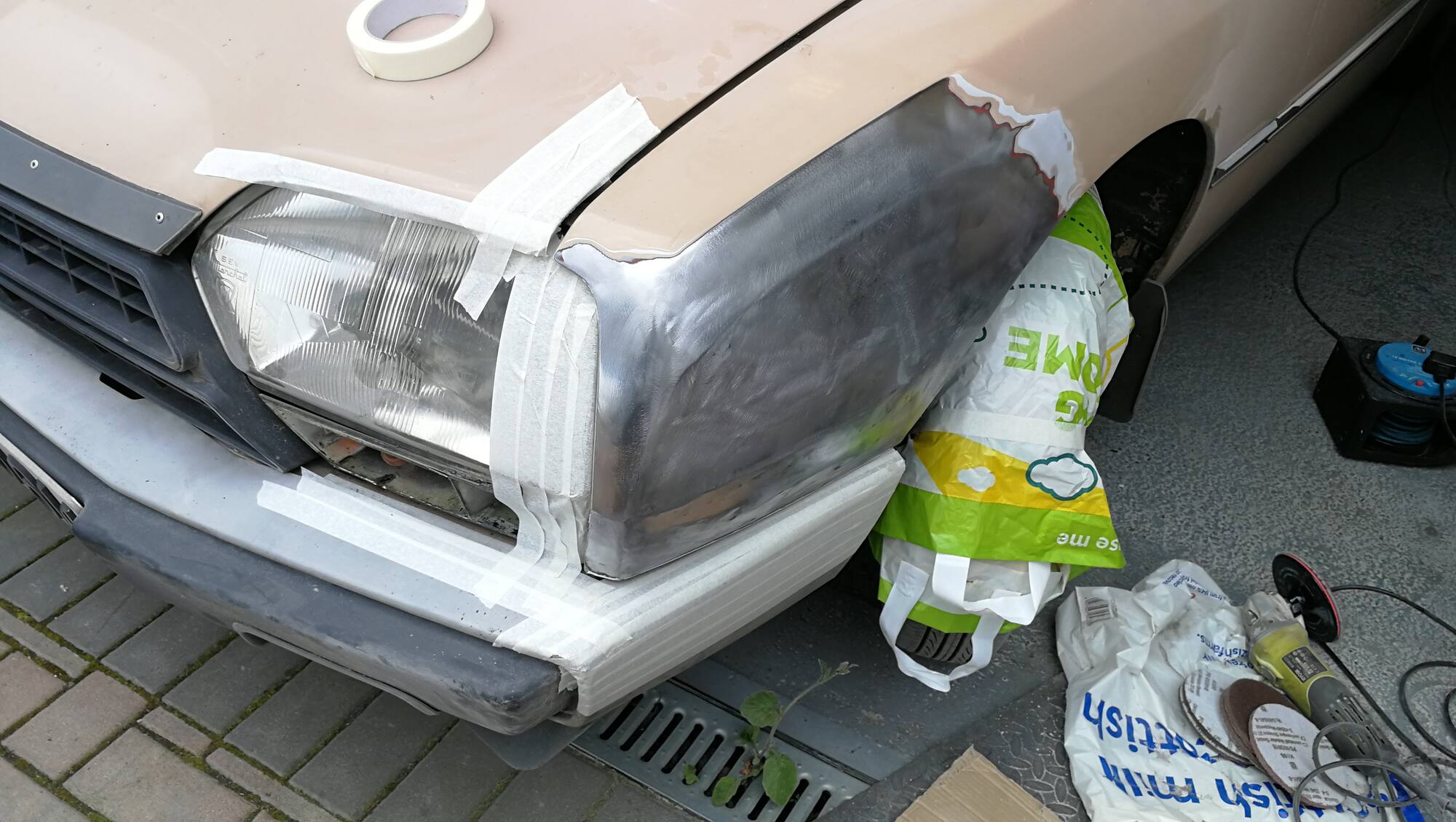

HMC Posted June 15, 2019 Posted June 15, 2019 Great result! I always wondered what was going on with that front wing; had no idea it would be so solid underneath! 320touring 1
320touring Posted June 15, 2019 Author Posted June 15, 2019 9 minutes ago, HMC said: Great result! I always wondered what was going on with that front wing; had no idea it would be so solid underneath! Yep, I was very pleased. The lil bugger has got under the skin of my brother and I - well love GLF'ing it. Should be even better after new spheres and LHM chaseracer and HMC 2

320touring Posted June 15, 2019 Author Posted June 15, 2019 33 minutes ago, HMC said: Also- I’ve got your old 320 auto coupe now! That's a good auld tub, and I know Supernaut did a power of work to it when he had it, so it should be a grand steer! 31 minutes ago, Split_Pin said: Grand progress chaps. Wish I could have joined you, instead I had a thoroughly* enjoyable* time at a weans party. There will be a next time 31 minutes ago, Tickman said: That is an ace result on the wing. Cheers, I was pretty damn pleased. Hardest bit will be getting it painted up ok 28 minutes ago, Broadsword said: Impressive work on the Citroen there. Thanks 24 minutes ago, Fumbler said: That wing looks fantastic. Fantastic car too. Aye, it's a wee cracker - glad I bought it sight unseen. Cannae see past it as an automobile.

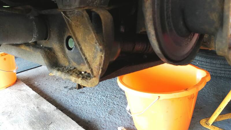

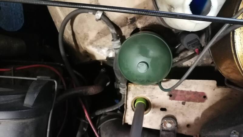

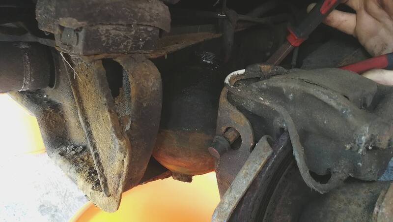

320touring Posted August 3, 2019 Author Posted August 3, 2019 Well after 400 miles up and down to the North East meet last Sunday, the shortcomings of the tired spheres were all too evident.. Today we sought to resolve it. 40 year old Citroen suspension, what could possibly go wrong? The answer? Not too much bar one of the rear spheres not being seated properly, causing an LHM leak. The fronts were a doddle - literally Tool on Crack it Then off by hand Pela pump to draw the fluid out the strut New one on Then we broke for breakfast. LHM TANK emptied via the Pela The rears are somewhat more complicated - They are pretty much like the front struts with the spheres at one end, except they are laid horizontal in a subframe. The correct thing to do is undo the high pressure 3.5mm line (8mm union). This is ok when new but after 40years, the 8mm unions were somewhat recalcitrant. Step forward the 'cheats method'. Compress the strut down using a screwdriver to lever the sphere towards the front of the car. Careful not to snap the 3.5mm pipe. Undo the 11mm retaining clip bolt next to where the 8mm union goes in. Jack up the rear arm until it's above the shelf the strut is on. Angle the strut out, and attach the tool to the sphere. Crack the sphere and wind it off by hand. With the old sphere out, fit the new seal and sphere. Double check it's tight. It's what caused the LHM leak. Re mount the retaining clip, making sure that the sphere is located in the subframe correctly. Put it all back together - wheels on and put it on the ground. Top up the LHM TANK. Start the car Open the 12mm bolt on the accumulator sphere housing. Crack the 11mm nut on the return line to the LHM TANK. Watch for bubbles - essentially like bleeding a coolant system. Tighten the nut and bolt back up. Marvel as the car rises total cost for new suspension and brake fluid? £215. £180 for spheres £20 LHM 5l £15 sphere removal tool "Magic carpet ride" £PRICELESS RobT, Tickman, captain_70s and 28 others 27 4
