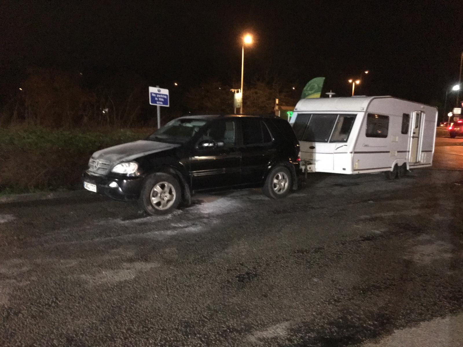

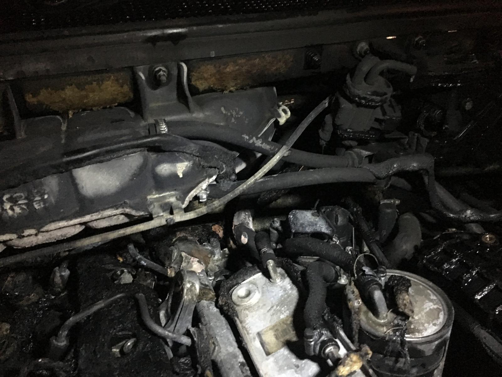

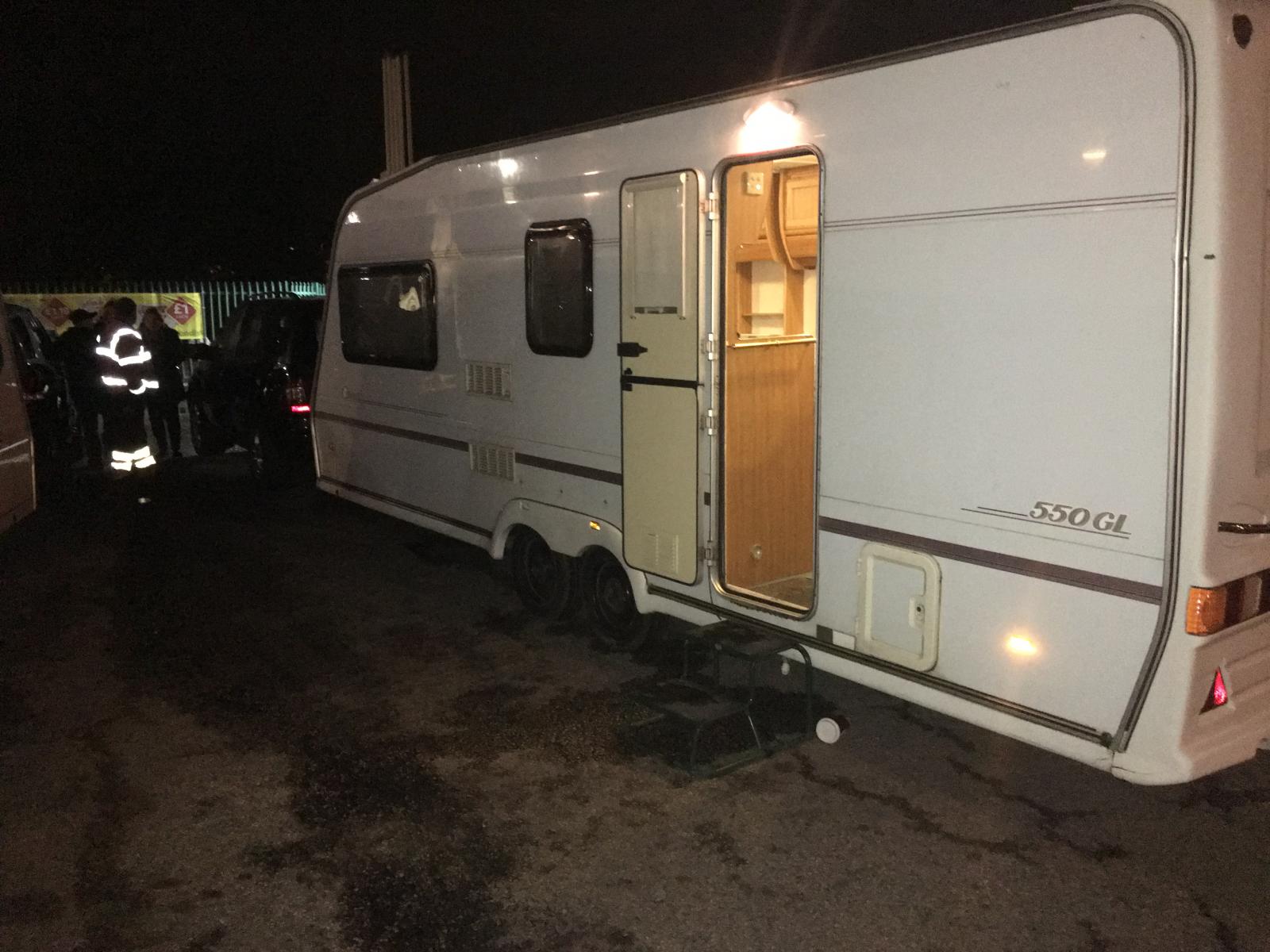

bloobloo Posted February 27, 2018 Posted February 27, 2018 This time last year, taking the caravan out for the 1st trip of the year. Saw what I thought was a bit of steam coming from under the bonnet and pulled off the motorway into the petrol station at J27 M6. Parked up in the service area where the tanker fills the fuel tanks.......... So, then what... Sod it, brew time whilst we assess the damage waiting for recovery! I do have a pic including fire engines etc too somewhere, will dig it out. Talbot, 320touring, richardthestag and 1 other 4

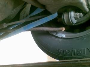

DodgyBastard Posted February 27, 2018 Posted February 27, 2018 WP_20130319_001 by srblythe, on Flickr I had a ball joint separate on a busy roundabout in Rosyth while doing Pizza deliveries in 2013. It pushed the wheel up into the arch and made the car un-drivable. WP_20130318_005 by srblythe, on Flickr WP_20130318_001 by srblythe, on Flickr richardthestag, Lacquer Peel and Dirk Diggler 3

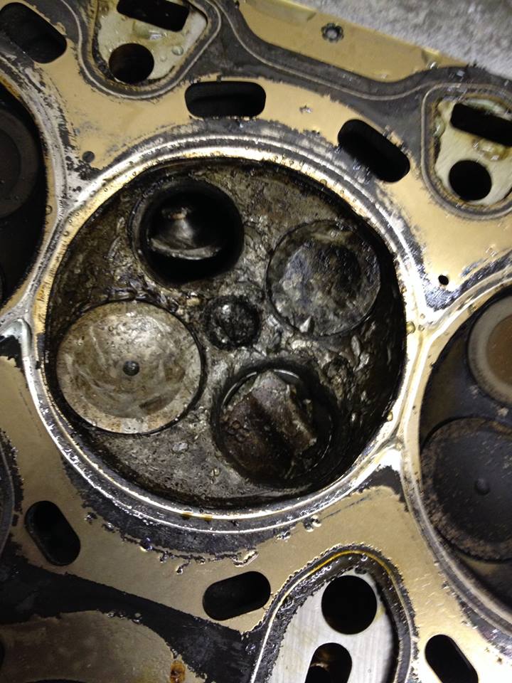

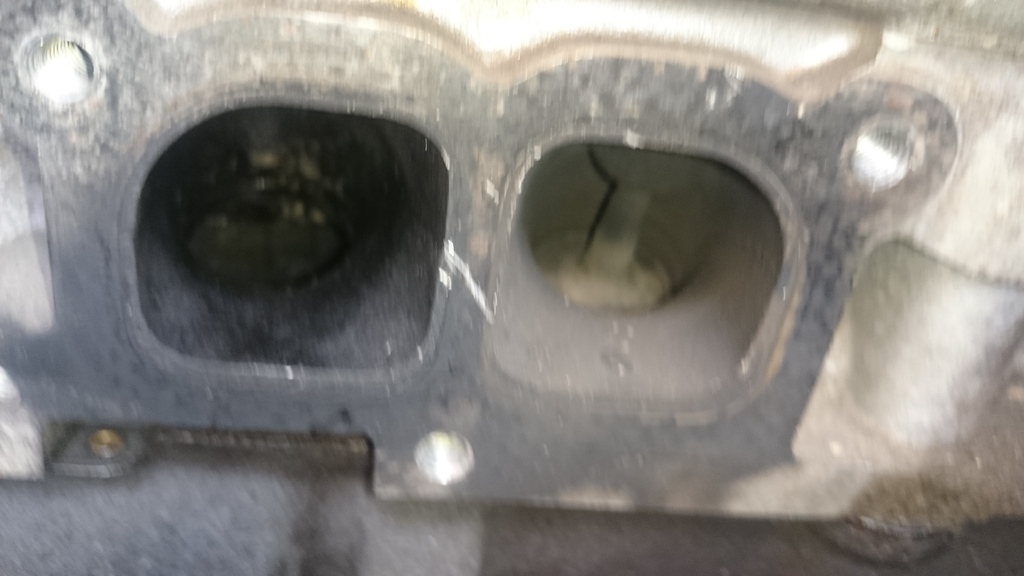

fatharris Posted March 2, 2018 Posted March 2, 2018 The Omega's untimely demise deserves a mention, I feel. Snapped valve on Cylinder 3, still managed to limp it for at least another 5 miles at 30mph, in hindsight I should have kept going, but I would have eventually reached the M5 and I wasn't sure of my plan after that, so I pulled in. Still got it on the driveway, it's now my executive smokers' lounge, with heated seats and a stereo. Sent from my ONEPLUS A3003 using Tapatalk Exiled_Tat_Gatherer, richardthestag, CGSB and 3 others 6

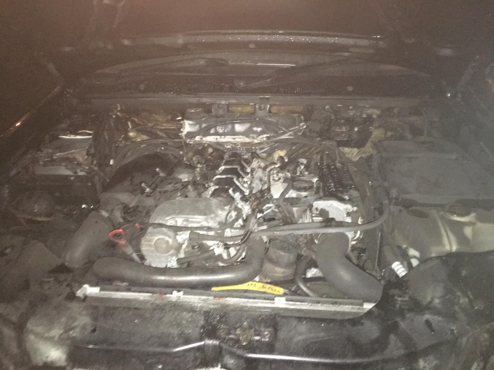

The Reverend Bluejeans Posted March 2, 2018 Posted March 2, 2018 I've not had that many. 1980 W reg 323i, came around a roundabout in Milton Paradise Keynes and the car just veered left, pulling the steering wheel pretty much out of my hands. Front passenger wheel bearing seized completely solid. Recovered back, pulled the hub off but had to grind the inner race off. It had seized and spun on the stub axle before welding itself on. Sweet.The car caught fire 6 months later on the M1. Near J29 I detected smoke, pulled over and did the correct thing, recovering my jacket, the fire extinguisher and pulling the CD player out before letting it burn. This 1996 323i Coupe had a slight* misfire. Not my doing. A local garage had the head off, skimmed it, built it all back up but failed to notice the fucking massive melted bit on the piston crown. It made it 25 miles home but it smoked a bit until I pulled the coil pack off and removed the spark plug. 320touring and Exiled_Tat_Gatherer 2

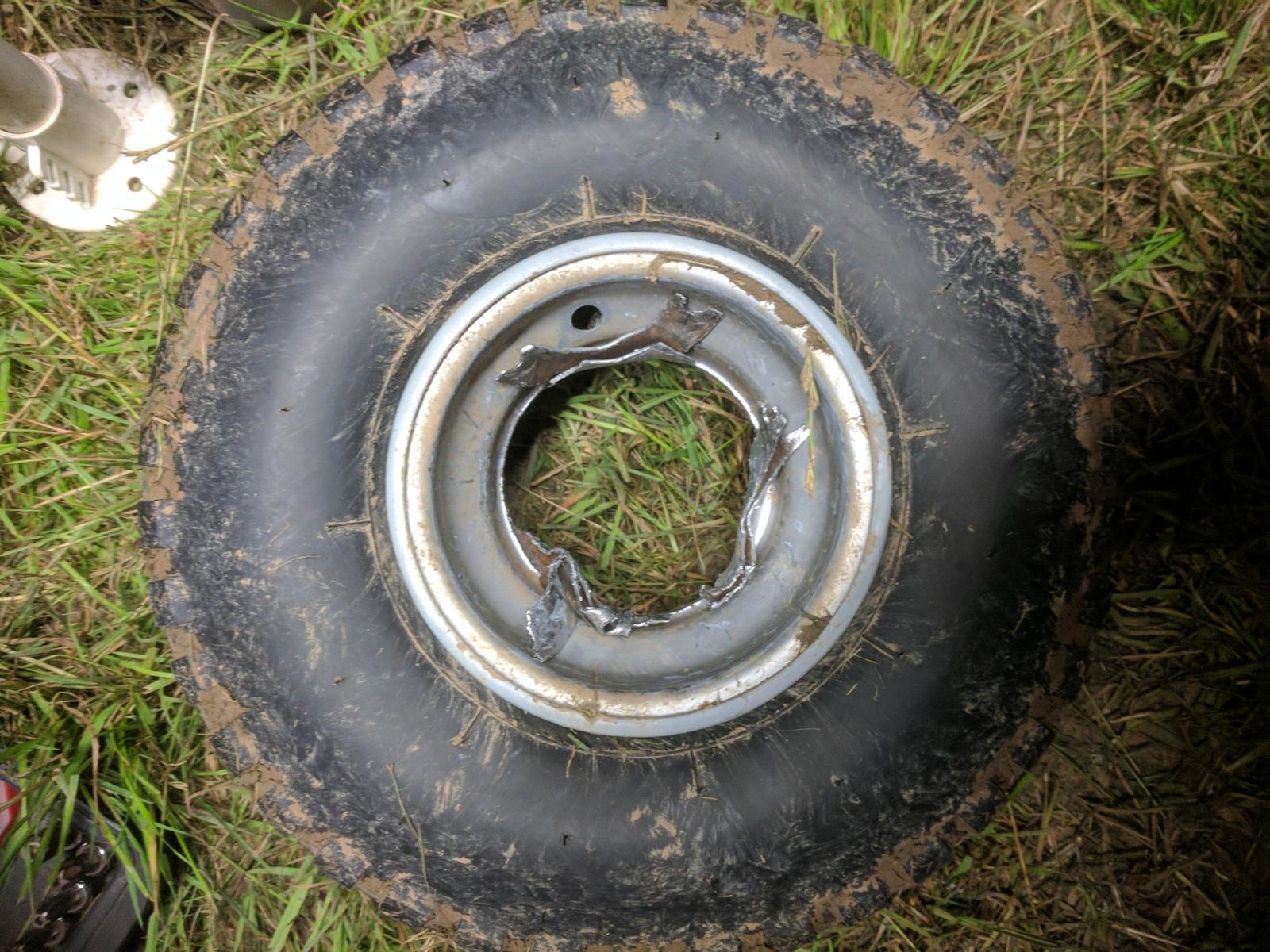

cms206 Posted March 3, 2018 Posted March 3, 2018 Oddly enough they wouldn't do an exchange unit on the gearbox. Sent from my SM-G930F using Tapatalk D Spares & Tyres, The Reverend Bluejeans, Dave_Q and 13 others 16

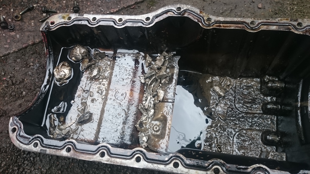

The Reverend Bluejeans Posted March 3, 2018 Posted March 3, 2018 This was a good one. 2005 116i that dropped a valve on the M23. Rather than stop when the engine sounded like a Gatling gun, they kept going. The piston disintegrated, falling into the sump whilst the rod and gudgeon pin flailed about, destroying the bore. It then dropped another valve. Still, it did 100'000 miles, not a bad run for an N45 shitbox. Dirk Diggler, CGSB, Exiled_Tat_Gatherer and 3 others 6

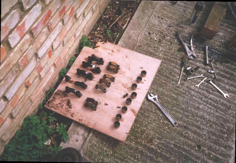

richardthestag Posted March 3, 2018 Posted March 3, 2018 crumbs a fair few over the years. I have non digital photos of some will need to got into loft brrrrrrr to get them broken crank on A series in a moggie minor, initially caused by cronic overheating due to wrong dizzy fitted and no temp gauge. crank fractured between #1 main and #1 big end. #1 piston was made from wood. broken driveshaft on brothers 1100 austin, what actually happened was all but on bolt on the joint had snapped which caused the driveshaft to twist and lock that wheel and the diff. in the middle of a main junction. ford 105e diff grenaded on kingston bridge when I was giving it some wheels on its recently rebuilt 997cc engine. raw powa. it went bang and when I got to the roundabout on the other side the diff was locked and I span it 180 as I tried to turn on the roundabout. brake master and servo failed on 1500TC triumph just when I needed it, ok I might have been a tool. xr3 pulled out from side road I flashed him because he was blocking my progress. he gave me the bird so I left it as late as I could before braking and then realised I had no brakes. bent the steering wheel and lifted my arse of the seat but stopped with about an inch to spare. brake fail on my 105e, huge lesson learned, I had just fitted cheap but new shoes all round. the week before I had to execute an emergency stop on the M4. the engine had been breathed on a little I had it up to a ton (indicated of course, but on my mates TR7 who was following me, 105e speedo only went up to 90). I was not shy about exercising the full rev range on my smartly engineered and balanced 997cc engine . alas standard drum brakes all round. Anyway the emergency stop went well, if you consider veering across three lanes and onto the hard shoulder and overtaking at least one truck while on the hard shoulder. anyway escaped that one. following week heading up the M40 to the 105e owners club national day, exited the m40 with the speedo needle off the scale. stood on the brakes and they were rock hard and showing no signs at all of slowing the car. t - junction at the end of the slip was approaching rapidly, dumped into 2nd gear - no synchro on first and aimed to steer left praying nobody in the way. went around the corner just and span the car 180. stopped and crapped myself. 105e show was just a couple of miles away so very nervously drove to it. bought new ferodo brake shoes from the spares stand. the old linings taked from the car were absolutely rock solid, screw driver and hammer could not mark them. have not fucked about with cheap brakes since. Another brake fail on my year old 1988 Cav company car, master failed on snake pass. hairy moment to say the least Front damper fail on GTI Golf Mk2 caused some brown trousers in an emergency stop on that front o/s corner which just locked up everytime I touched the brakes I do drive a lot more considerately these days broken main bearings on my stag v8 was pricey turbo fail on 1.6hdi shitroen was similarly expensive, suddenly realise how much the little engines rely on their turbo. it was undriveable on any incline. will find more I am sure The Reverend Bluejeans, Lacquer Peel and Exiled_Tat_Gatherer 3
cms206 Posted March 3, 2018 Posted March 3, 2018 That must have made some interesting noises and I imagine a heck of a bang!Wee bit! Took it out in the morning, banging at the back end. Signed on 0635, left garage 0645. Phoned in at 7am - "We'll get you a change of bus on your next run." Phoned in at 8am - "Short for schools, we'll get a PS out to replace it on your next run." Phoned at 9am - "The school buses aren't back yet, we'll get you a change of bus on your next run." Phoned at 10am - "Next run, no drivers spare." Phoned at 11am, backshift have started; by this time I've got trouble keeping to the board - "Early shift never cracked a light, you're due off for your break at 11.50 - I'll bring a bus down to cover the break, just dump the Dart somewhere nearby when you get back to Paisley." 11.10 - I've lost 1st, 2nd and 3rd. 11.15 - Terminus achieved in 4th; it is at the very bottom of a village. It smells really bad. Phone in - "Just try to limp it into the garage" 11.25 - Manage the climb to the top of the village in 4th, turn right at the lights, get about 200 yards... a god almighty bang, can't see the road behind me, selects 1st and takes off like a rocket. 11.26 - grinds to a halt. Furthest point from the garage, outside a shop. Marvellous. Sent from my SM-G930F using Tapatalk D Spares & Tyres, 83C, alf892 and 3 others 6

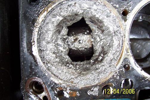

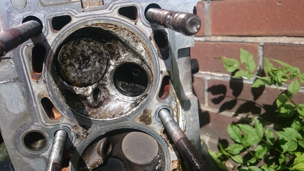

fordperv Posted March 3, 2018 Posted March 3, 2018 I can play this My saph engine failed on the way to fordfair a couple of years back so got it recovered Here's what I found There should be a valve in here There should be a piston in here Where can they be Oh wait ive found them they are hiding in here Coprolalia, D Spares & Tyres, richardthestag and 7 others 10
The Reverend Bluejeans Posted March 3, 2018 Posted March 3, 2018 CVH? Looks like one. Worst blow up I've seen was a Mark 2 2.3 Granada in 1987. It was three years old, had done 60'000 miles - without an oil change. Woman driver, company car. It had finally chucked a rod on the M4 near Hungerford but Wimmin was unfazed by the noise. So it chucked another rod and finally siezed. The STINK when the sump was removed from the scrap engine. It was near enough melted. Lacquer Peel 1

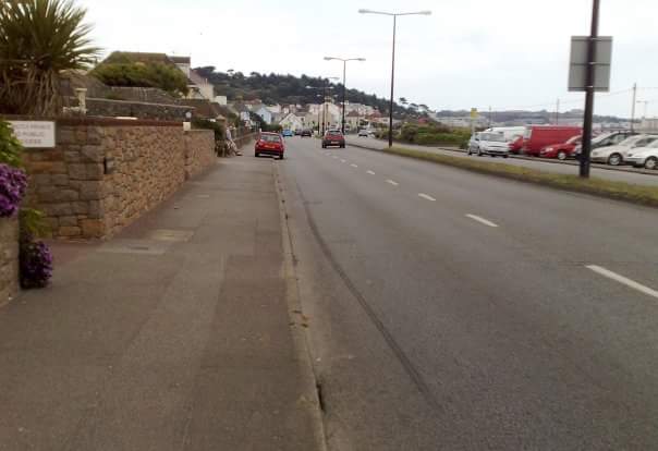

Coprolalia Posted March 3, 2018 Posted March 3, 2018 Inner CV joint blew itself to bits on the Scirocco on the A30 going up Fraddon hill towards Indian Queens. With a mate when the OSR wheel bearing disintegrated on his ZX going towards Havant on the A3. OSR wheel overtook the car. Trouser-faecal matter interface.No photos of car fails but will this do? Ripped the aluminium hub through the wheel racing.Track was a tad rough and lawnmower racing calls for drifting. Sideways action across washboard ruts caused the failure, which was nursed round the rest of the track back to the pits. Lacquer Peel, 320touring, Dave_Q and 2 others 5

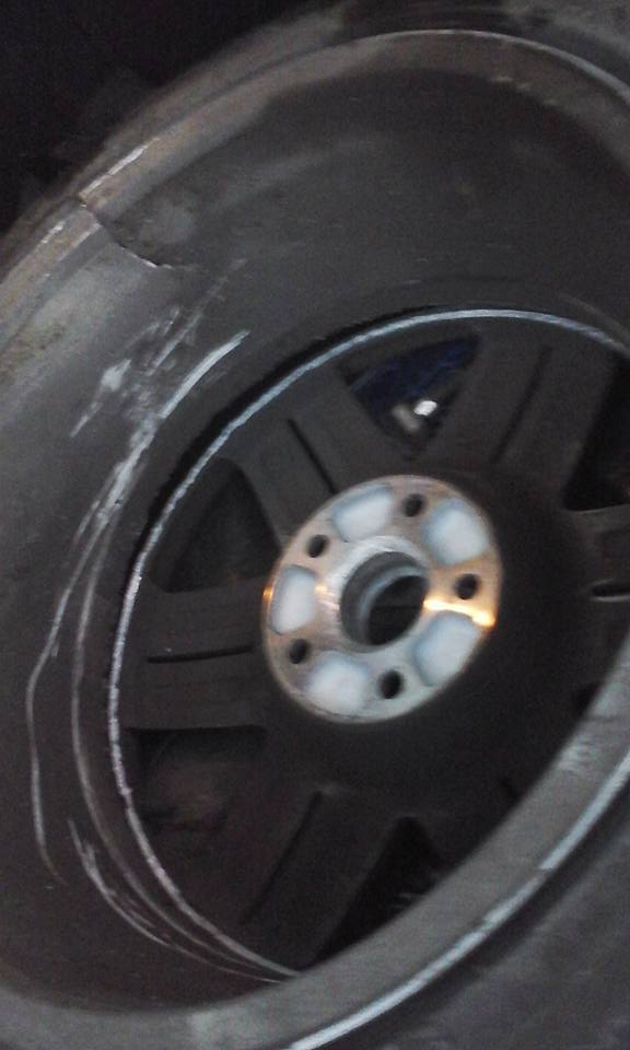

xkjagnz Posted March 3, 2018 Posted March 3, 2018 Slight crack in an alloy after encountering a pothole Lacquer Peel 1

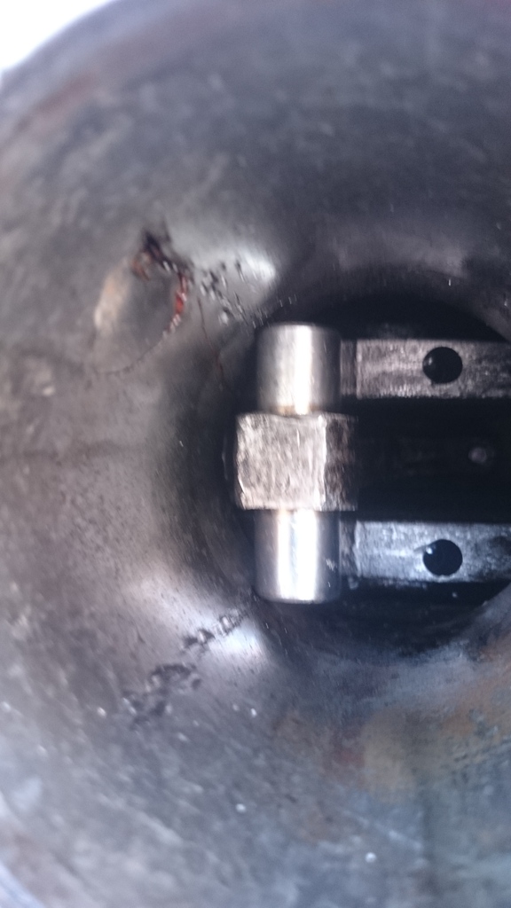

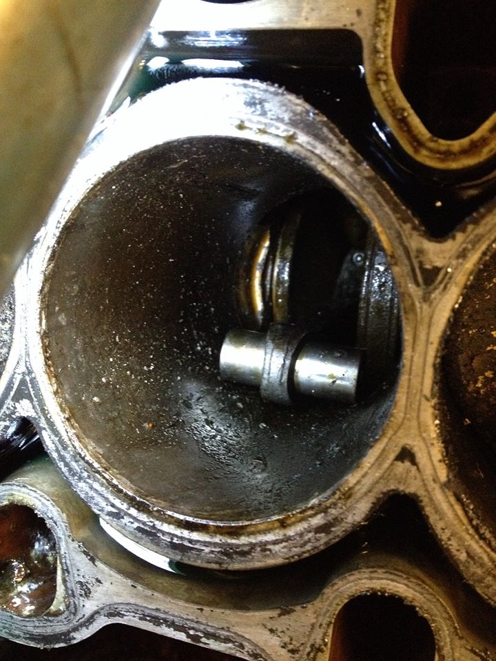

xtriple Posted March 4, 2018 Posted March 4, 2018 1473 by david towerss, on Flickr 1472 by david towerss, on Flickr 1469 by david towerss, on Flickr Yamaha TDM 850 piston. It was January a few years back when my wife was learning to pass her test, we had been riding round Torquay, Paignton, Brixham doing everything correctly, all speed limits observed, riding like Nuns. Got home, had a cuppa, went to start the TDM, nasty noise and 'THUNK!' no more turning over. Had to use the Bonnie in the rain and sleet for the afternoon session. Stripped it down and one piston was smashed, all the bits still there (as you can see) but severely buggered. I was going to rebuild it but someone offered me more than I paid for it broken, so it went. I really liked that bike. Yes, she passed Exiled_Tat_Gatherer, mat_the_cat and 320touring 3
