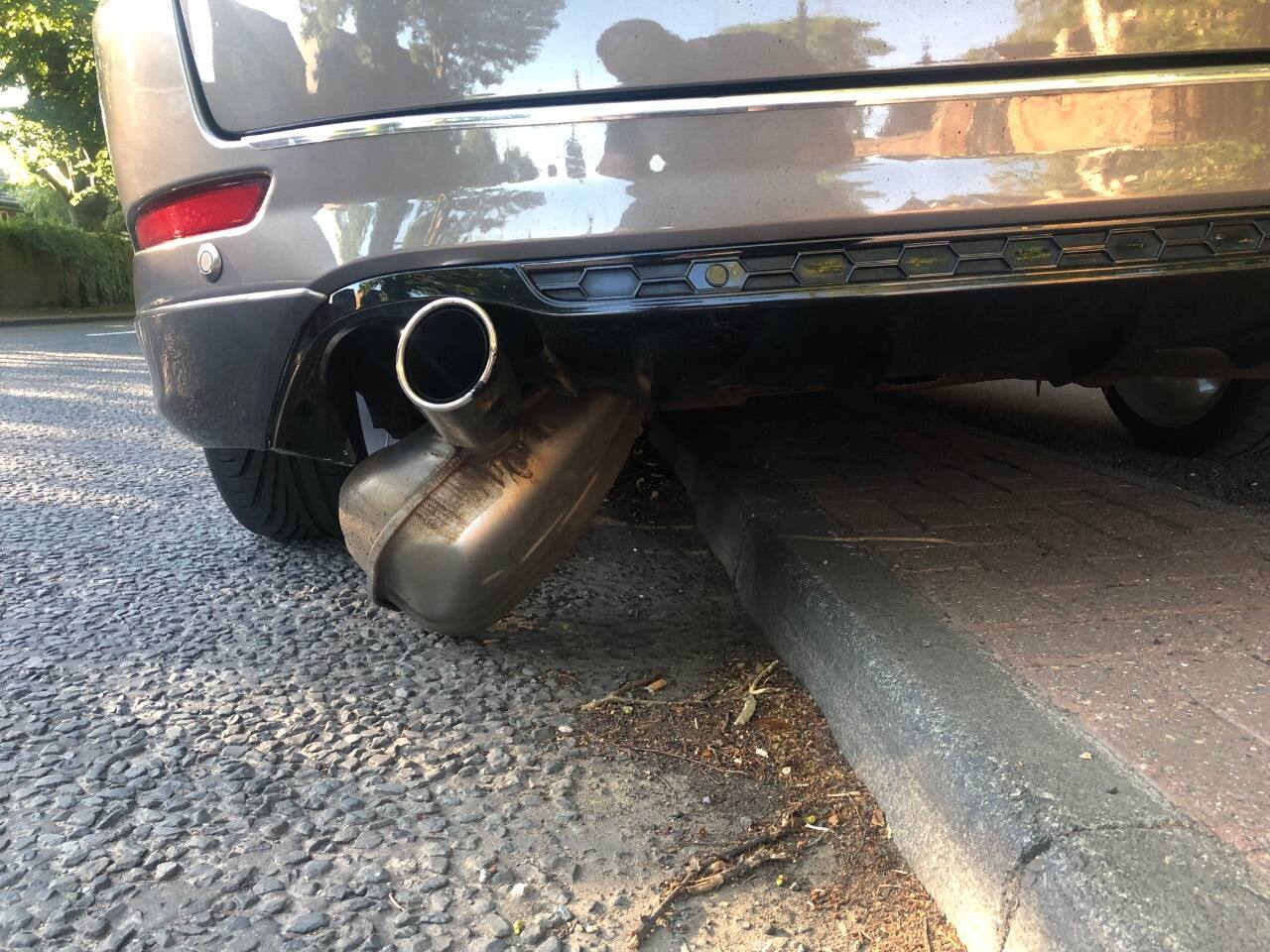

Did a back box delete like the cool kids, just now.
