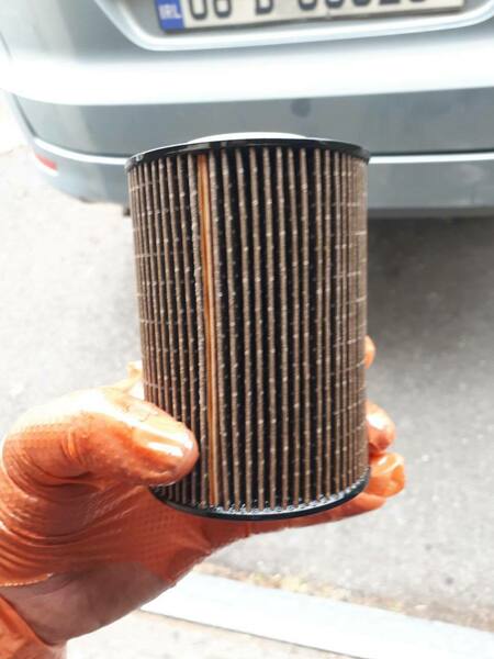

Out with the old oil filter.20220622_123652.thumb.jpg.1fbeea770578eabe429d60340f3e0345.jpg

Air filter wasn't too dirty,but due a change on mileage.

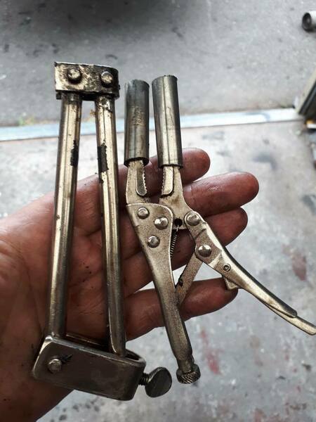

I clamp off the fuel pipes as close to the connectors of the fuel filter housing as possible.

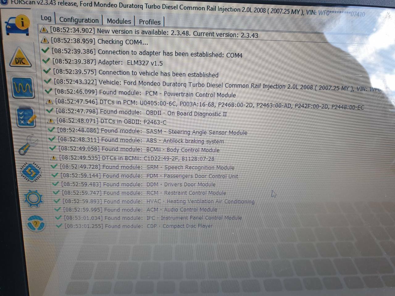

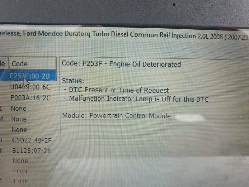

Right, dropped the diesel-diluted oil, got a new bottle. Hopefully that will shut the computer up about degraded oil so i can get on with clearing all the codes.
I'll plug it in and see what codes are there just now...
Turns out the other two dpf codes haven't come back, only oil deterioration codes. The others are cruise control not working and the boost, which has been there for months and months.
It did have one warning about soot build up, unsurprising if it's blowing smoke and not regenerating!
It says its done a regen recently. That's surprising if the oil deterioration code is there, isn't it?

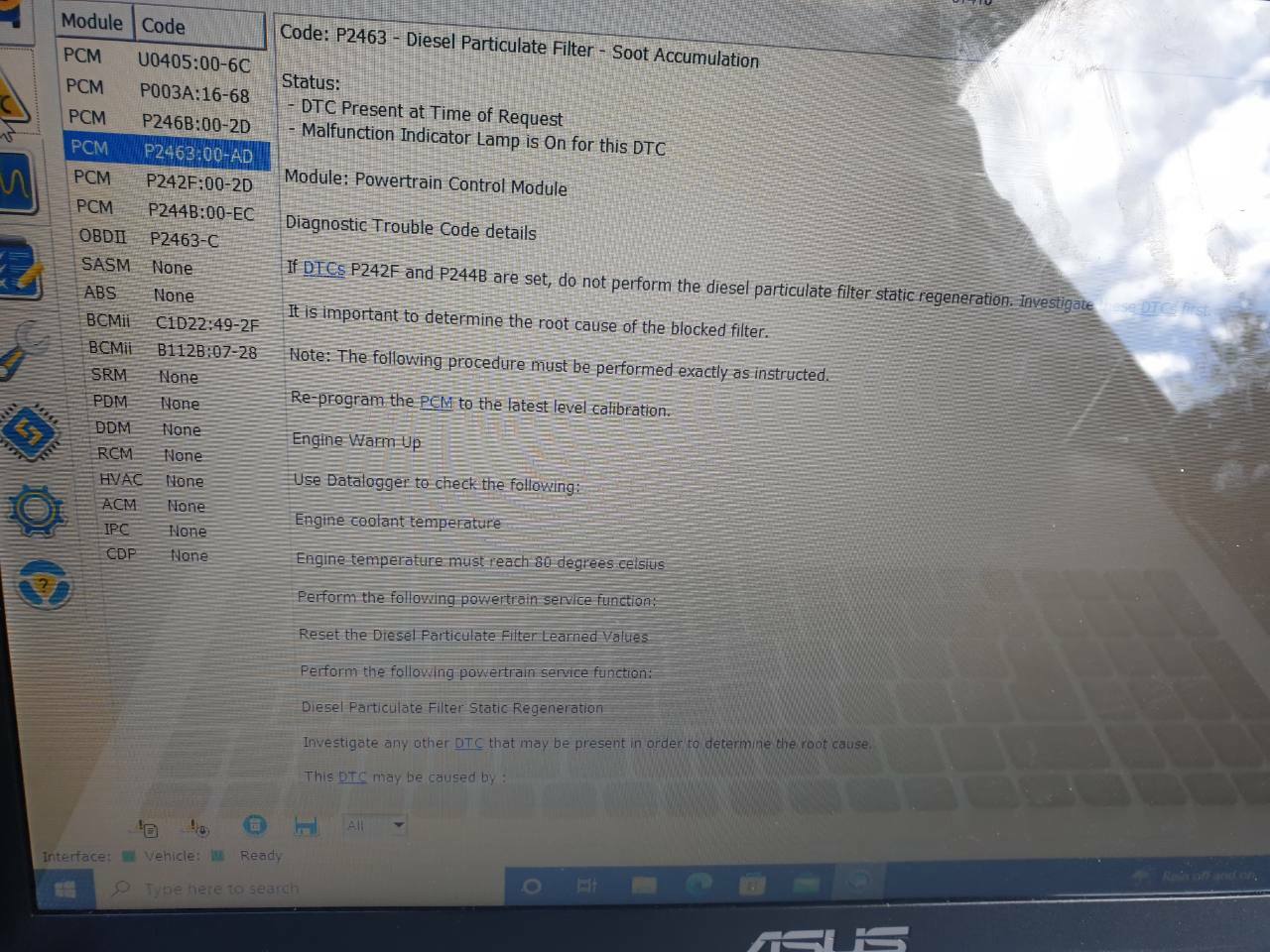

So I drove to Brizzle with fresh oil and I got engine lights, smoke, even limp mode for a while.
When I get home I'll see what codes are there but it's definitely not happy 😪
Is almost like it can handle 70 mph and gentle acceleration but it can't handle 80 mph and heavier acceleration.

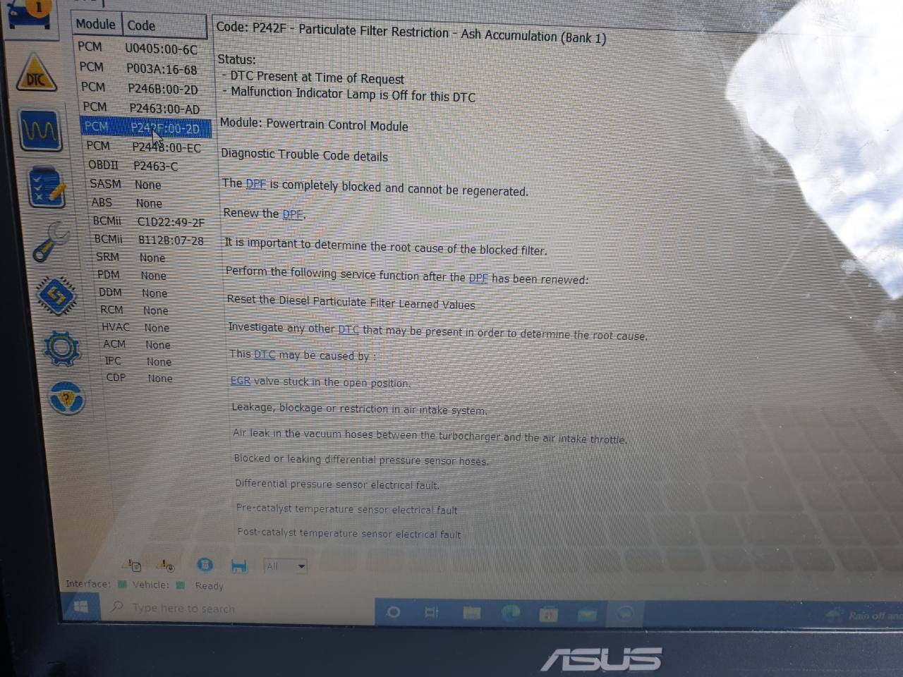

DPF showing no pressure at all, it’s not been gutted as it did a regen 600km ago. So that would suggest the sensor is deaded. Probably.

I've just driven back from Bristol in limp mode, that's nearly 4 hours travel time with basically no power. If I go for the stop and restart engine I get power, bluish white smoke and then limp mode.
I'm going to get the codes when I get a moment, I've got to turn around and go to a gig (in Wifey's cars, I dare say as I've lent my Volvo out so I can't use it) then not sure what I'll do for work tomorrow!!!

What actual dpf pressure reading is it giving you? If the code is saying it's completely blocked the ECU thinks it's got high pressure across the dpf which may or may not be the case.
It could be the sensor or hoses. It could be a lump of crumbled hose in the sensor.
If you have or can get a vac tester might be an idea to apply some pressure/vaccuum to either side of the sensor whilst reading live data to see if the values are sensible.
