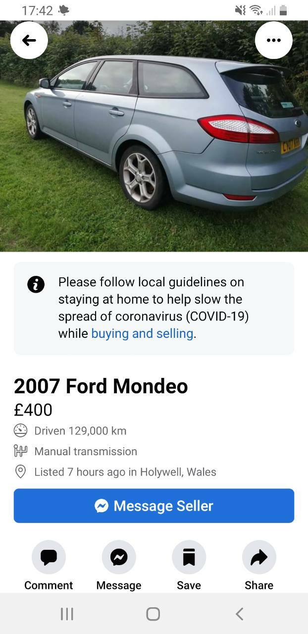

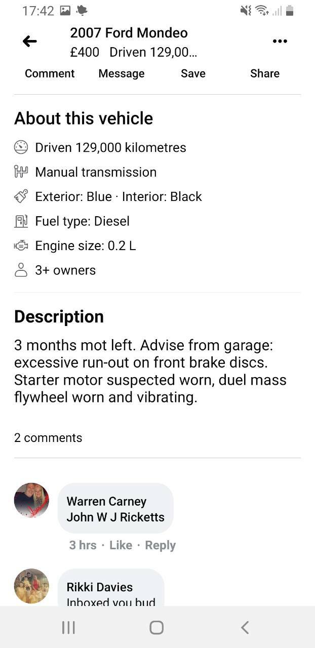

How much of a money pit would this be?
I have to admit the Mondeo is a decent thing, maybe I need one as well as Wifey...
@brownnovait's near you... oh dear someone stop me!
