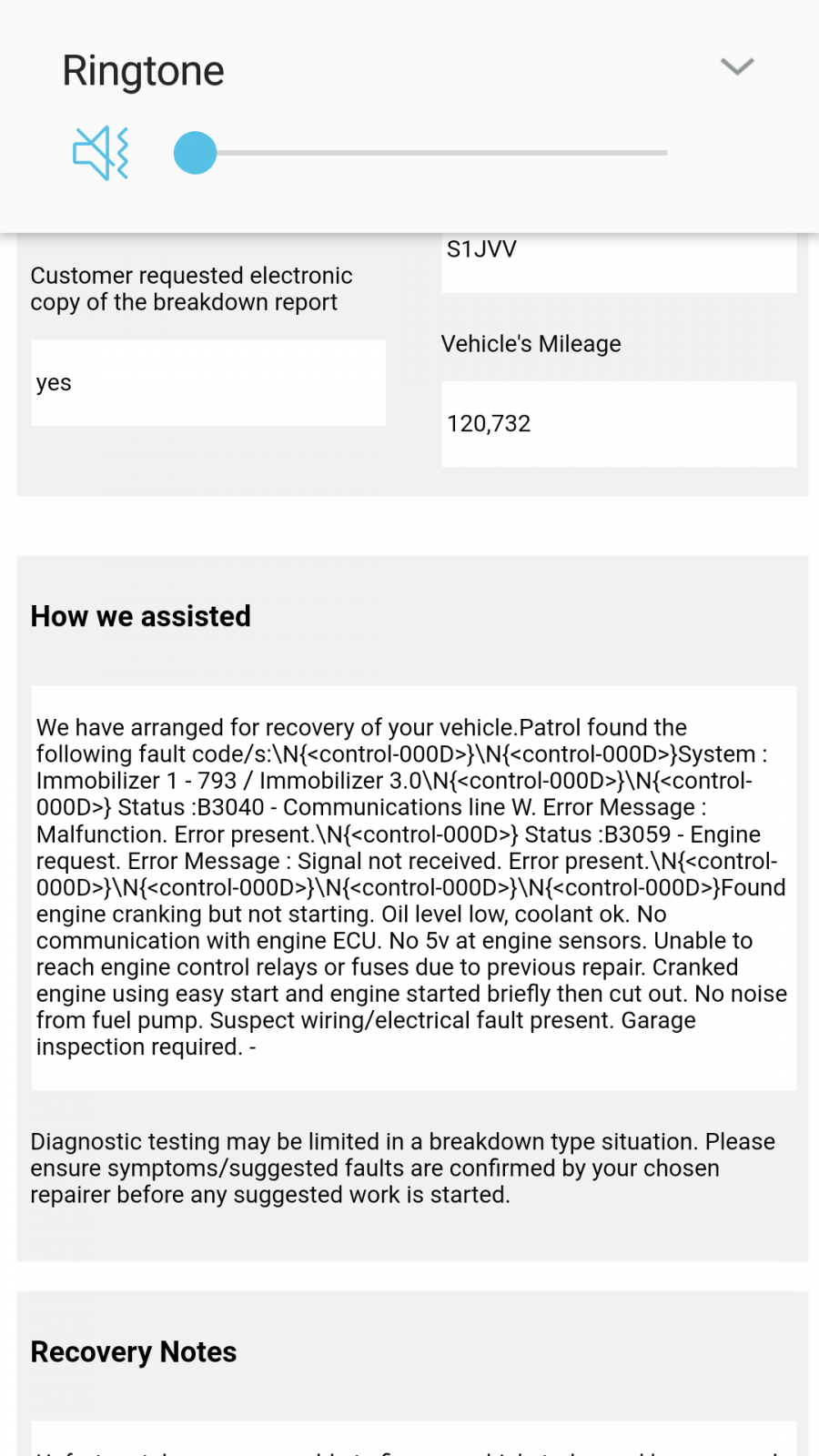

News is in and it is not good. Had a nice chat with the AA lad.
The ECU is dead. The car is not communicating at all via OBD. Just doesnt connect. Theres power getting to the ECU but no voltage to any of the three sensors he checked after the ECU. Think he said he checked the MAF and a couple of others. There were no volts present.
Which I guess means the ECU is toast. Or theres a wiring issue somewhere. The ECU is bone dry so its not related to rain or water. Probably.

It can't have been running on ether but have a dead ECU, with a dead ECU there would be no sparks so I cry bullshit on one or both of those claims.
Youve lost me now man. What claims?
For it to run on easy start then the ECU must be working otherwise no sparks.
Ergo ECU is not faulty and AA diagnosis is a stab in the dark.

Other that an ECU fault, what might cause there to be power to the ECU but no power after it?  (presuming that bit was true like)
Be grand to know what to look at rather than the ECU.
it could be one of the output transistor drivers has gone fubare , ecu is trying to work , sparks are trying , but the injectors are dead ?
Would it start if the injectors are dead though. Because it started, but wouldnt run on.
it was running on ether though if I read it correctly. Crank sensor will cut fuel, dodgy fuel pump/injection relay also will stop fuel, these are 2 purple relays in the fuse box
Easy start can make a petrol 'fire' without a spark........that's why it's pretty useless to try and diagnose with it
Everything (pretty much) runs via the ECU, it needs to 'see' everything to say when to make sparks, inject fuel etc, not sure what or how he tested it but I can't imagine everything being as dead as he said and it still running on easy start.
Do you have access to diagnostic equipment? The first thing I would check is what the engine is seeing on the live data side of things when you try and crank it over.
