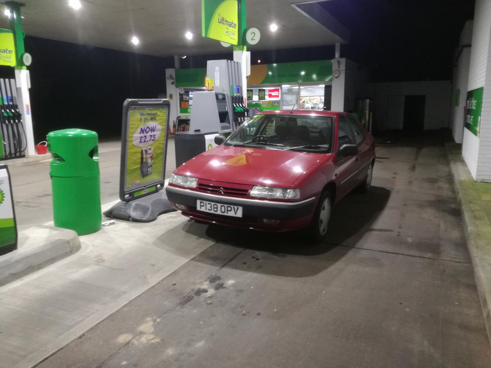

Talbot Posted February 7, 2018 Author Posted February 7, 2018 Warmer than standing on the platform...Shame that travelling by train is so expensive and so unreliable. It's quite nice sometimes to just travel without driving.Although it does mean being on a train...EDIT. Yes, I am sideways. The Moog, Lacquer Peel and Jim Bell 3

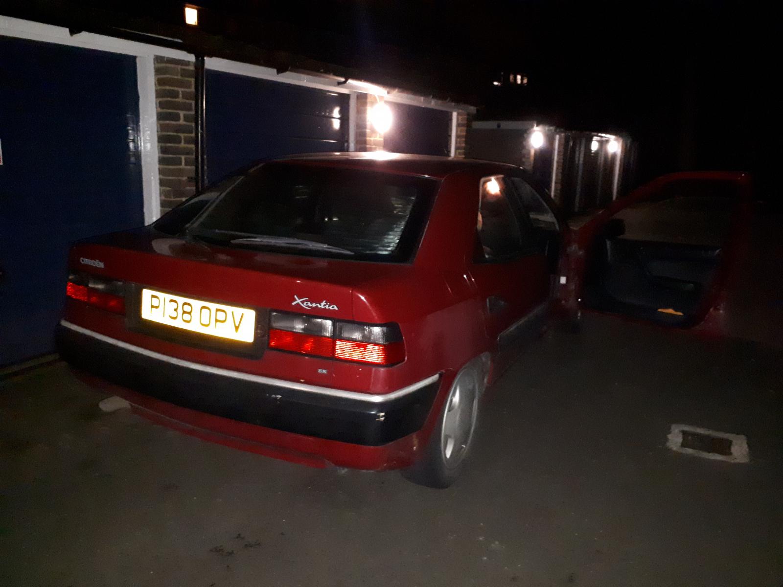

Talbot Posted February 7, 2018 Author Posted February 7, 2018 I think that's a xantia. egg, Cleon-Fonte, Lacquer Peel and 2 others 5

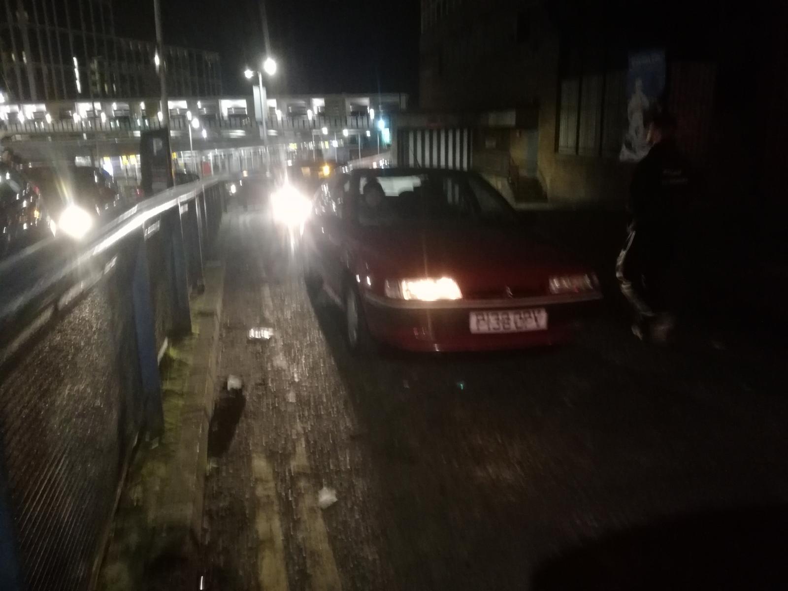

Talbot Posted February 7, 2018 Author Posted February 7, 2018 Pez station shot. It am teh lawz. KruJoe, Cleon-Fonte, Sigmund Fraud and 12 others 15

Talbot Posted February 8, 2018 Author Posted February 8, 2018 Home now. Quite a fast journey in the end. Actually, there's less broken on it than was thought.. or at least different things are broken. The engine temperature gauge actually works, The reason it stays almost on the bottom stop all the time is that it's actually running that cold as the thermostat is clearly jammed wide open. Given that I can grab and hold the top hose even when it's been running for a while and is still running indicates it's well below 60°c. Fuel gauge is definitely very broken, but I suspect will be a fairly easy fix.. it's not exactly a complex circuit. Driver's door lock will need some investigation as it's properly siezed internally. I also don't think the key is the one that fits the door lock. I may see if I can find someone breaking a Xantia for the complete lock set including a remote central locking key. Lack of a blower motor is a definite pain. The trickle of warm air into the car was just enough to keep hypothermia at bay, although I did find that if you belt it down the outside lane at significant* speed, you do get a little more airflow in. It's just a bind when you come to a complete stop at a traffic light. Brrrr! Rave, CGSB, Jim Bell and 3 others 6
Talbot Posted February 8, 2018 Author Posted February 8, 2018 I hope it is just a side light that's gone.It is. Every other lamp on the car works fine. Few gone in the dashboard, but that's no surprise! egg and RobT 2

Talbot Posted February 8, 2018 Author Posted February 8, 2018 I had a quick look at the door lock. The Driver's door lock button is jammed up and does not move at all.. I suspect the door card been dismantled and rebuilt* in the past incorrectly, as it's clearly the plastic button that is stuck. .. and the key just doesn't fit the driver's door lock. I think it's had a replacement ignition barrel at some point (not uncommon) and the (one) key for the car is for that lock only. I'm sure I can get a complete lock set for this from somewhere and re-instate the remote central locking it has.
