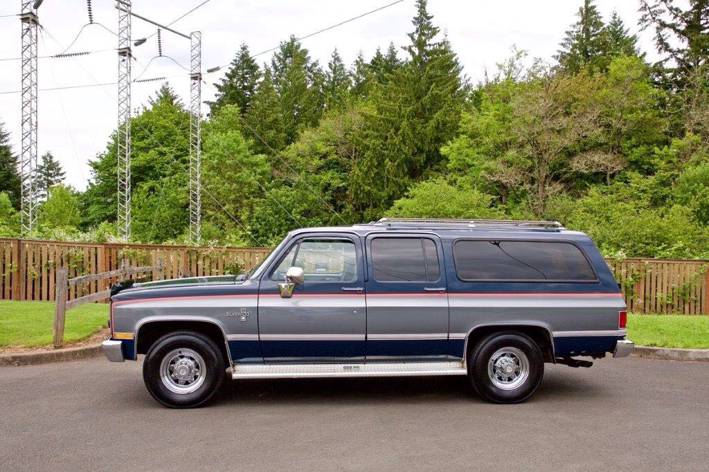

All this Yankee action makes me want one of these even more now. 454ci big block square body Suburban.
