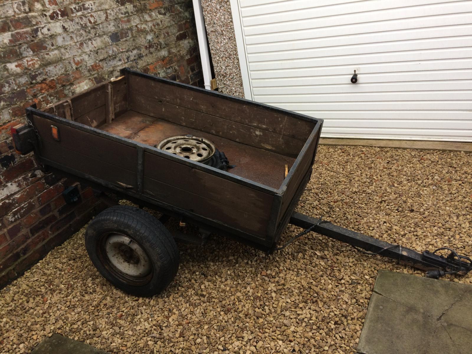

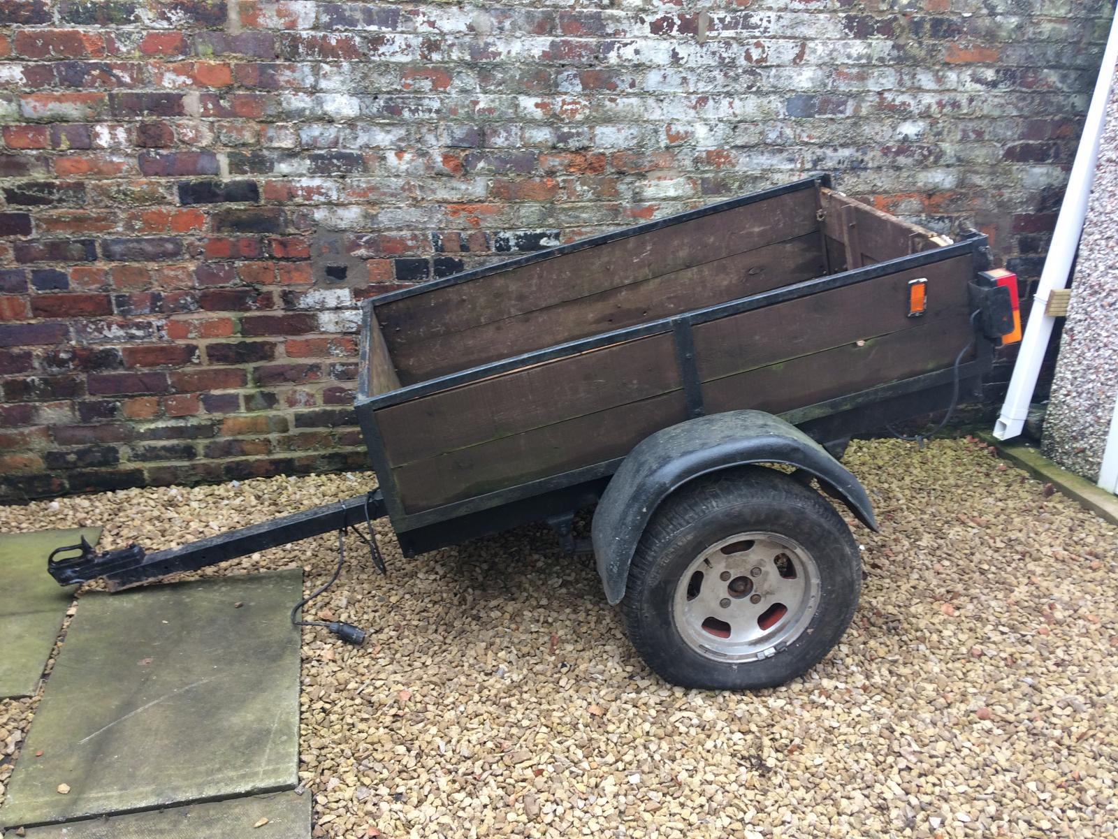

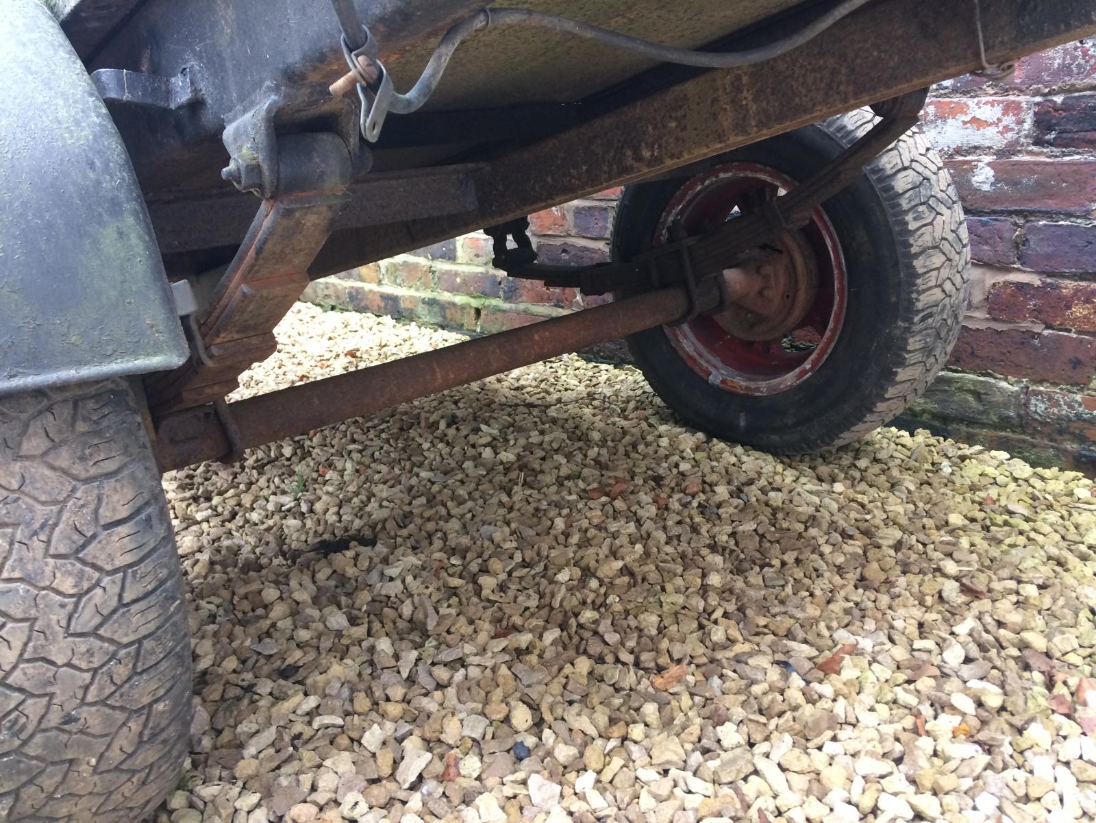

Thought I’d finally post some pics... can anyone spot the mistake with the springs?
Also tried out these ford slots for size. Look great eh?
The fixed end should be at the front?
Also, some dampers might be a good plan..

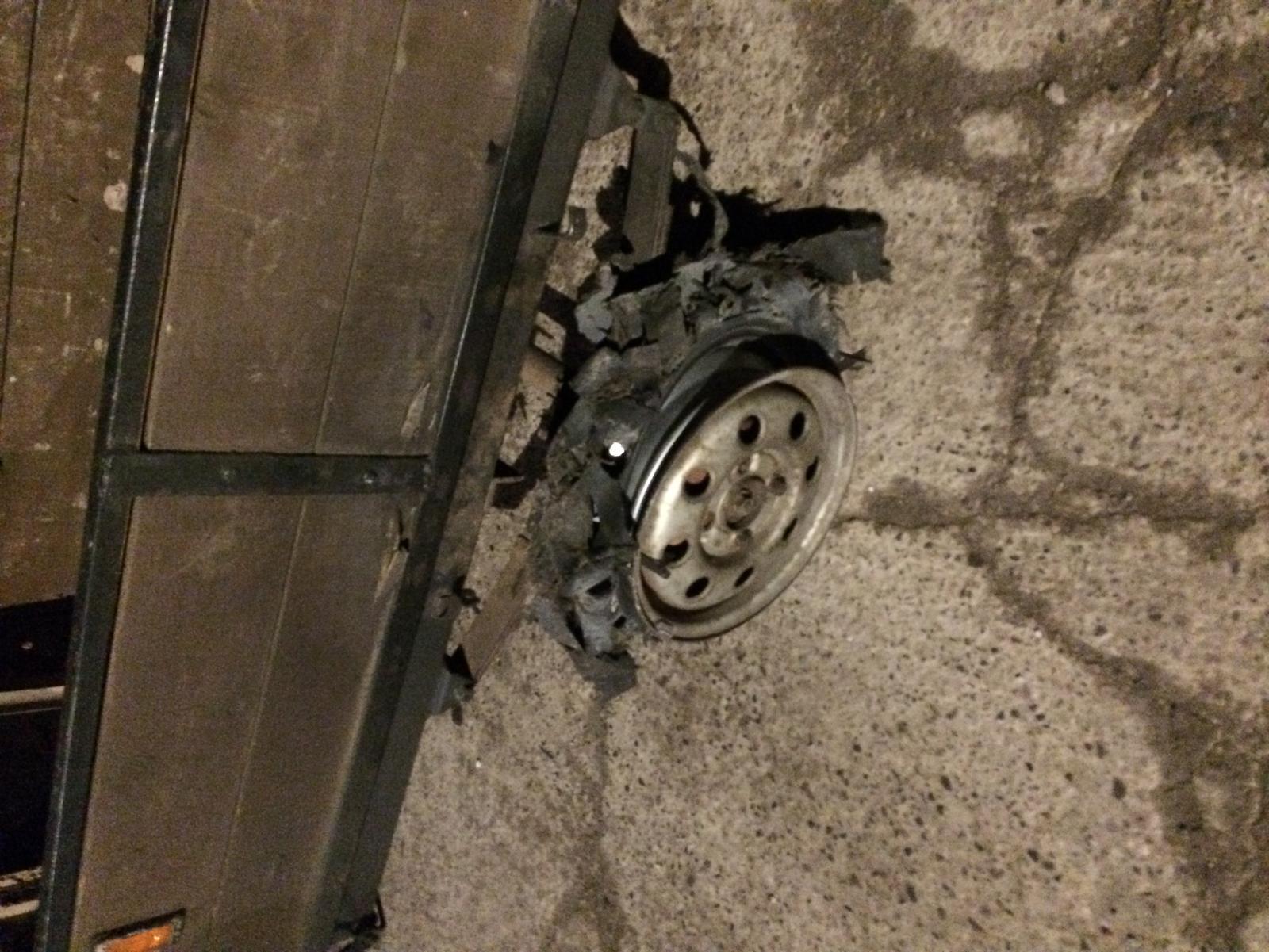

I got my moneys worth out of this one - it let go on the A1M as I carted the BX to Shitefest last year.

Yes, the slot-mags do look the nuts on it!
Here’s the reason for the single Citroen wheel.. like many of these trailers it had very old tyres!
