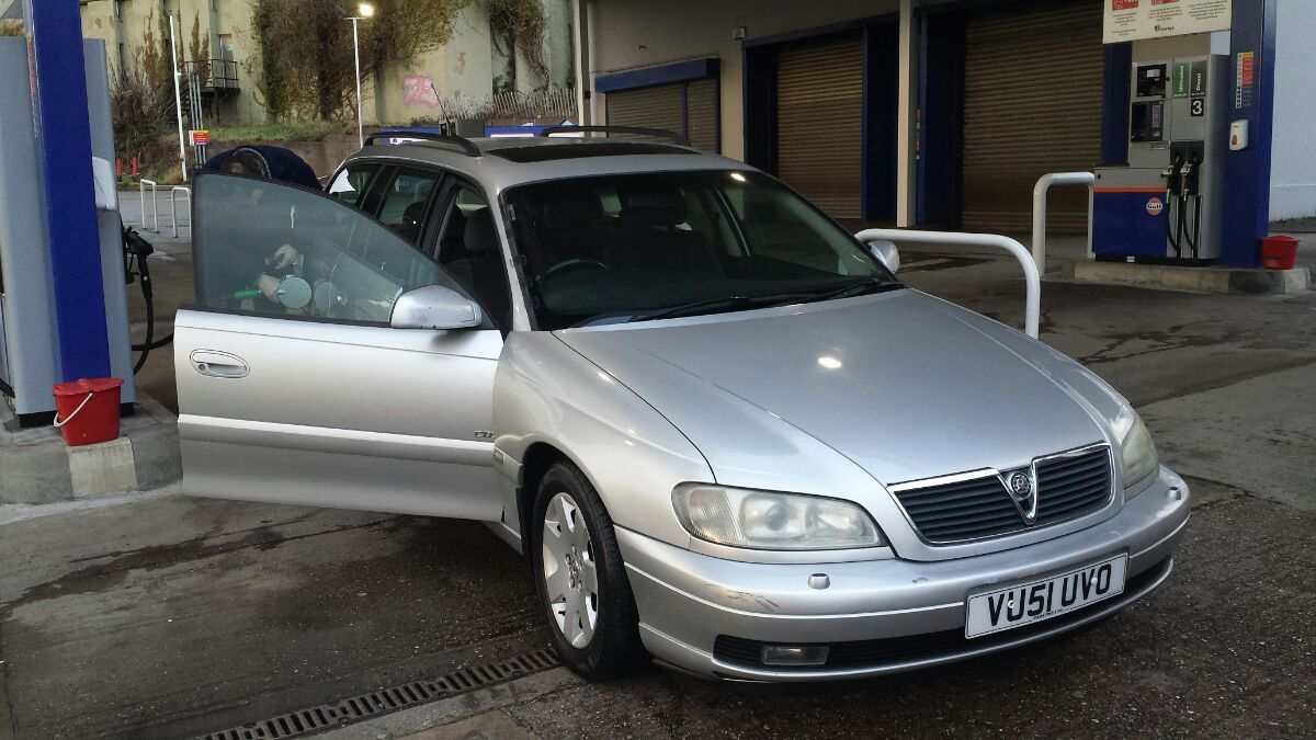

WAT: 2001 Vauxhall Omega 2.6 CDX estate automatic
MOT: May 30th 2018
Mileage: 127k
History: Stamped book until 2012, some MOTs, receipt for two Wingding Ditchfinders in August 2016 (on the front) & verbal confirmation only that the cambelt was done 'around two years ago' by the guy's AA-mechanic friend across the street (2.6 V6 has a 4yr/40k interval)
Cost: £650

Anyway, the car needed a battery and required jumping each time it was turned off. SnrYoof packed a spare battery (which wouldn't fit), lots of tools and other useful things. It also had a very low rear passenger tyre. SnrYoof forgot his fancy tyre inflator. It also needed some fuel, and on the way from the storage place to the first available petrol station on the A45 on the outskirts of Coventry it also decided to tell us it needed oil too. A quick check revealed that there was oil which wasn't black or ominous-looking, but not very much of it.
PEZ SHOT
Of course a better photograph would have been the one taken about 10 minutes later as we had to use the massive battery in the XF's boot to jump-start it. But I'm an amateur at collection threads and also allowed my dad to buy a Vauxhall, so what do you expect?
As we now wanted to prioritise oil, we Googled the nearest 24hr Tesco, which was near the Ricoh arena, and I followed my dad there. Upon arrival, it was discovered that the air pressure system at the garage was out of order. They did have oil, though. But then when we tried to open the bonnet using the catch under the dashboard it decided to stop working.
So we were around 40 miles from home with no way of filling the oil and with a rear tyre that was noticeably deflated, possibly at just being attached to a Vauxhall.
Naturally I decided it was therefore time to also highlight the car's finer points...
On a car this big the bumpers are your parking sensors...
I also got right down and looked under the car. The arches and bottom of the doors on the outside looked good, and even immediately underneath were solid. The rest of the underneath didn't look fresh. In fact, I got up and did this...
Essentially we decided that the only thing we could do was drive it home. We'd travelled from the A45 to near the M6, so joined the M6 at junction 3 and began the journey home. A brief stop at Watford Gap where it was confirmed that the warning light had come on twice more, but I'd noped them using the onboard computer, and SnrYoof decided to risk going the final 20 minutes. We carried on.
HOME!
The car drives like a dream. It sounds brilliant, the gearbox is smooth and the kickdown sensible, the engine feels like every one of its 170hp remains intact, its quiet (2600rpm at 70mph), comfortable, composed and as soon as we can open the bonnet and dump some oil in it it will be a very functional tip-runner and DIY wagon. It may get a light-touch service at the local friendly garage, then we'll wait and see what happens at the MOT in May...

Bonnet cable probably needs adjusting, 8mm bolt on back of slam panel, loosen and move the cable 5-10mm towards the pass side then retighten bolt

This was fantastic advice. I just popped into my 'rents on the way back from dropping MrsYoof at work to collect some books I need for essay writing.
Decided to mention to SnrYoof that if he sat on the bonnet and I gingerly pulled the cable that it may open.
PRESTO!
Oil can now be added, as well as coolant.
Even better, it even started without needing a jump! The nice 50 mile run must have given the battery some charge, although I imagine just that one cold start this morning has drained it again so a new battery is probably still the wisest way forwards. There was a squeaky 'this-may-be-a-tensioner-or-just-condensation-on-a-moving-part' sound that matched engine speed. This is probably just a £650-car-so-ignore-it noise.
Other than that, it's going to probably get some new fluids and then just get driven. The bonnet has been left up so SnrYoof can investigate why it wasn't opening with just the cable release; he's good at that sort of thing so I have no doubts he'll work out how to solve it.
SnrYoof got a new battery fitted today. Bonnet issue appears to have also been sorted after he sat on it the other day.
Some other minor snagging issues though...
  • Low idle - seems to tickover at juuuuust over 500rpm and it feels slightly uncomfortable. It's not like the timing is out, but it feels like it's just a little too low for it to feel happy. Can you adjust this using an idle control valve or some such contraption? (that was a total blag please don't laugh please humour me)
  • Spongey brakes - a bit of brake pedal travel is required before the brakes cut in and they don't bite as reassuringly as they could. Pads and discs look fine; suspect it's just because it was sat for a couple of months
  • Passenger seat is height adjusted electrically and the motor is jammed. It makes a whirring noise and clunks but doesn't move the seat. It's also stuck in a position that makes it impossible for SnrYoof to sit in it, although I suspect this won't really be a problem. He says it's too high for even me, and I'm 6ft 2; hardly a giant. This may be a fiddly one to sort out if the seat requires disassembly.
It's going to get a service, brake fluid flush and then some proper runs about and it should sharpen up a bit - that's the way things work* on Autoshite right?
Engine and gearbox felt very good on the drive home, as I said; those are the two critical components and fortunately they're both strong on the Omega.
