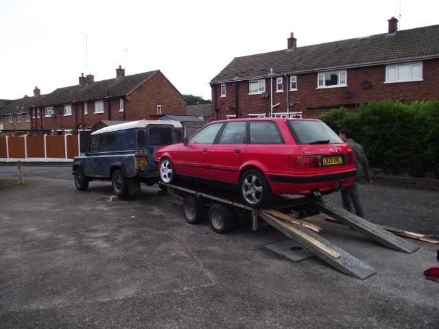

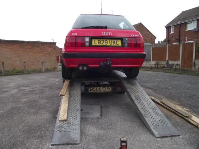

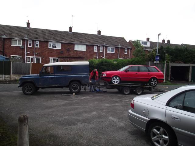

The collection of the Audi was performed completely to an Autoshite manor, involving a trailer that was too small really, no winch, some ratchet straps and a fair bit of swearing. Pictures to follow later.
