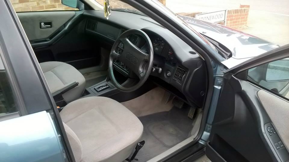

Buying this later today from the blue forum,no collection thread though as its being trailered and going straight to my local garage for some free parking. I am an Audi driver!!!!!
