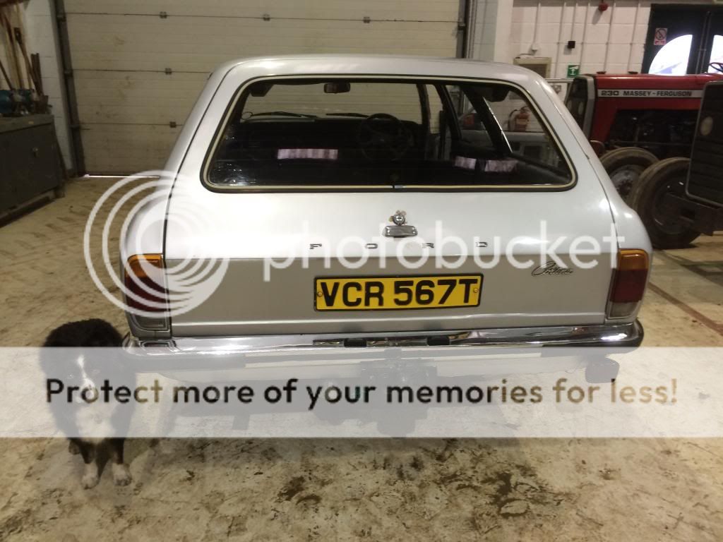

The blue ebay Cortina of endless misery i'm trying to flog has finally generated some interest :-D
One lad on BSC has offered a trade for a tidy x300 jag (so much want).
And a local classic breaker/trader has offered a bag cash.
I give you a clue to the result.
"Steve walks wearily down the street, with his brim pulled way down low"
I was reading that advert over on there, It does look very tempting to be fair, just a shame about the few jobs it needs doing, I guess that's what's putting people off.
Still would though.

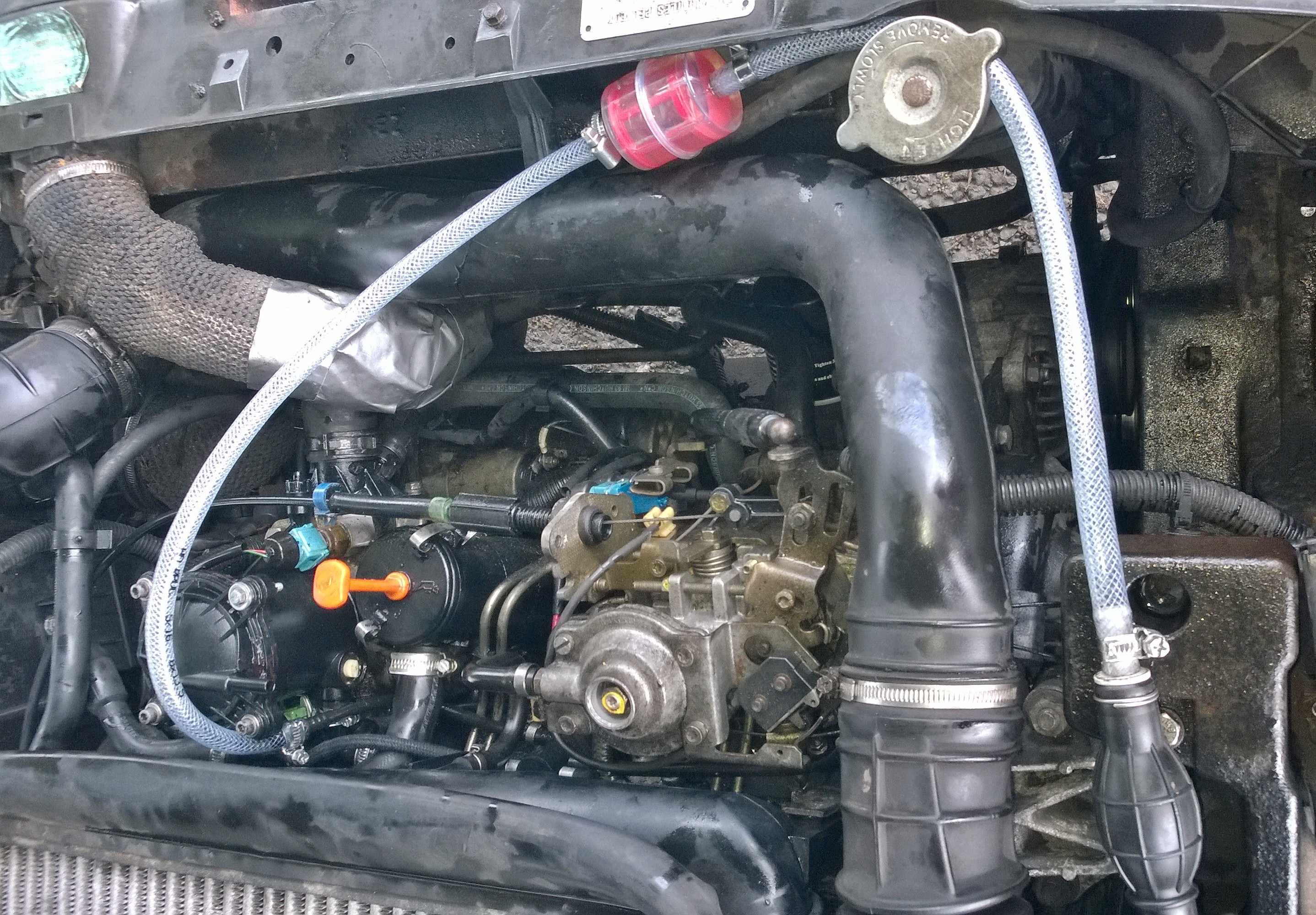

I had a delivery of 10m of clear fuel tube today so I set about the 405. It has shown up that air is getting into the fuel housing somewhere. I took it apart and it is the switch halfway up on the back of the filter. it is cracked and air must have been getting in there.
I have cleaned it all up and slavered gasket sealant all over it, fingers crossed that will work (dont think it will). I reckon I might have to replace the housing. Any idea where to get one?
On the Saab there is an oil leak dripping onto the exhaust creating a stink and some funny looks at traffic lights. I have lobbed a bottle of Wynns Engine stop leak to see if that fixes it. If not I will have to get stuck in but having two out of 3 cars out of commission is getting me earache from the missus.
Its fixed! Completely bypassed the filter housing and ran a clear fuel line through a fuel filter to the pump. What a difference.
Starts straightway pulls really strongly and no hesitation. I think it must have been leaking for a while as the car feels transformed.
Going to do about 1000 miles over the weekend so will see how it holds up.
