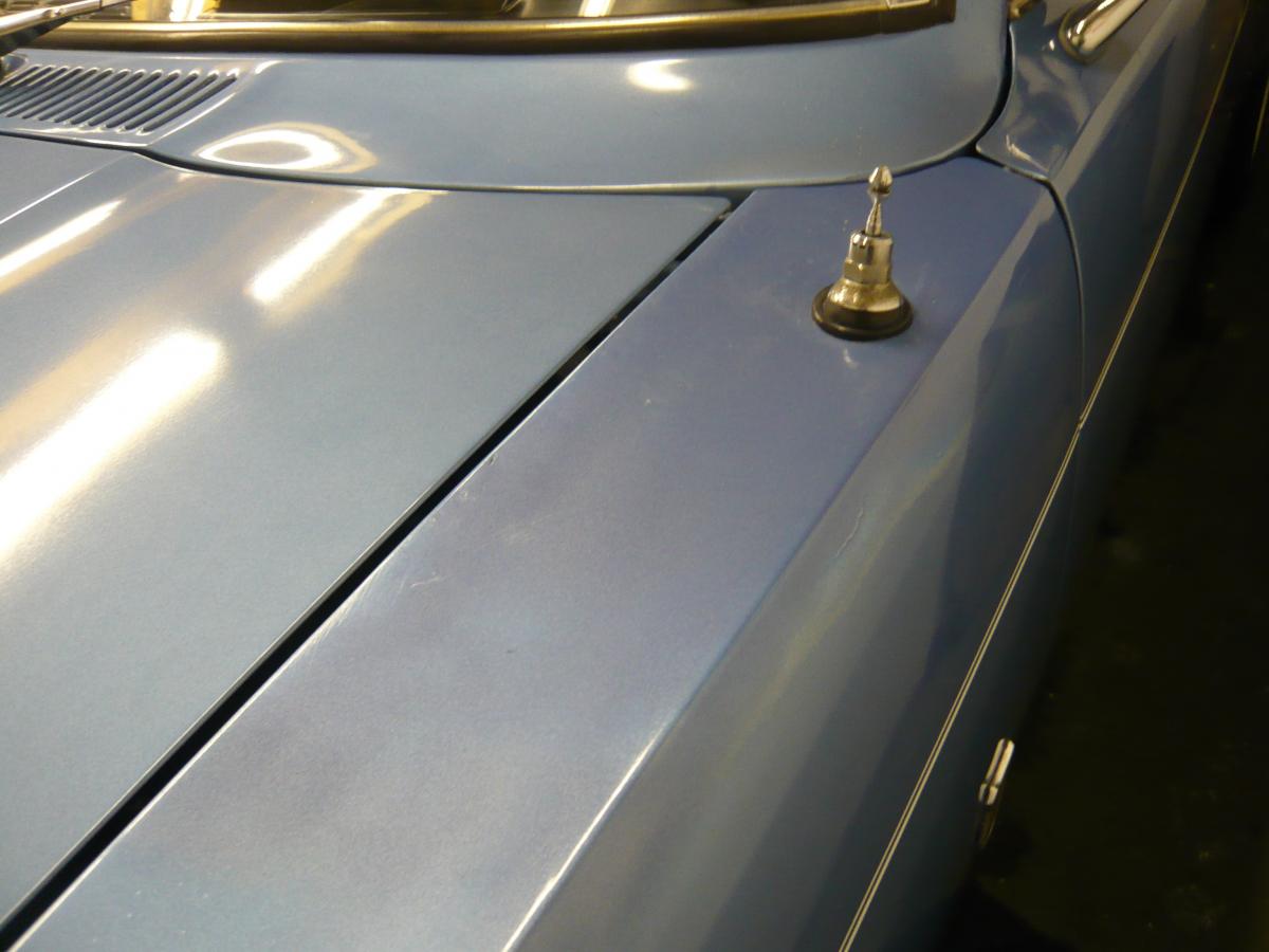

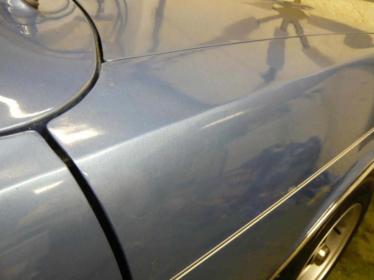

Your lucky, I'm having major Cortina woes...
I spoke to the garage doing the work today, it seems the original wings are fucked, I'm not surprised as i knew they were bad, I had got a pair of replacements but it seems they are no better, one is a flop on panel which the garage won't fit as they said they were shit 30 years ago so they aren't pissing about with them now which is furry muff and a second hand one i bought that seems to be as rotten as my old wings now that they have shot blasted it.
The trouble is it's now holding the job up as it's almost ready for primer, Mk3 wings are the most expensive to buy and they are like rocking horse shit, there's a pair on ebay for nearly £900 at the moment! Sod that!.

Damn that's crap.
Fibreglass wings are an option as above though. On a mk1 they ruin the structural strength of the suspension but as the mk3's are bolt on I don't think that'll be such an issue.
Are mk3 wings really more expensive than mk1 wings? NOS mk1 wings are £1500 a pair.
Is it not viable to have your current ones repaired? The ones on my mk1 were a complete state but I repaired them in several places and they're reasonable now.
They reckon the rear edge at the top has gone and where it goes inside the wing under the bonnet is now non-existence and the double skinned lip along the back edge has swollen and is fucked, they were so full of filler it was hard to tell how bad they were.
Fibreglass is a thought but I can't imagine them being any better than the flop-on panel fitment wise.
tell the garage to fit the panel they won't fit!
FFS it isn't their car to make the choice - you're paying the bills, not them!
I suppose it's a case of grinding all the filler out and seeing what it looks like then? It was the same with my Minx (see pics in the Little Minx thread) but new wings weren't an option because I couldn't find any.
I understand why they won't fit the flop on panel, they don't want to spend a day trying to get it to line up, which it never will.
The garage next door has shot blasted both wings and there's no back edge left to weld too apparently, The drivers side is the worse one, the bottom of the wing is complete gone as well so it will need a lot of work and labour trying to weld it all up and they are concerned that it will rust up again within 6 months and i would have wasted my money.
They might be able to salvage my passenger wing as yet but I'll find out tomorrow properly.
At least the garage sound okay. Don't think you would get many refusing to put a wing on to save you hassle in the future.
