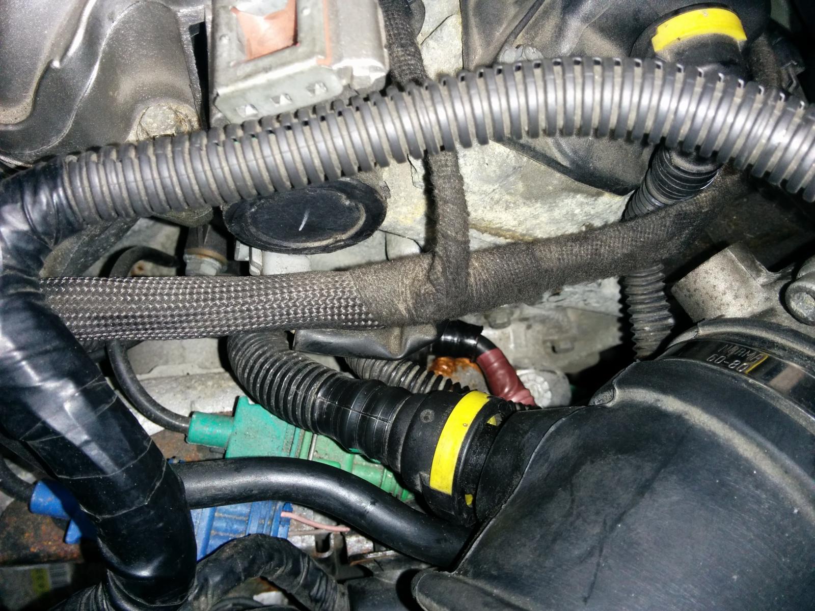

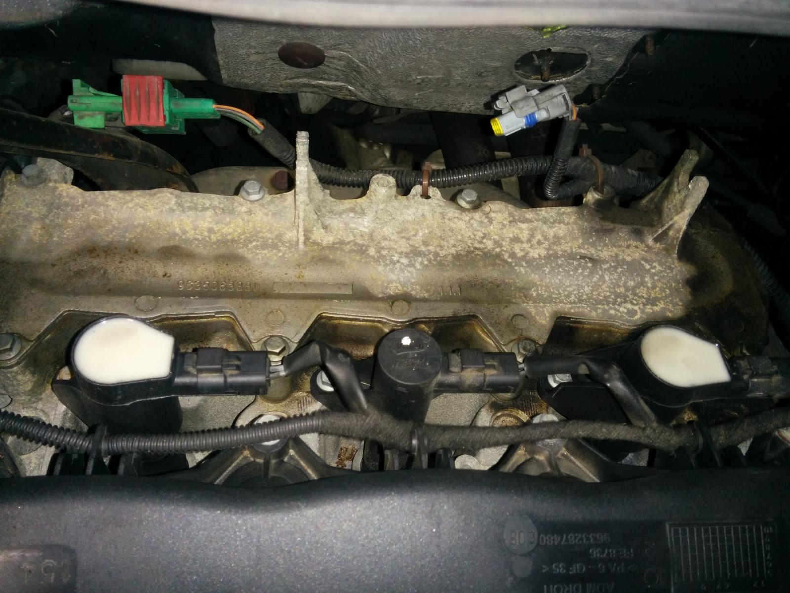

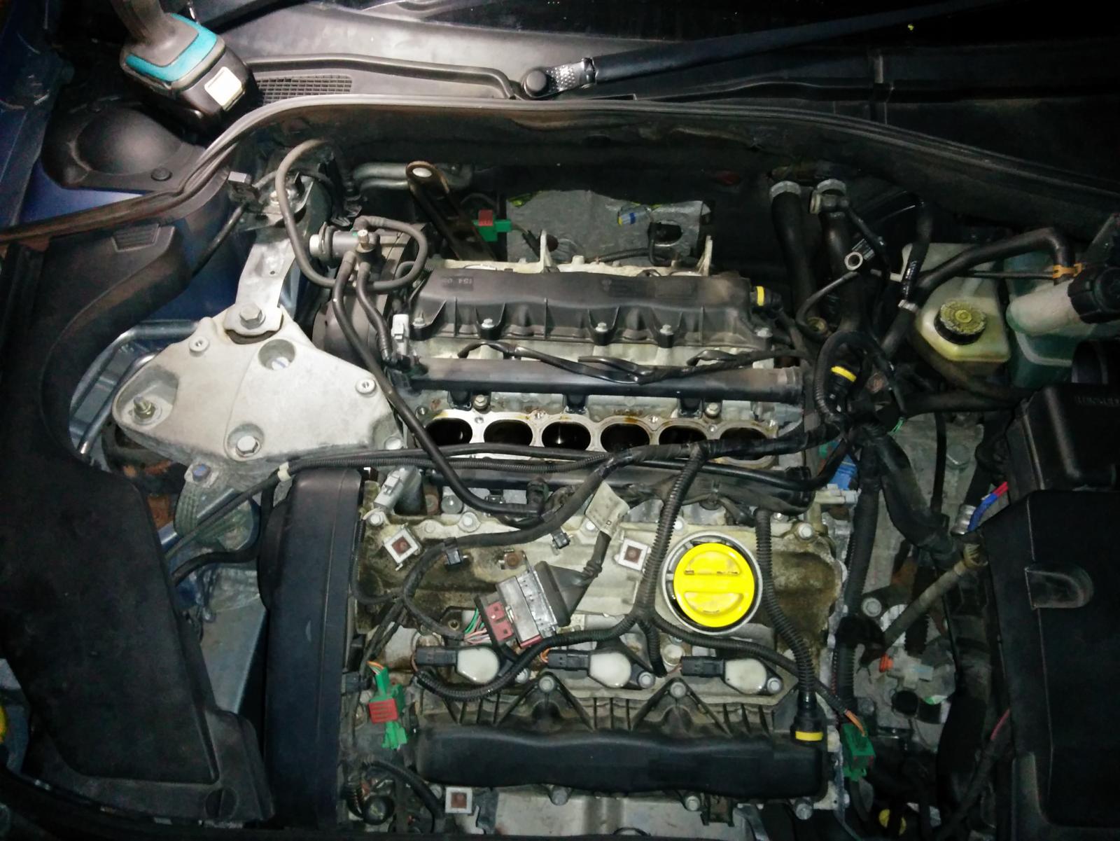

I got to this stage in 15 minutes:
The engine was still quite warm at this point, so wasn't that bad a job to start.
Guess which is the coil that failed...
Incidentally according to the paperwork from the previous owner, Halfrauds Autocentres were supposed to have replaced all 3 of those coils under the intake after one had misfired previously!

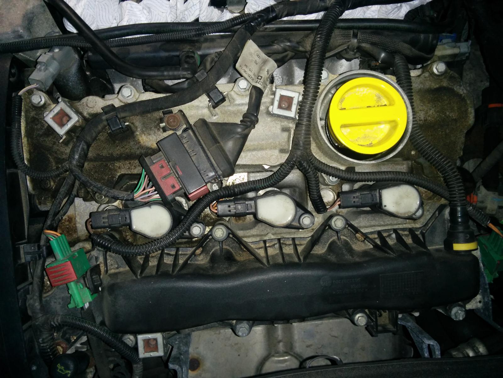

This is the stupid bit of pipe that I broke at the base of:
You can see the brown insulating tape and black silicone pipe of the bodge repair. Once it's a bit warmer I'll put silicone sealant (too cold to set atm) around the gap to seal the air leak - while I try and source a replacement.

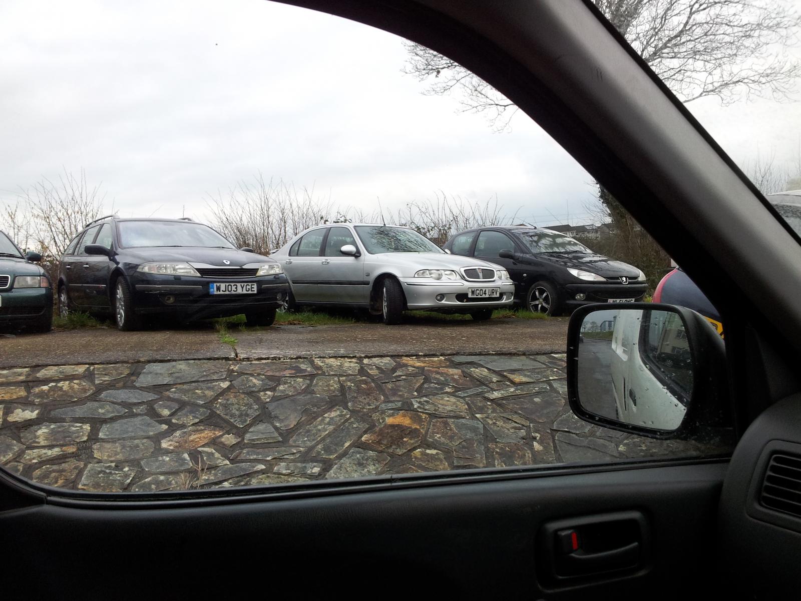

This slightly green Rover 45 belongs to a colleague and has been sat in a local garage's yard for most of the last year.  MOT has just run out, looks very tidy and had just had the head gasket done - only 56k on the clock, too.  1.4 K series, new front tyres.  Apparently, after the head gasket was changed the engine started 'knocking' and he gave up on it, dumped it at the garage and obtained another car.  I'm tempted to make a slightly insulting offer for it but it depends what the 'knocking' is - I find it hard to believe it could be the bottom end at that mileage unless it had so much coolant in the oil it's knackered the engine.  I'd like to think it was injector noise which these are apparently known for but who knows.
I might see what he wants for it and stick a battery on it so I can hear the noise myself, could be worth a punt although these things still seem pretty worthless.
On the other hand, it's currently keeping exceptionally shitey company.
One has absolutely no idea.  All sounds a bit odd to me, he's not mechanically-minded and I've not had a proper conversation about it yet so details are sketchy.
I've just remembered what happened last time I bought a Rover hatchback with a 1.4 K series engine with 50-odd k on the clock.  Hmm.
That's the sad thing, I don't really, I haven't got time for the projects already in progress!  Only reason I've even considered this one is because it's on my doorstep and belongs to someone I know.
I should probably leave it alone.

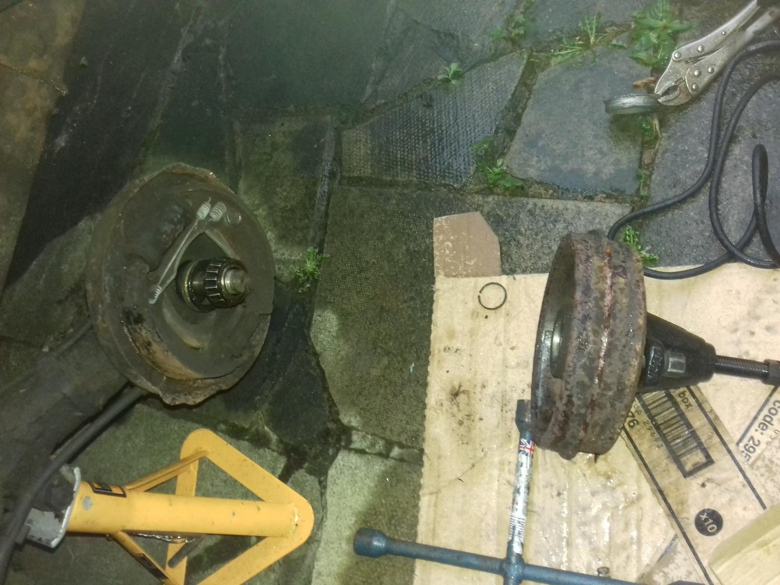

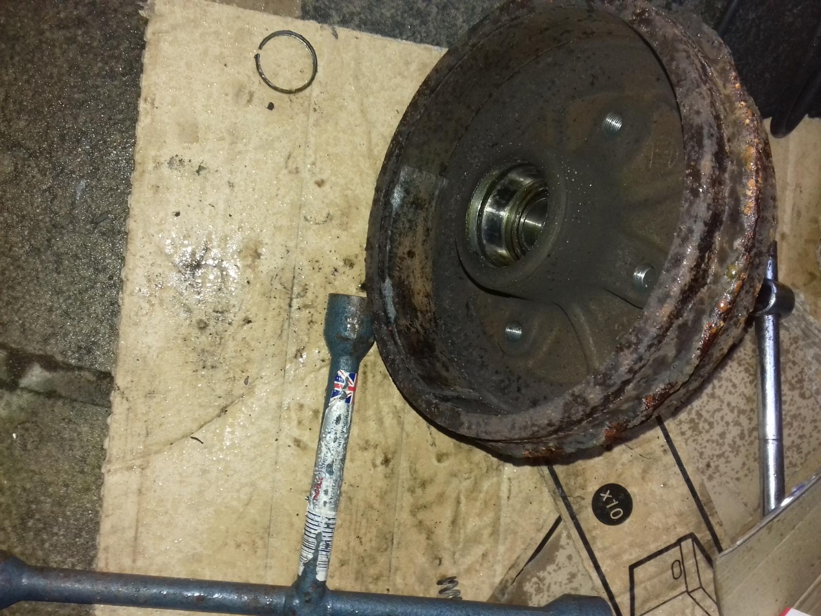

You will need a hub puller to get it off, the screw in type rather than a slide hammer. Probably best to buy a fitting kit with the new shoes as well, linings coming adrift on these is quite common. I am surprised the breakdown people didn't try to get it off at the side of the road. A few years ago I went out to a 306 that had done the same thing took about 3/4 of an hour but came off in the end without too much damage.
Pug 106  rear brakes update: hub puller bought, drum came off no bother.
And there's the lining on the drum.
Just need a shoe set, a fitting kit, and by the looks of things a wheel bearing too.

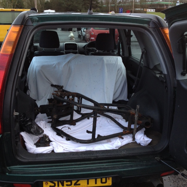

Not exactly a collection thread but...... 300mile round trip today (Lanarkshire-Bishop Auckland) in a 15 year old CRV to collect a replacement frame for my 33 year old GPz1100. A £50 ebay bargain that still has a few useful bits attached. The original GPz frame is bent and even using a 25mpg car for the collection run then painting the replacement etc it's still going to be miles cheaper than getting the original straightened.

How does that work with the bike's ID? I think the reg goes with the frame number doesn't it?
The only time I've known a frame be changed the garage supplied a frame with no number on... turned out to have been crashed too
The new frame has a V5 so the old bike will be officially scrapped once I've rebuilt everything onto the new frame.  A shame as I prefer the reg number on the bike as it stands just now but can't transfer the number as it is a newer reg by 1 year.
There is no way that I know of to change a frame number on a V5 so this is the only way to do it unless you start grinding off and re-stamping numbers and that looks (is) really dodgy.
I don't actually like the practice of buying & selling frames with log books as it can be the same as selling VIN tags and a V5. Essentially a ringing kit. At the autoshite end of the market it's a harmless way to get around a £500 bill for motoliner frame straightening on a bike worth £1000. At the other end it's giving a false identity to somebody's pride and joy that's been stolen to order.
Rest assured this one all checks out ok. It's an old bike that was legitimately broken for spares and the numbers and paperwork are all sound.
Logbook goes with frame, anything else is just ringing..
The one time I saw a new frame fitted the insurers sent someone out to watch the identity of the old frame be destroyed and see the number stamped into the new one.
Edit sorry missed your reply above.
Ta. I thought that's how it was but wasn't sure.

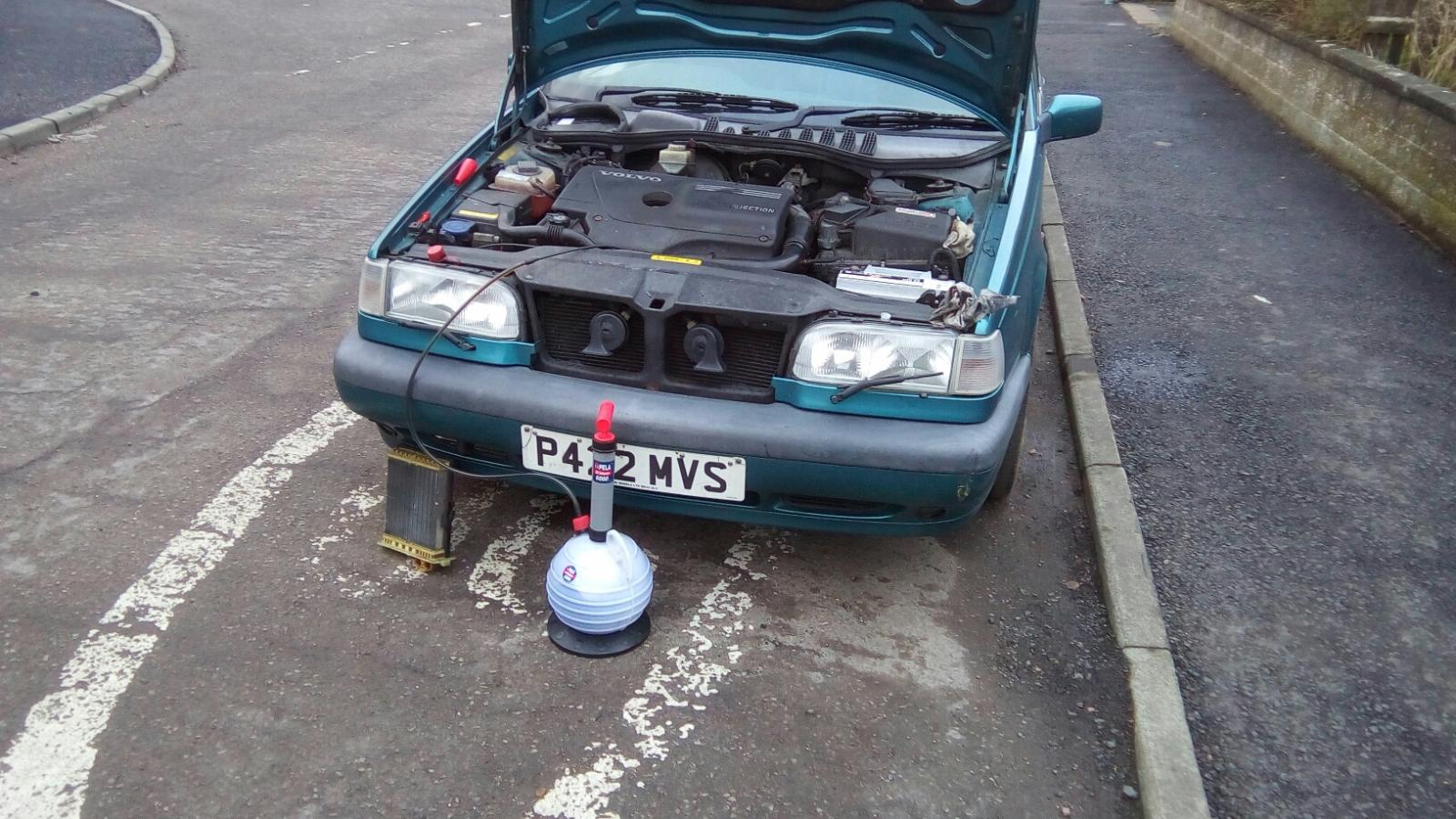

Slight mojo restoration on the Volvo today. I managed to get the heater matrix and oil changed. The Pela pump gets more oil out than the drain plug does so I've come to the conclusion that it's better as well as easier.post-168-0-88367100-1486916905_thumb.jpg
