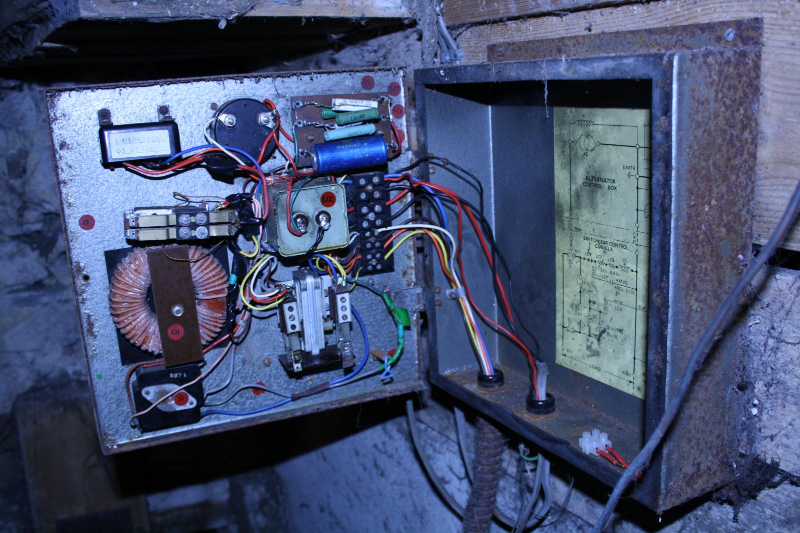

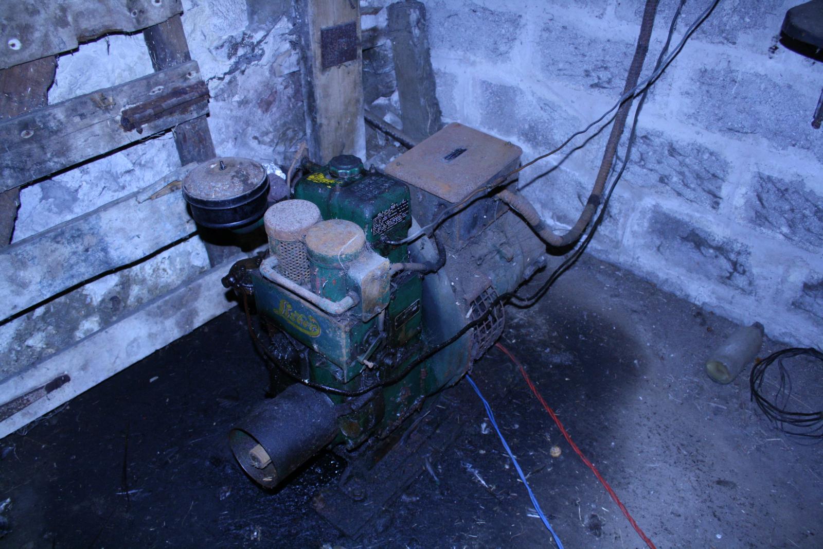

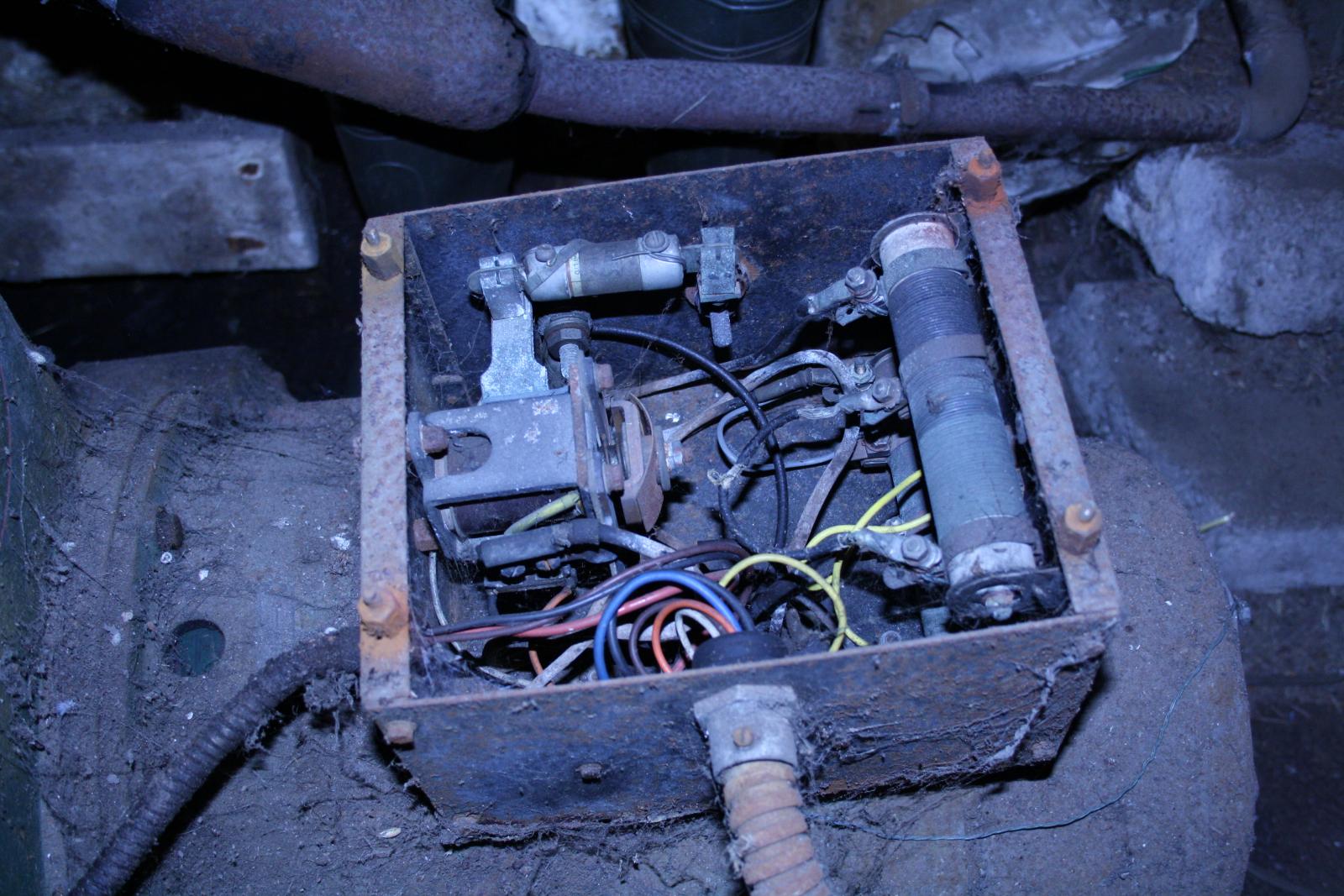

We were having a prod around his generator at the back of the farm shed. It's not cranking quick enough to start. We didn't manage to fix it but I took some photos of it anyway. It's a weird starting system, where the generator/alternator part of it works as a starter then switches over once the engine is running. It can even be set to auto, he says that when it's working properly and it detects more than 40W being drawn from the battery, it fires up the engine.
Does it run on veg, mate? (Soz, couldn't resist). One of those everlasting old Listers, looks like an air-cooled one for extra noise.
Aye it's a Lister. Not sure about the veg oil bit.
That's a Lister "Start-o-matic" genset. engines that look visually similar to that one were made from the late 50's onward,  The last versions made in 1985.
They will run on veg (if it's warm enough), but the power output will be lower, which could be quite important with a genny.
